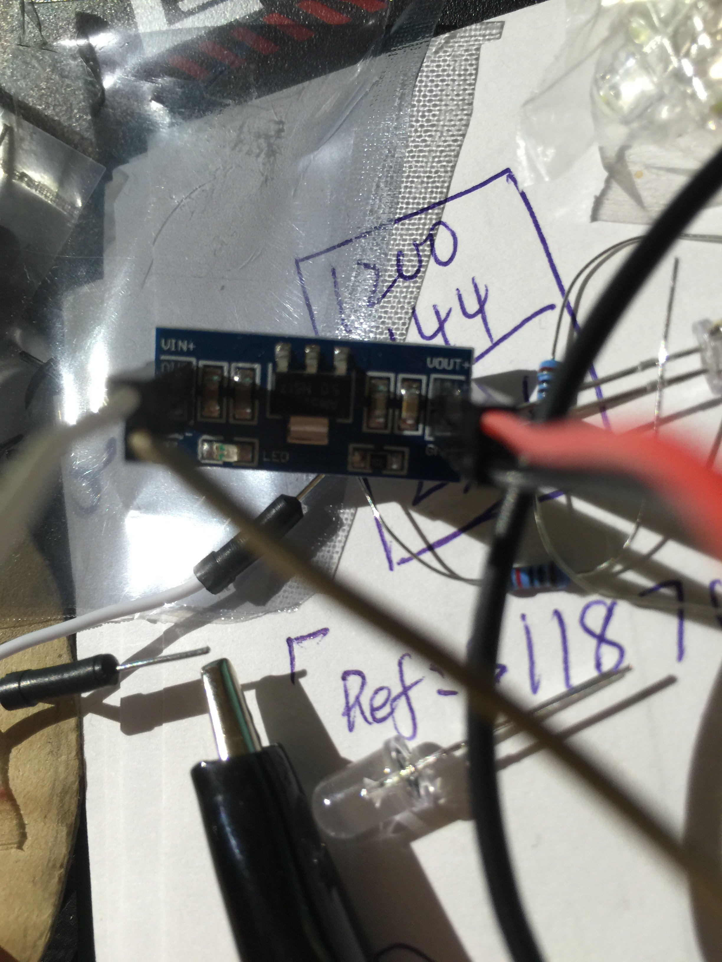

2) I bought a 5v module (input: 6-12v, Output: 5v 800ma) to replace the lm7805, 0.33uf & 0.1uf on your diagram. Looks like this

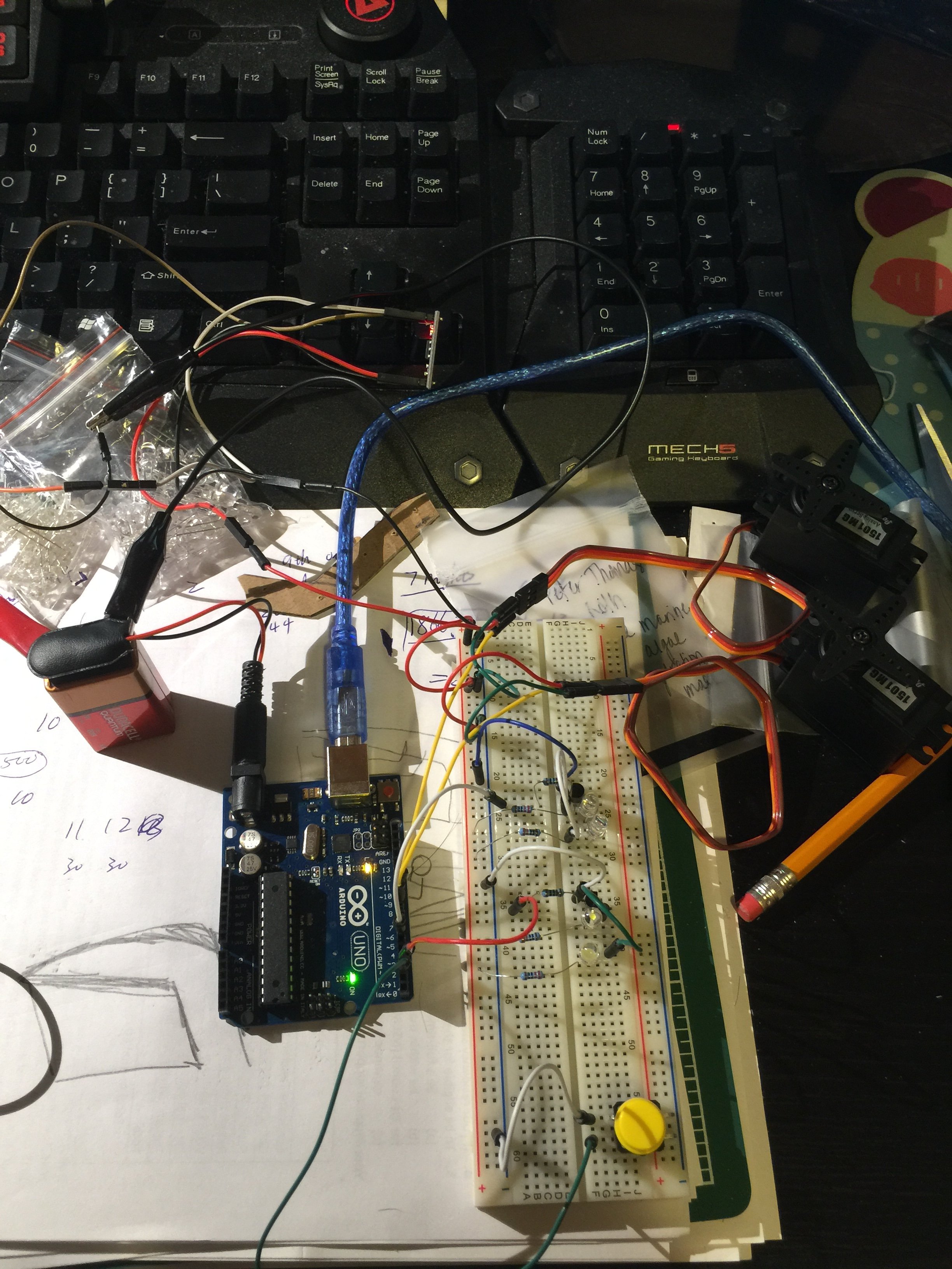

4) I use bread board to connect everything for test.File 2016-03-29, 9 10 57 PM.jpeg. So I connect the battery to the 5v module and than connect it to the breadboard. Then connect all servos and leds to the breadboard.
Here is my problems:
1)When I plug in the power supply, the servo start moving themselves.
2) when I push the button, the led turns on but keep flashing and the servo keeps moving by themselves after they move to the right position
3) Seems like every time when servo start moving by themselves, the L led light on the UNO r3 board flashing as well.

1.) (again) do not use +9v batteries! they are notorious for SUCKING!.. seriously... probably wont be able to provide enough current for the project.
- +6 voltage probably would have worked.. give it a try..
2.) servos:
- do you have all GND's connected.. battery/Arduino/servos?
- try limiting the range/movement of the servos.. (maybe your arms arent centered/set and its trying to move past its stop position?) try a range of say 30 - 90 for testing..
3.) Have you metered the module you are using? getting a steady/stable +5v out of it on your meter?
the servo twitch sounds like the GND not being connected to me.. (or moving past the stopping point)
* looking at your pics.. I dont see a wire from the Arduino GND pin to breadboard GND (where battery and servo GNS connect).. but I cant fully see/grasp what you are doing at the battery directly either.. lots of wires going on)
4.) You can probably eliminate the leds & transistors/resistors..etc..
and just use 1-led (with resistor) directly to each pin for testing as well (helps to trim things down when troubleshooting)

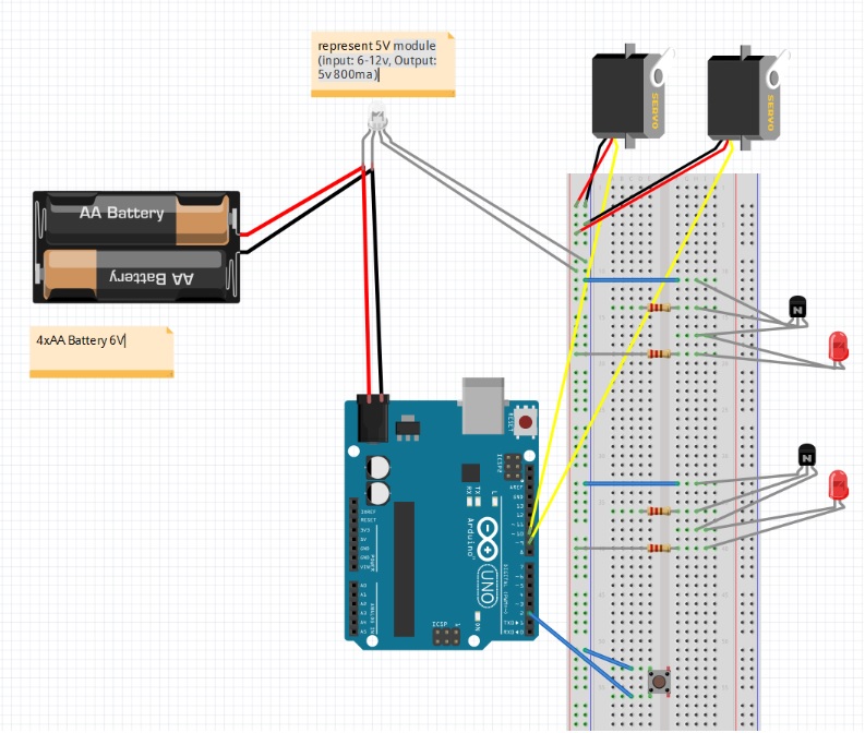

Hi xl97,
I did follow your steps but still no luck. I draw a diagram to show you how I connect everything.
So the 2xAA battery pack represent 4xAA 6v battery pack. And the RGB LED is represent the 5v module. It has in +/- and out +/-.
Here is how it looks like when I power it on and push the button.
I have already change the move degree from 180 to 30 for the servo.
Could you please help me out?
Thanks
