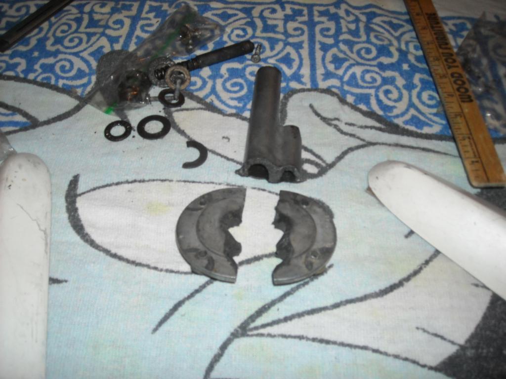

Spring Return Mech & assorted washers & bearings
Pieces of the swivel Mechanism - This one is broken in 3 pieces - Interestingly the working burke chairs don't have this piece & the mechanism is cast into the base of the chair. I picked up a Burke 116 at a local mechanic for free!!! & It has this piece unbroken in it!

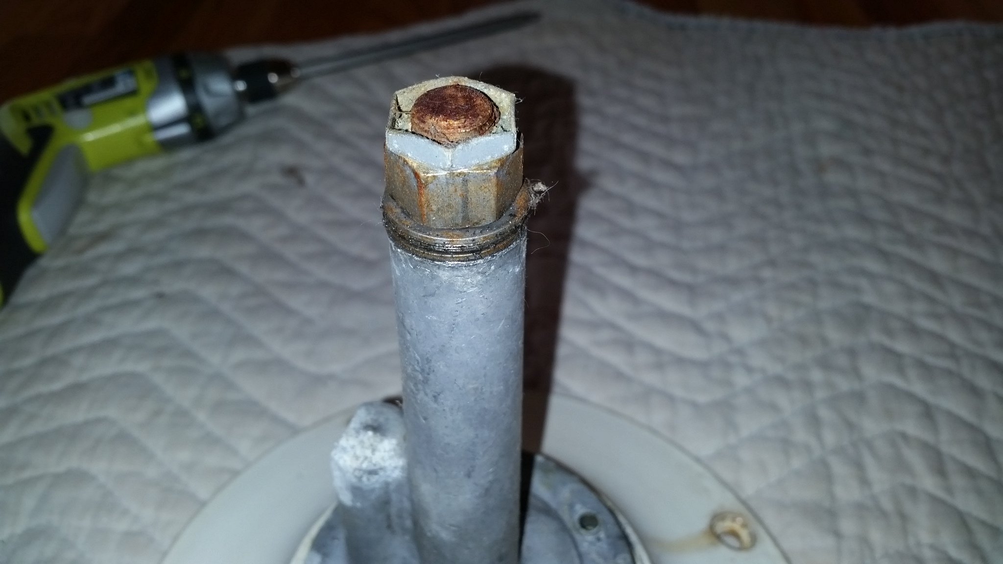

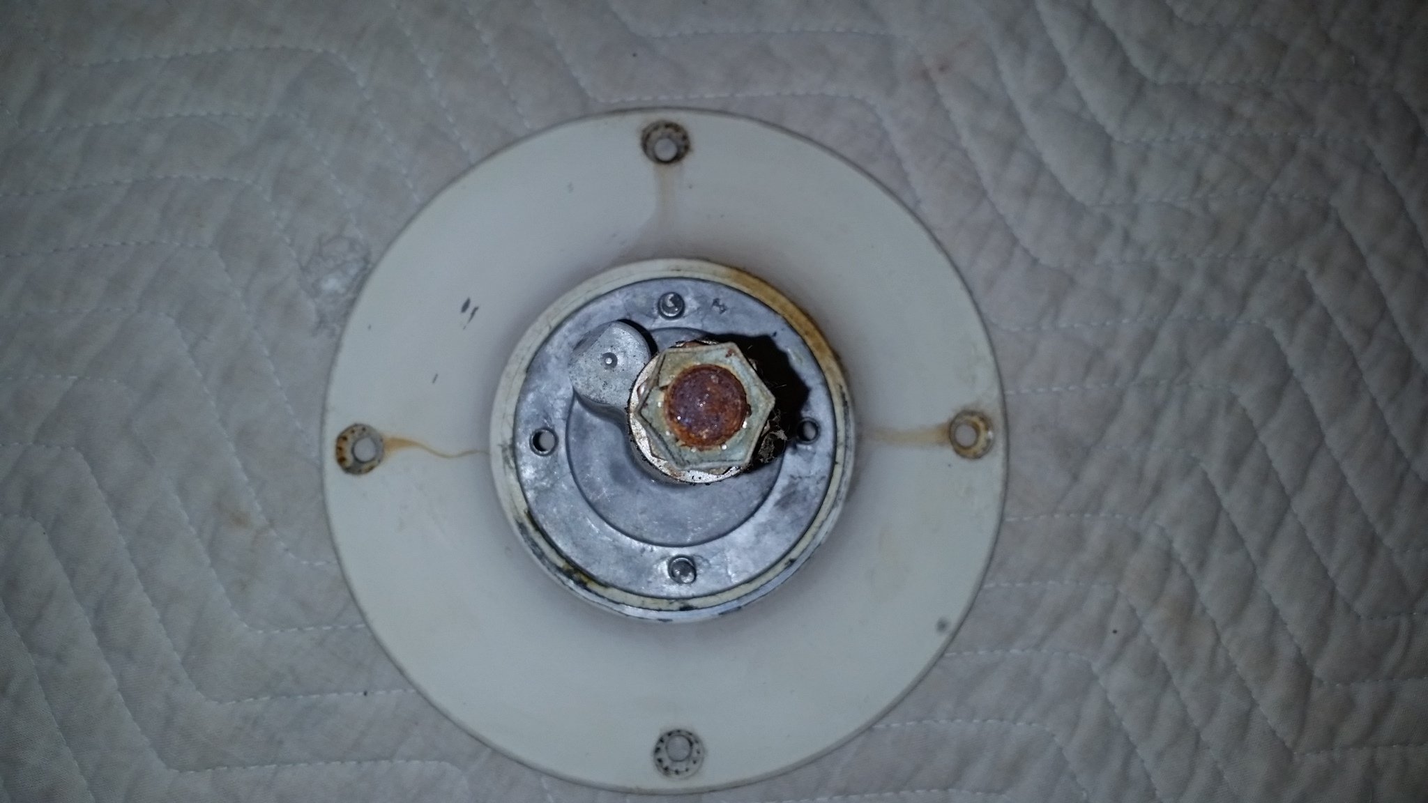

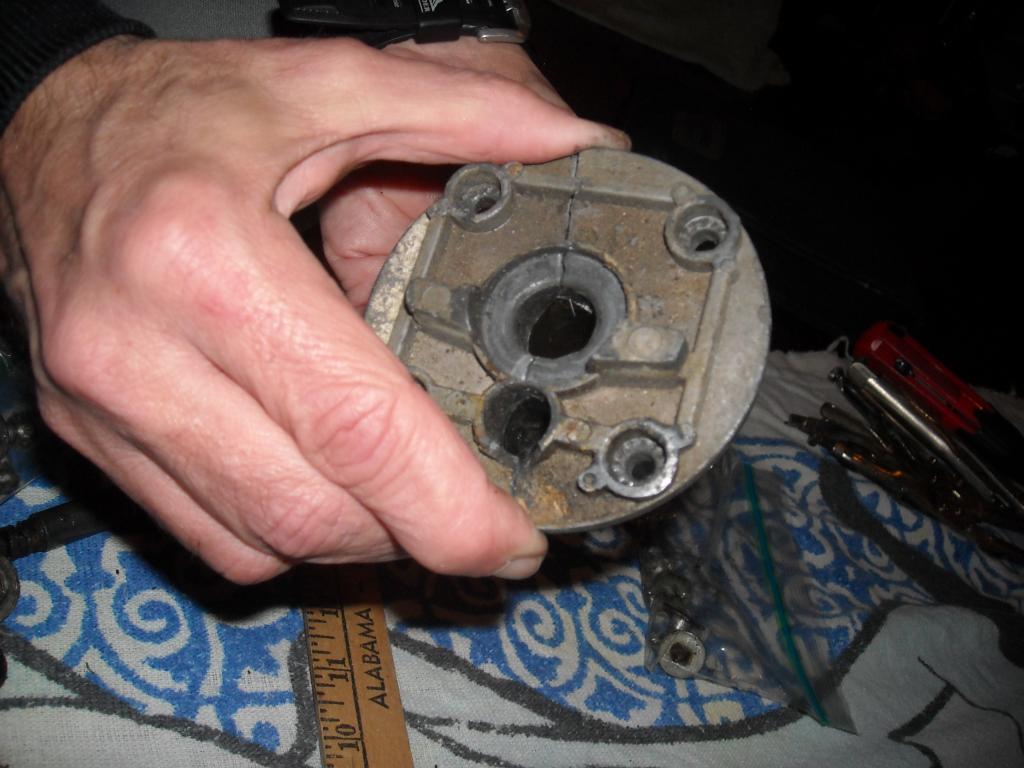

Bits of the swivel mech held together - The post on the upper base gets bolted through the central tube & a spring & tube with bearing on the end goes in the off center tube for the return mechanism. - The upper part of the base is tilted underneath for the return spring to center it.
Top of the Swivel Mech - Screws to top of the lower base through holes in the upper base
Side view of the swivel mech

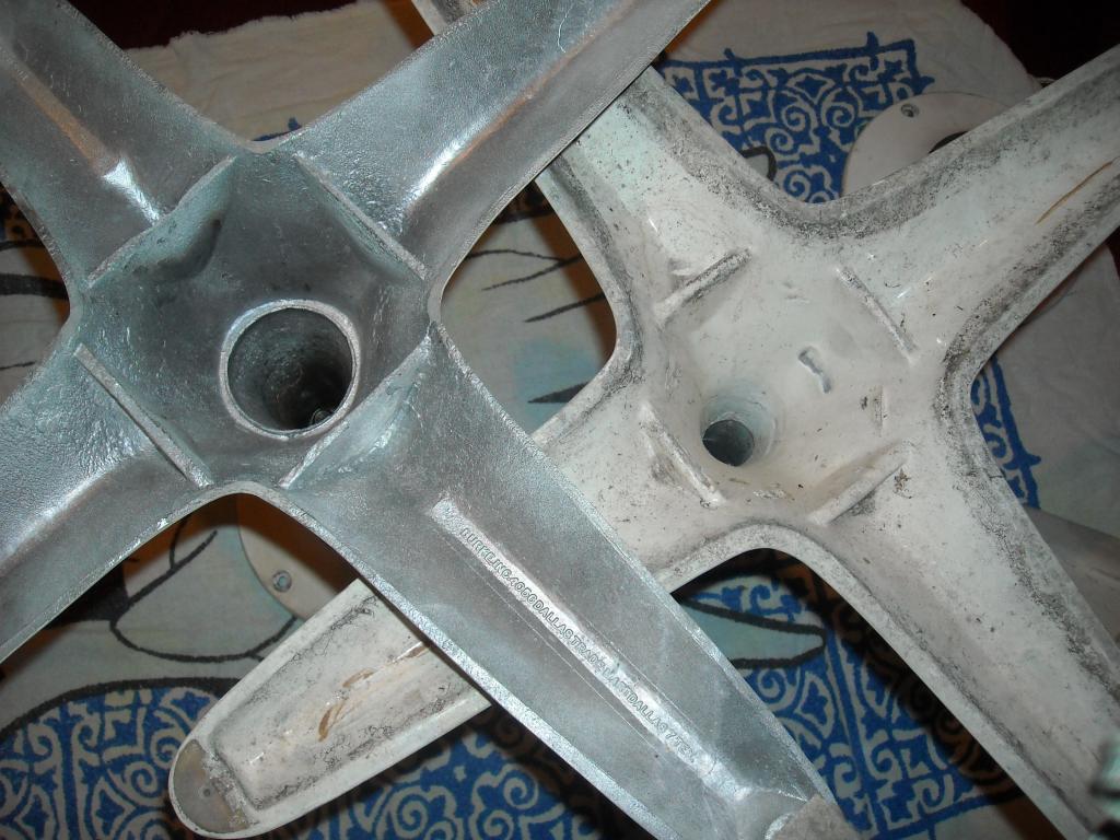

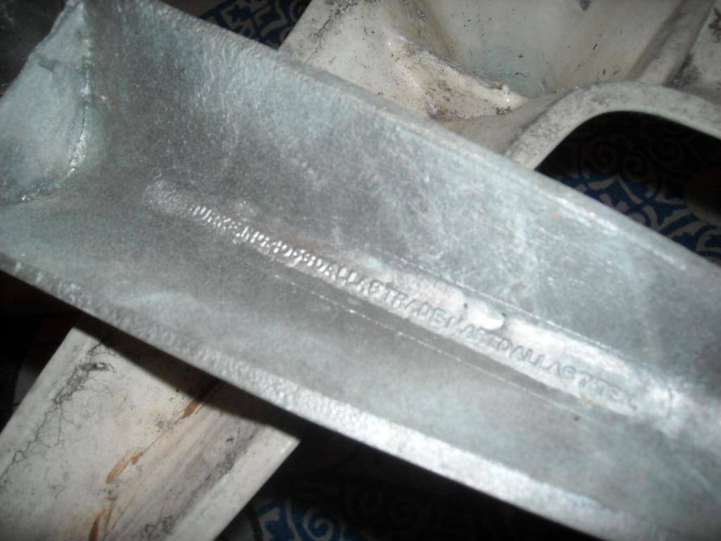

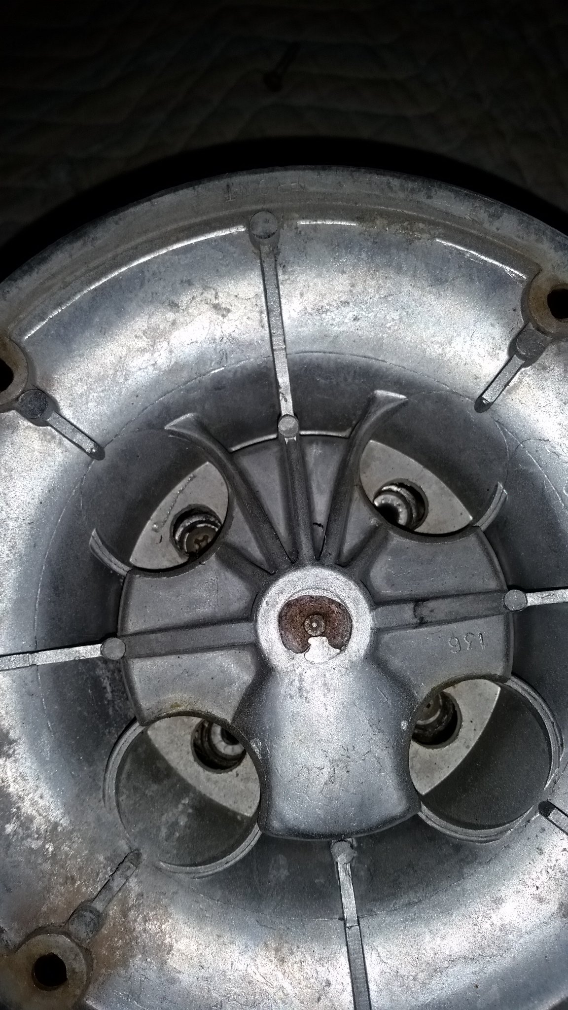

Bottom of the propeller base with built in swivel on top, The lettering on the base with the broken swivel is much softer - Maybe coated over too many times.
Comparison of two bases from bottom

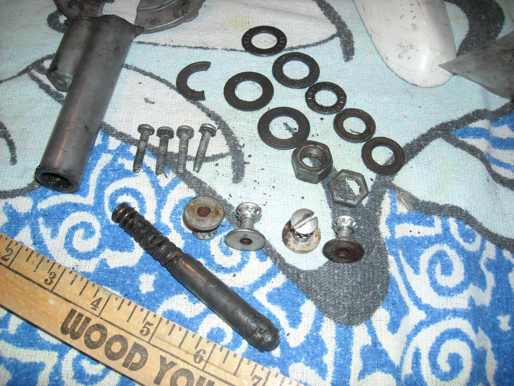

The set of 4 Screws & bolts in the first pic hold the seat to the upper part of the base - I'm having a hard time replacing those since they are missing on my beater chairs.
Anybody got an idea for replacing that cast aluminum swivel mech? I'm assuming getting somebody to cast in aluminum is going to be stupidly expensive, I was considering getting a functional disk & tubes welded from steel maybe...

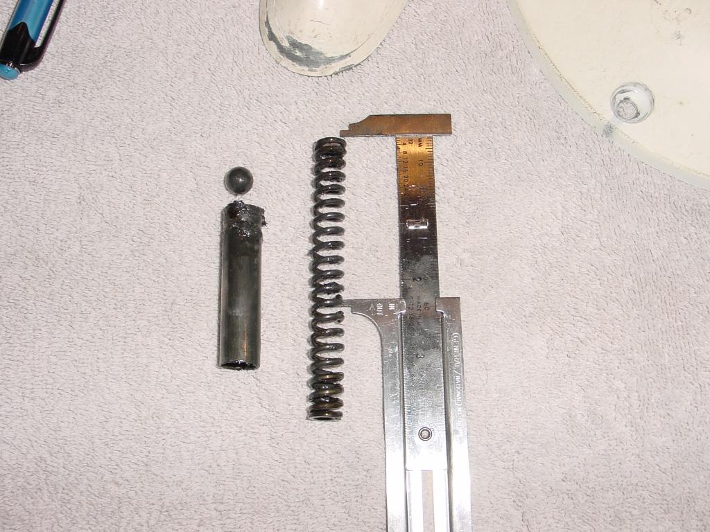

Return Spring, sleeve bearing, washer bearings & self tapping screws I'm not too worried about, found some close enough parts.

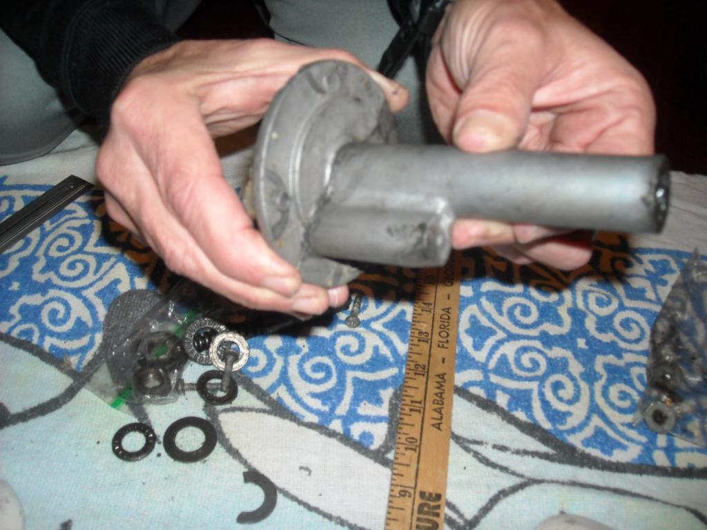

So managed to find the disc bearings & a bunch of the other hardware - By Buddy welded the broken swivel mech back together (Didn't know you could weld cast aluminum?) Still need to replace one of the swivel mech & one of the spring/bearing mechs - Here is a pick of the spring & the bearing.
The Spring fits in the tube & then slides into an off center hole in the Swivel Mechanism. The bearing sits in a little cup that fits at the top of the tube & the spring then pushes the bearing against the tilted under surface of the upper chair base. This cause the chair to spin back to center.
Any suggestions for terms to search for on this little bearing cup?
BTW - Got my broken swivel mechanism welded together, but it's not as smooth as the unbroken ones.

Do I remove what appears to be a 'C' clamp from the top of the Mechanism in order to remove it from the base?
What about the nut at the bottom?

Also, did you ever find a solution for the feet of the chairs and suitable replacements for the screws and T-nuts?
I'm also finding it impossible to find those star washers that are concaved rather than flat?
