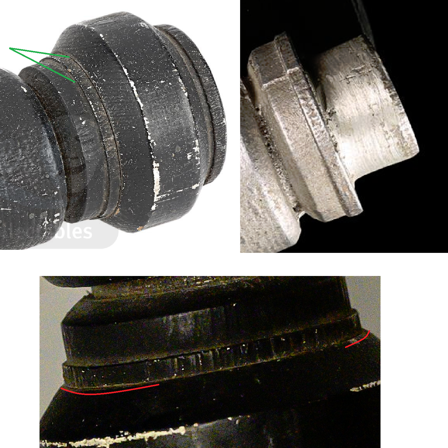

I think I've been staring at this thing for too long - but Mouse Vader I think you are correct about the pommel being separate... See here:
The green lines shows 2 types of internal corners, the leftmost one has that rounded groove that a once piece lathed item has, but the second spot (where the casting lines up too) has a pretty distinctive line that does not have that same rounded edge to it.
Also on this 6k image, I grabbed a snip of the pommel here. The red shows 2 spots where I see the pommel coming off the body, right at the same spot on the cast blank. And the grove right above it (first green line) does not show any indication of that kind of crack
This could mean for these castings, they did it in such a way that the cast blank could be mounted, then created this 'slip-on' pommel they could cast again and use on the body because we know the pommel extends does extend further into the body.
(I'm half asleep right now.. so I hope someone sees this too)

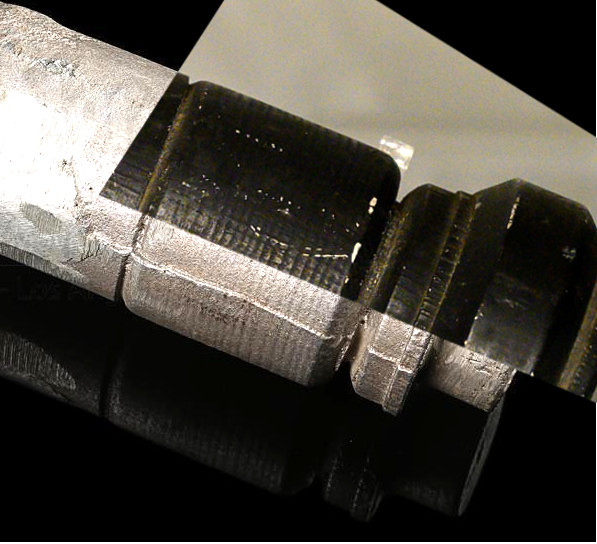

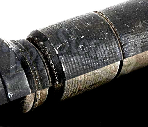

Ok Someone had to fingerprint this thing - muggins again ;) . Bare in mind I've had to scale & rotate one image to fit another. These fortunately were similar angles to start with so not by huge amounts. Levels & contrast also altered for better definition. Also disregard my post #68. I could follow the grain from the body to the pommel but only onto the part that's present on both. LOM I see that area & it does look suspiciously crisp. I'd expect some small radius here if only from the paint.
(edit: another angle.)
Now all we need to do is get someone to persuade Gus to give that pommel a good twist...
