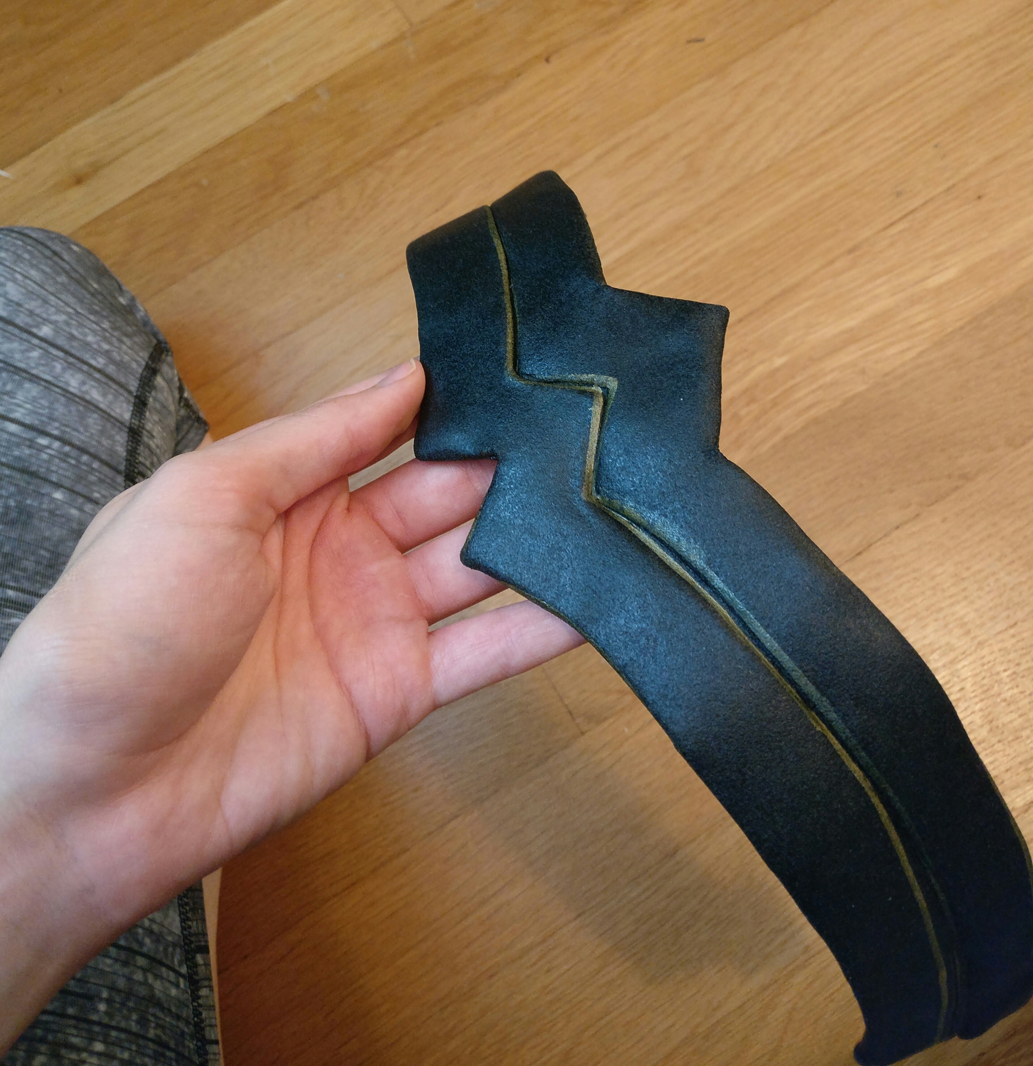

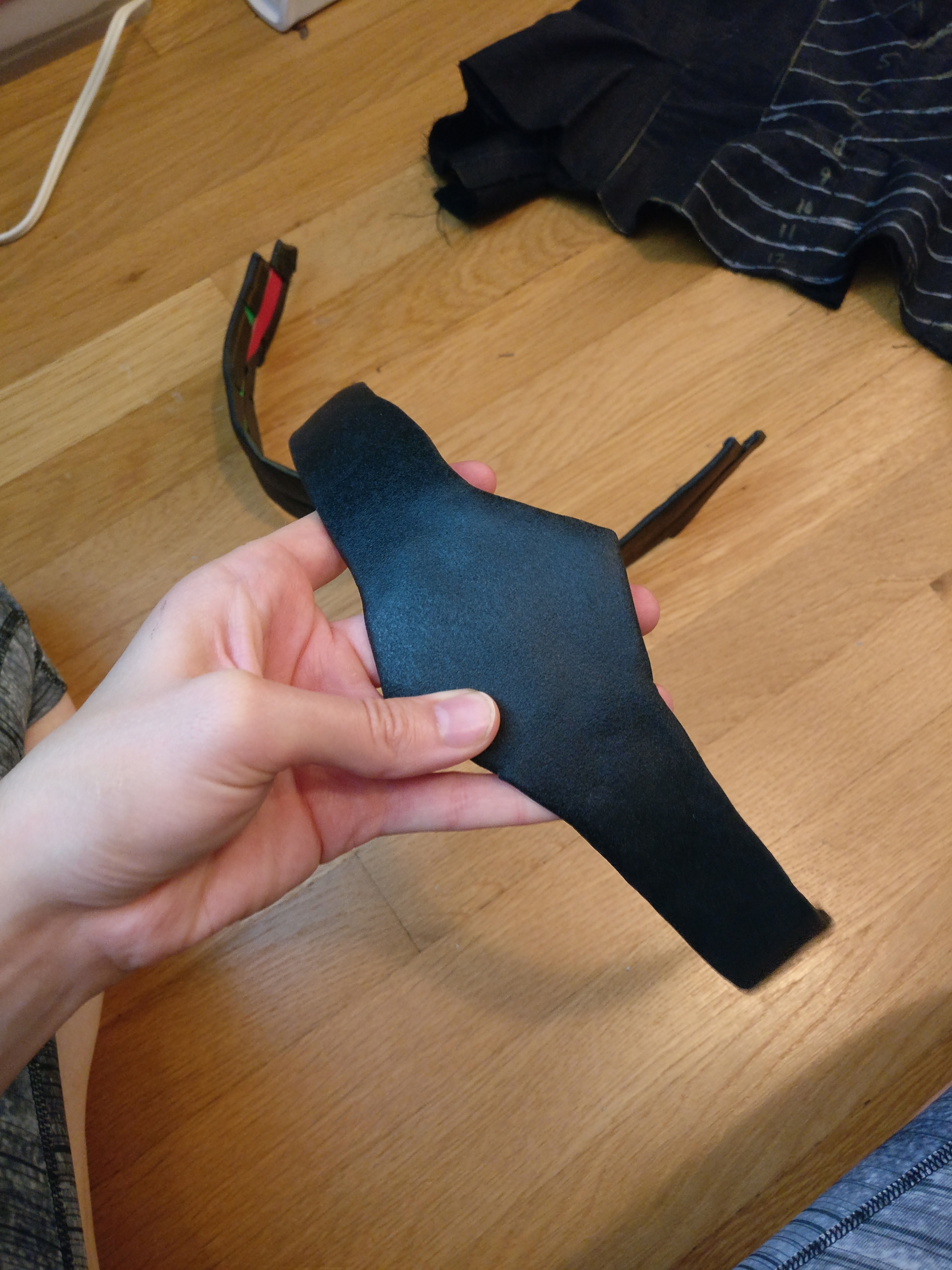

I made a first attempt at my Worbla pieces which... didn't go so well. Ha. :D You can see the breastplate, my first attempt, is rather lumpy looking below. I think this is due to both 1) me never having worked with Worbla before and not really being familiar with how it heats and handles and 2) the fact that I attempted to merely coat the craft foam underlayer with one layer of Worbla on top... I've heard of people using this method rather than the 'sandwich" method with a piece of Worbla both on top and bottom of your craft foam core, but upon seeing some more videos of people using the sandwich method, I think this helps keep the surface looking a bit smoother than the 1-layer of Worbla method I used, due to the 1 layer needing a lot of hand shaping and pulling around the edges of the Worbla. I THINK this is what made it a bit more lumpy and uneven. So, I'm going to be re-doing these and the remainder of my armor pieces using the sandwich method.
As you can also see below, my second attempt, the tiara, looks a little better than the breastplate, but still more lumpy than I'd like. So I will be attempting that again, using the sandwich method this time.
