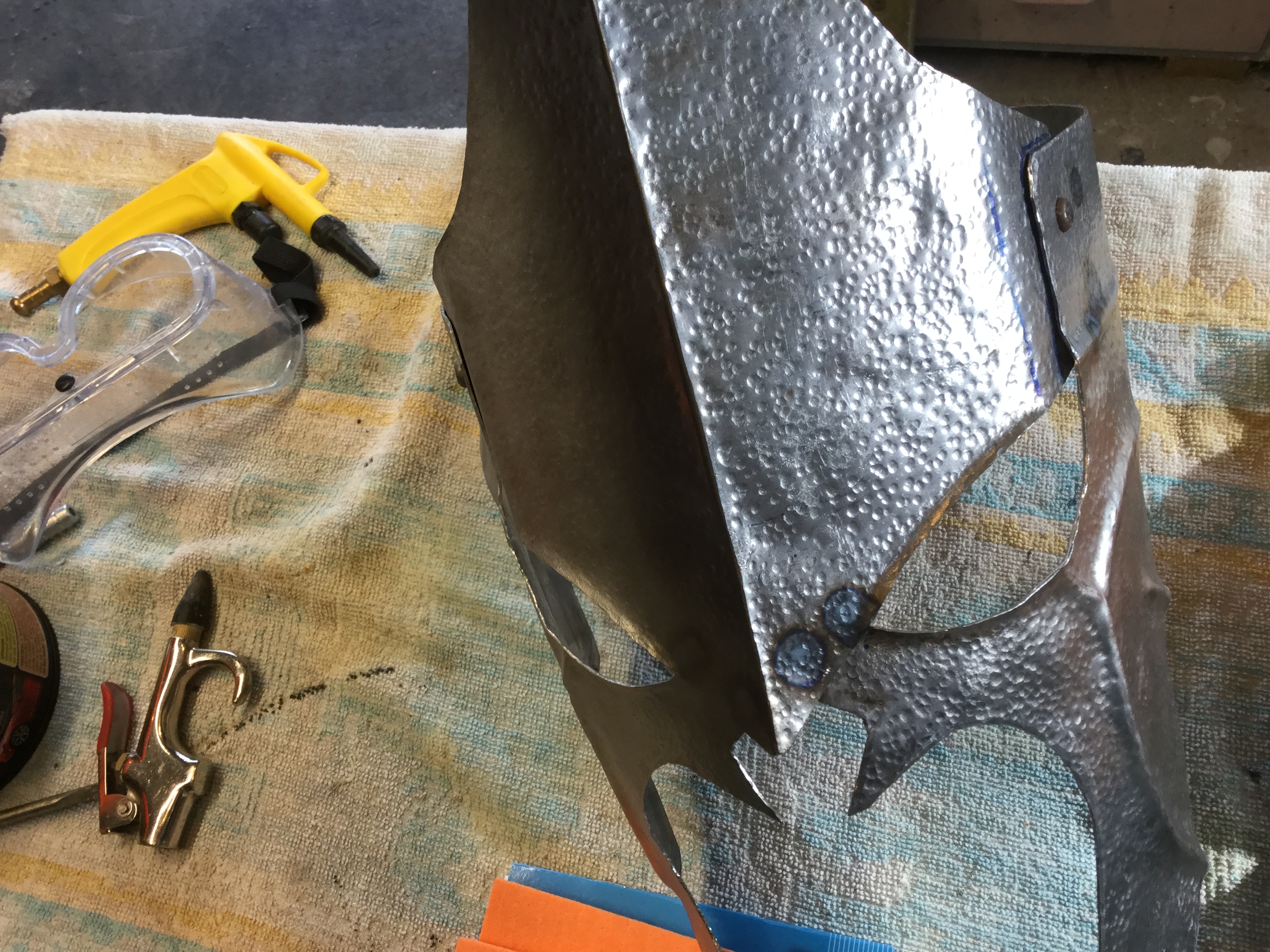

Every square inch had to be peened with a small ball hammer to give the sheet some texture. The surface didn't look busy enough when it was plain and shiny.
Next was getting the nose welded, followed by riveting the crown together.

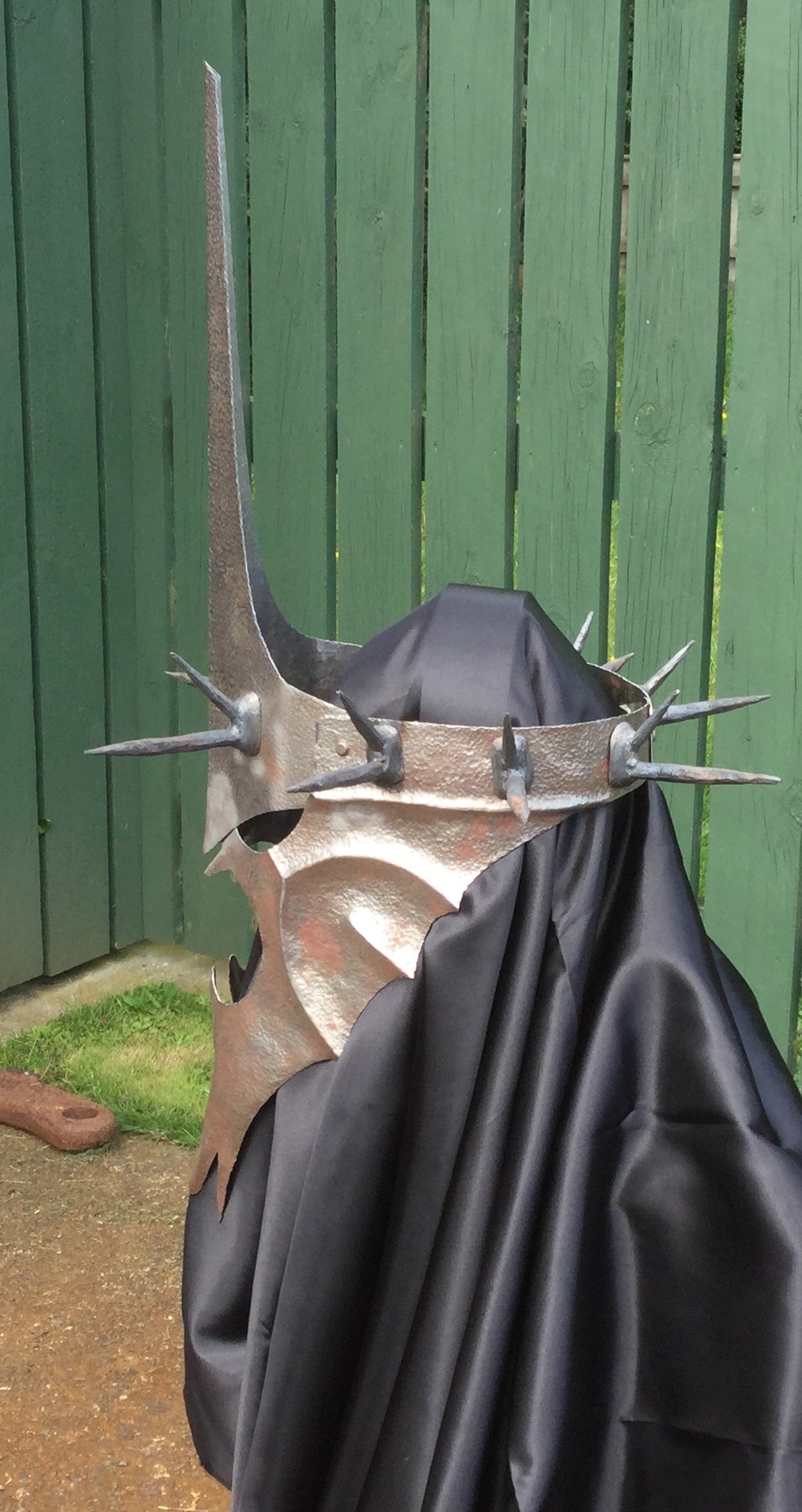

First test assembly. Still have to sand blast the sunburn on his nose, heat the spike bases to match the spikes, place the interior liner clips and then smoke-weather the whole thing.
But feeling pretty good about progress so far.

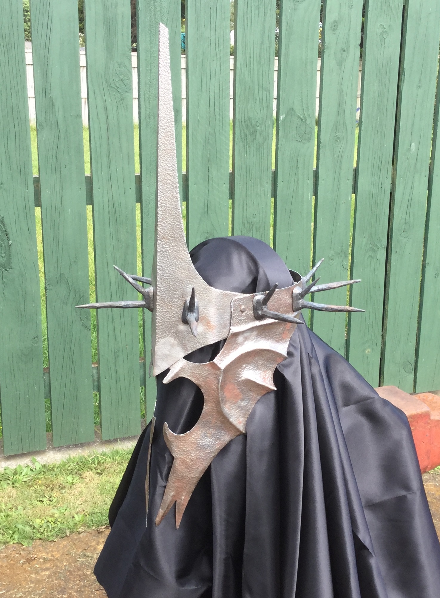

Now sand blasted the weld heat marks, heated the bases of the spikes to dull their shine, and reassembled. Next step is to use the coal forge for weathering, then mount on a display stand.
It's too heavy for easy wearing, so might have to make the next one with a view to ease of cosplaying. That will mean new templates and a new way of constructing. Should be fun.
