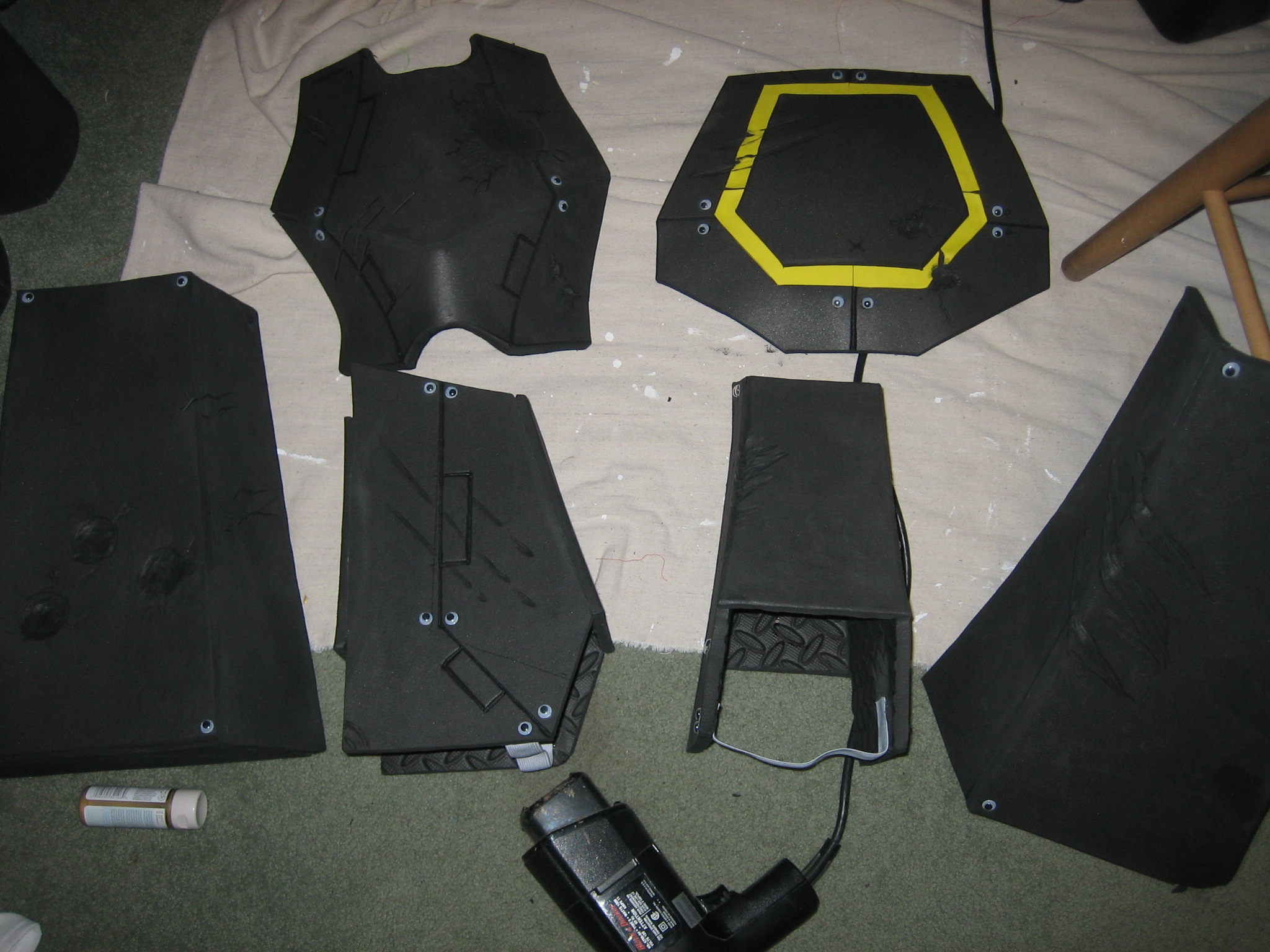

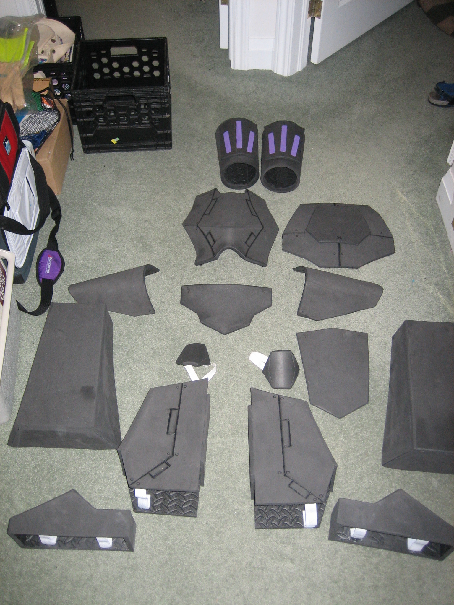

So this is most of the armour shaped and detailed through a combination of dremel sanding, and etching with a soldering iron/straight edge, getting ready for battle damage.
Here is some of the armour with battle damage and the first coat of 3:1 PVA/Podge brushed on. The googley eyes are meant to look like rivets after the plastidip/paint.

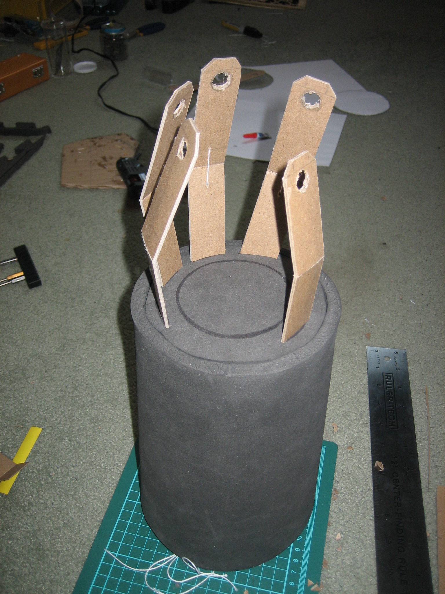

The fingers have string running through them like a tendon, and snap back to a mostly straight position thanks to a measuring tape core. It's difficult to explain but I'll post some photos on that process later. I don't have it photographed here but that circle in the palm is an insert for a small 3 inch blue plasma dis, to emulate an electrical attack.
This is probably the most complicated part of the build. I'm still really hammering out the design and function of these.

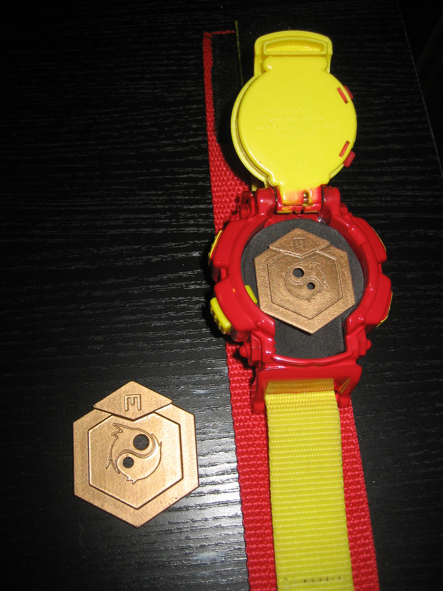

I had an old "bubble gum watch" which I spray painted red/yellow, and added an extra red strap to. The watch flips open at the push of a button to reveal a medacoin that I designed and had a friend 3D render then print for me. He made a slightly larger one to really show the detail, but the smaller one fits properly in the watch.
