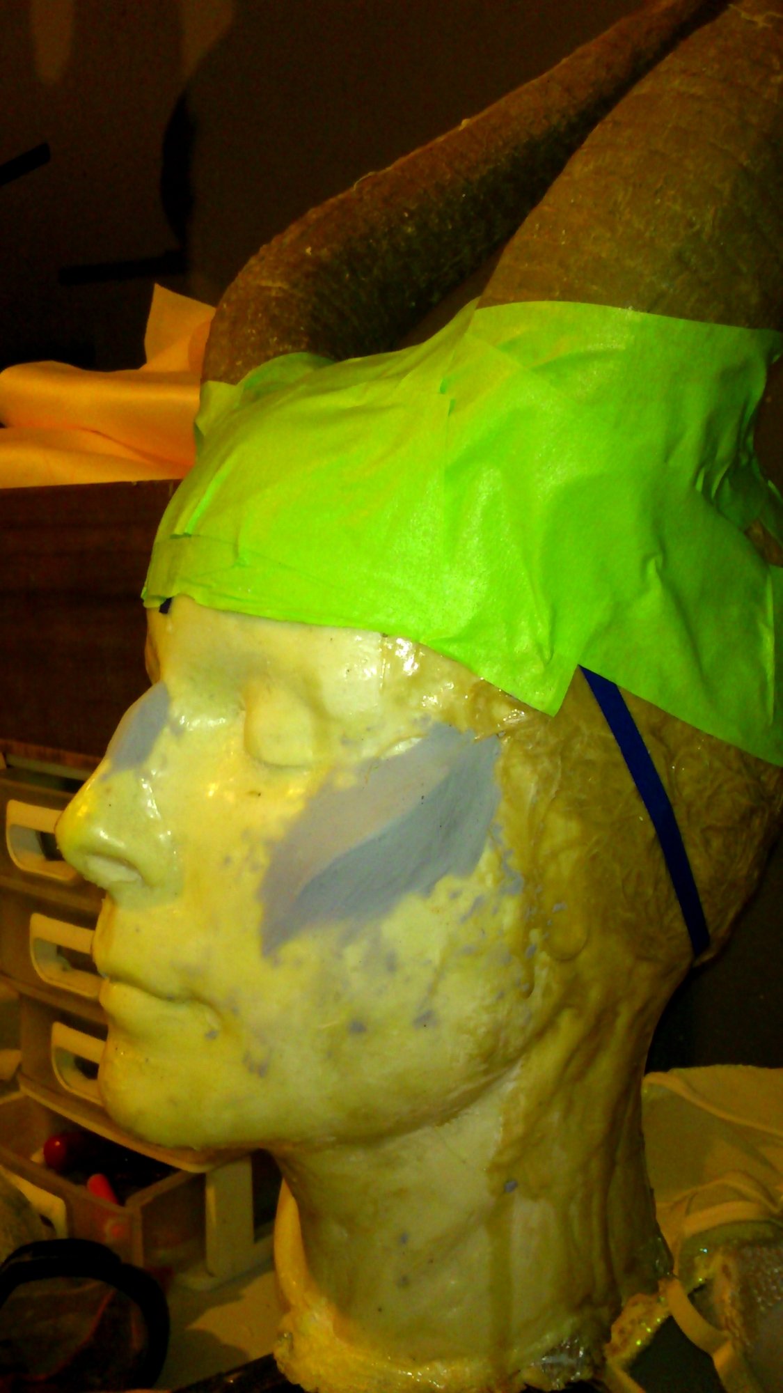

Currently waiting on my first layer of fibreglass to cure on my headcast. Very excited to get back to sculpting again. I'll be direct modeling in epoxy filler. Woot, just got back and my fibreglass is nearly cured, and the horns are cut back enough to stick them on :) Daily antihistamines have also meant I can work with the stuff :) XD
And one the horns are on I can also tidy the face and start sculpting the cheeks. Have not yet had the courage to attempt to cast my ears again. But I should.

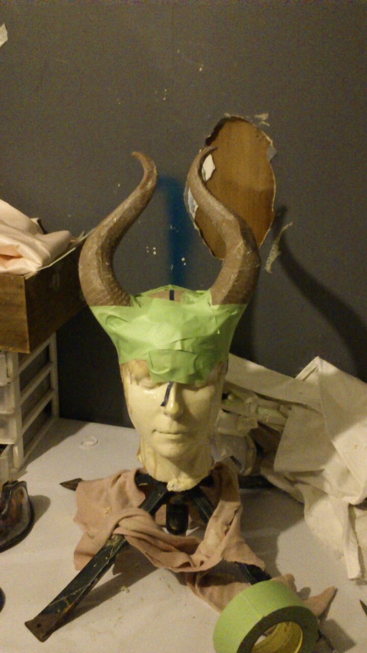

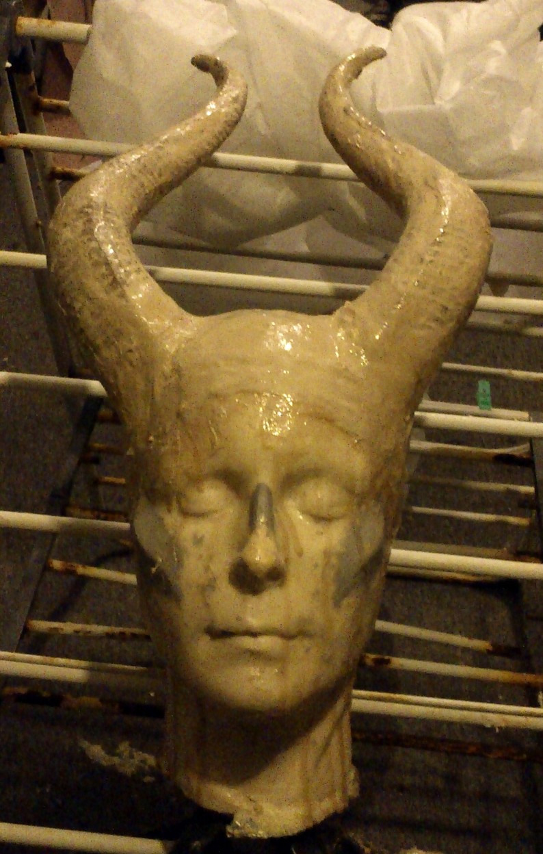

Got the horns glued in place ready for glassing! Testing cheek and nose prosthetics. They work differently to may be assumed :) The nose basically lengthens the nose, pretty effectively :) And the cheeks mainly sharpen not make them bigger.
But then when I glassed last night the right horn (on the left in photos) fell off and it took about 40mins to find a mix of cleaner and glue to hold it in place long enough for the now partially curing glass to bond and hold in place permanently.
But on they are and if I can work around this surprise virus (it may just be a head cold, still in that "every symptom is the same for every virus" stage) I'll start soaking the head in a bucket of warm water to loosen the PVA and thus all the glass. The prosthetics should float off but if I need to redo from start that is not a big deal either :)
Also I am waiting on the Winged Fairy doll to arrive and I suspect it will help a bit but not fully. But there will be a lot of silly business like this going on.

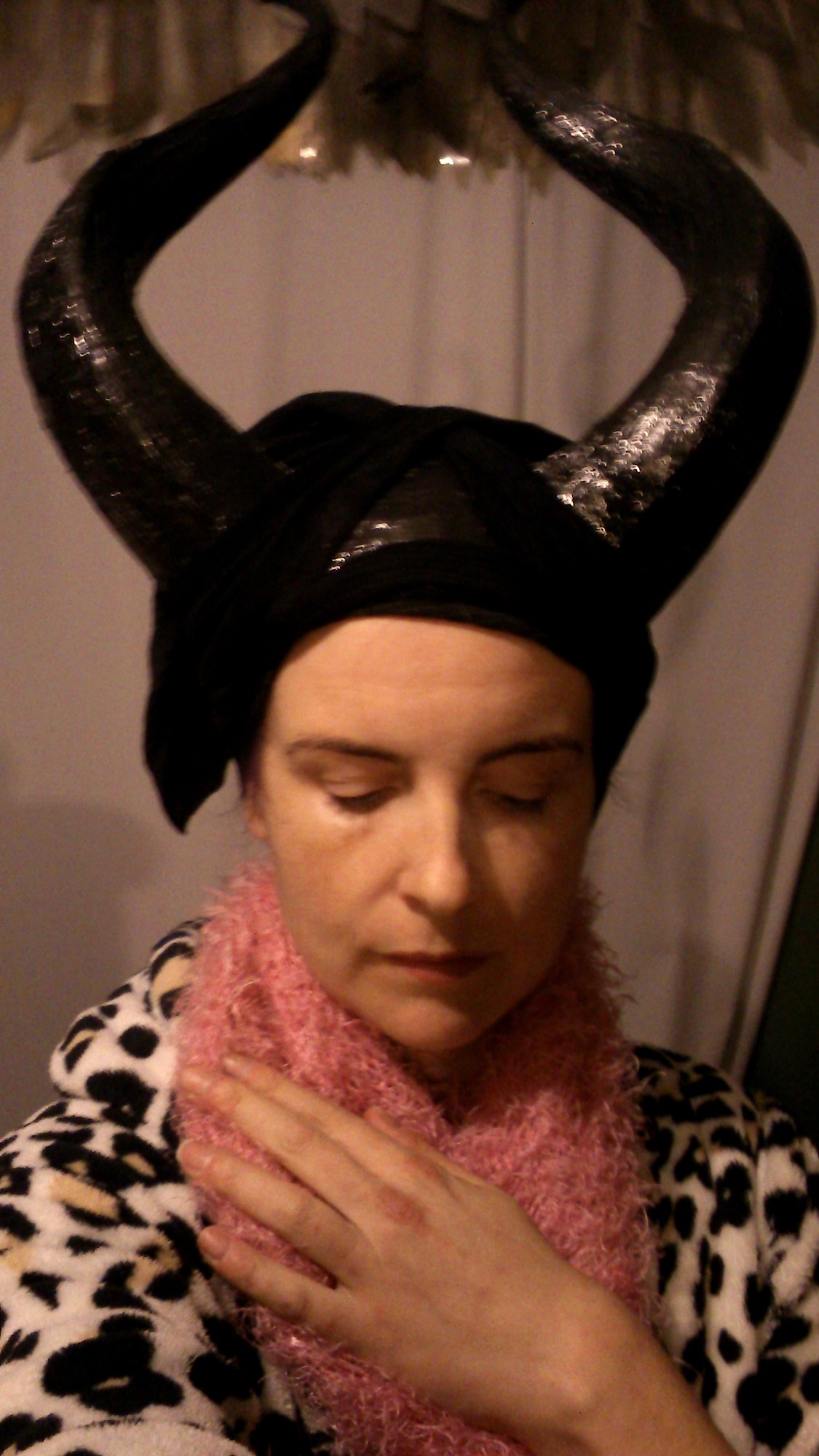

Started cutting the horns down to shape and to be able to be worn. I still need to cut a tiny slivver from the front and slightly more at the back and then vents in the top.
The left horn base is too heavy, but this is pronounced more in the photos due the the angle of the camera and mirror. And me benig shortsighted and unable to see what I was doing.
The horns hold on just with hair, though my hair is now far too short to pin over the top. I need a lace front wig for this “natural” look.
But I also narrowed the tips and made thoose curves much more pronounced, Hampered by my dust mask and goggles not cooperating so I couldn't see. I have a respirator with multi cartridges, just have to find it after a clean and disinfectant.

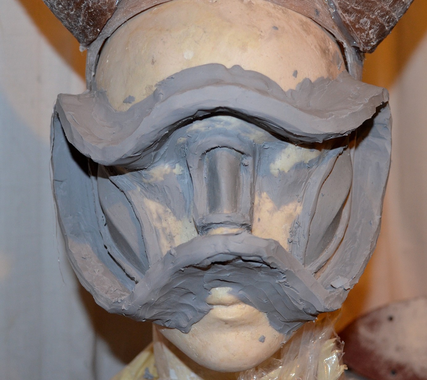

And those are the prosthetics almost ready to be molded. Almost I need to look at the things in daylight before sommiting. I may want to attempt some pores on that smooth surface. So I may be capturing my own skin. erg.
