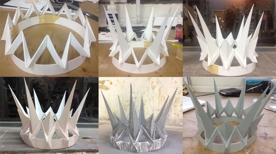

The first piece I started on was the crown. Its constructed out of styrene sheet, then covered in filler, sanded, 2 pac primed, more filler, sanding etc... The rivet details were fast cast half spheres I cast out and glued on (I think with death glue). Painting was a bit of a 'see what happens' process using a mixture of silver spray, hammerite, ageing spray, silver finger and sanding with some dark details added and rubbed in. Finally a sporadic layer of gloss was puffed over random areas to give it a beaten metal appearance.

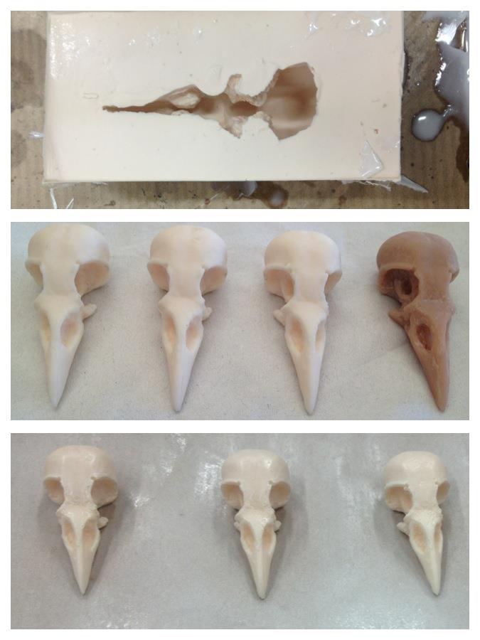

Skulls! Gotta give a big thanks to my co-worker and friend miss Emily Pooley for doing a scaled down crow skull for me. I gave her a real skull (that were all far too big for the corset) and she created a beautiful scale model for me, which I then did a silicone block mould for and cast out in fast cast.They barely need any tidying up, just a few holes drilled in and a puff of white primer and clear lacquer.

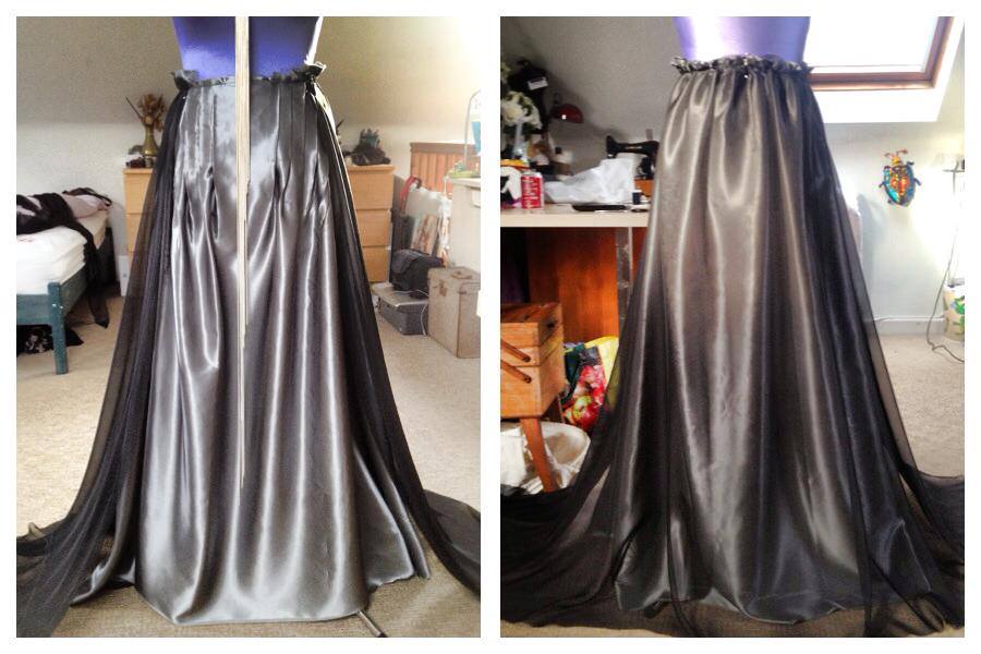

The skirts were made up of a hoop skirt, petticoat and then a silver silk pleated layer and a black chiffon with a lot of time spent on hand rolling all the hems.

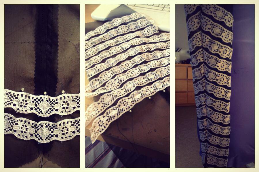

Sleeves!Organza silk base with a structural/decorative seam in the middle. Then lots of hand dyed/aged lace, cut, pinned and hand sewn onto the base of the sleeve.
All sewn up together and all the lace meets perfectly along the seam hurray! There was also a button sewn along each line of lace. The puff sleeves are silk organza. There's then a long flowing sleeve attached made of chiffon and a lot of beads... All the sleeve components are sewn onto the corset, so everything is just in two parts of top and bottom.

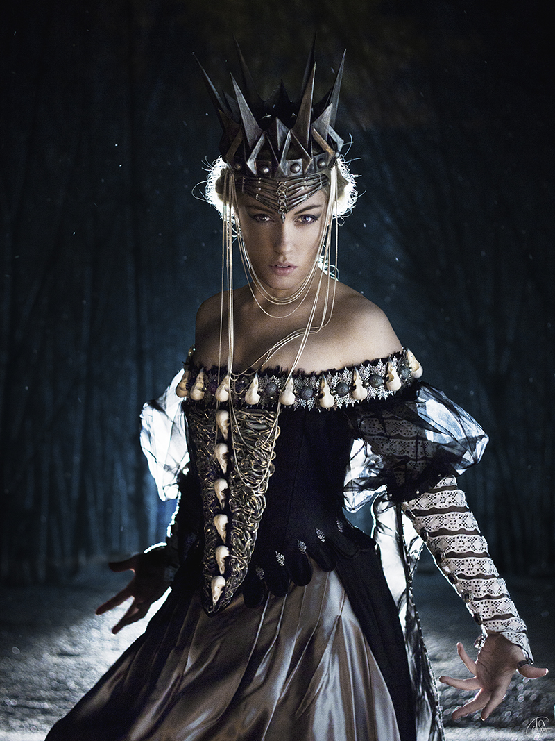

And then voila! You can see more about this costume on my Facebook page I've made an album dedicated to it here
