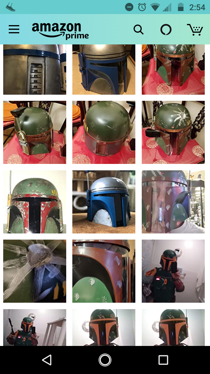

This is one I've been considering, although it take a lil work. If you go to the photo portion, you can see lots of fans converting it to Jango or their own custom Mandos. Seems like a good practice bucket anyway, but again if you're looking for something with lineage this probably isn't the option for you. I have some painting skills so I might be able to polish it up to resemble something more respectable until I can get more professional one

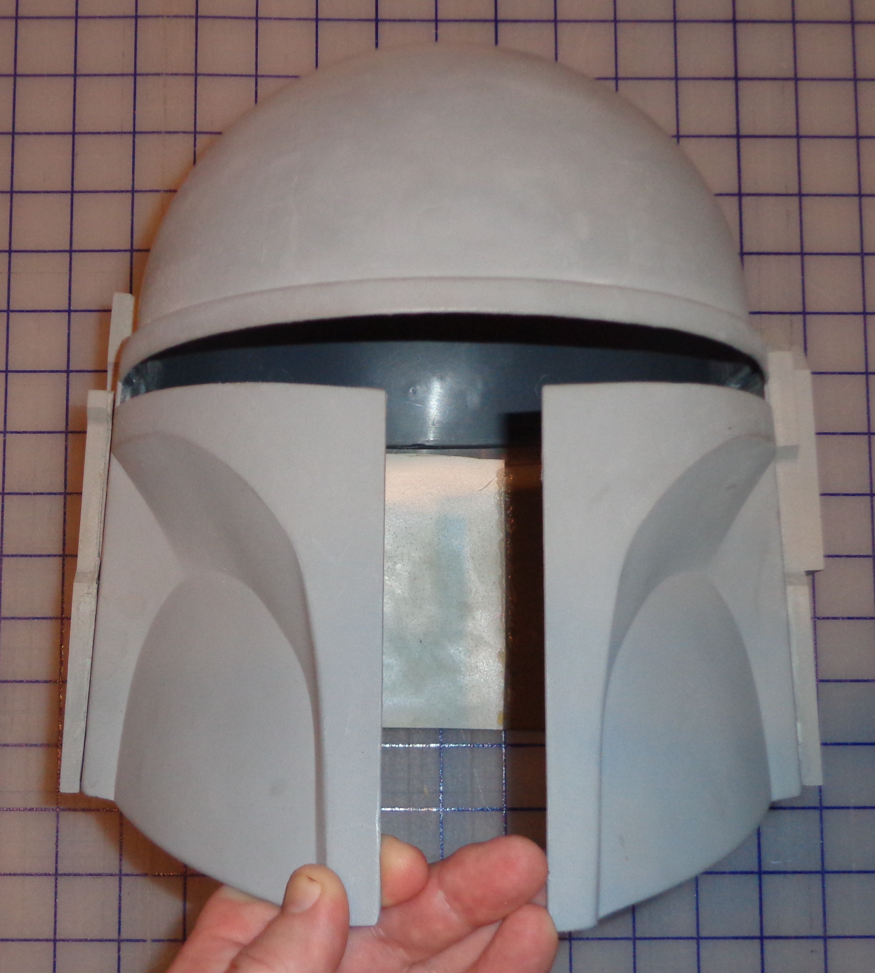

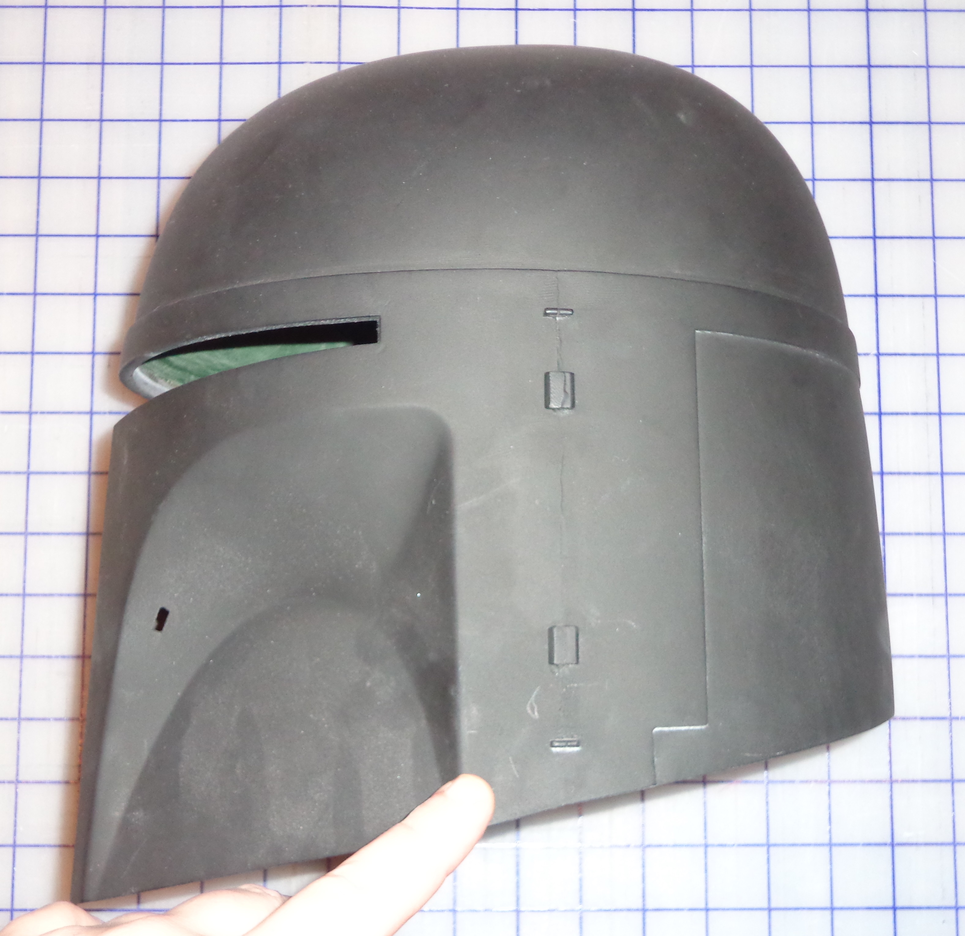

Ironically, for all the crappy stuff they have done, Rubies does still manage to get it surprisingly close from time to time. It's hard to find now, and there was production randomness that could impact what you got (some behaved perfectly, some refused to cooperate no matter how long you worked on them)... But their "two-piece" Jango helmet is very close out of the box. Glue it, reinforce the seams, use something to flatten the cheek plates, and sand it to give it a good painting surface, and you're good. The size is right and the detailing is really close. There are some fiddly bits like the keyslots and the rangefinder (and its earcap) that I am less up on, as I haven't made an intensive study of this version vis-a-vis dead-on accuracy. I just know it's somewhere between "pretty close" and "very close". At the very least, it'd make a good base to which to add accurizing pieces.
Inquisitor Peregrinus
It isn't. Jeremy Bulloch was 6'1" and almost looks like a bobble-head with that helmet on. Tem Morrison was 5'7" and the helmet is fitted to his overall frame better. The Jango helmet is about 5% smaller than a true 1:1 Boba helmet. Someone over on TDH some time back measured one with lineage and the 2-piece and the brow band circumference is a match. It might have been one of the early laser-scanned-as-a-starting-point helmets. I can see Rubies not thinking to make a fuss about that. It just makes sense. Heck of a savings on material, not having to mould and cast the thing. That it also doesn't risk damaging the original is a bonus.
I'll take pictures tonight of the two good Rubies Mando helmets -- the Jango 2-piece and the recent plastic Boba -- to show comparison.

I've seen them come out pretty much perfect with some elbow grease. But they are harder to find now, and there are good alternatives -- notably, posted upthread. This was more to show the size difference between Boba and Jango.
