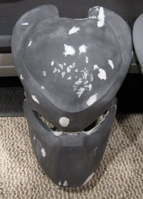

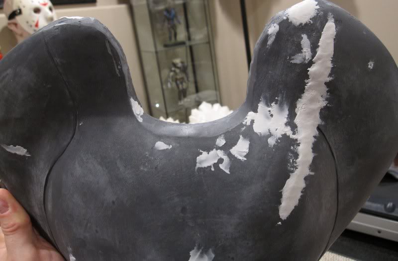

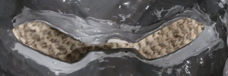

It had a bunch of small dents dings and some minor repairs that needed some filler. I used Apoxie Sculpt for anything that needed filling and then to reinforce the thin edges, I used Plumbers Epoxy. The eyes needed some re-constructive work, so the Apoxie worked perfectly and once it was sanded down, the eyes were as good as new again.
Eyes before Apoxie:
Eyes after:
The line here wasn't defined, so I did some minor dremel work. You can see how much filling the eyes needed by the amount of white Apoxie:
Bio after applying Apoxie:
...during the sanding process:

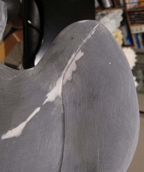

This needed some fixing:
After sanding and redoing the line with my dremel:
And how it looks now:
Great job re-defining that back fin flaw. The one thing that is wrong in the original mold that bugs me ..glad you were able to show how it can be fixed. Also glad you used the plumbers epoxy tip I gave you ..I actually used it on all the repairs to mine. If you use it in small amounts it has great workability, sets very fast and is rock hard in about 10 minutes, but sands down nicely. That dent in the forhead, however is part of the sculpt and not one of the mold flaws. Casey referenced me a different resin that Im now going to use in my further pulls. It gives me a little longer work time and gels in a way that the edges can be built up some more. I really wish there was an easier way of doing this, but the sculpt virtually ends at those edges ... so most of the time im building up the flash area to make it stronger ..only meaning that even when its cut, those edges need to be sanded to get that rounded look. Still havent decided how Im going to remold this yet ..I will probably use the plumbers epoxie to build more of an underlip around the edges.

Sorry guys - I forgot to include the fact that I had to use a heat gun on the gap between the eyes and the brow as it was warped. Hence why you see all the white filler in there.
Thats a kick in the pants. I wonder what they did when they made the screen used ones? I thought maybe your casting was taken out too soon before it was fully cured or that the mold was giving out on you. Weird...this is right up there with things that make you go hmmm...

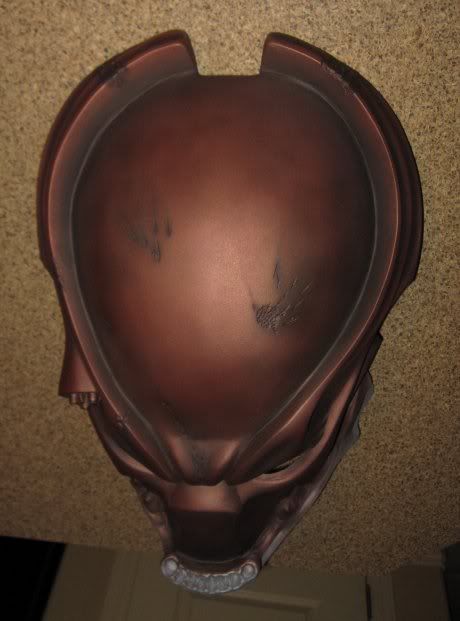

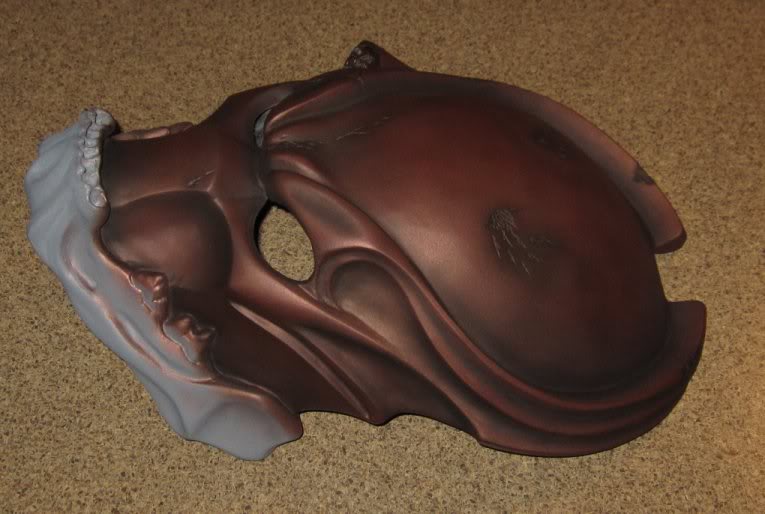

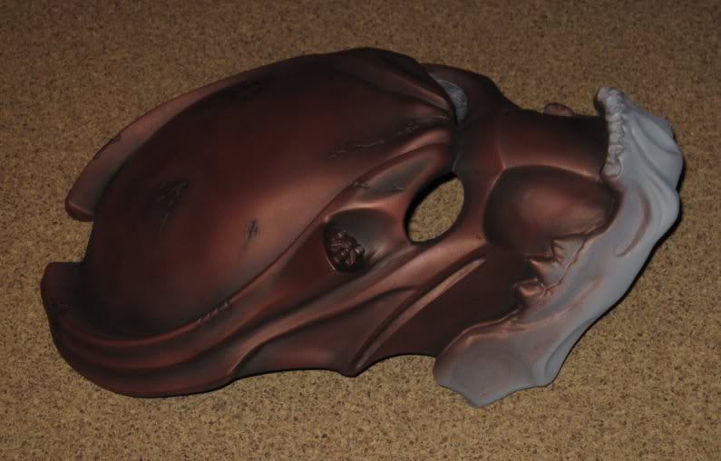

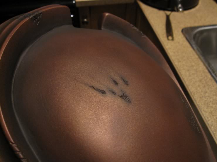

Well after a few repaints and mixing the colors to get it looking just right, I finally got the Bio done. Moving onto the jaw tomorrow...
