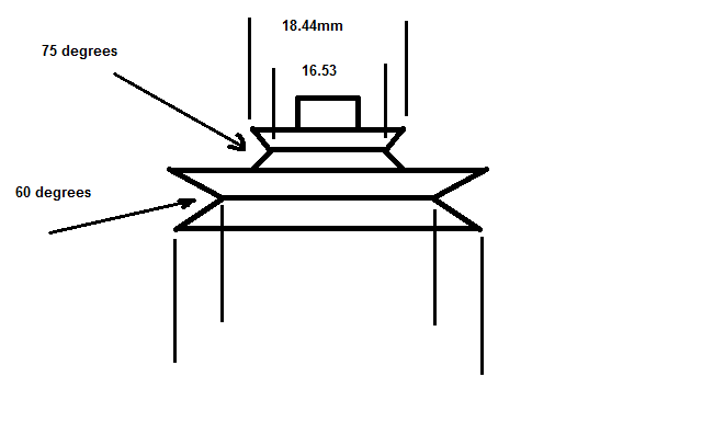

Are you talking about the middle ring on the piece I showed? All the dimensions are there in the photos. Width = 18.44mm Width of the middle ring with chamfer = 16.53 the height of the middle ring is 2.8mm. (all three rings = 7.67, bottom 2 rings = 6.29 and bottom ring = 3.49).

Chris, on the middle ring how wide is it wherever groove is? I will try and get an image up of what I mean.
OK not to scale whatsoever but here is what is going on with the rings - remembering we are talking about 1/10s of millimetres. The angle of the lower ring cut is 60 degrees and the middle cut is 75 degrees.
If you get these made the inner chamfered part of the ring will work itself out - due to the angle of the cut.

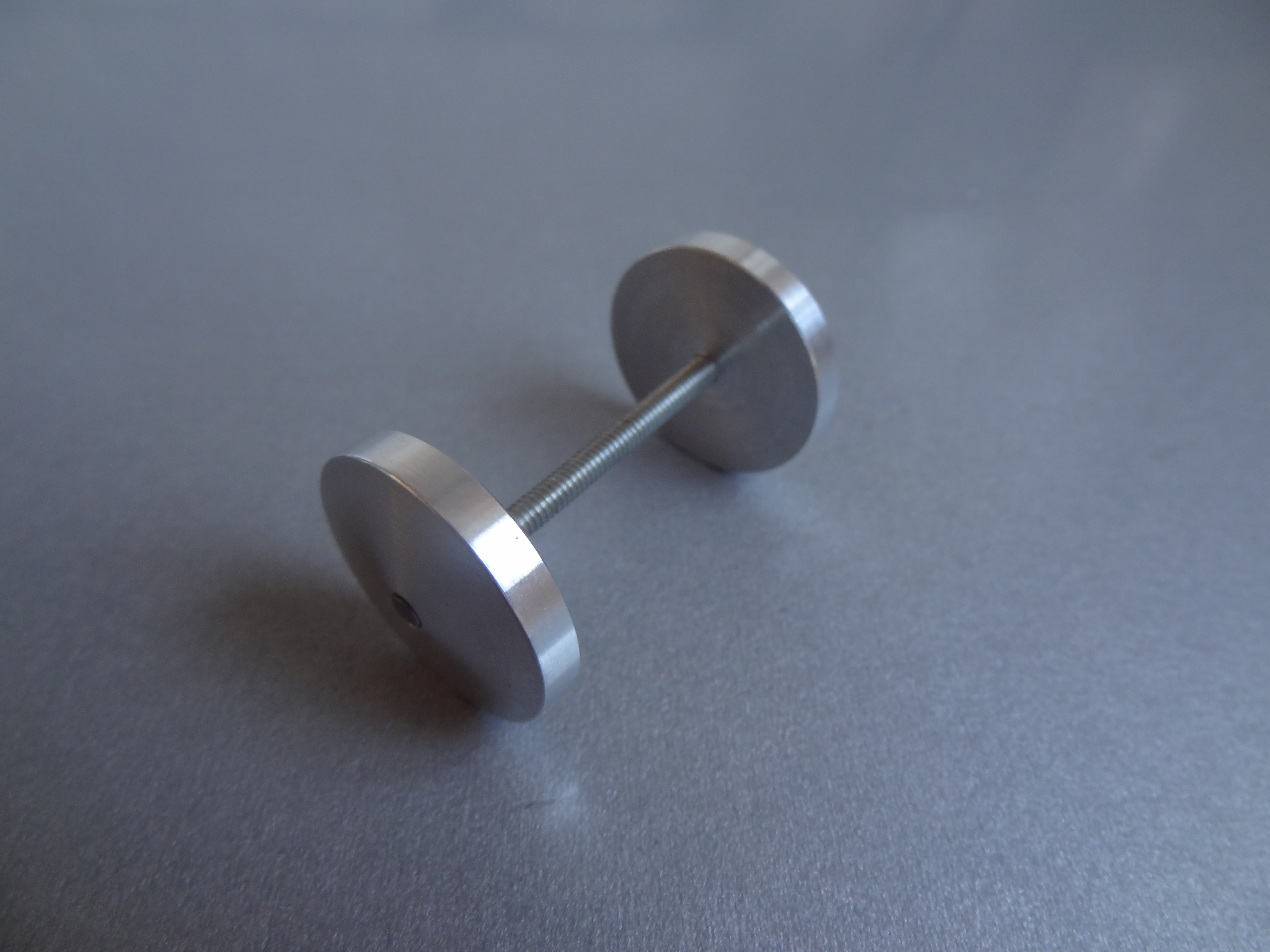

From putting my build together. I've got to categorically say the stylus brush base is not used on the sides above the trigger. It is the conical base from the sweep arm. The threaded rod from this fits the hole perfectly, you can simply screw this part together with the rod and two like discs. When you look at the reference pictures the hole in the middle of the disc is not large either.

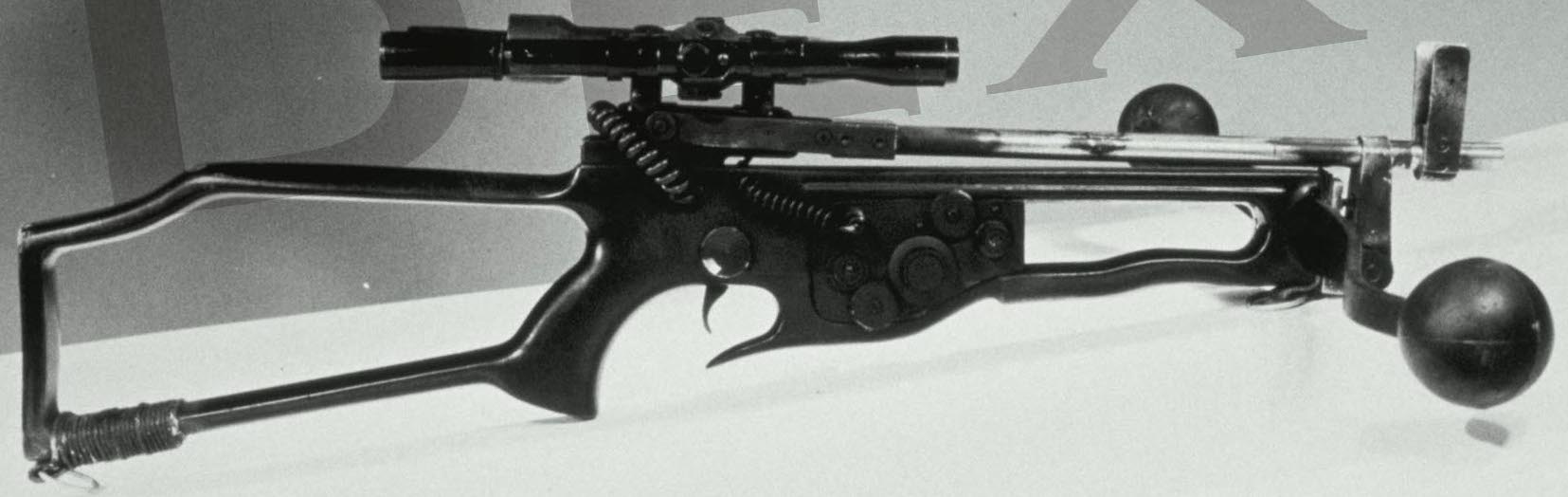

Hey, Marv? From your Michell-y experience, is the "knob" at the left end of the side plate on Boba's prototype Uzi-based blaster from a Michell turntable? Or just vestigially similar to the various swingarm bases?
--Jonah
I'd say it looks a little similar to the base from the type of stylus brush that the Boba Fett darts can be obtained from, but not convinced. Certainly not one from a Hydraulic Reference turntable.

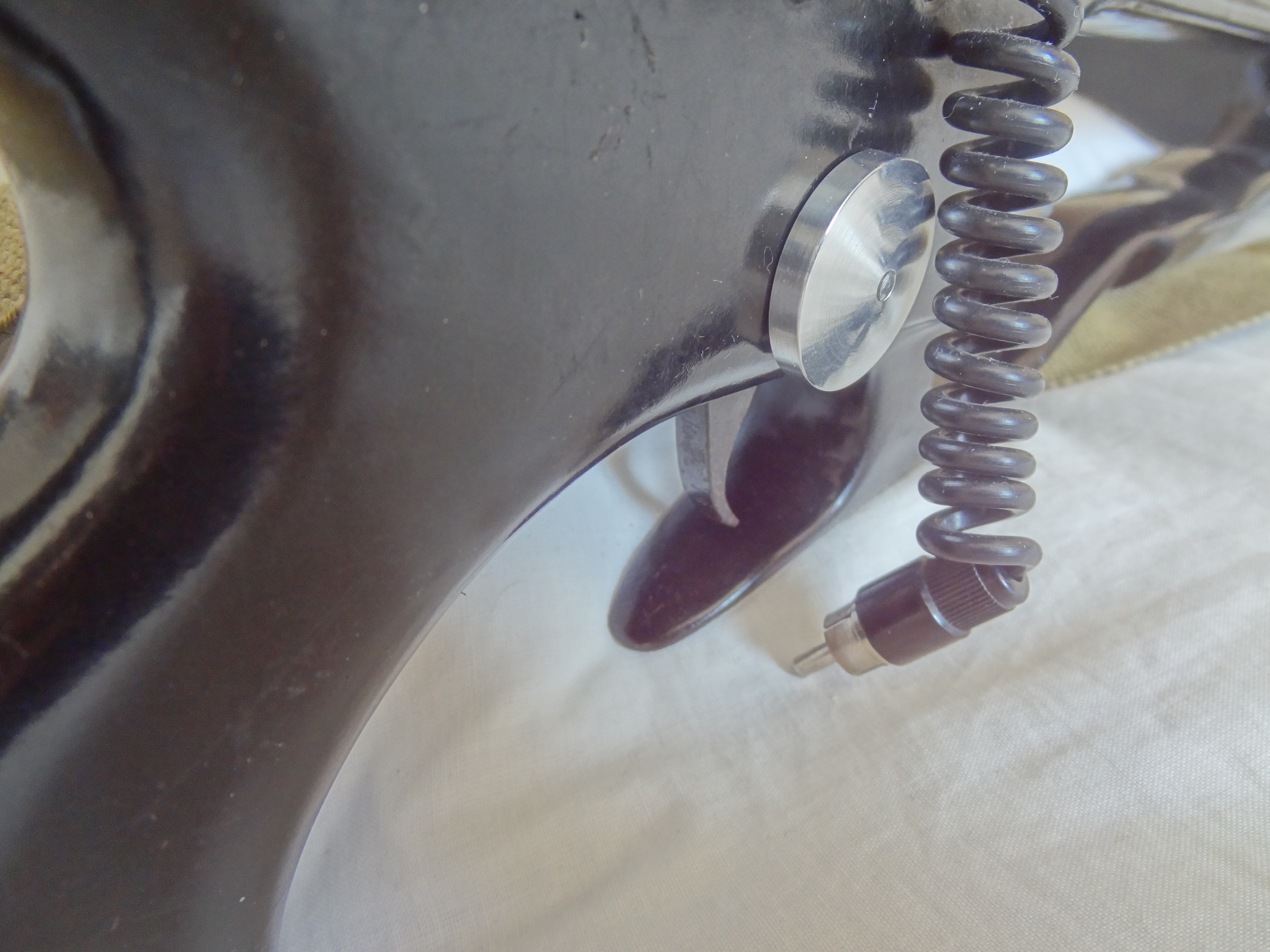

BTW Marv, the trigger discs are attached with dome head screws so the holes are covered.
View attachment 461615View attachment 461614
I not so sure that's the case when you see it from this side? I'm happy with my solution to this using the threaded sweep arm rod. It works from the point of view it fits the hole and obviously the discs.
On this shot you can see the hole is small too :)
I would like to know however what size screws you have used though, especially on the plates. The threading on the discs is a very old imperial size indeed, I tried using the screws I took out of an old Michell tuntable board and they did not fit!?
The other side is a little clearer and you can see the slot in the screw head. The same dome head slotted screws are used elsewhere but some also appear to be pan head slotted so it could be one of those.
Sorry, it's M3 that seems to fit some of the discs, not m3.5.
