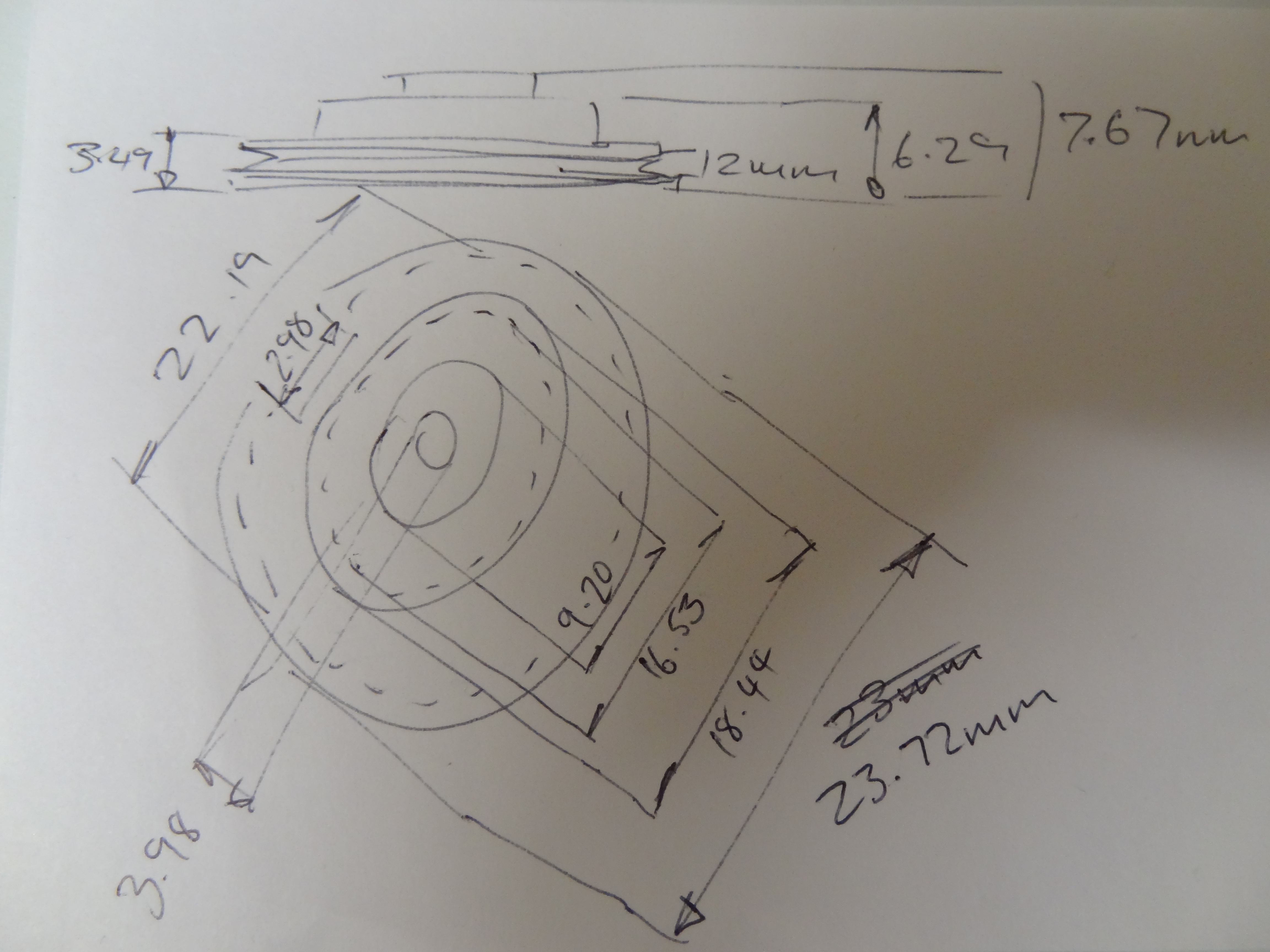

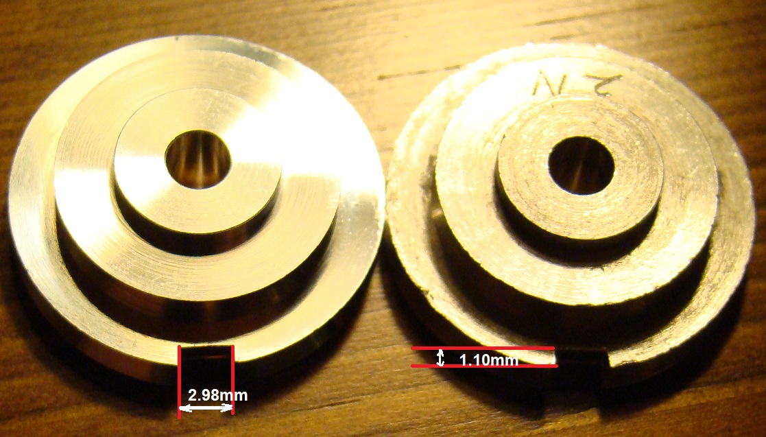

Is there any chance you could put up a couple more pictures of some measurements round the middle ring, am I right in thinking that the combined height of the bottom and middle ring is 6.29 Total height being 7.67mm
Also is the central hole threaded?
I don't suppose you would have access to the other discs used which could be measured up. There is a small firm here in my local town may be able to knock something up for me? These figures work out nicely in imperial. I think its an old boy who has the machine shop so may be right up his street?
This is how I'm seeing it from your pictures?
Just noticed what depth does the recess go to on the bottom ring where its 2.98 mm wide.
The centre hole is not threaded - it was a pulley on the turntable that turned on a spigot / spindle with belts.
Unfortunately I don't have any more photos the ones I posted were old photos I found on my hard drive. The discs I had made was quite some time ago.
Both the lower and middle ring have recesses in them as belts sat in these grooves. Your drawing has the middle ring as flat.
If you look at my side on pictures you will see what I mean.
All the sizes including the groove depth are in my photos.
Yeah I realised I'd done that on the middle but I couldn't clearly tell what the measurement were on this to include them. Also which of the pictures do you mean has the depth, I think I must have misinterpreted something here?
Yes sorry the notch depth is 1.10mm

OK, found all my Michell parts and have them sitting beside my PC. I'll measure them tomorrow night.
Fairly accurate. I've gone with his for officer and pilot helmet greebles. His are right about an inch in diameter, so slightly overscaled to the originals.
I measured my Elvistrooper discs (low detail and high detail) and compiled against the measurements in the photos earlier in this thread.
All measurements in millimetres.

        Real            Elvistrooper
Outer diameter:
        23.72           24.2 - 24.5
        18.44           16.85 - 17.1
        9.2             9.5 - 9.7
Diameter inside groove:
        22.19           22.5
        16.53           15.05
Thickness:
        3.49            3.07
        6.29            6.14
        7.67            7.67
Hole diameter:
        3.98            4.26
