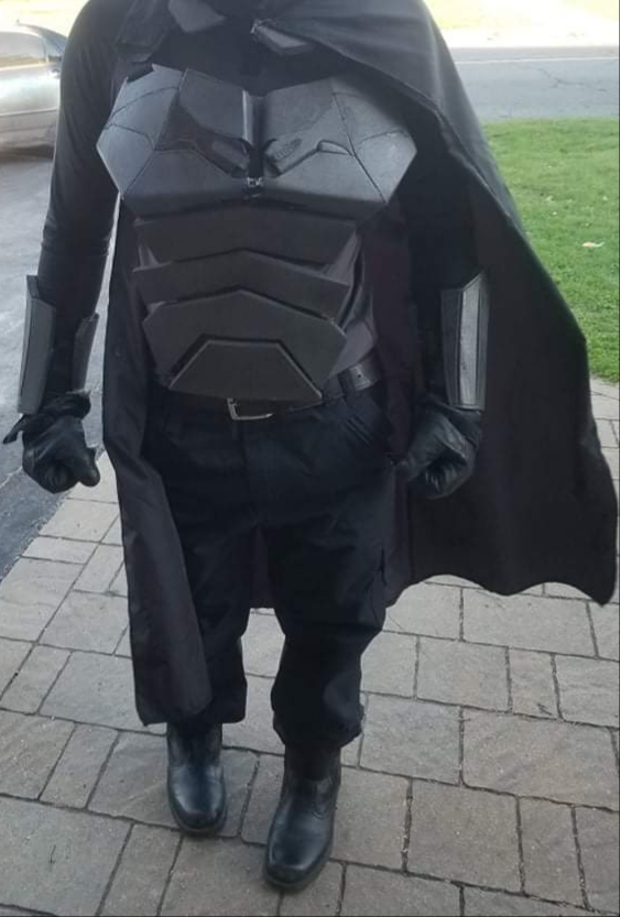

Hi, Last year I made a batman cosplay using eva foam based on the Pattinson movie which I didn't get to finish unfortunately but I'll include a picture of. I want tp reattemp it using the molding and casting technique which I've seen a lot on the internet and the results seem visually better. The thing is that I don't know Jack about it. Especially in the material department. I've heard some people mentioning polyurethane, silicone, resin, latex, fiber glass, or sometimes mention them but they call them "liquid", latex foam and more. So which am I supposed to use for cosplaying? Or does it depend on what am making? If am making let's say a red hood armor or a batsuit, do I use the same material to cast the whole thing or does the helmet/cowl require a different one? If yes, are there other pieces of the cosplay that require a different material? Does the props so too? What about the mold? Am I supposed to use the same stuff for both the mold and the cast? Please enlighten about this whole making cosplays by molding and casting things!
Your help will en appreciated.
Ps: Before anyone says that it's too complicated or that it's too soon for me to try. Well everybody starts somewhere. Also, after accidentally destroying my foam torso pieces last year and having to redo them over 10 times I am patient enough for anything
