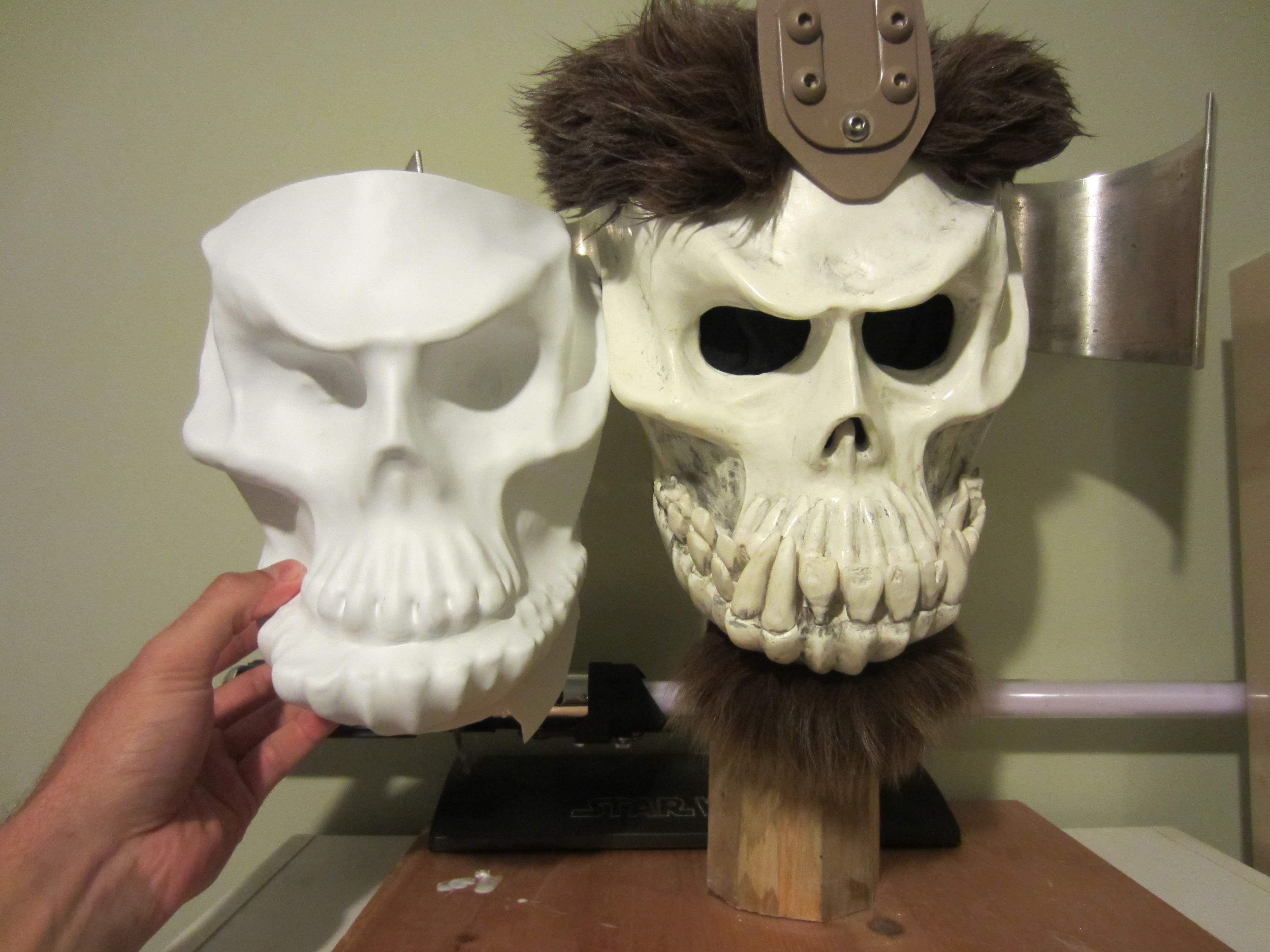

I have recently decided to try my hand at vaccuforming. I am vaccuforming with a shopvac of 5 HP and the thickness of the styrene I use is .06 '' I set my oven at 300 F and let the styrene bake for 2m30s. When I get the styrene out of the oven I quickly put it down on my model and start the vaccum.

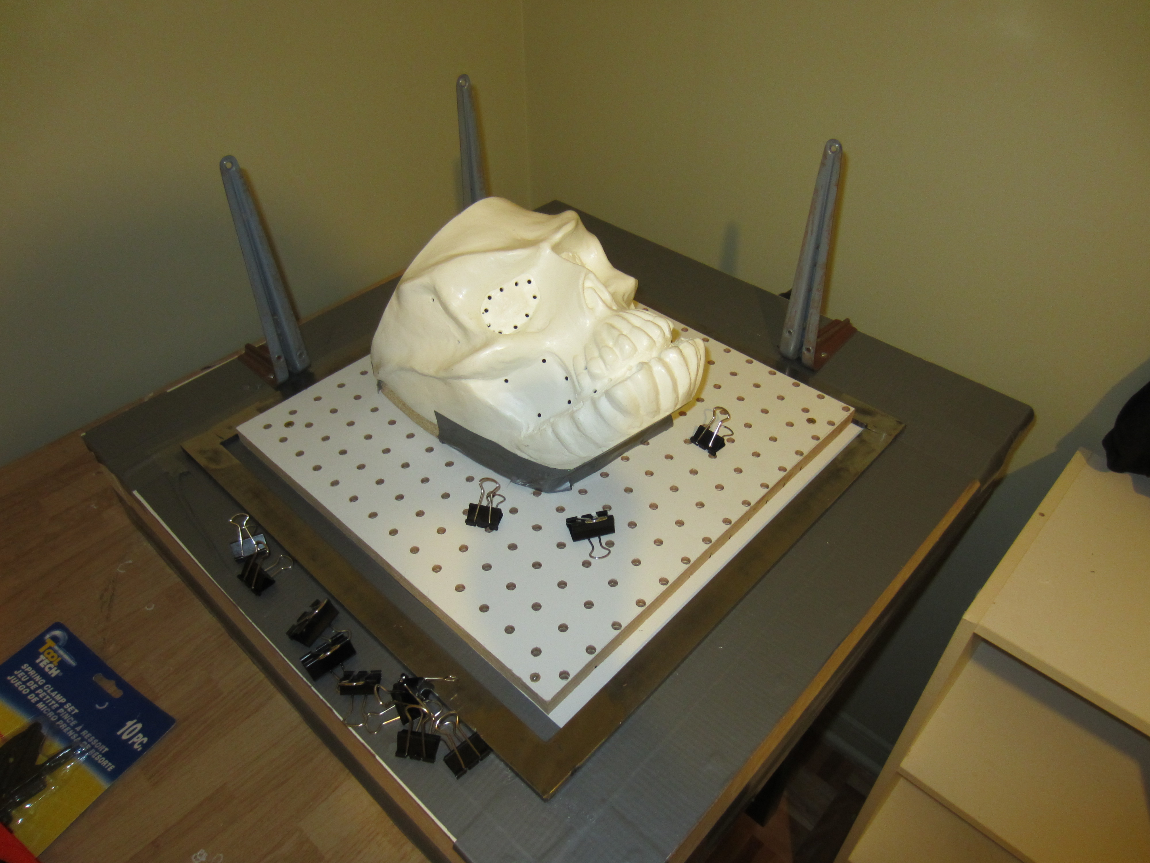

I have joined one picture of my vaccuform table and the other picture show that my vaccuform mask as a lot less detail that the one I have rotocast.
It seems to me that my shopvac is not strong enough. I know that I can get a 6.5hp will it make a big difference or should I look elsewhere?
I dont want to use tiner plastic because the mask will be to weak.
By the way, the teeths are cast seperately :lol
Any help would be apreciated :)

I use a stronger shopvac with my vacuformer and even use .080 polystyrene but you will always have less detail while vacuforming. It is best to use this method with objects with less detail.. Best of luck:)

Most of the time when pulling something with that much detail you'll need to drill some small holes in the recesses of the larger areas. In this case it would be between where the teeth are placed.
I think you nailed it. I use a motor that will pop 0.1 abs and still get bad pulls when I dont ad holes to allow the motor to draw air from high detail areas. I also usually hollow out the bottom so that the small draw holes have direct access to to the table holes this usually works pretty well.

I would guess that if you're using those little paper clamps to hold the styrene between your frames, you are losing some suction when you press down. I generally use two 3/4" thick MDF frames that are screwed together in several places.
It doesn't take much to lose enough suction to cause the problems you are having.
Thanks for the tips guys! I have already drilled holes between the teeths it dosent show well on the picture. I will try to heat up the model a little bit.

Boy, a 5 hp is pretty good. Mine is a 2.5. If you can't get better results by the above heating, other etc. suggestions...I think you need a second stage vacuum source.
I know a guy that uses two 6hp shop vacs to improve results. Better is to buy a vac pump on line or a manual hand pump is available at many auto parts stores. You will need a one way sump pump type valve from a hardware store. That prevents air from competing with the flow to the shop vac. Install it on the platen side of the valve and switch off the vac after it has pulled to max depth and finish with the hand pump. Other options are a more expensive electric vac pump and there are ways to rig an air tank so you have the air pre-evaccuated so it will suck air in when you open a valve.Any bicycle pump also can be made to work; just plumb the former to the inlet instead of outlet ...that is the only difference for a vac versus a regular air pump...direction of air flow. having said that ,everyone elses comments still are valid. If you want to use thinner plastic you can reinforce the reverse side after pulling with glass but not practical for production runs...you didn't say if it is "one-off" or not.GOOD LUCK!
