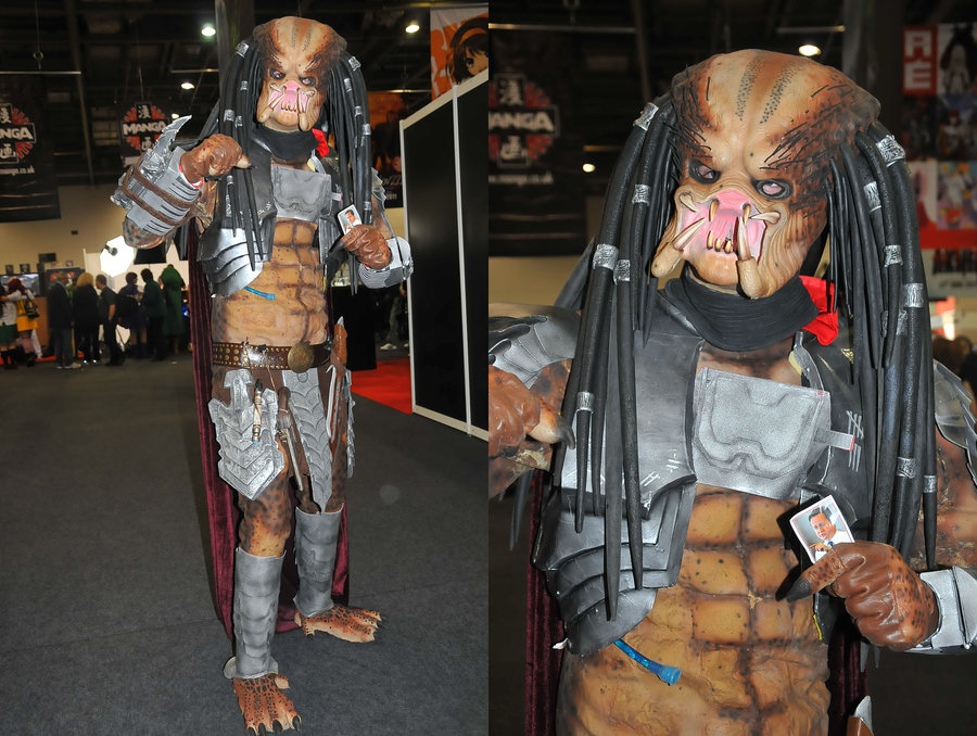

and a super cheap method - cutting black foamie sheets into hair thin strips, and cut edges a second time till its fairly round ( a little octagon at the base)- then rolling it till its rouneded.
Cathat
thats my method XD ... it really dont look bad if your trying to do things on the cheap
you should be able to see it on this pic
hope this helps but casted ones do look better
