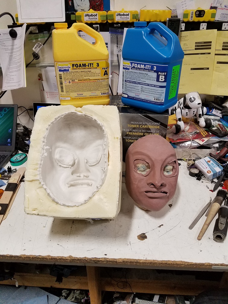

I have used plasti-paste from smoot-on, and I have also used their Foam-it series, rigid foam, but one small thing with using foam, mixing and temperature is needed for full expansion, its rigid and very light. I will post some of my pictures of what I have done.
Here is Face and silicone ( mold max silicone tin) with outer mold with rigid foam
