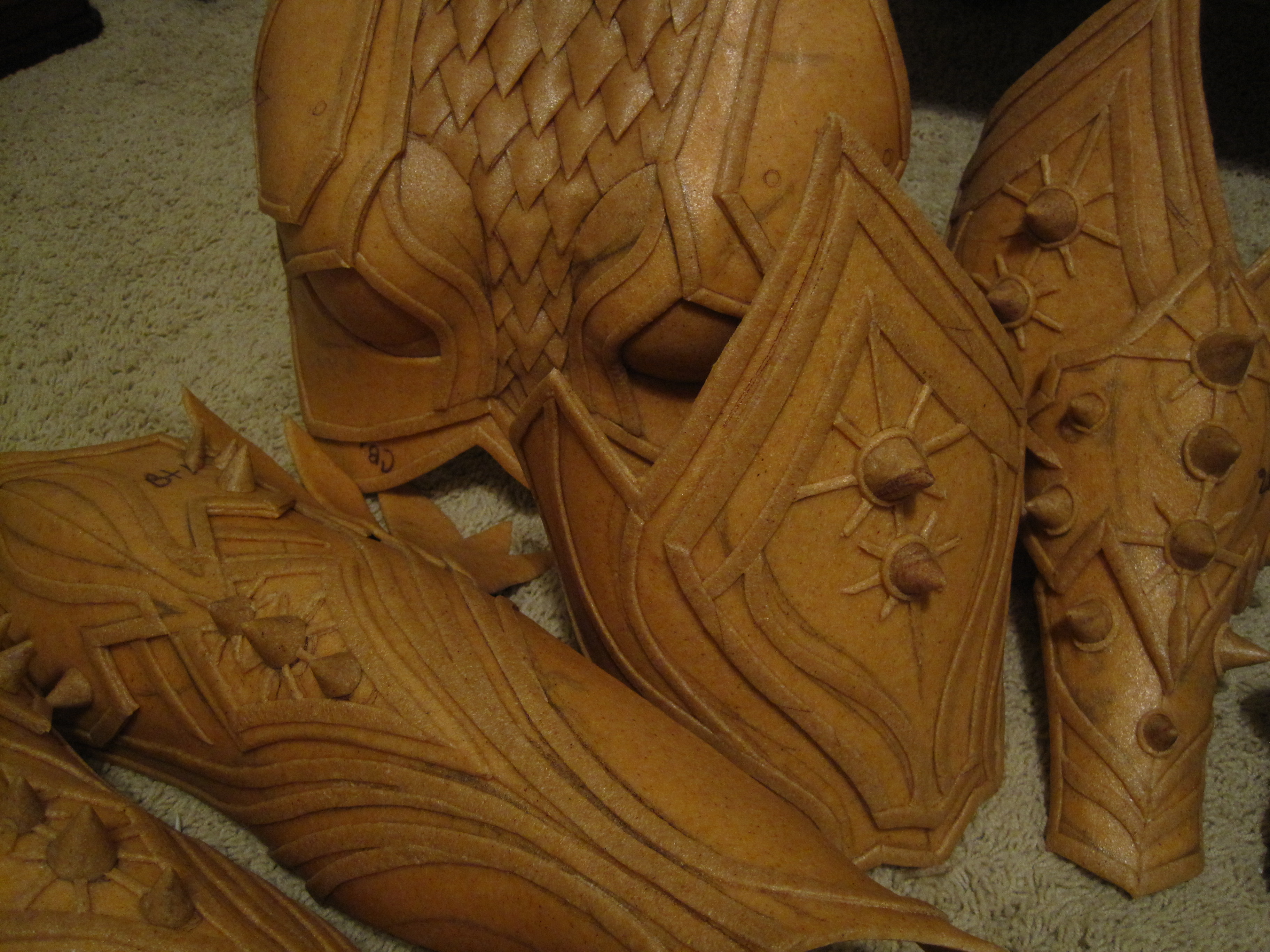

So the holidays really shut me down on progress, but I was able to get a few hours of armor detailing. Details are strips of Worbla, straightened and tooled with a pair of scissors while hot. One of my favorite things about Worbla is the fact that scraps can be heated and smushed into a "clay" of sorts. All of the spikes are made this way.
The details are taking me years, but will hopefully pay off after the paint job.
It might have taken you some time, but the details looks simply amazing :O Awesome job spring :thumbsup
