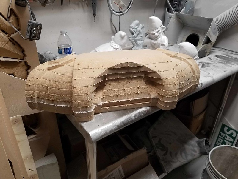

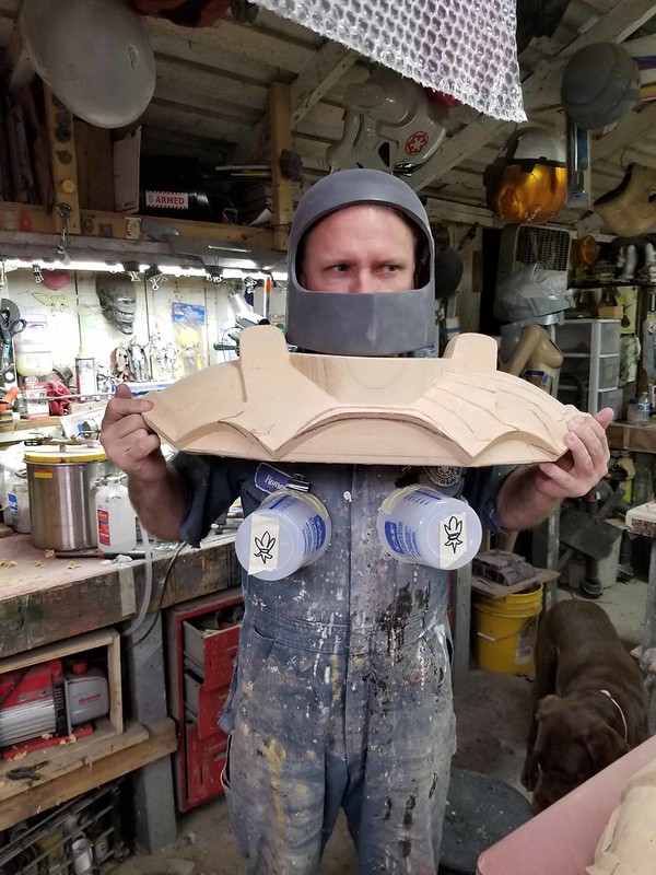

The digital models were sliced up and fed to my CNC machines. The machines whittled the slices out of MDF and I then glued them up in the real world like so:
After a bit of sanding and filling, they looked pretty good:

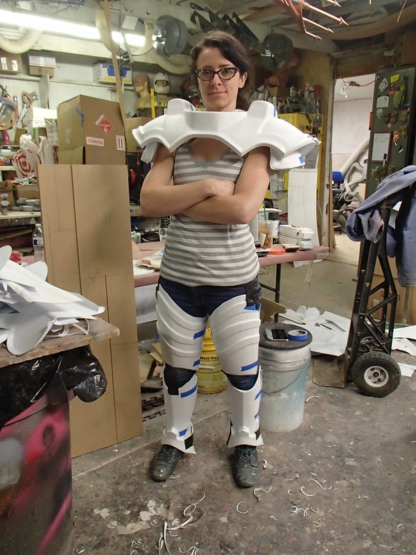

The next step was to lay out the collar/shoulder parts and the lower sholder plates on the forming table:
The first pull came out pretty good:
Though I'll freely admit, it looks better on my friend Madison:

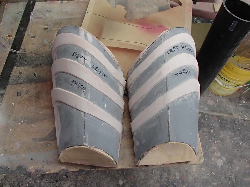

The thighs started out as a particularly heavy fiberglass pair from my Captain Phasma project (Link https://protagonist4hire.blogspot.com/2019/02/building-captain-phasma-part-2-armor.html) that were trimmed a bit before I added the ridge details with Bondo:
After the Bondo work was completed, I split them into front and back halves, mounted them onto some plywood, and sealed up the open ends to make them into vacforming bucks:

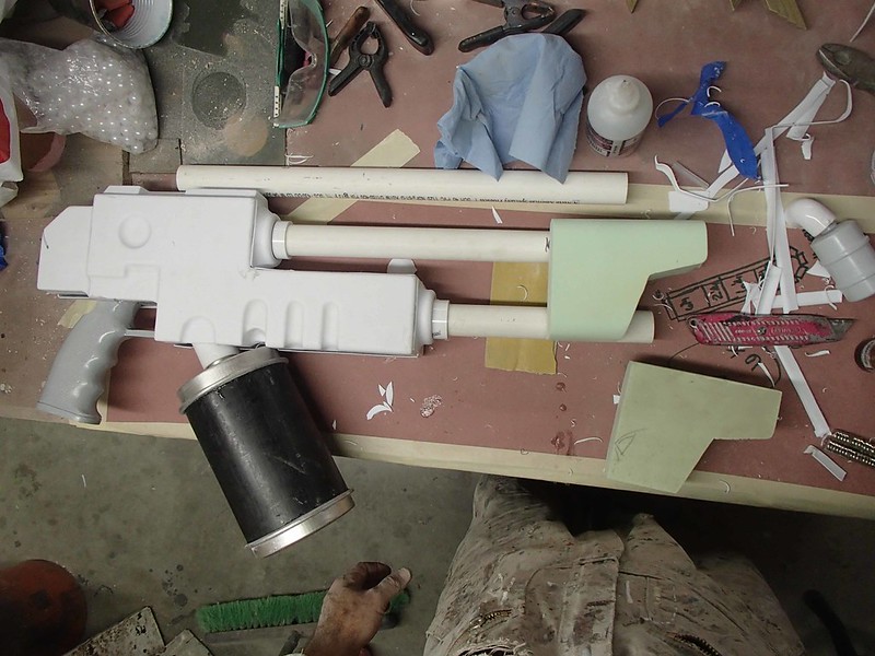

The next step was to make some weapons. I started by having the CNC machine cut out some profiles:
Then I layered on some details and sculpted out a pistol grip:
The grip was designed so I could mold it and cast it separately and use it for all of the different weapons I had in mind:
Once the shells were vacformed, it was just a matter of gluing in the resin cast parts:
The muzzles were resin cast details, but the magazines were separate vacformed parts.
The flamer was made in largely the same way:

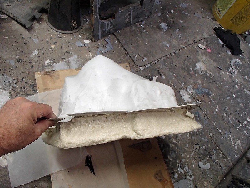

This was filled with rigid expanding foam:
Then the plastic was peeled off:
The chest was sawn in half from top to bottom and a slice of 3/4" MDF was inserted in the middle to make the piece a tiny bit wider and stronger. Then I took a saw to the boobs:

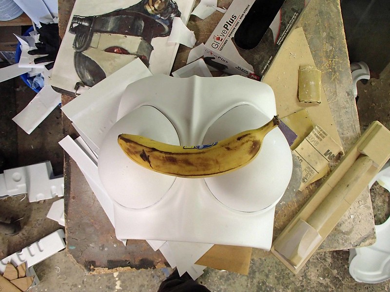

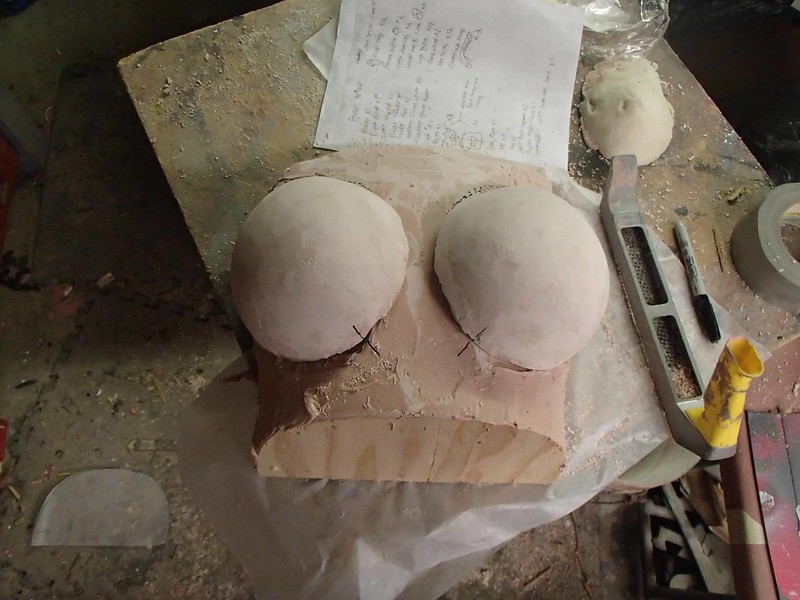

The cups themselves would be vacformed separately to make the parts easier to remove from the forming bucks. In this case, they started as styrofoam hemispheres skinned over with Bondo and reshaped a bit:
Once I was happy with the overall shape, I cut out some 1/4" MDF in the same shape, offset by about 3/16" larger. These were glued in place before the final smoothing for the chest buck:
The vacforming went as well as I could've hoped:
My assistant Rachel cut out the boob windows:
The cup parts were glued in from the inside, making for a pretty sturdy assembly:
Banana for scale.

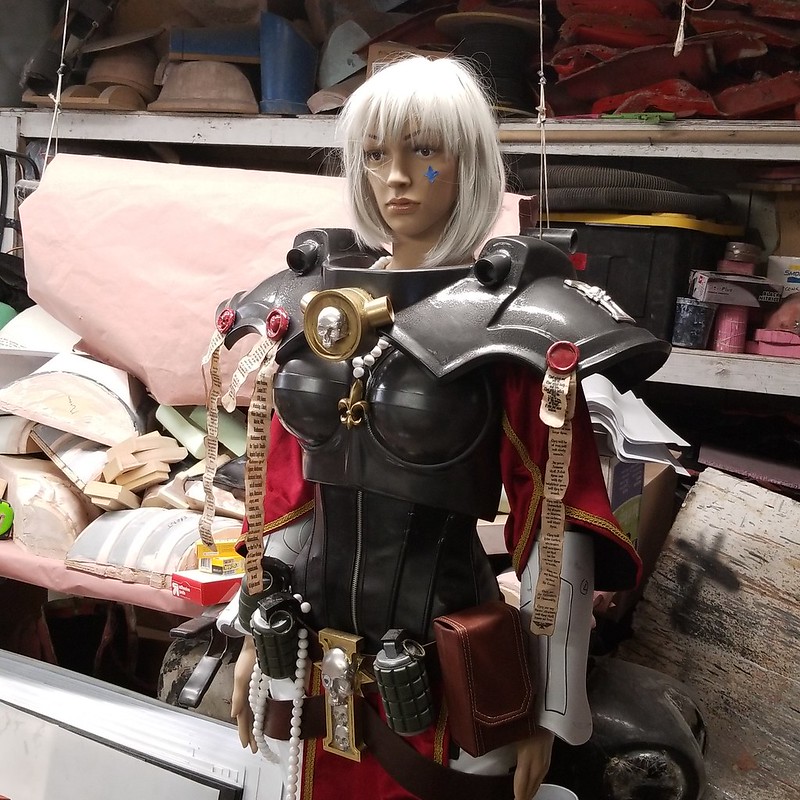

We were also regularly dressing up the mannequin in the shop as we made progress:
She was starting to look like something.

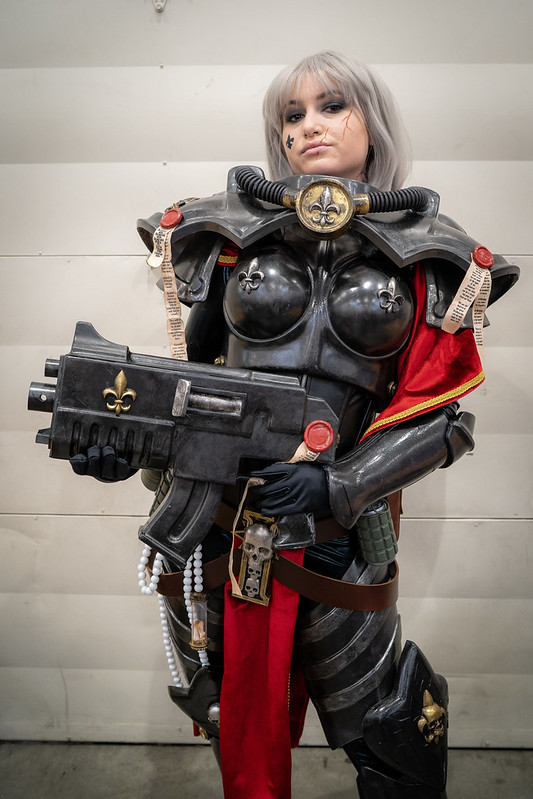

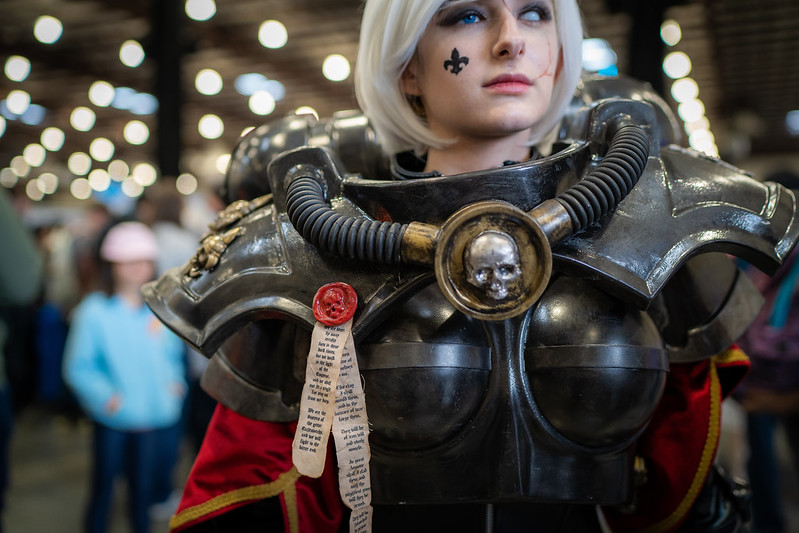

The base garments were all picked up on Amazon. Started with this catsuit: LINK These boots: LINK and this simple corset: LINK. We also picked up a variety of short wigs. Some silver, some white. Once it was all combined, it made for a great look:
Because we were up against a tight timeline, we ended up putting the final blackwash on the parts the morning of the event. While the rest of the crew was assembling the display booth, Rachel focused on final assembly and weathering of the Sororitas armor:
My friend Sierra strapped everyone into their gear:
As with any complete costume, the final step in putting these together is makeup. My cousin Amanda came along for the weekend to do everyone's scar effects and she did a great job:
We were strapping the girls into the armor just as soon as the paint was dry. The first completely assembled sister was my friend Madison:
Of course, that pic doesn't do anything to showcase the costume. Here's some better shots:
The next completely assembled sister was Danielle:
Third was Rachel (left in this pic):
The next day we had Mallory too:
For the duration of the Bay Area Maker Faire, I had three sisters dressed and walking around at all times:
