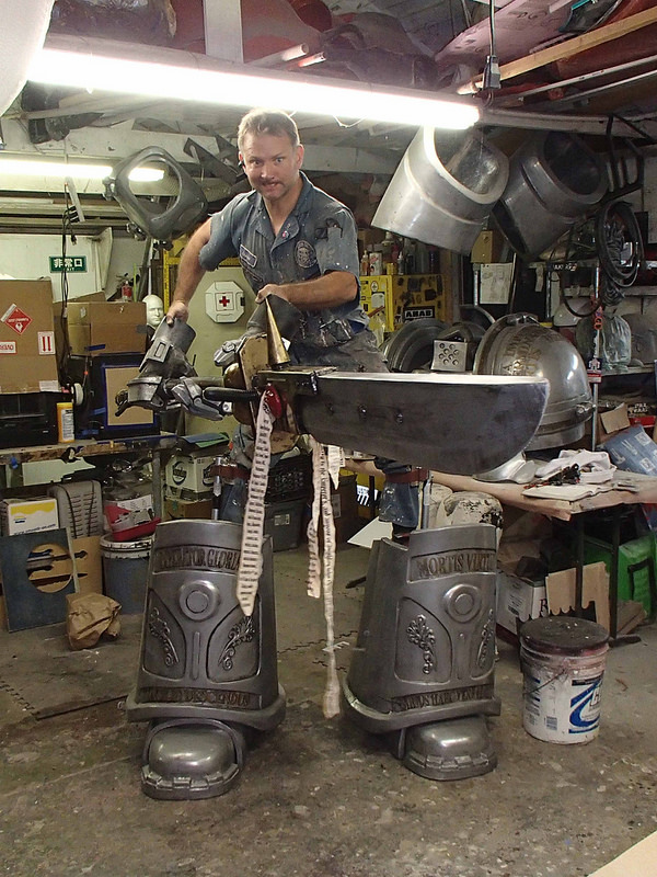

Did another quick rigging test with the stilts:
I think it'll work.
The kid in the armor in that pic is about 5'3". Maybe a bit shorter:
In fact, we can almost fit her into the shin if she kneels:

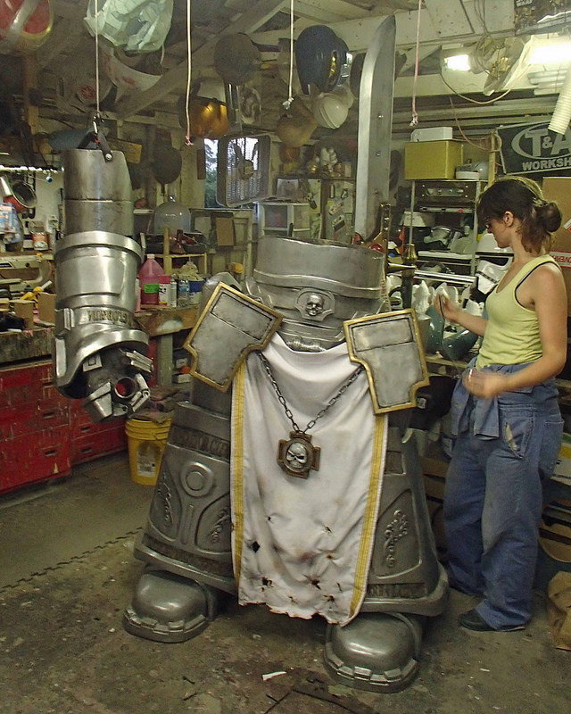

The back of the lower legs were fitted with plywood flats to allow them to bolt onto the stilts:
These were fiberglassed into place with the shin plates clamped on to ensure that everything would align properly once the glass had cured:

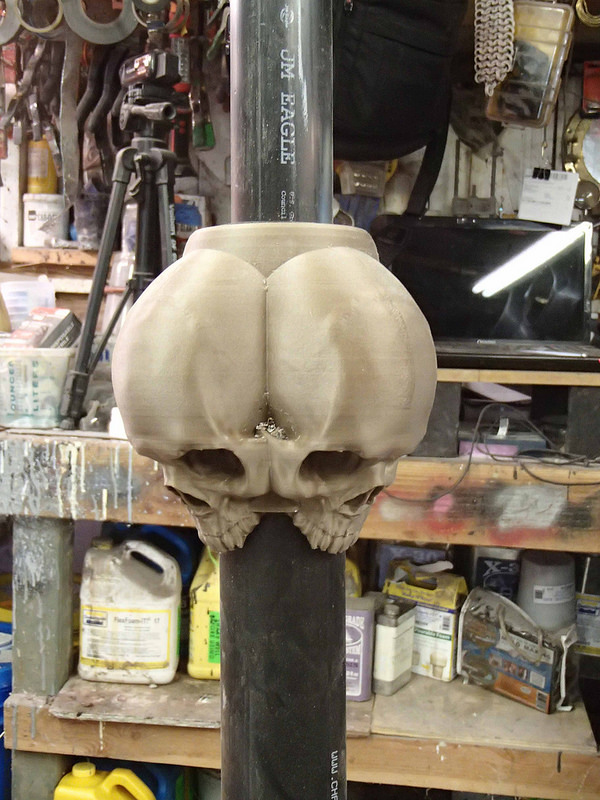

I also sculpted out a quick and dirty belt buckle detail with the help of a 3D printed skull:

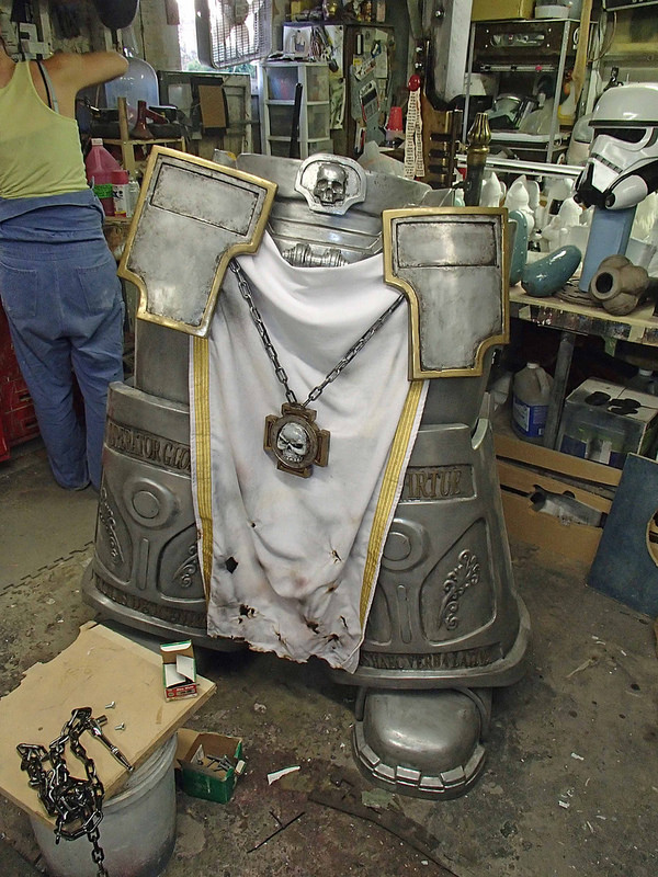

With all of the lettering in place, I could finally get a start on the weathering. For this project, it was just a simple matter of a quick blackwash to bring out the details and dumb down the chrome paint to look more like old, well-polished steel, while tarnishing the gold to an appropriately old look as well:
Then Madison picked out a few details on the hands with flat black:

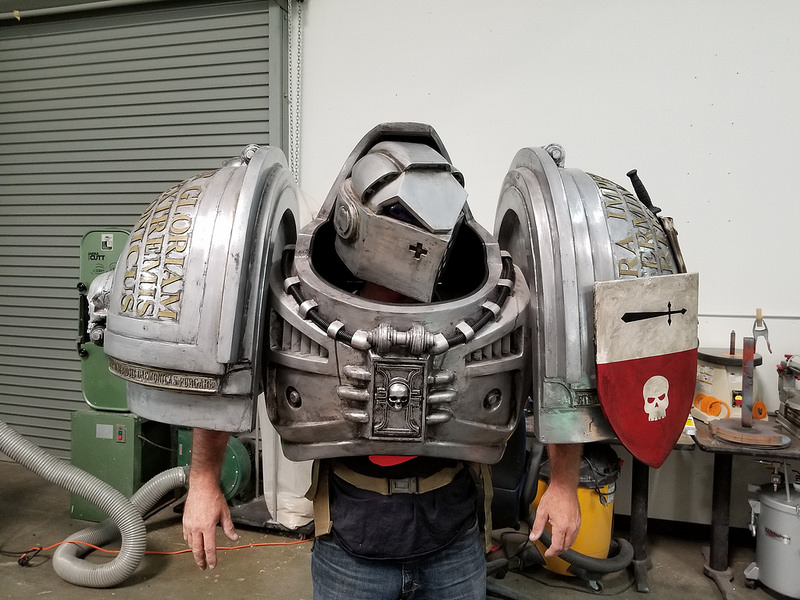

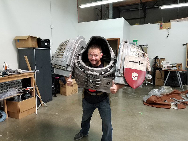

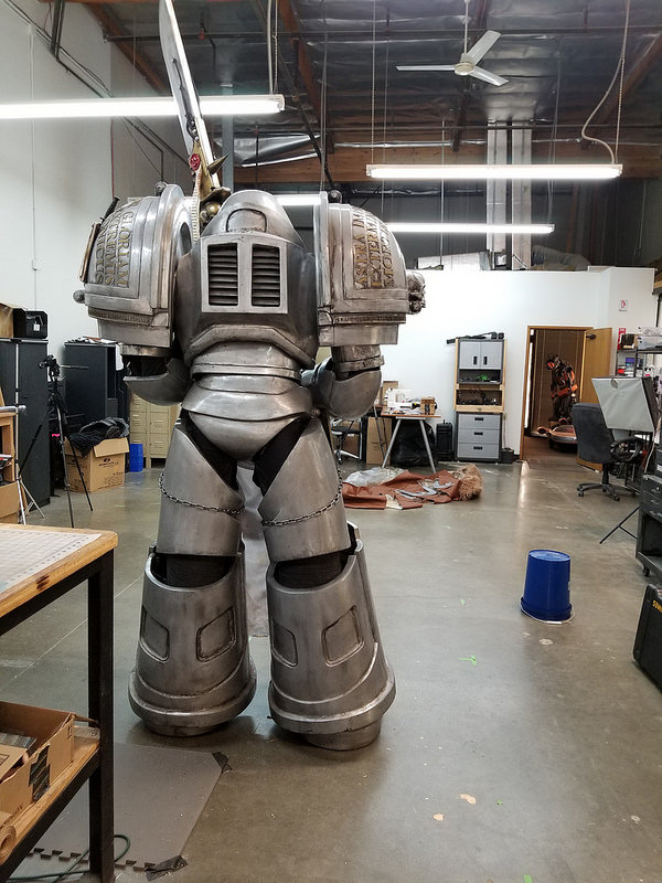

Here's a snapshot of the chest with the shoulders bolted on and the helmet wedged in place:
While I still had a few more pieces to make before doing the final rigging to make it wearable, I did manage to get this guy tied together enough to at least work as a statue for the Bay Area Maker Faire last month. He looked about like so:
Mortal for scale:

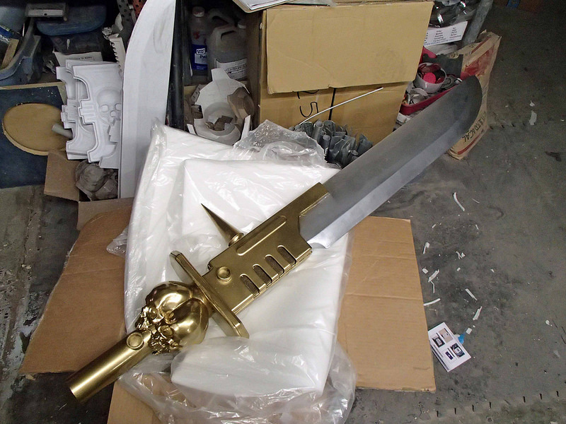

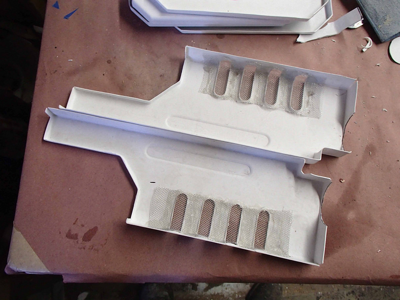

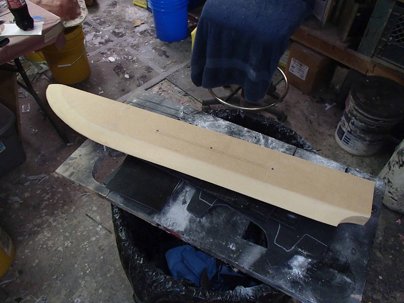

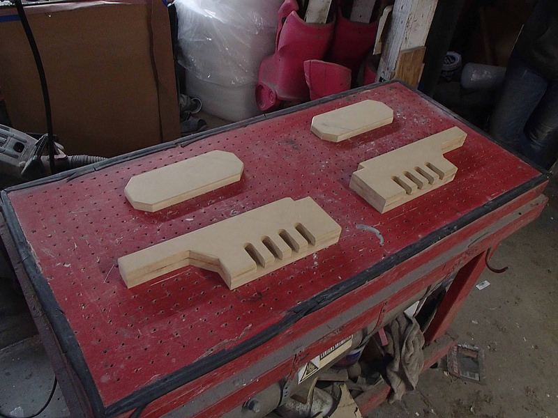

For starters, I decided it was time to make the final version of the force halberd. I started by making some vacforming bucks out of MDF:
The parts were formed in styrene. Then I trimmed out the vent holes and lined them with screen mesh:
Somewhere along the way I 3D printed this little widget:

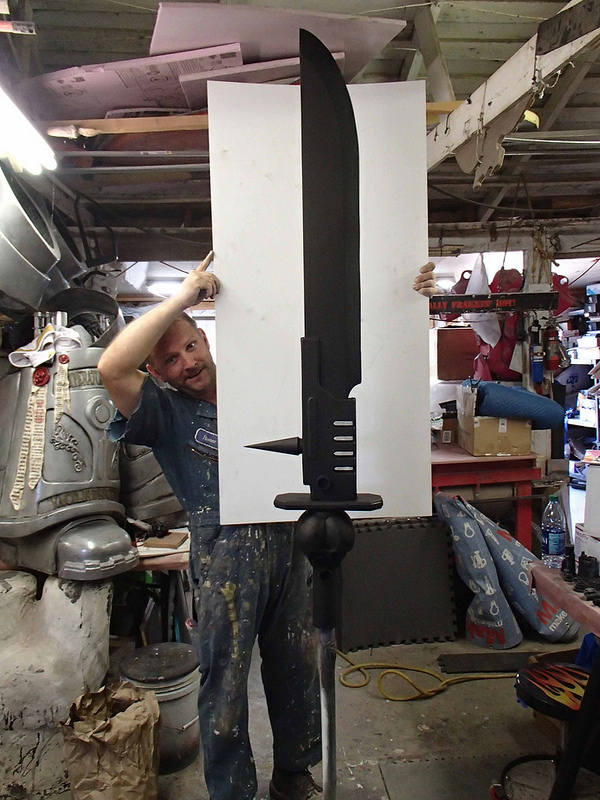

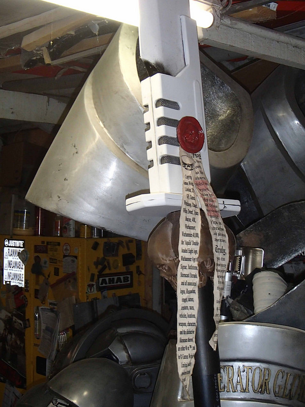

So here's the hilt section of the halberd all together:

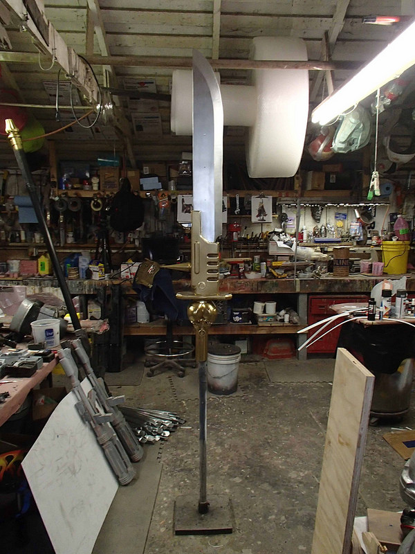

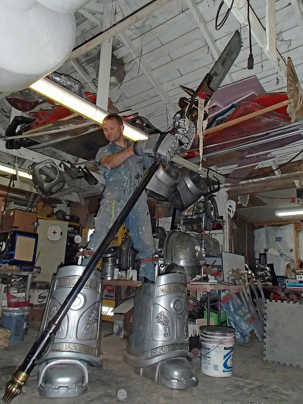

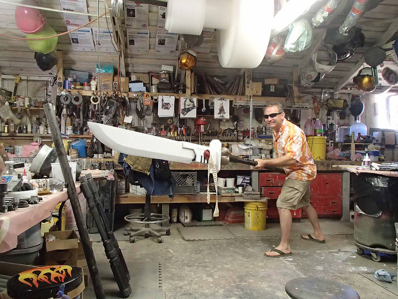

With the handle installed, it was just a bit too big for me to be able to take pics in my shop:
But that didn't stop me from taking silly pics:

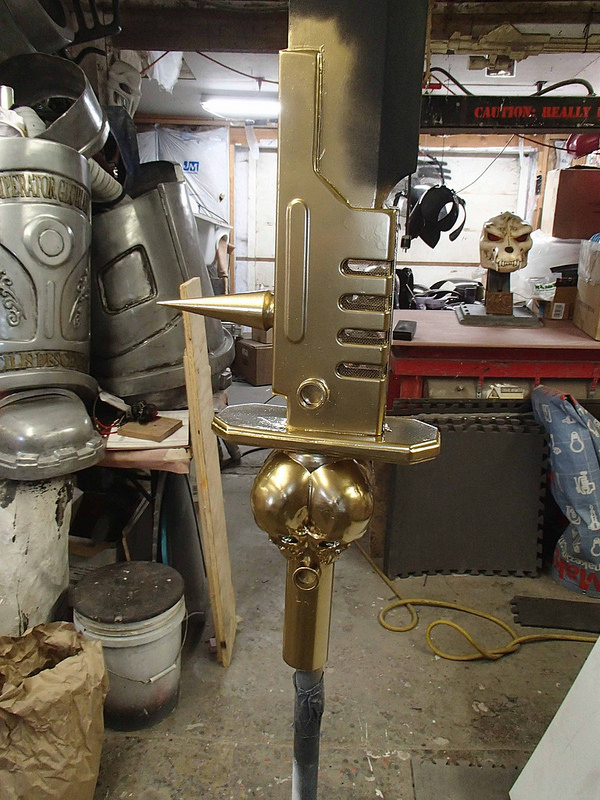

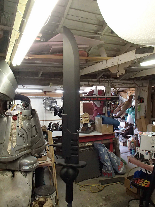

Eventually I got around to putting a coat of primer on it:
But it didn't start to really pop until I began putting on the base colors:
With the weathering done and the purity seals added, it really looked the part:

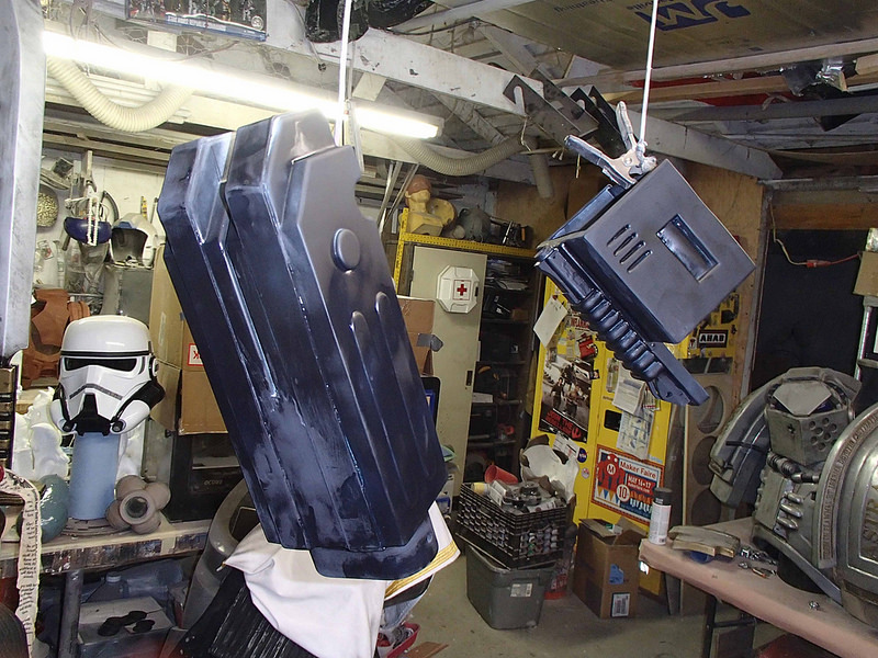

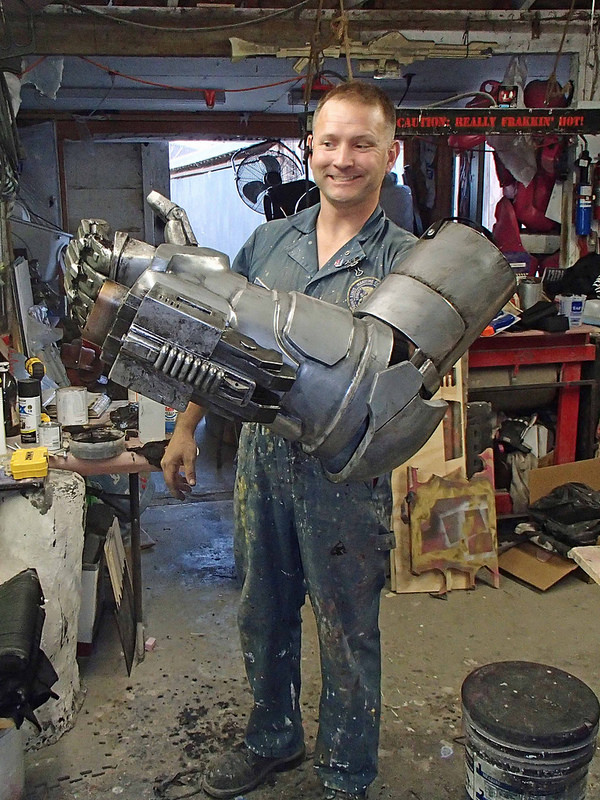

I also finally got around to priming and painting the storm bolter parts:
Here it is mounted to the left forearm:

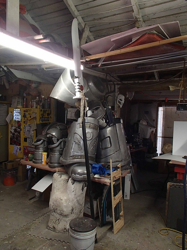

Then it was time to re-rig the thighs to the pelvis:
And set them back on the lower legs:

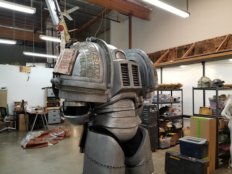

This beast is still not small. Even with the legs all scrunched up:

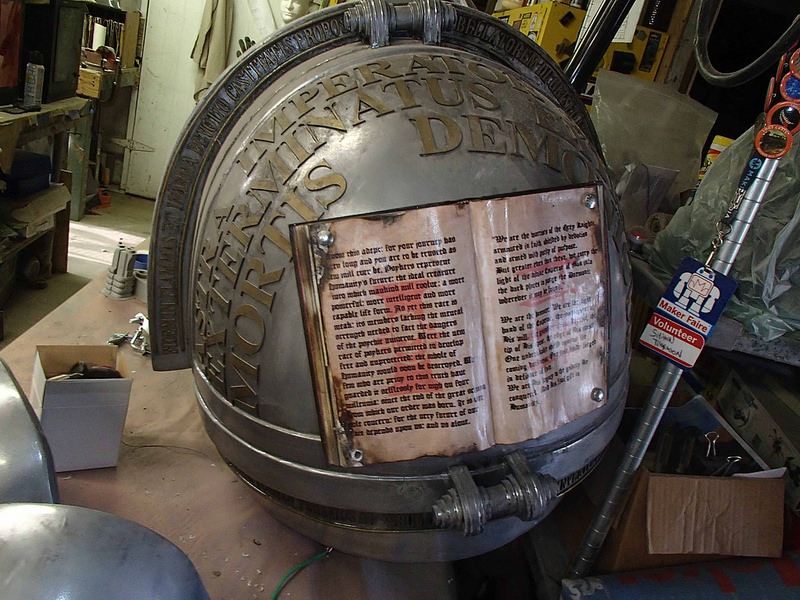

Somewhere along the way I also added this little book detail to the left shoulder:

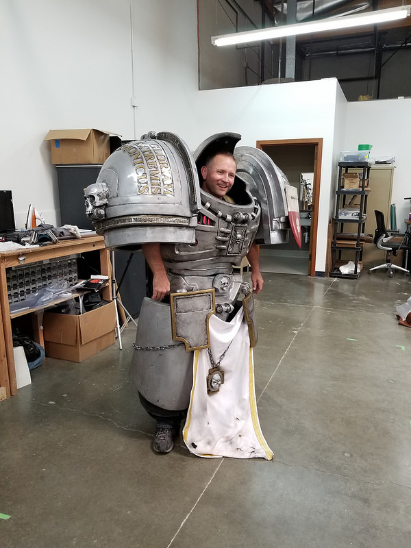

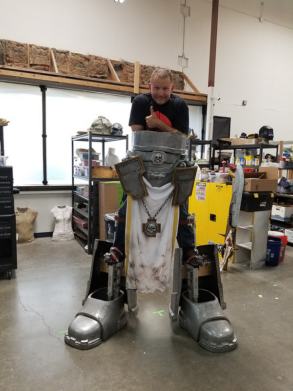

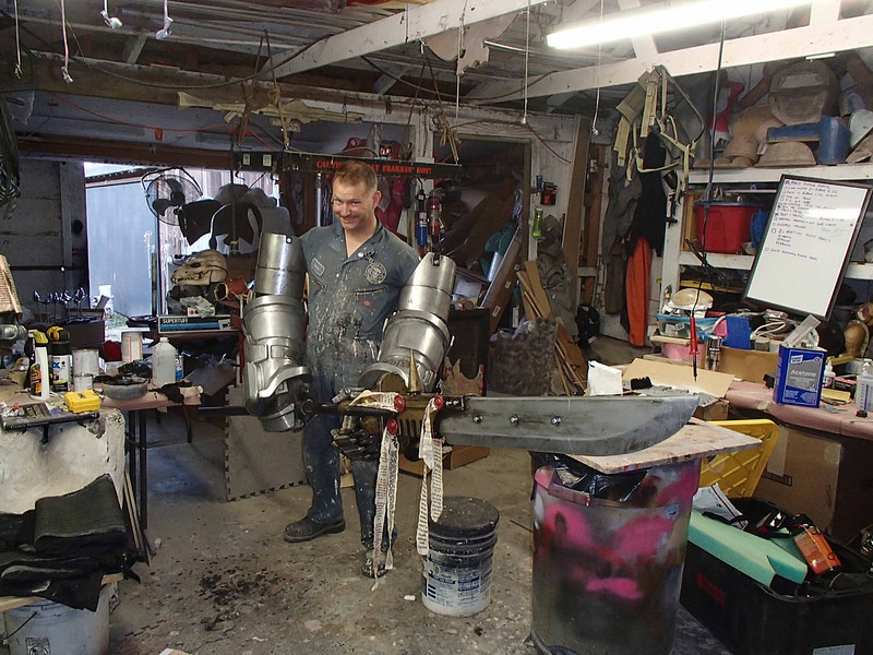

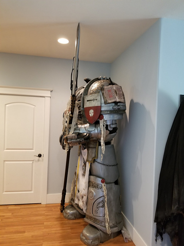

A few days later I was visiting a friend's shop with a truckload of goodies and decided to try this guy on:
There was a bit of silliness:

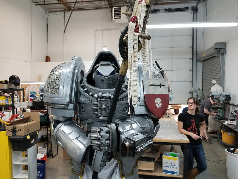

Sadly, I didn't get any pics of me wearing the whole thing. This is as close as we got:

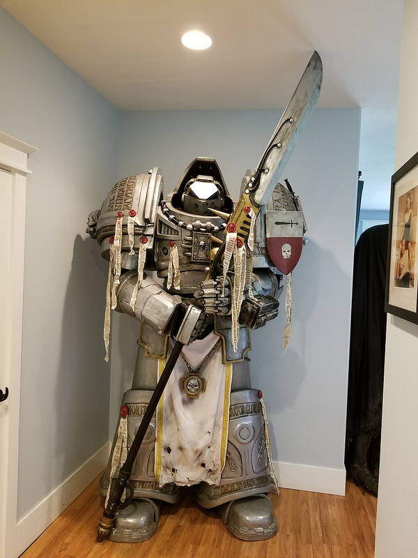

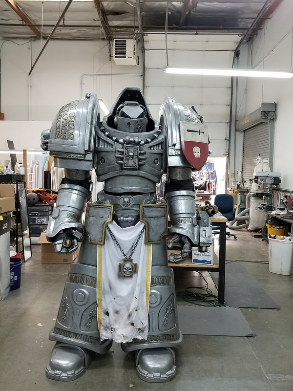

I did get a few good pics of him in statue mode though:
Then I decided to park him at a friend's house where he'll be displayed for the foreseeable future. I had to shorten the halberd though, since the ceiling wasn't high enough:
So that's basically a done thing.
