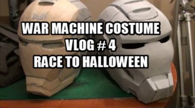

WAR MACHINE COSTUME VLOG # 4 - HALLOWEEN 2012 - SEPT. 20. 2012 - YouTube

Stealth,
Looking great as always, quick question for ya. Does that Iron Man mask in the video have clay on it? Just wondering if you get your helmets to a certain stage with pep and bondo, then switch to clay to finish before molding and casting?
Thanks!
Re: WAR MACHINE - Race to Halloween 2012 - UPDATE- Page 3- Sept. 20. 12
Yeah, oil based clay. I resin/fiberglass then sand down just a little to bring down the edges from where the pieces are joined. (Polygonal edges) , then sculpt.
The clay is replacing the bondo. Then mold and cast when the sculpt is done.
Thanks man. I've been dying to try this myself. I ordered a block of chavant nsp medium and hard yesterday to see which I liked best. What kind do you like?
I've been using crappy klean Klay. I actually removed all that clay last night from the Iron Manhelmet. It's just too soft. I switched to monster clay. It's a lot better. Much more sharper. I'll hardly have to sand much on the cast if it keeps going well.
Nsp medium seems to be the default best choice I think
