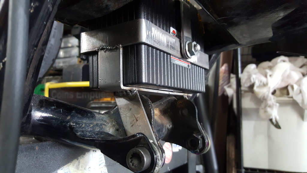

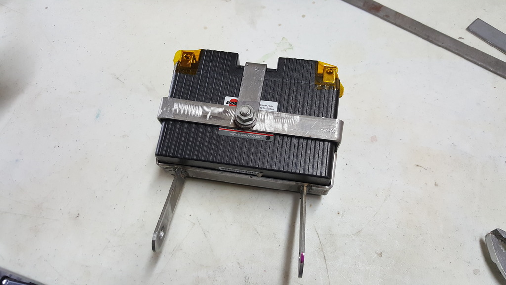

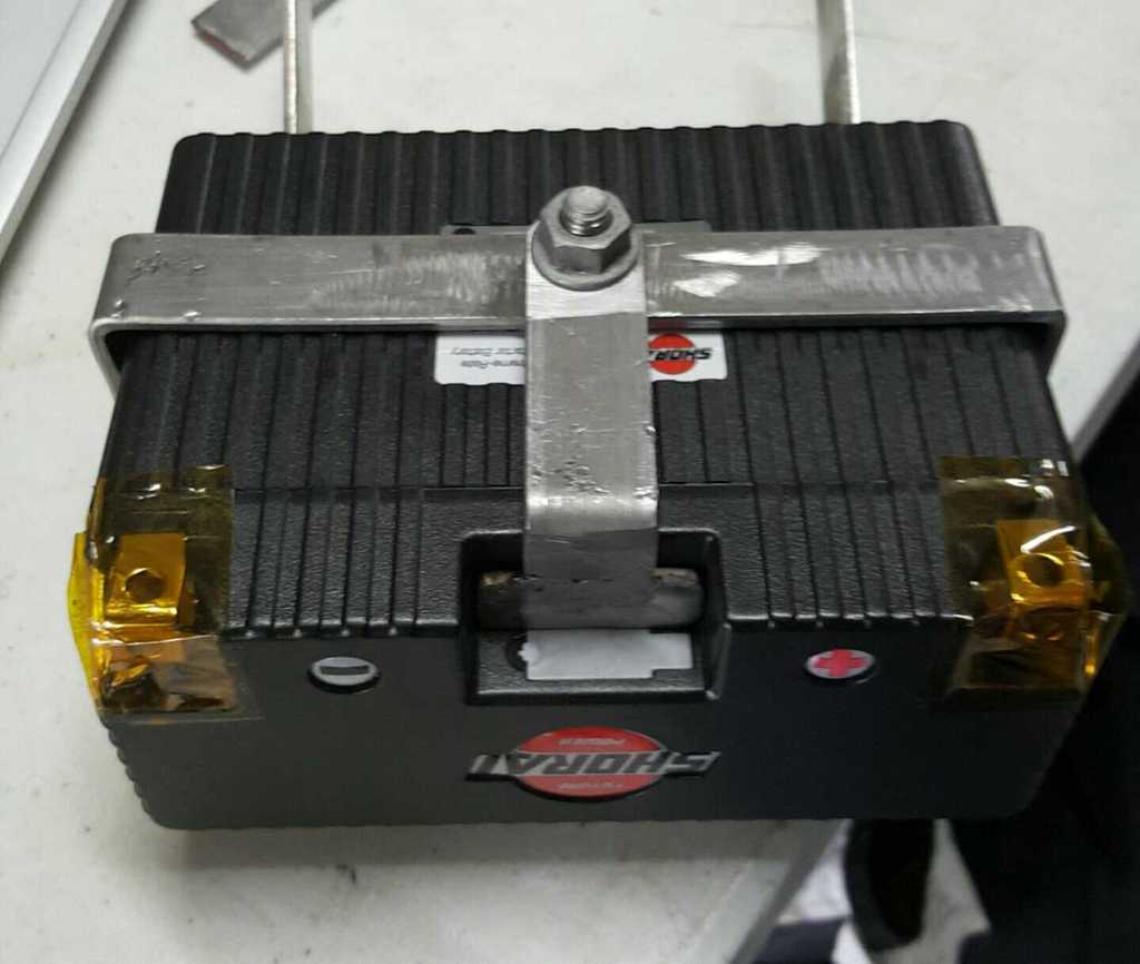

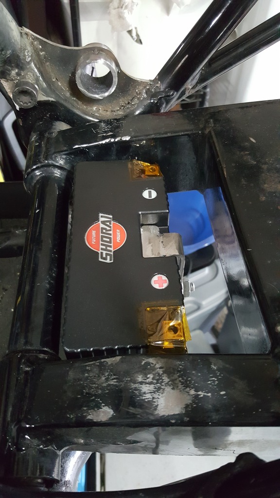

Made some decent progress yesterday. Got the kick starter functional, just need to get the momentary switch mounted so I can use it for starting.
Also got the battery box finished.

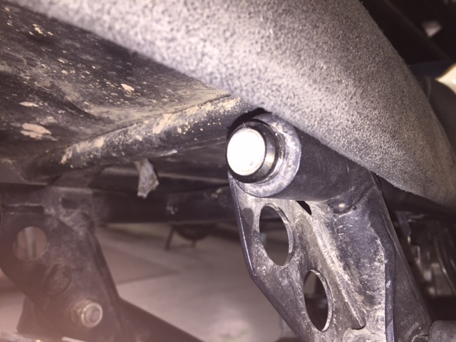

Got the motor in and starting to mess with wiring.. Have a question about the brake light indicator.. Have any idea what they did there? Doesn't look like
rhey kept the ring on the right rear bar that attached via the long spring to the brake pedal.. Can see where they ran wiring if they left it in stock place.. Making progress!!

Studying the screen shots, I have not been able to find a single shot of behind that frame piece where they mount it. I dont really see a reason for them to not use it, you can hardly tell it is there. I was planning on leaving mine mounted in the stock location. I did however see that there are two additional bag mounts along that lower rail that I need to weld on. Looking good though, Im genuinely jealous of the progress. I get about 4 hours or so to work on it a week, so progress has been slow to say the least.
Sent from my SM-N920P using Tapatalk
Yeah the only thing that threw me for a loop was the wiring.. Tell ya what too for a heads up.. your battery tray is affixed to the frame part and bolts on but when you go back to putting stuff together slide the brake rod (splined one that connects to the foot brake) through the whole before you bolt the rear swing arm on.. I almost had to take it all about just to slide the rod through there!
the only think I can think of is that they welded on keeper tabs to the frame or screwed in single wire loom holders here and there to keep the wiring up and around that rounded apex for the brake indicator.. I'm going to make some very small ones out of stainless and dip them in that plastidip to run the wires for that thing and keep the stock setup as well.. Looked around down low behind the right muffer and don't like the idea of mounting the base side on the swing arm with the other end on main frame.. just seems like a recipe for something to break on extension.

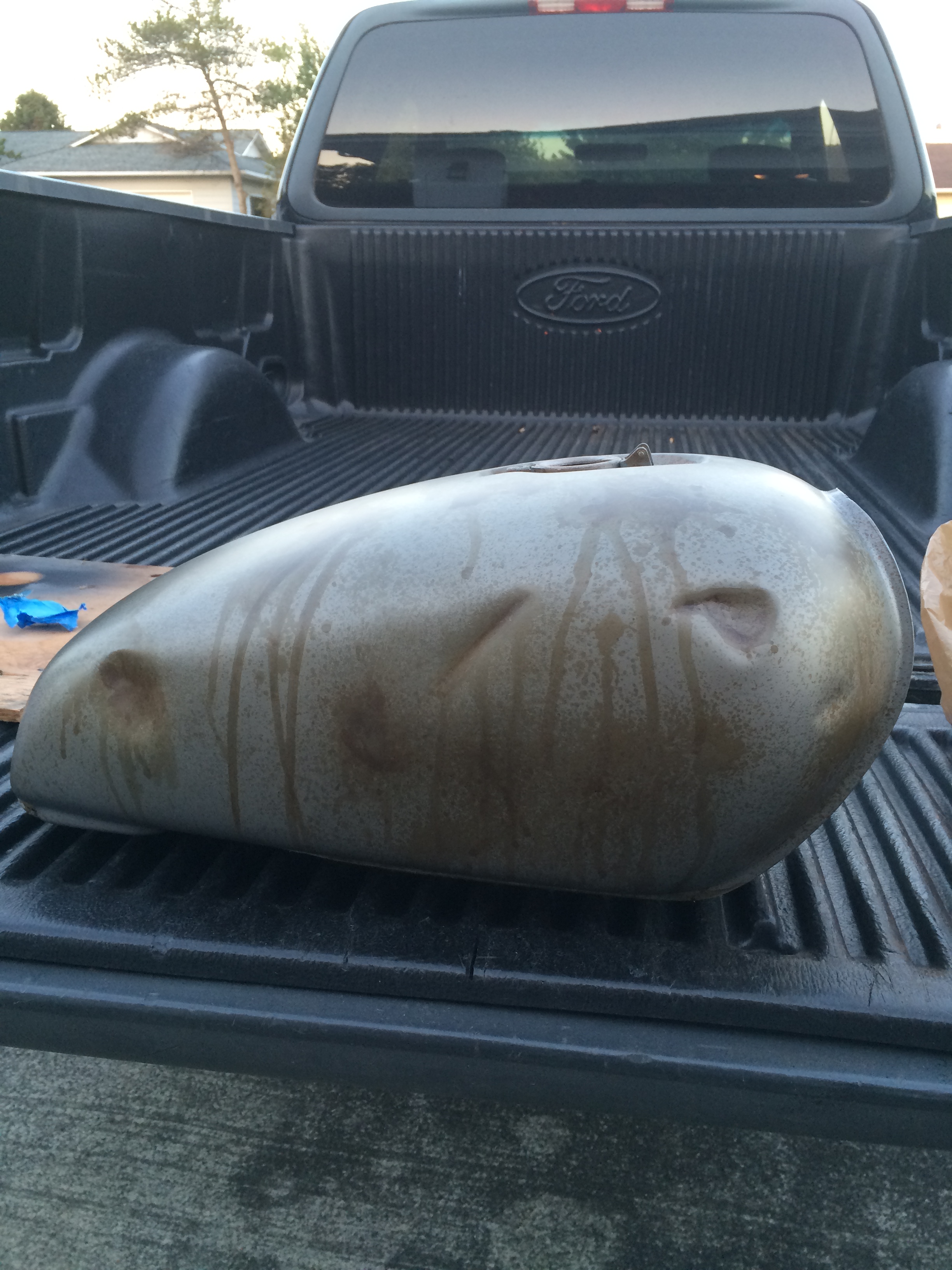

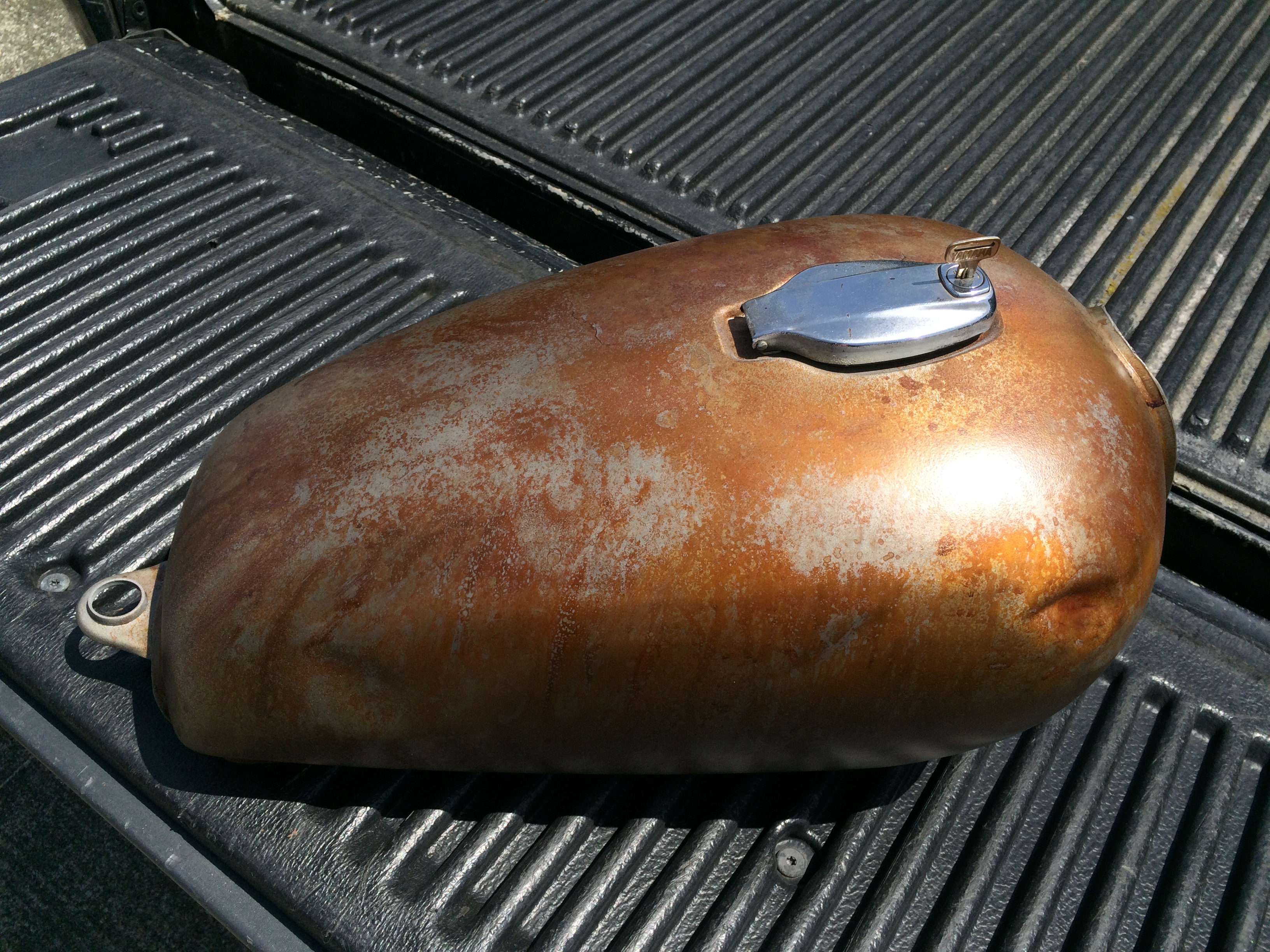

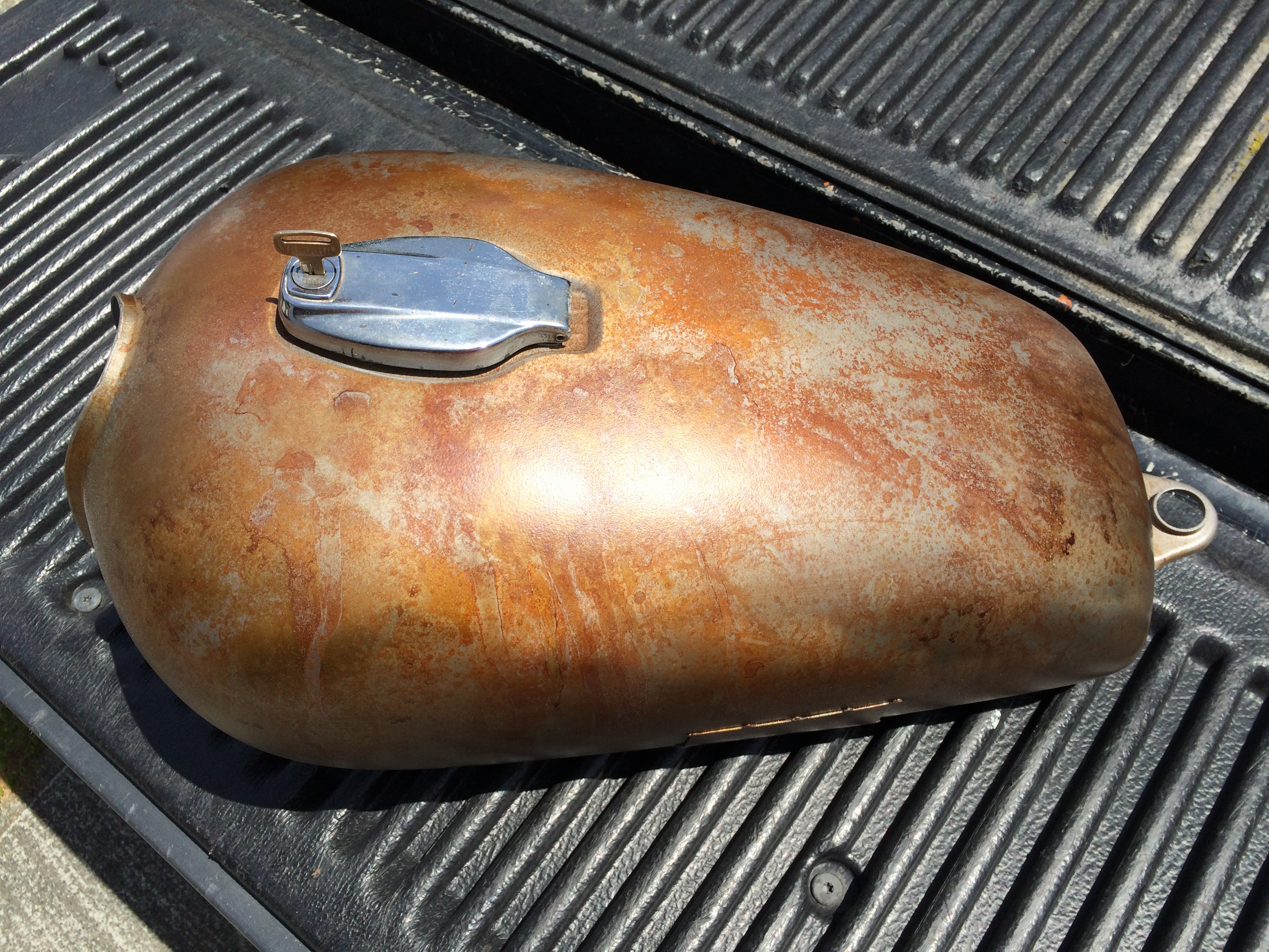

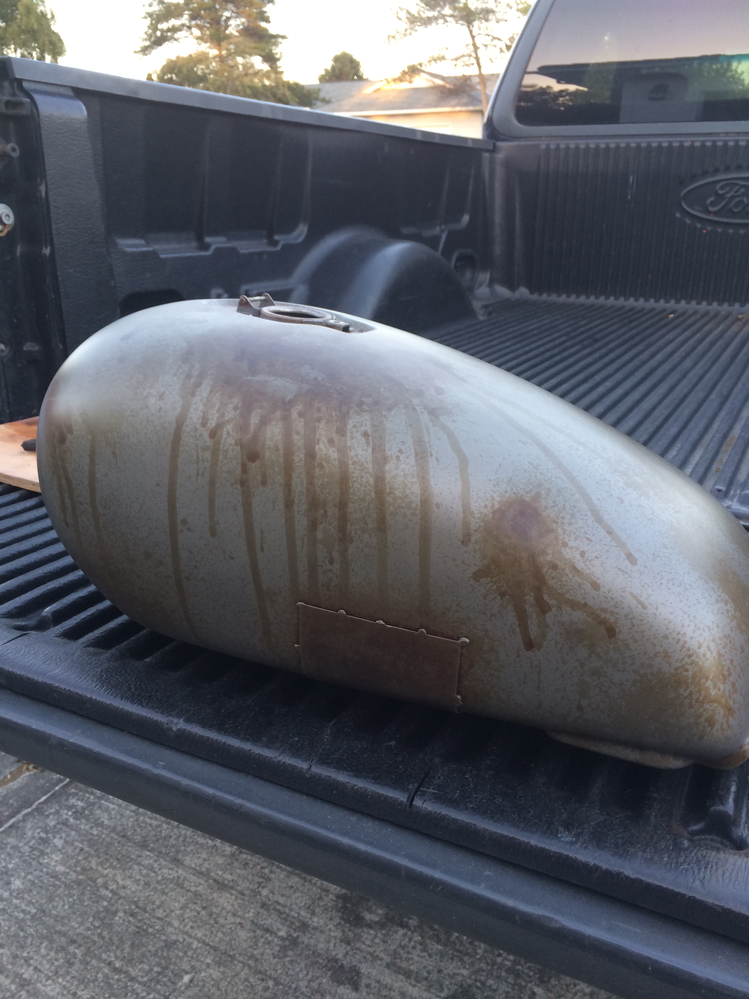

Making some more progress! Decided to re-blast the tank and do it over as I kinda went crazy with the patina on the first go-round.. first one on the left and the second on the right.. pleased with the results!
Photo May 31, 1 00 55 PM.jpgPhoto May 31, 1 00 40 PM.jpgPhoto Jul 30, 8 27 43 PM.jpgPhoto Jul 30, 8 38 33 PM.jpg

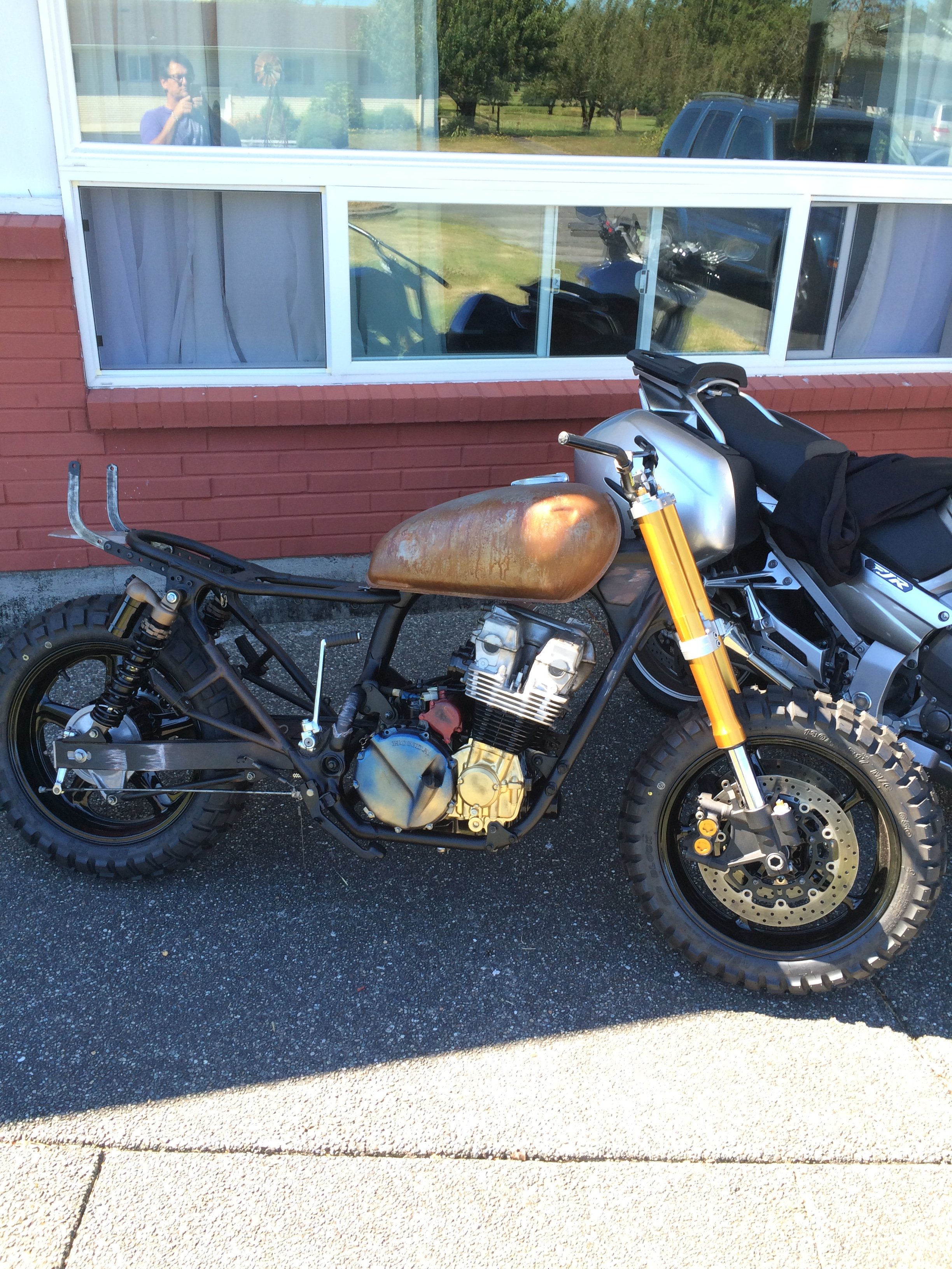

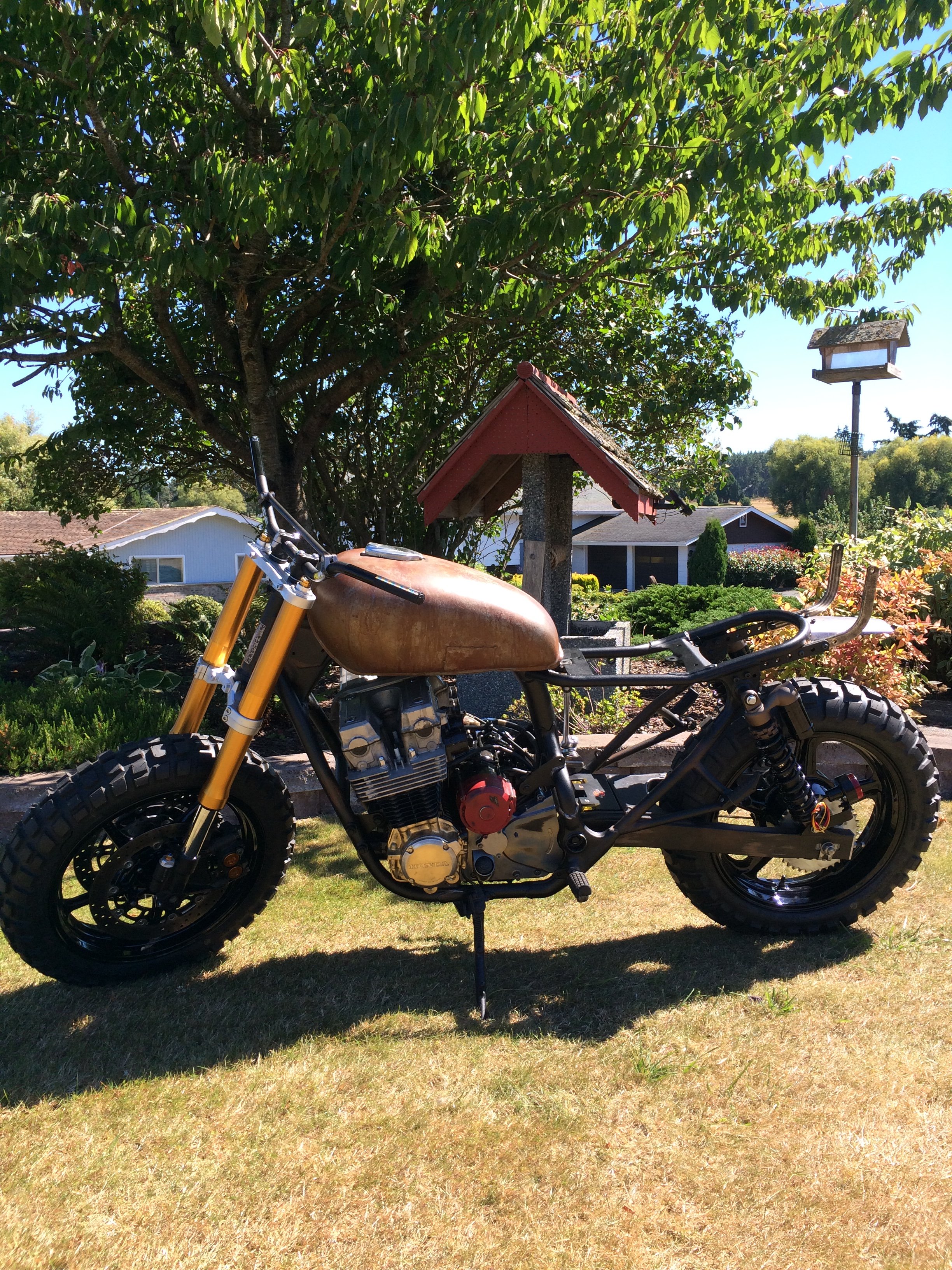

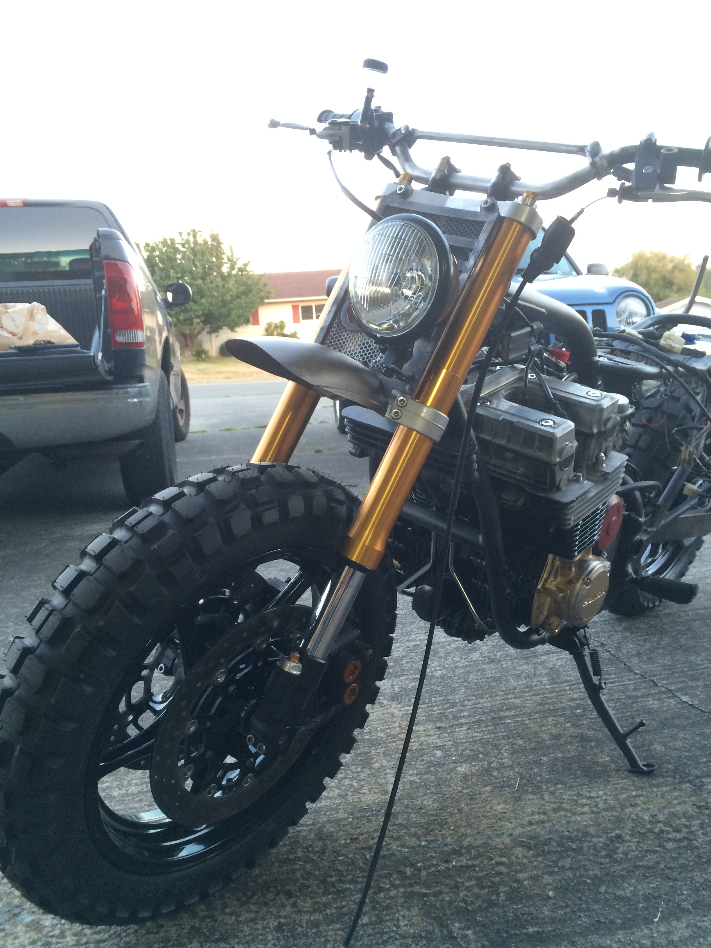

Finally getting the thing put back together of sorts!
Photo Jul 29, 12 24 22 PM.jpgPhoto Jul 30, 8 40 55 PM.jpgPhoto Jul 30, 8 42 53 PM.jpg

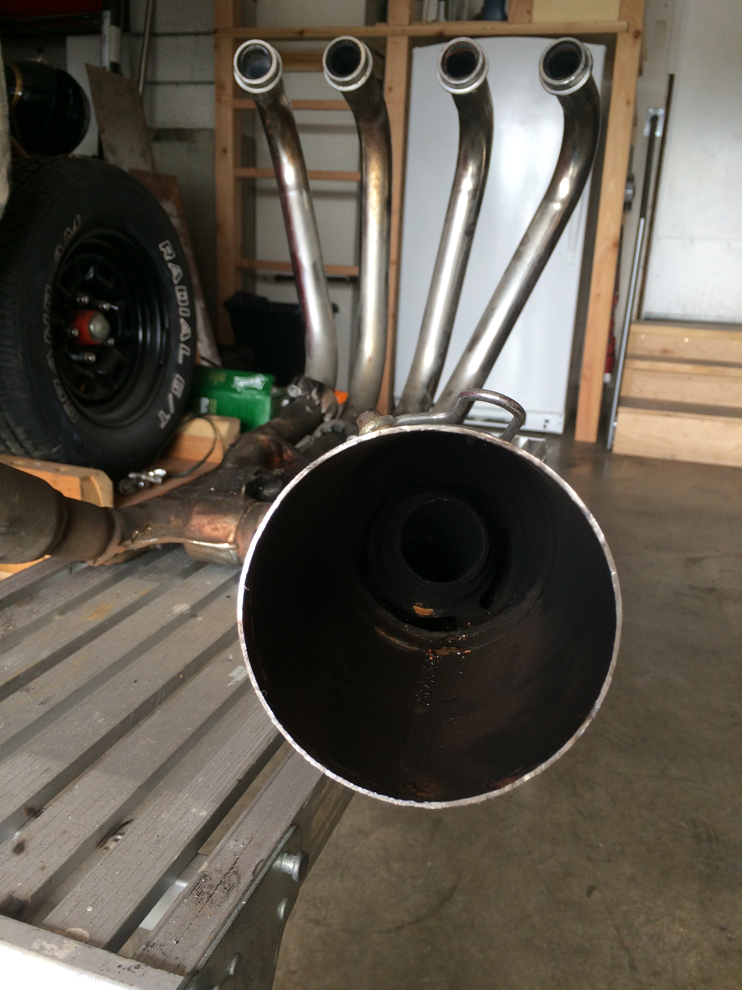

Have some advice when you start messing with cutting the exhaust.. The easiest way to get the can out of there intact are to drill out the "spot welds' right at the area where the walking bike is to be cut.. I had two on each pipe... drill those two out on each side then you can easily use regular cut off wheel but don't run it any deeper that and 1/8 inch or so all the way around... the discarded pipe section will come off with the baffle complete... I went caveman on the thing and did the grinder cut all the way around and sawzall'ed the crap out of the thing and cut off a few inches of the baffle stuff.
Going to play around tomorrow with making some baffles.. have no idea yet how I'm going to do it but I got a set of older sportster baffles from a buddy... will do something to cap off the flow of gases and probably wrap a shortened version of the sportster baffle with fiberglass or steel wool.. have you thought about how your going to do yours?

As for the exhaust, the one I got off eBay was already gutted. The jet kit I installed is set up to run without the baffles so I don't have a plan to add them in. Cory runs his without as well. Classified I believe made some custom ones, probably cut down from an existing aftermarket one.
I really like the second go at the tank, sometimes less is more, but it definitely looks better.

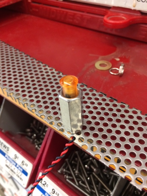

Here are the little Led's for the panel on the bars.. I was looking at various stainless pieces to make something kinda cool for it to hold them.. They were at radio shack and have a resistor already incorporated, only bummer was they didn't have a blue one for high but i'll figure I'll get the one finger salute if I leave them on lol

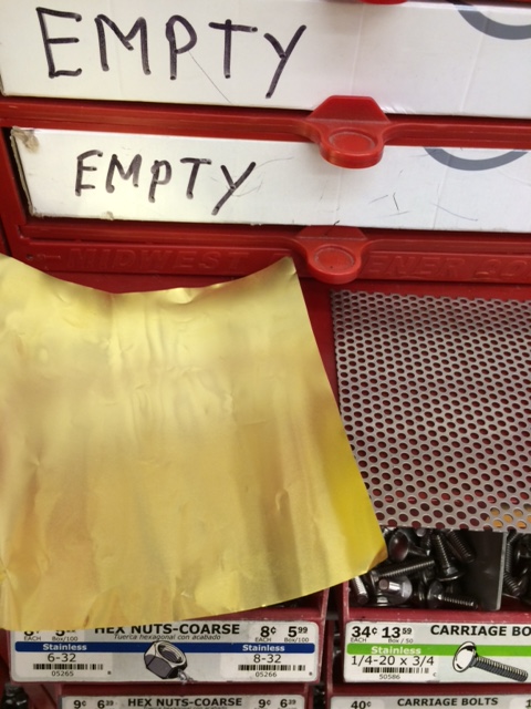

Worth mentioning that I noticed this material while at ACE, its some sort of brass gasket material, figured it would be good to put behind the brass mesh on the tail pipe section, I was wondering whether or not the heat would turn it colors or not but will probably get some of it anyways to see how it looks!
View attachment 649770View attachment 649771View attachment 649772View attachment 649773
View attachment 649774View attachment 649775View attachment 649776

Ragtop, where did you end up cutting the exhaust? From the CM pics looks like its just before the rear mounting point? I was thinking of cutting my exhaust. Thanks for the help.

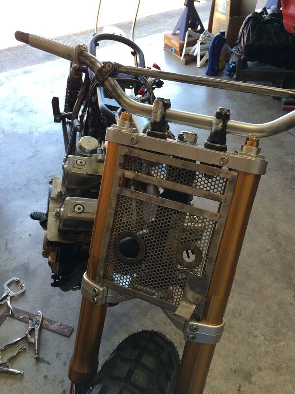

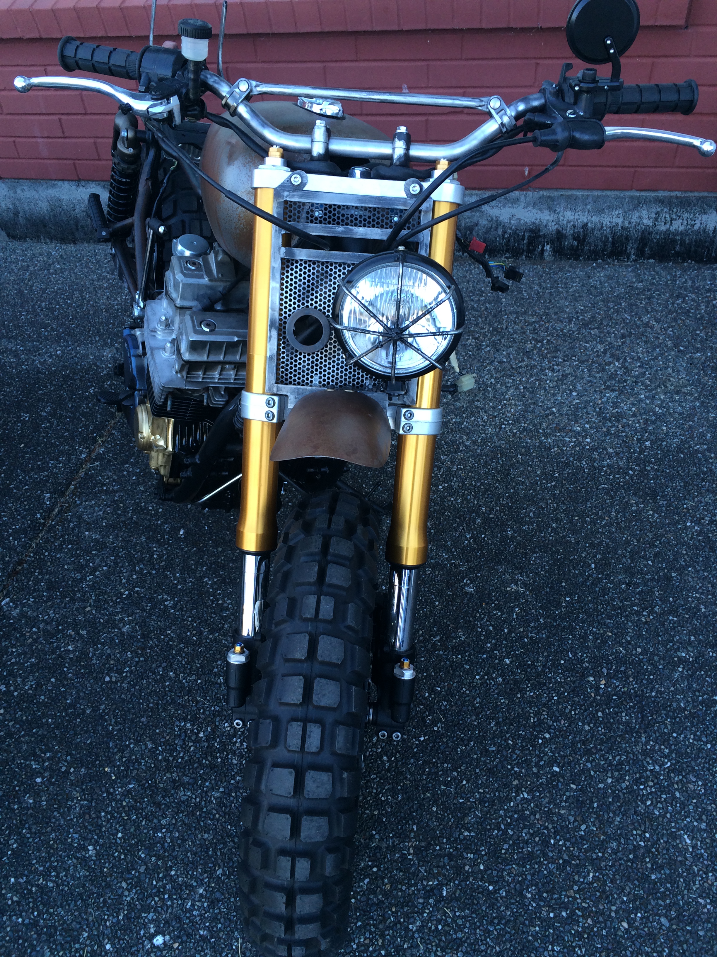

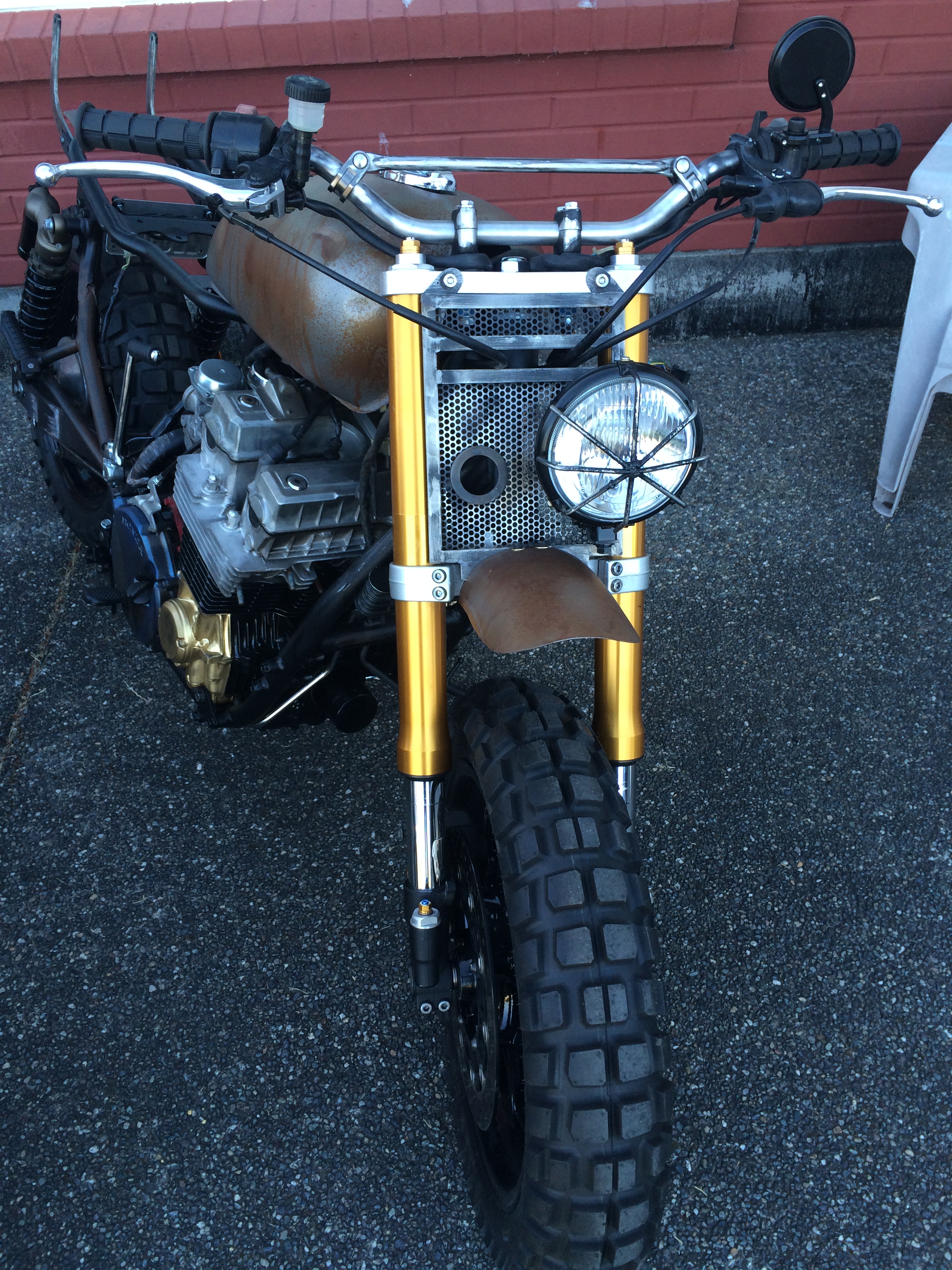

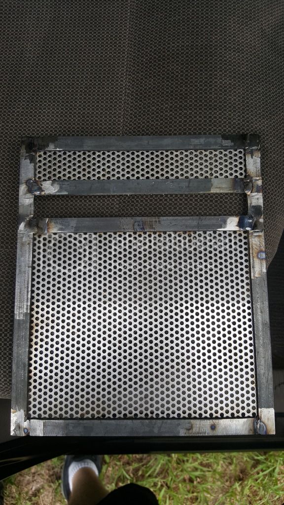

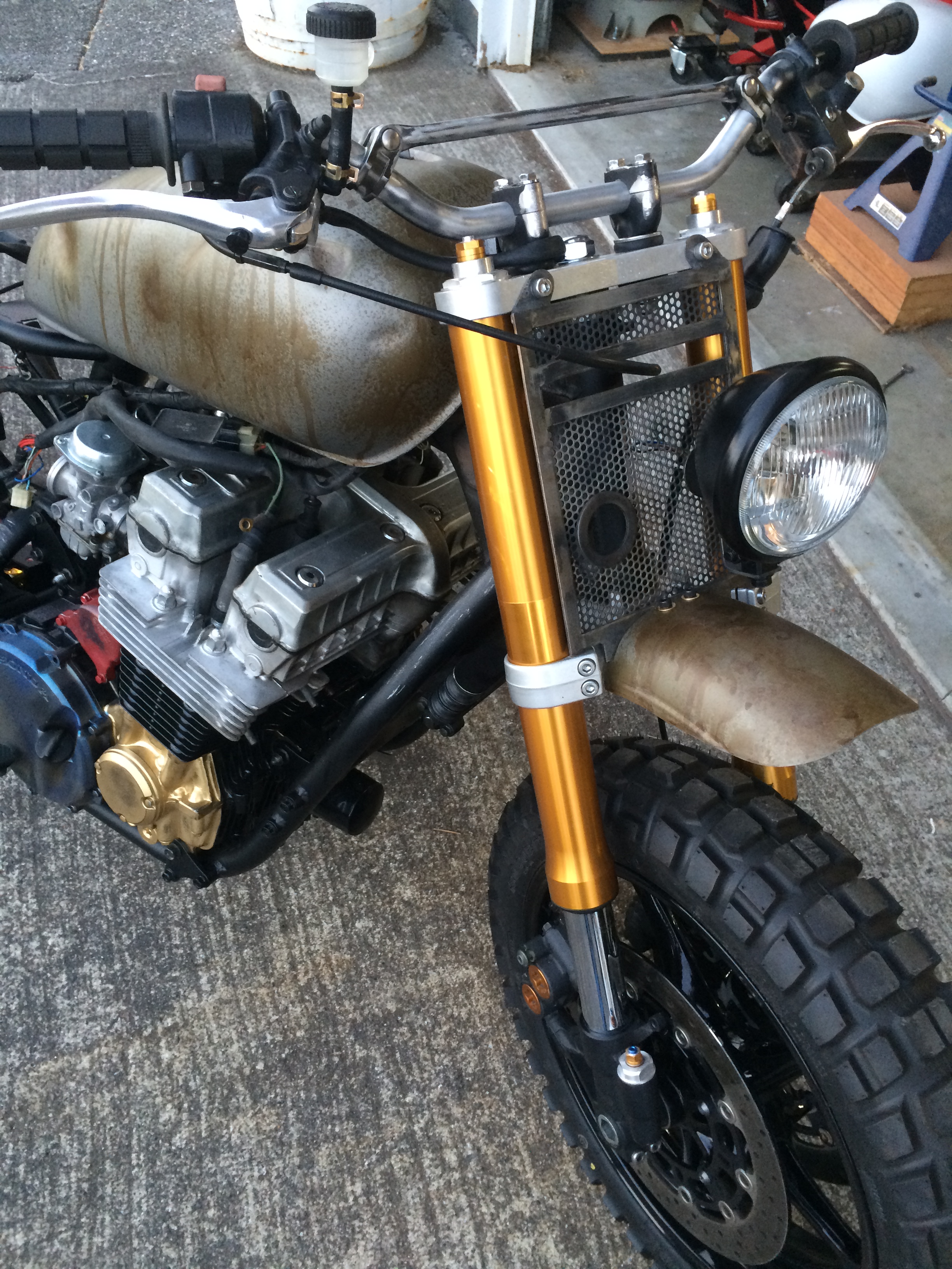

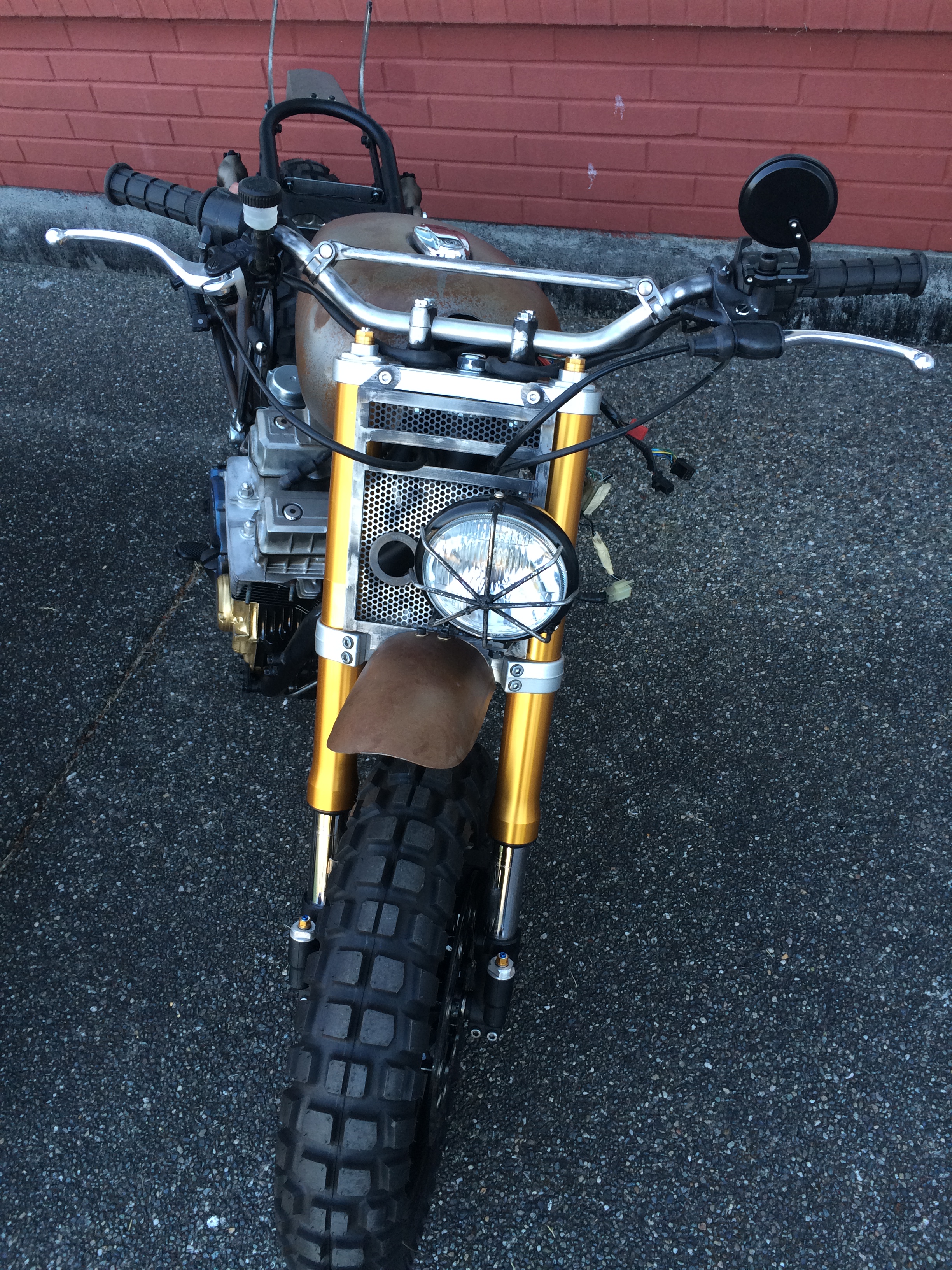

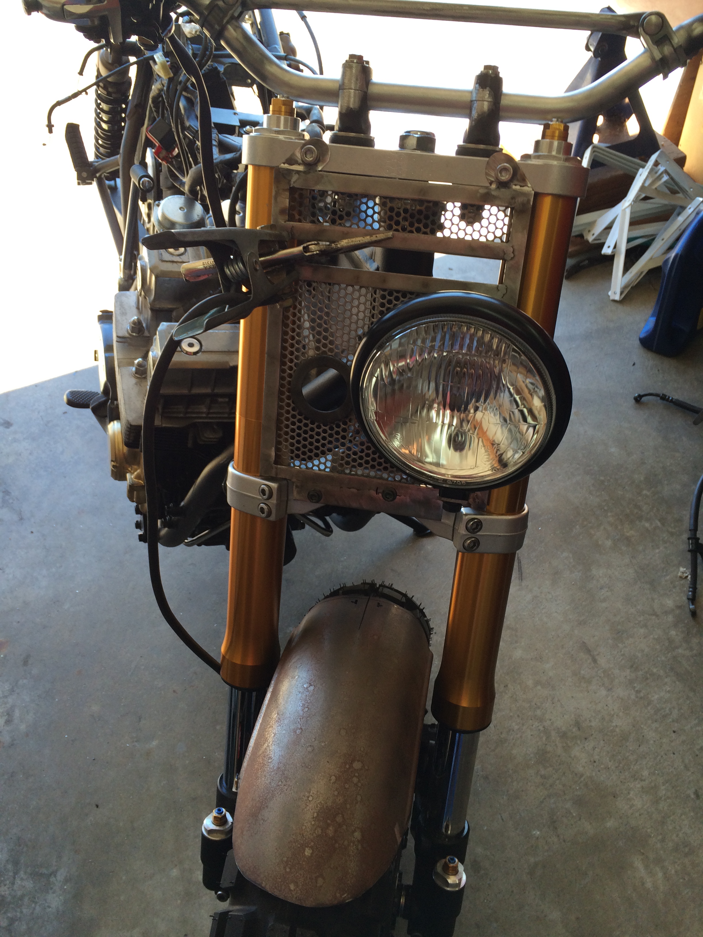

So I had a few hours this week, managed to get the front grill welded up, just missing the mounting tabs and machine bushings.
The machine washers have been a bear to track down. There are no hardware stores in our area that carry machine bushings. I checked Lowes, Home Depot, ACE, and a mom and pop place over here. Fortunately this weekend I went to Tavares to visit my grandparents. There was a Rural King and a Tractor Supply there and between the two of them, I managed to pick up what I think are the right sizes. I picked up two of every size they had there just in case.

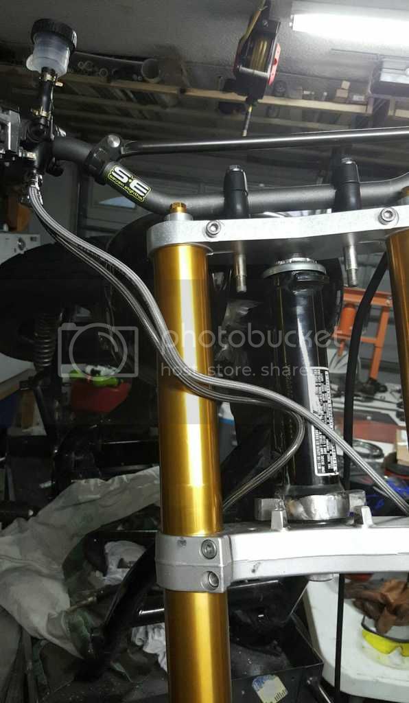

I also test fitted the Galfer lines. I think one side of the lines is crimped on upside down, which causes the lines to twist when installed like the reference photos. It may be ok when the grill is installed.
That's it for now.
So the guys over at Galfer just emailed me back. The banjos can actually be rotated!! Did not know that....so as soon as I get home, I will be fixing the twist in the lines.
