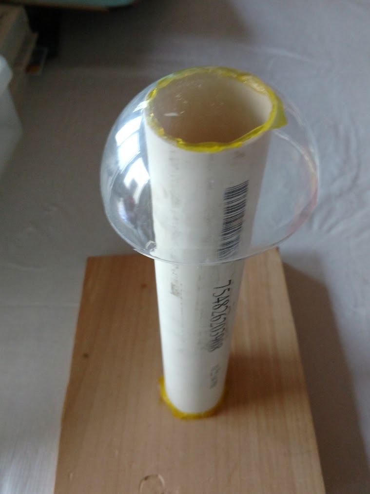

After cutting them out I did a little quick shaping with a heat gun and what Evil Ted calls a "foam anvil" which is nothing more than 3" acrylic dome glued to a piece of PVC pipe on a stand.

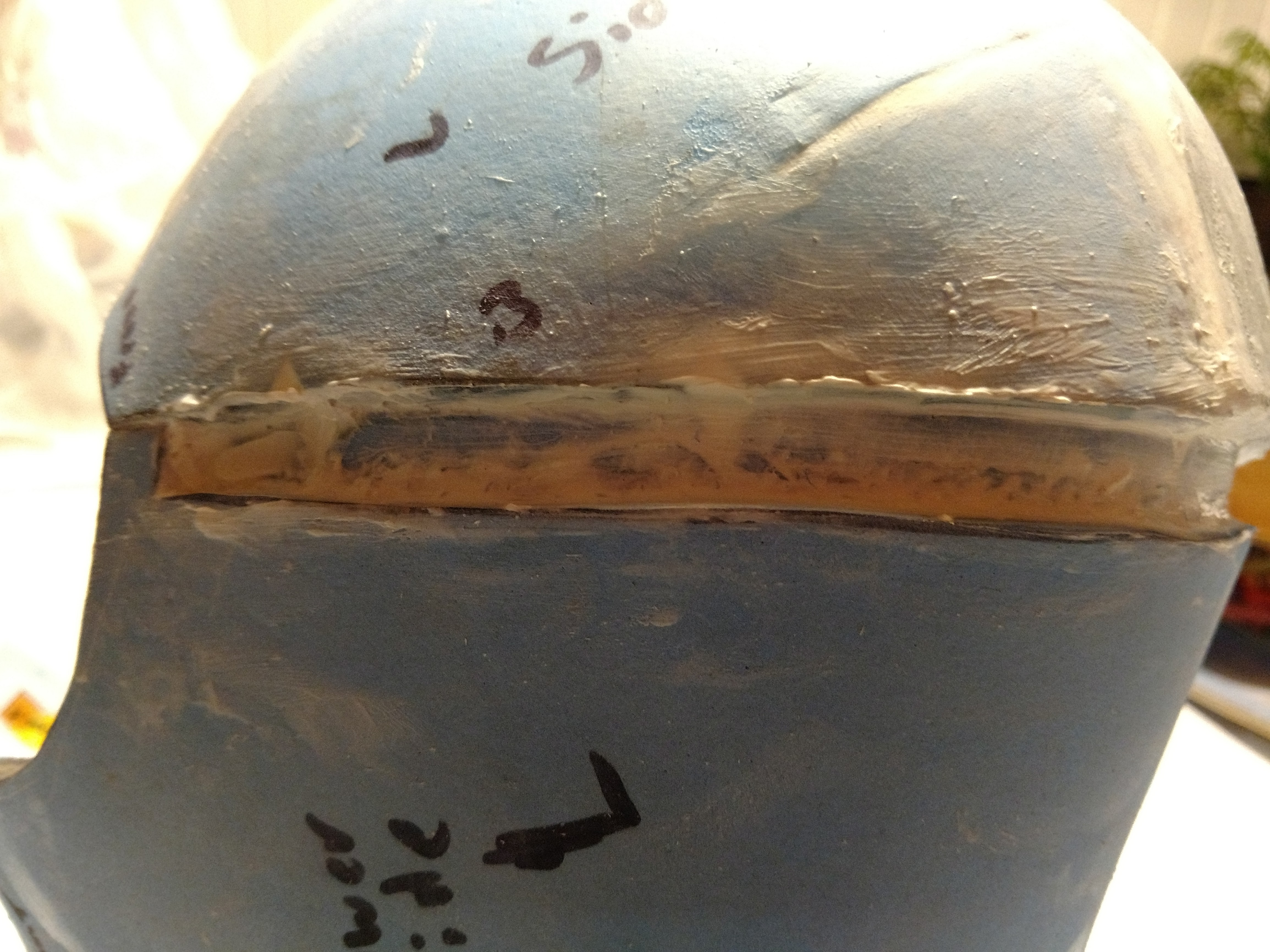

I went and glued the side pieces closed and I also used a bit more glue along the top of the seams on the top piece to close the seams up a little better. Once the glue was set I then went and attached the side pieces to the top. It went a little better than when I glued the top piece closed but still a bit rough, but not too bad for my first time. Like with the top piece, the side pieces attached with a slight gap at the top, something that I would fix the next day.

Anywho, I suppose it's time to post some more progress pics. Since I last posted progress pics I've attached the lower sides of the helmet and have been spending the rest of my time slathering lots and lots of Kwik Seal to fill the gaps in seams and the holes resulting from the cut out registration marks.

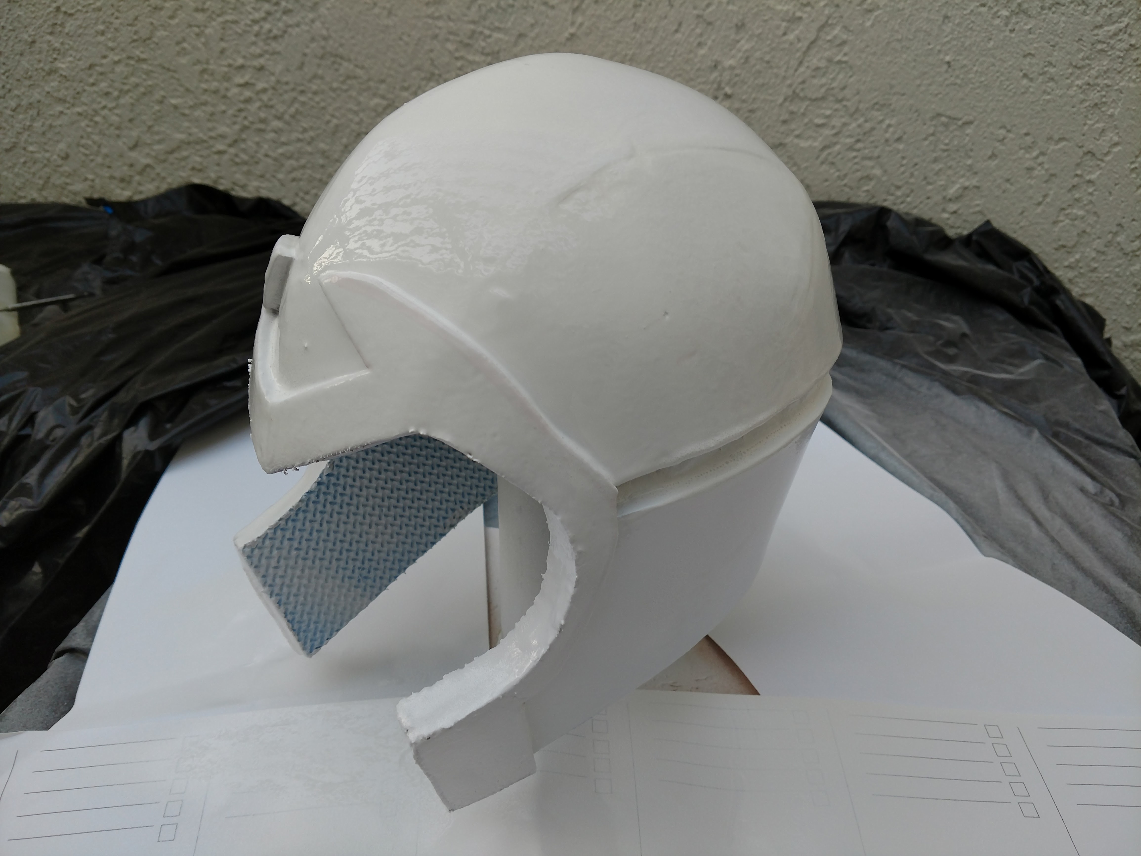

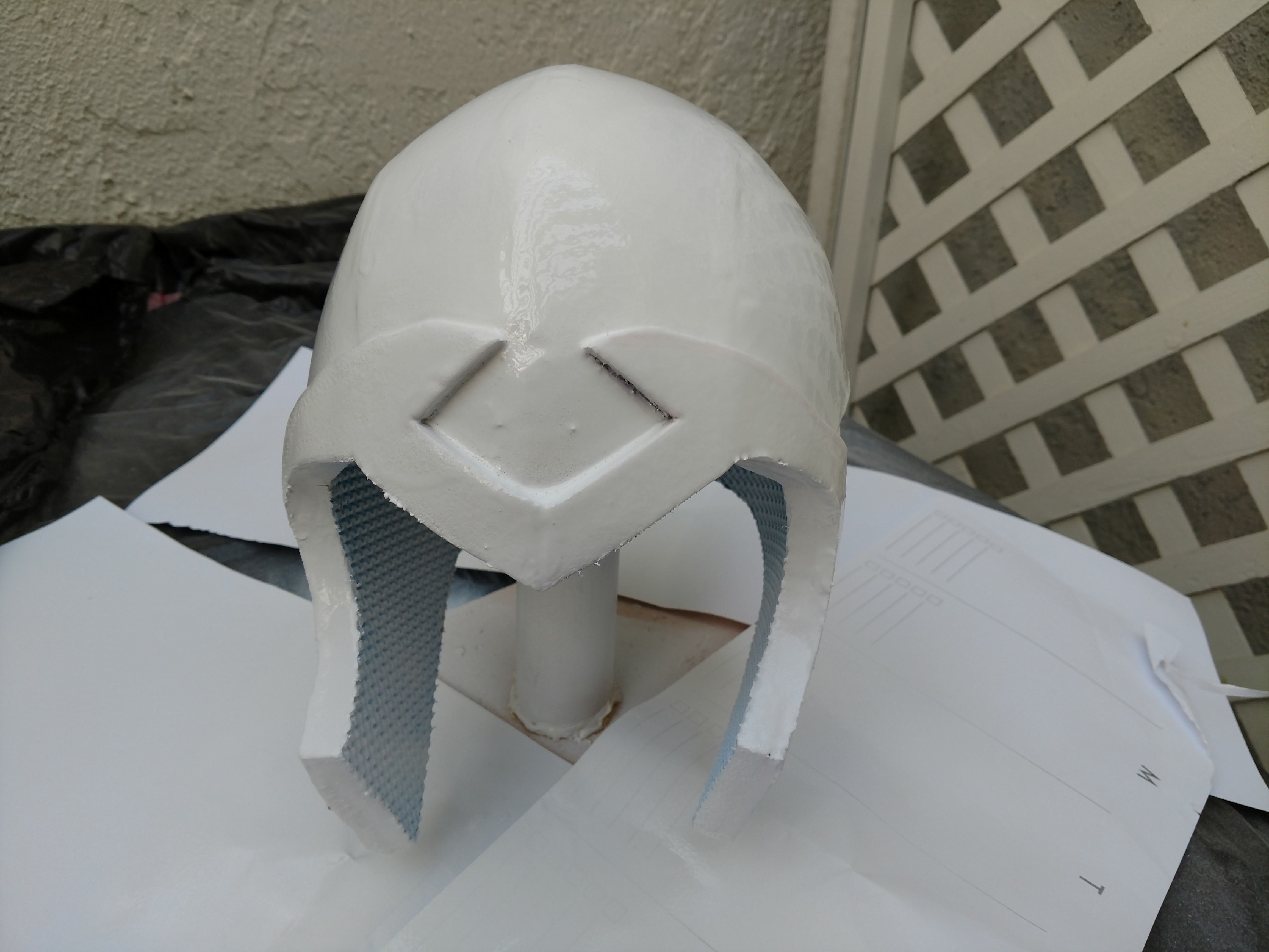

After that was done I went over the helmet with yet more Qwik Seal, even though is for a 5 year old the perfectionist in me wants to try to make the seams and holes as invisible as possible. So, after doing that for another couple of days I finally decided that enough was enough and it was time to time seal/primer my build. So here it is after a coat of white plastidip.
Of course Plastidipping the helmet showed off the flaws better so after it dried I went back and added yet more Kwik Seal in an attempt to clean it up.

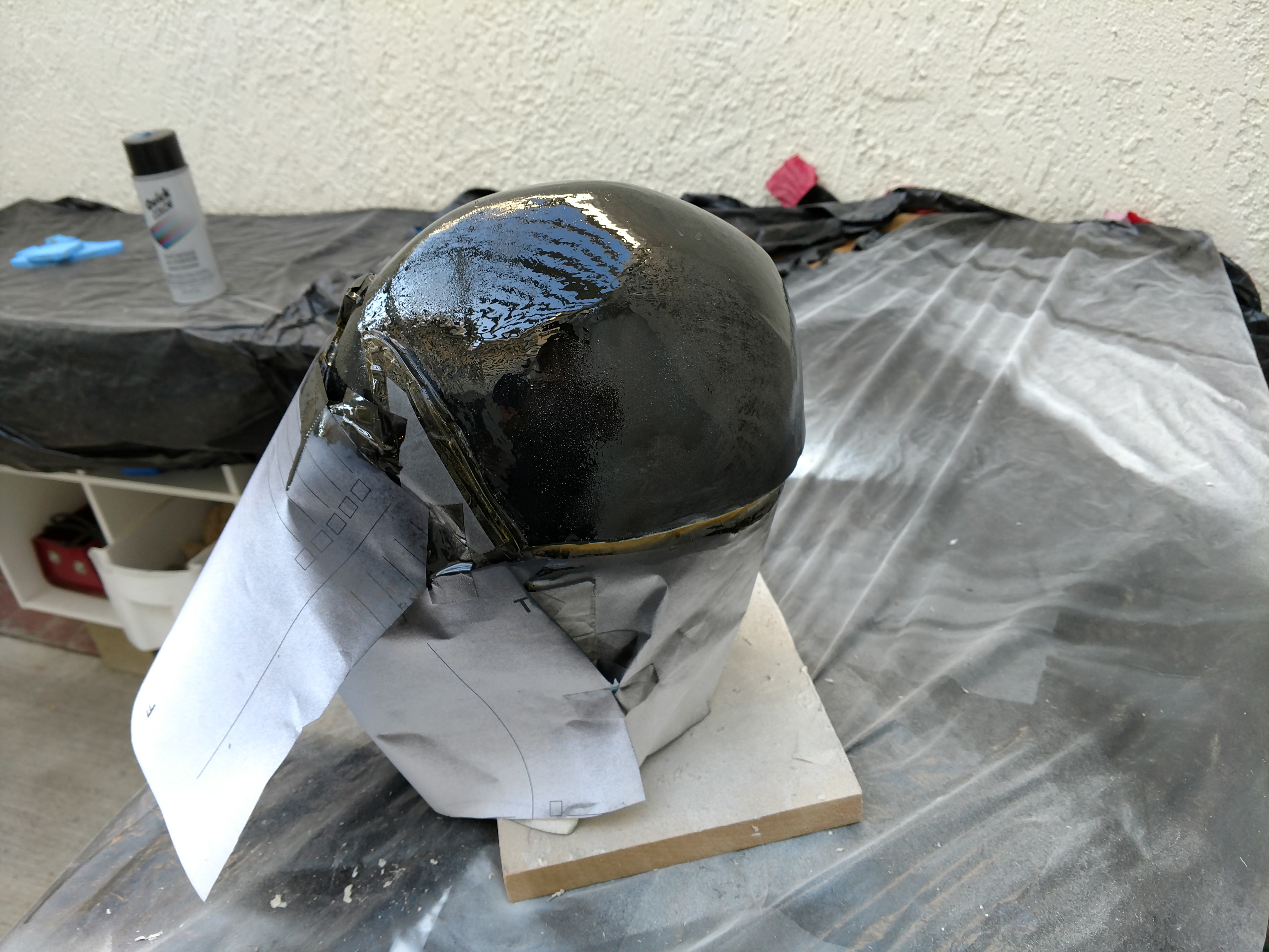

Next I masked off all the areas that I wanted to keep white so I could hit it with some black spray paint.
IMG_20170924_164125240.jpgIMG_20170924_164131112.jpgIMG_20170924_164304421.jpgIMG_20170924_164313837.jpg
As much as I masked it off I didn't do as good of a job as I had thought and hoped that I did and had a fair amount of overspray of the black. This I fixed by simply painting over with white acrylic paint and a brush. I also used white acrylic over the white areas with the pitting and this worked exactly as I hoped and covered up all of those little holes.

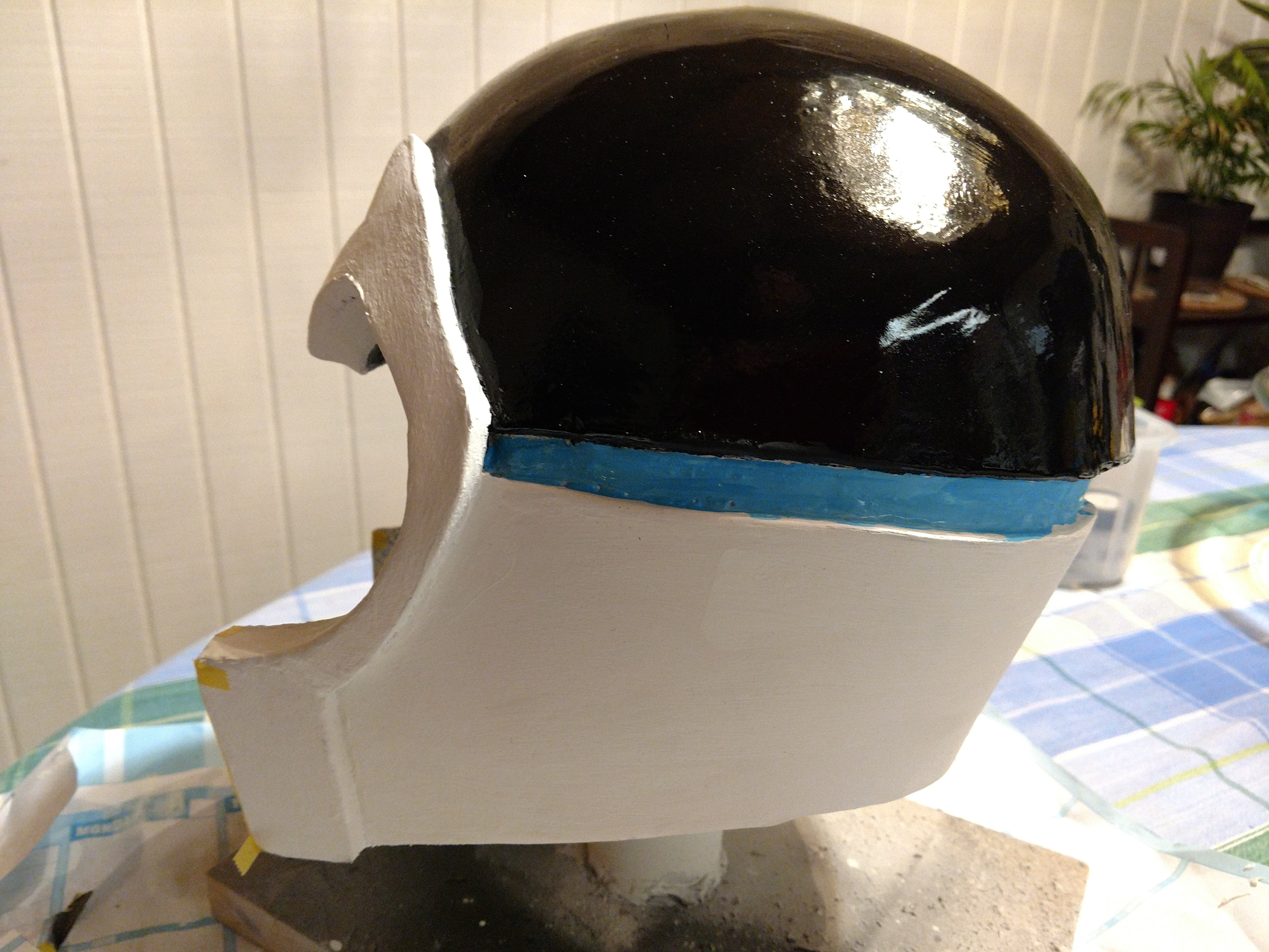

After touching up the white areas I then went in and painted the blue trim that goes in the recess in the middle of the helmet and the front of the mandibles. The template actually calls for small pieces with openings cut in them to go in front of the mandibles but I cheated and simply masked off part of them and painted in the blue.
What's not visible is a couple of coats of glow in the dark paint on the blue on the mandibles. I'm also going to add the same glow in the dark paint to the blue strip in the middle of the helmet in order to give the blue a nice glowing effect at night. Evil Ted originally was going to put reflective tape on his and so was I but I decided that glow in the dark paint might be a cooler effect for a 5 year old.

I've finally finished the helmet, even though I'm posting it today I actually finished it on Sunday. All I did in the end was to apply a little more glow in the dark paint to the blue areas, apply a gloss coat, and add the visor. So here it is, it's a bit rough but I'm overall happy with the results considering that it was my first attempt at working in foam and, most importantly of all, my nephew loves it.
