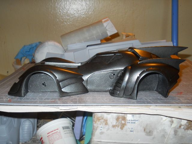

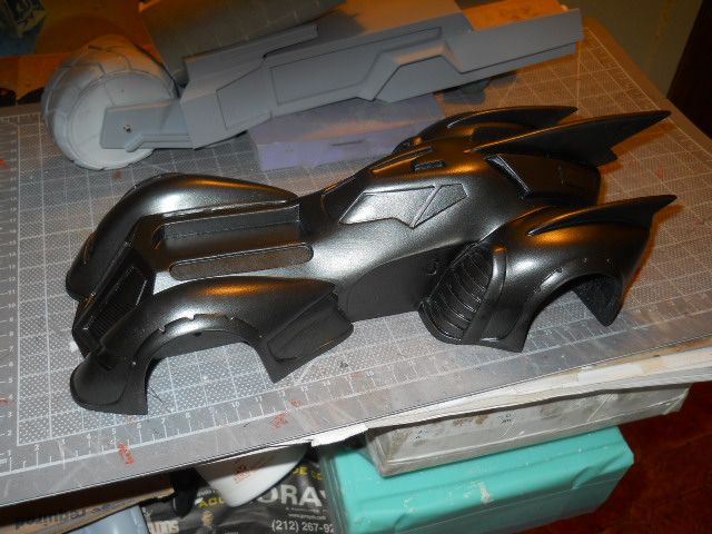

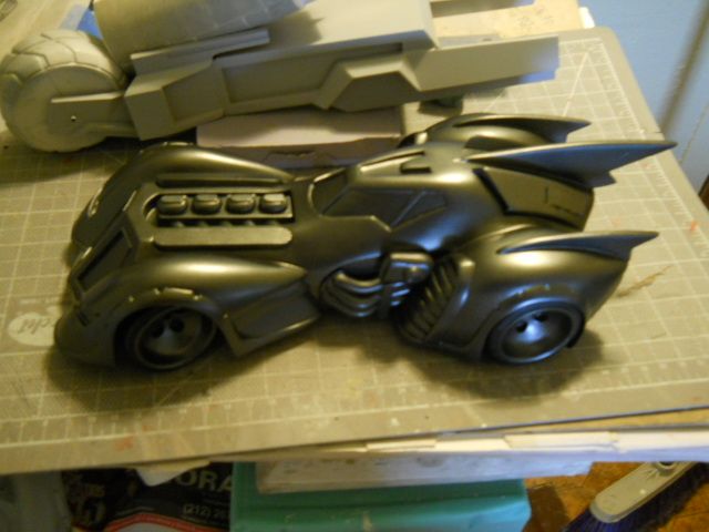

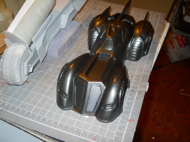

Thanks guys Nice Vette there Al, I took the originial casting that had the bad paint issues and stripped it 1st I used thinner with a tooth brush, then Easy off oven cleaner for 15 minutes, then some Ajax with the toothbrush whatever was there that contaminated the paint ain't there anymore after that LOL!. I had used Dupli Color Automotive gunmetal paint for the engine and detail parts and it covered the resin without any kind of proplem so I said I'll spray the whole car in the gun metal to seal it and just tape up the areas that were going to be painted in that color anyway and then hit it with the Flat black.

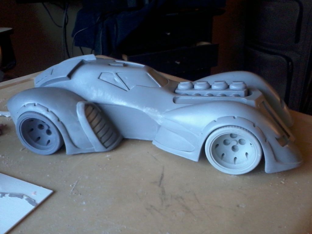

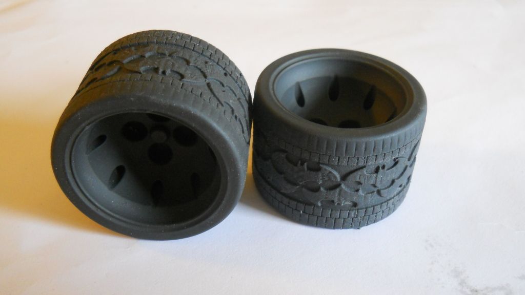

Okay guys the kit just got taken up a notch with the help of Master Modeler "IEDBOUNTYHUNTER" who is a humble guy but I must give credit where credit is due he offered to help draw the wheels up on Solid Works and have them 3-d printed but that's not enough for Al, he takes it up an additional notch by creating a custom tread pattern that Bruce Wayne himself would use. Incredible work Al and thank you, I envy you guys who know how to utilize this technology I feel like a dinosaur :unsure Lol.
Just wanted to show the wheels that were designed by the one and only
"IEDBOUNTYHUNTER" he did a terrific job and add a uniqueness to the car.

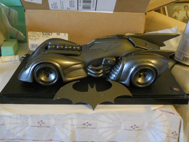

I have been wanting to remold my Arkham Batmobile for awhile because the pattern was slightly off on one of the front wheel wells which gave the car a slight tilt in the front, its slightly visible but it bugged me so I molded it with Rebound 25 and made a Ultracal 30 shell for it yesterday and here is the 1st casting the stance is even. Glad I reworked it because I recieved 3 kit orders and one build and paint for this so now they will get the new improved BV2.
