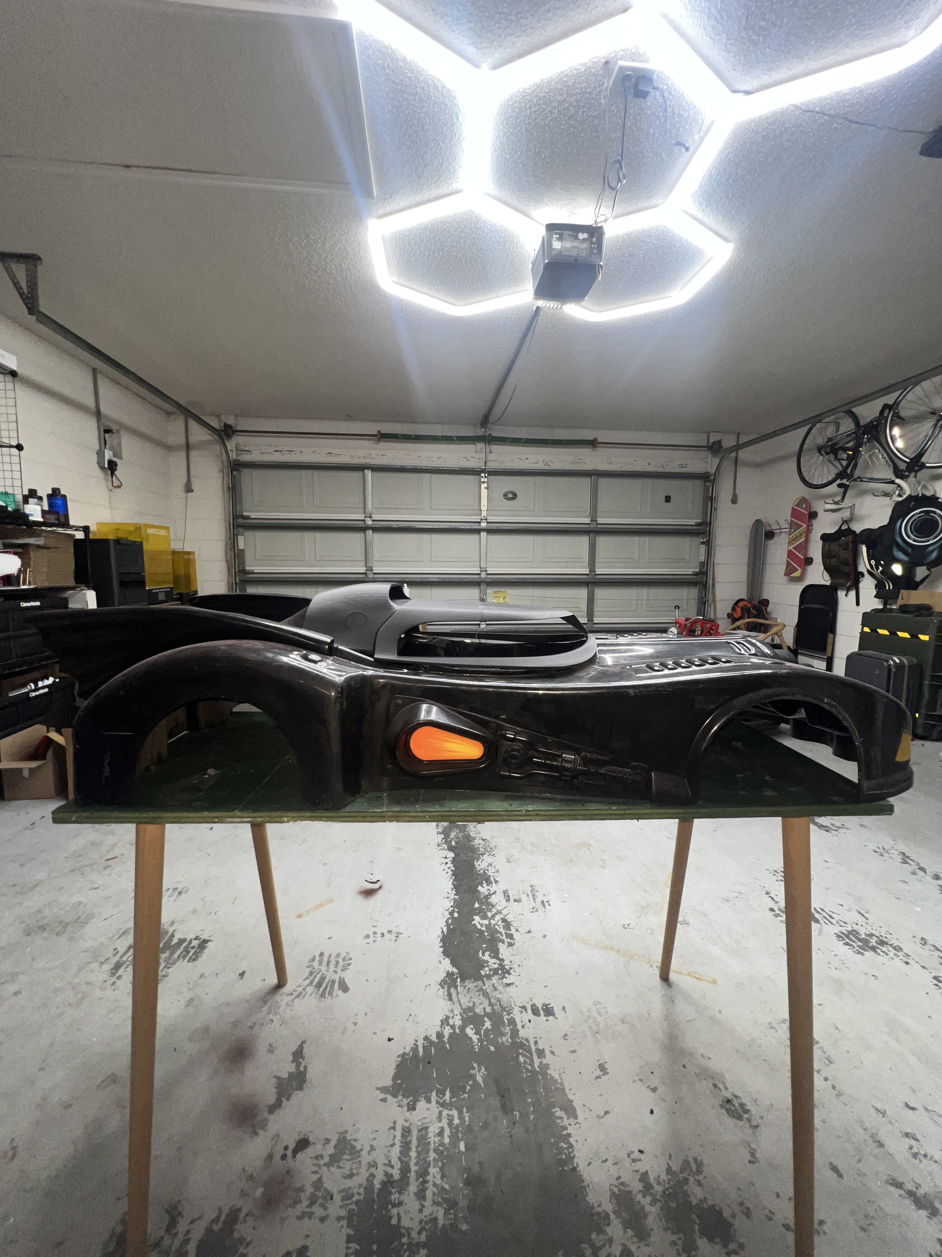

I recently came into a vintage 1992 Batmobile power wheels style (actually called power drivers) that I'm currently turning into a large scaled r/c.

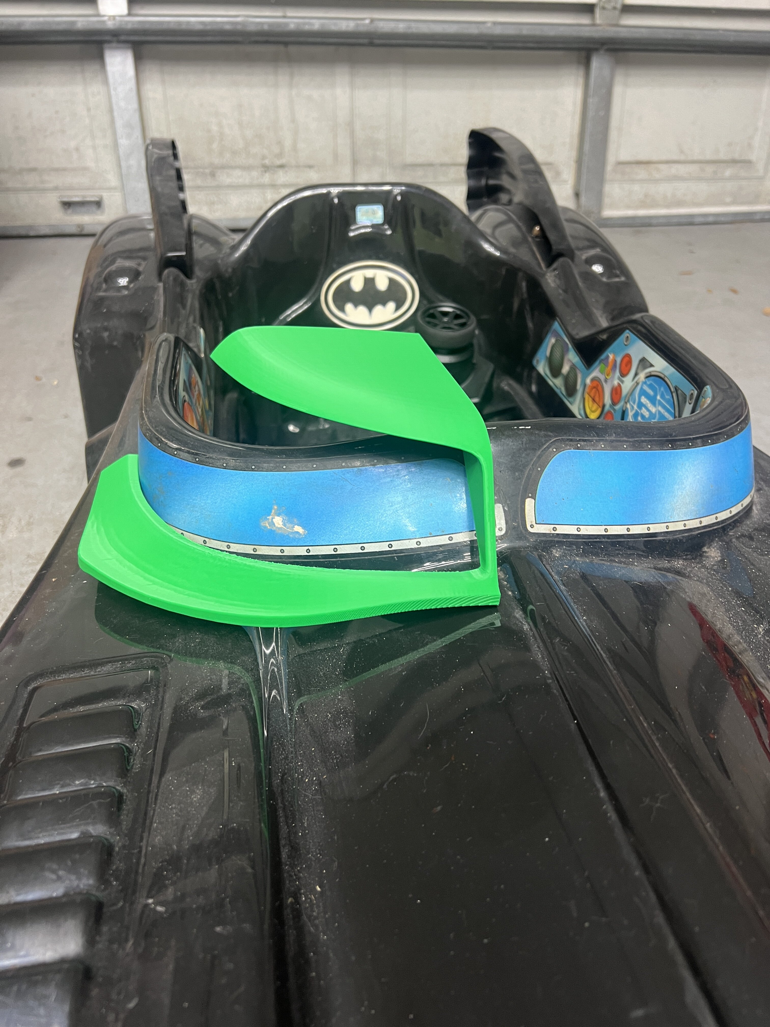

Ordered a Bambu P1s to start prototyping a canopy and rear. With the intention to have the canopy slide forward to allow for easy access of the batteries and random switches I'd need to enable things.
the P1s is painfully fast compared to my resin printer, so it's highly likely I will have a finished prototype soon.
My only concern is having to decide if I want to Dremel out a portion of the existing plastic "window" off the Batmobile. It's pretty thick and prevents the 3d printed parts to sit flushed (Even though the scale i've printed it at is slightly to wide and tall)

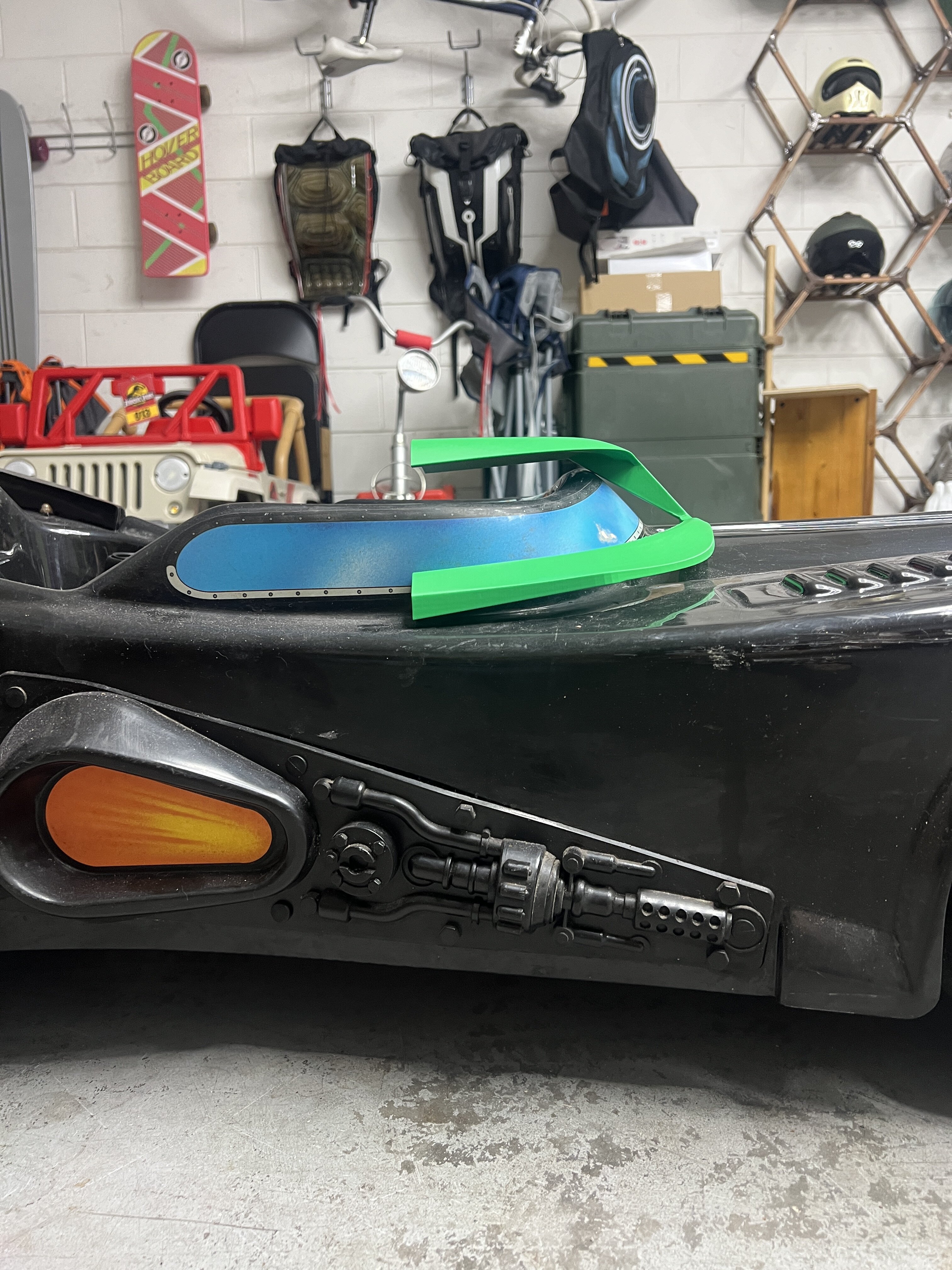

Mini update.
After several several prints at different scales, I finally have a canopy I'm happy with. I'm currently printing the back hood/vent piece so I expect that to take just as long until I nail down the scale.
These are in PLA and will get further prepped for paint before any semi-permanent mounting's done

I do have a question for anyone that' has some knowledge on bodywork (I have none yet).
There's a gap between the canopy and the batmobile shell, about 1/4 to 1/2 inch of space.
What's the best way for me to go about building up a smooth flat surface for the canopy to rest on? Bondo? expoxy?
The sapce I need to build up is on the left side of the "black negative" gap (that's the original semi canopy i cut off).

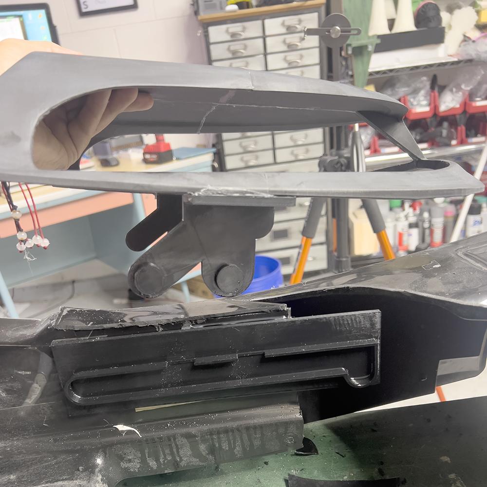

I'm back after a long hiatus.
Took me a long time to iterate on the right approach to get the canopy to slide ( i got pretty frustrated). I've had every sliding mechanism ever produced in my amazon wish list, lol. However, the height/thickness/length tolerances wouldn't have been right for what was needed/allowable on the car.
Then one day, randomly, it hit me, I could just design my own sliding mechanism custom tailored to the car. I couldn't believe how rudimentary it turned out to be.
  • Designed a bracket to mount to the car, with a drop in system so the canopy can come off whenever I wanted. In addition to a sliding arm with two round joints to smoothly travel and stop where I needed it to. Now I have ample space to get into the electronics whenever I want.
    • There's a slight gap between the canopy and the body that's gonna get covered with a foam/rubber trim.
  • Also made tail lights and headlights. (that I have to reduce in size a smidge).
  • Attached the rear canopy vent so It connects to the canopy with magnets firmly.
  • Next is designing a neat housing for all the electronics, speakers, lights and FX.

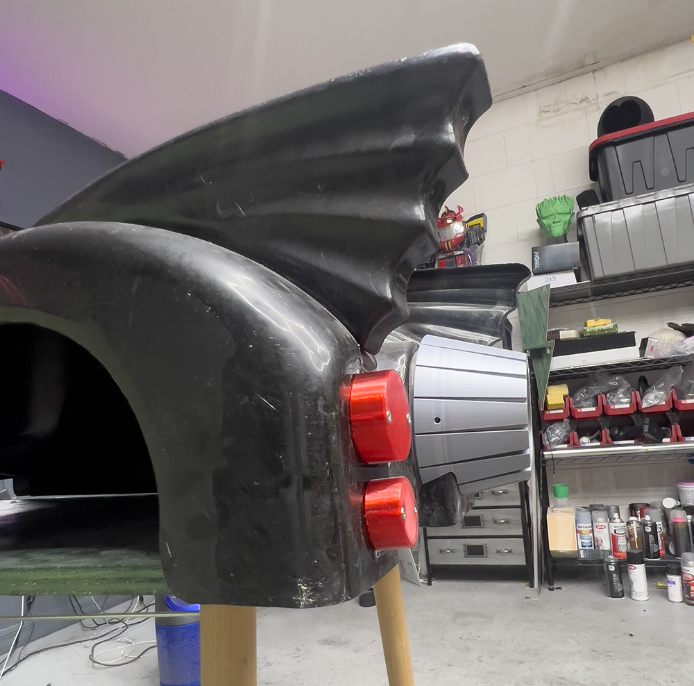

making some serious headway on the car and hope to have an update out in a week or so. Currently designing a custom cage for the atomizer/afterburner effect.

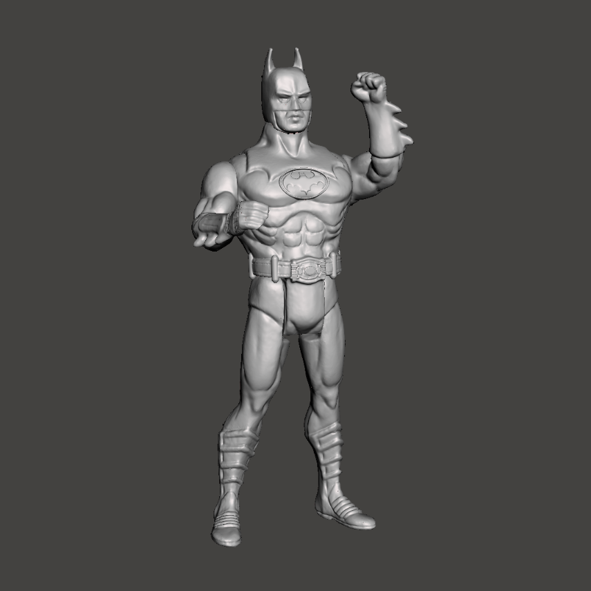

Small update, big progress, The car's 90% done.
Decided i'm basically making a giant Kenner style Batmobile toy, so figured I'd fully commit and make seats and 90s style kenner Returns figure.
Have a few small electronic upgrades waiting to arrive from Japan, but did manage to get a custom throttle controlled smoke generator.
And lastly, the engine simulator speaker system now also plays a modified version of the Batman Theme. (had to buy an old PC laptop to run the software to customize its sounds lol)
Hope you're all enjoying this build, it's been challenging but fun.
