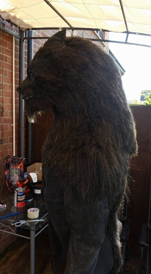

I spent a few hours yesterday dirtying up the hair on thehead and also on the upper parts of the Lycan, Making it look grimey and matted....I used a thin latex wash pigmented black and just dug the brush into the hair and thrashed it about to give it the desired look and the latex will also keep the majority of the hair in a dirty, matted state....So no need for vast cans of hair lacquer...LOL....
The upper torso (FRONT) now finished and the hair matted and dirty looking...
The upper torso (BACK).....
The front view with head attached......

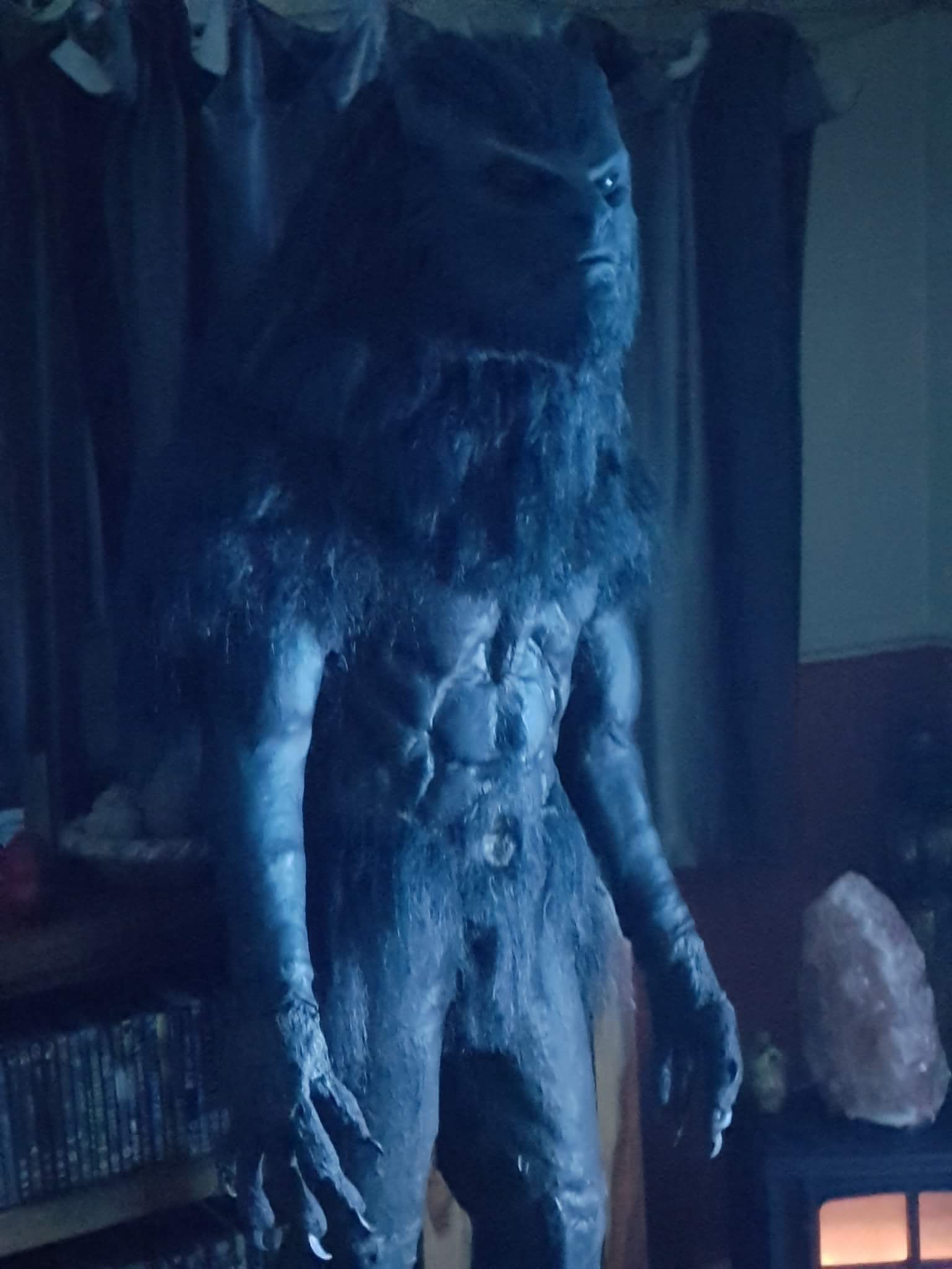

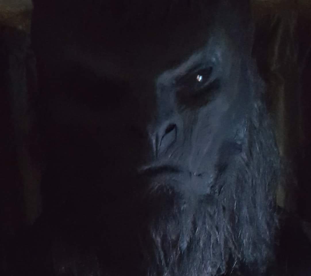

I sincerely apologise for the lapse of updates in regards to this costume project the last few weeks have been hell...Tragically we lost one of our Dogs to Cancer, in the same week a very close and dear friend was diagnosed with terminal Cancer and given a few months of life, Sadly our friend passed away just over a week ago and last Monday we tragically lost another of our Dogs to Cancer..so it's been pretty traumatic past few weeks for both myself and my partner.....
I've been doing what I could when I felt up to it....I could not find the correct looking Blue Pupils for the black eyeballs, so I used brown ones instead.. Gutted I couldn't find em but nothing I could do... I've also broke away for the classic "Underworld Lycan"...(Yah I know I'm gonna get slapped for this.. LOL) I've had to add hair to the forearms and the front/upper areas of the thighs as the dread scourge namely creasing at this areas, I'll trim back these areas as much as I dare so it you can still see the under skin but softens the look and takes the eye away from the dreaded creasing.....
I've also altered the ear position by moving them slightly forward and inward.. They look a bit than they originally did, Also attached the hands to the wrists with black elastic for ease of fitting when the costume is being put on...you can't see the join/s under the hair and I also plan to make wrist shackles with attached black plastic chain (Painted a steel/gunmetal) so it looks like he's just broken free and on the rampage.... These will further hide the join between the hands and wrists of the costume...
Well that's about it for now, more updates as and when they happen,
A few photo's of the "Lycan" as he looks now.....

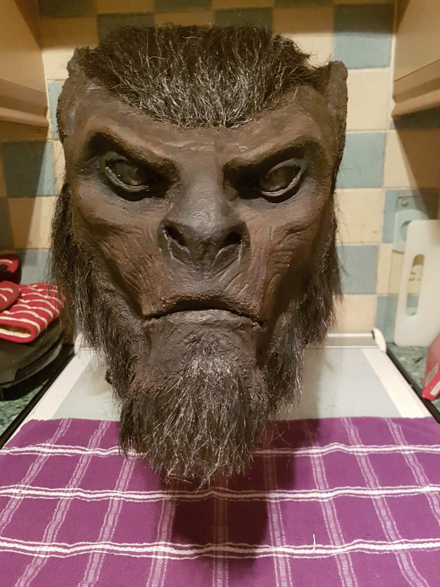

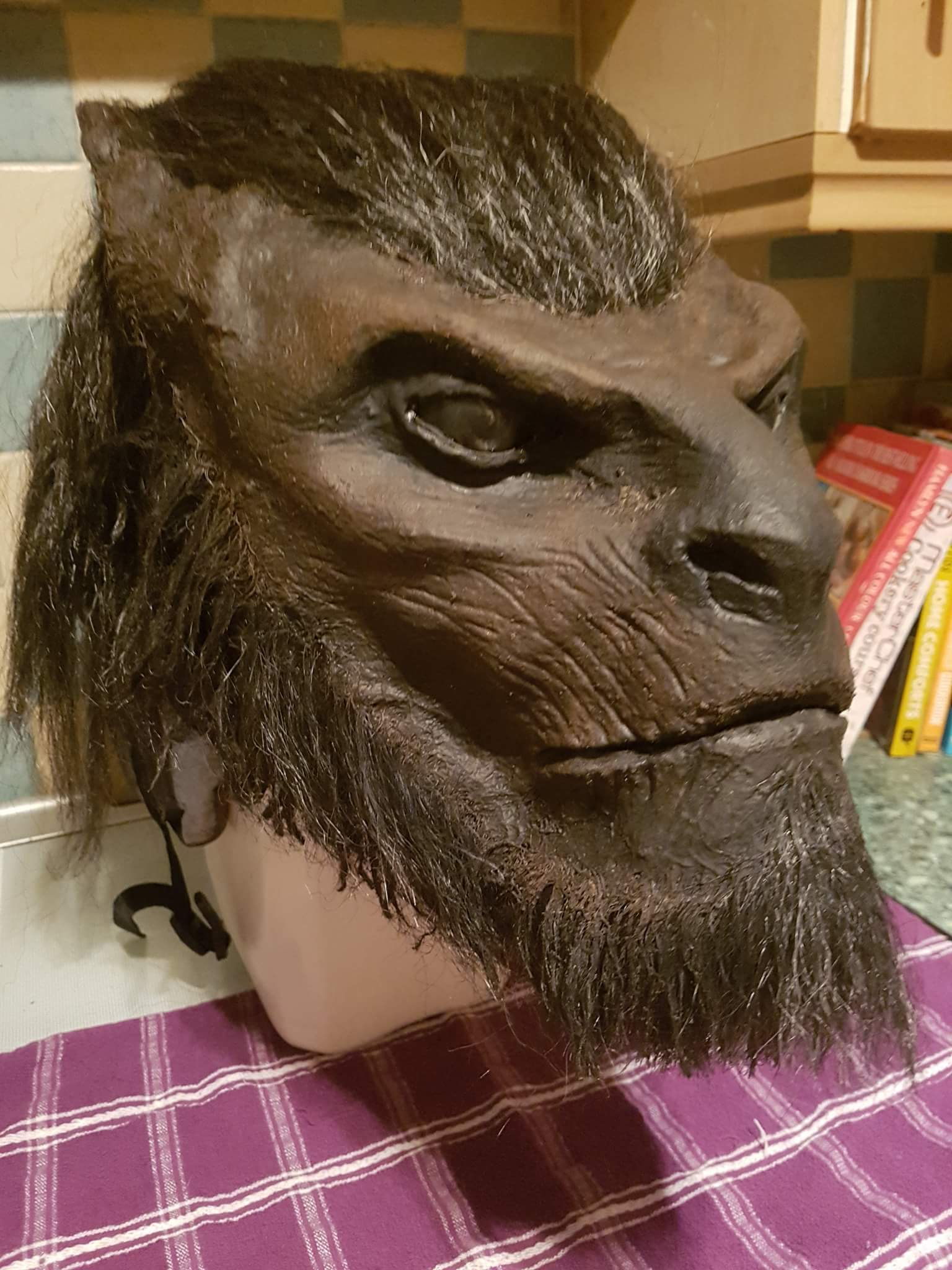

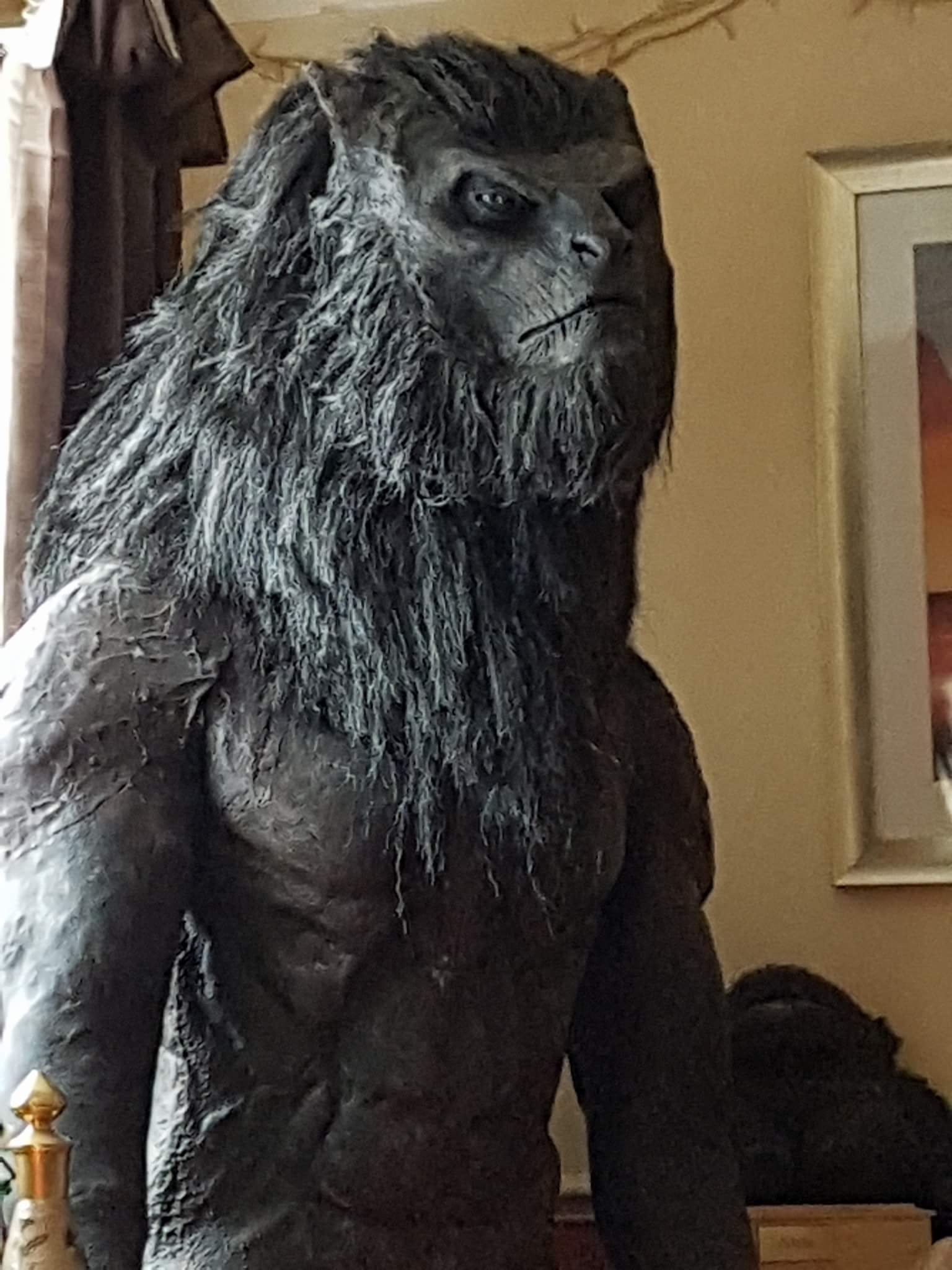

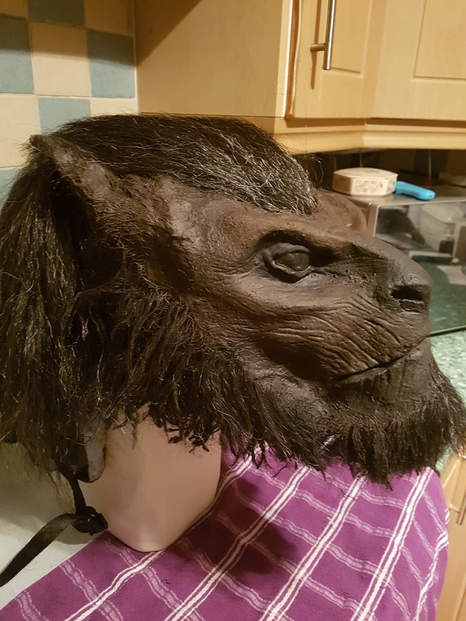

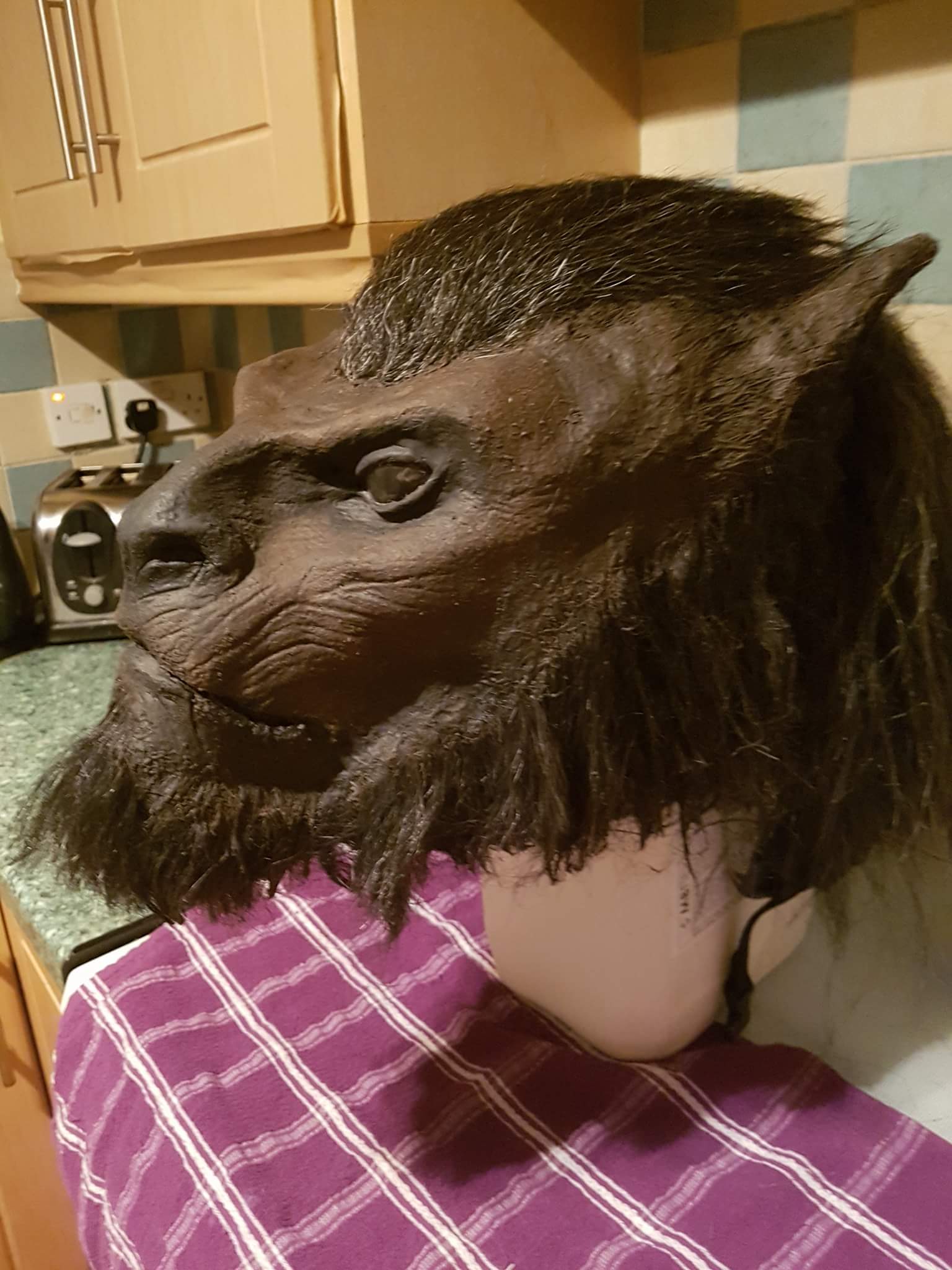

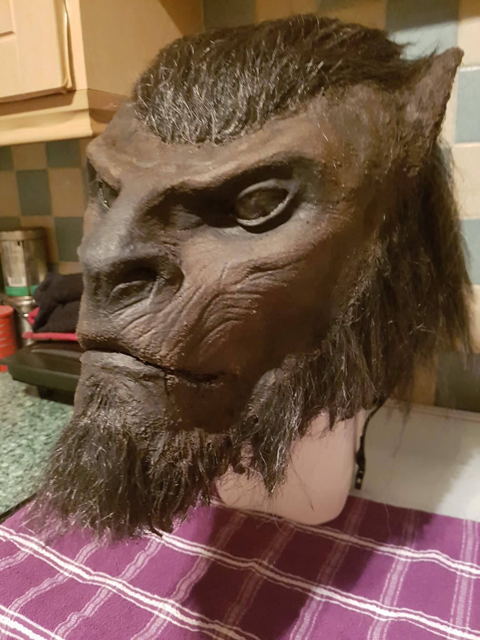

So it's been ages since I last posted on this costume project, It lapsed due to A few issues and health scares which has to take priority. But last year I made a new start on the build, Completely scrapping what I had previously done as to be honest and I admit that it looked and felt wrong..
I have re-done everything, Sculpting, Molding and cast a new face and head, body, arms, Hands and legs, It was hard at time and nearly drove me bats! So now the new replica costume is about 90% complete with only the lower legs and feet to finish up on and then add the remaining hair to where it's needed..
Photo's will follow as soon as I can upload them..??!!
