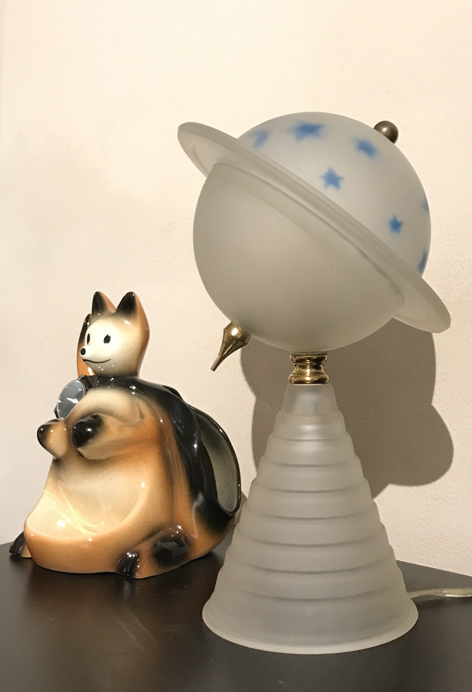

Hello everyone! Long time lurker, but I finally registered. I am hoping to get suggestions regarding possibly painting my clear Saturn lamp to match the green of the lamp as seen in Twin Peaks.
Here's mine. I had originally thought it was the 1939 World's Fair Saturn lamp, but after further research I believe it is the Sarsaparilla reproduction:
And here is what I'm aiming for:
I'm a bit of a newbie when it comes to things like this, so I'd greatly appreciate any suggestions!

I have a few questions.
1. Are the stars painted onto the plastic
2. Is it even plastic
3. Have you tried changing the bulb to a green bulb and seeing the effect from that?
The lamp is made of glass, and the stars are painted on. I’ve thought about trying a colored bulb, but I’d like it to match colors even when it’s not turned on.
Would it be possible to use paint stripper to remove the stars without damaging the actual glass, and then maybe use translucent green paint on the inside paired with a green bulb?
Alternately, sell this one and put the funds towards the genuine article. I suspect it will be really hard to get a satisfactory effect with paint and lights.
I've painted one of these.... no problem. Painting the inside is a bad idea... wont look right.
