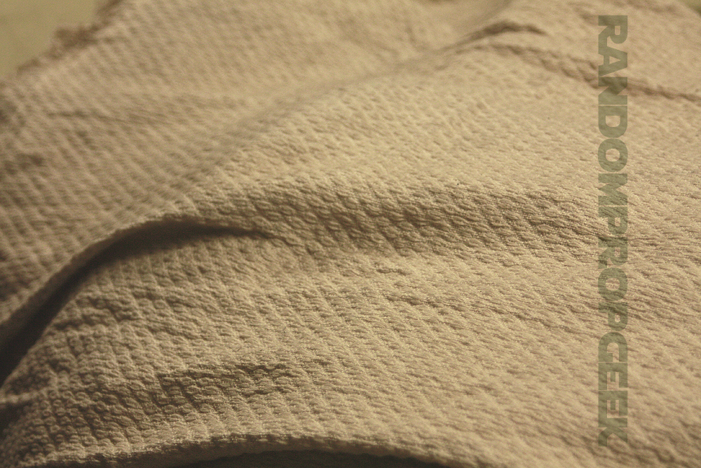

Talking PD Tusken robe fabric: I didn't spot any near close weave pattern on any costume build i found on the net. Monkcloth seems to be kinda near at a quick glimpse, waffle pique also from a distance, but really not satisfying in my opinion. I read somewhere about blankets with a similar weave than the PD Tusken, but couldn't find any. So by chance i got some yards of cotton fabric from a friend who's a tailor and fabric collector. She brought it from one of her journeys, but couldn't remember where she picked it up. Long story short:
Quick update: Talked to my friend on the weekend about the fabric. Guess what? When i mentioned Tunisia she was all on it. That's where she got the fabric from...
The monks cloth is a close substitute but still way off from the original fabric. I think I read somewhere that it may have been sourced locally in Tunisia.
This fabric you chose is super nice. A lot better looking than the RL blankets I’ve seen used as well.
