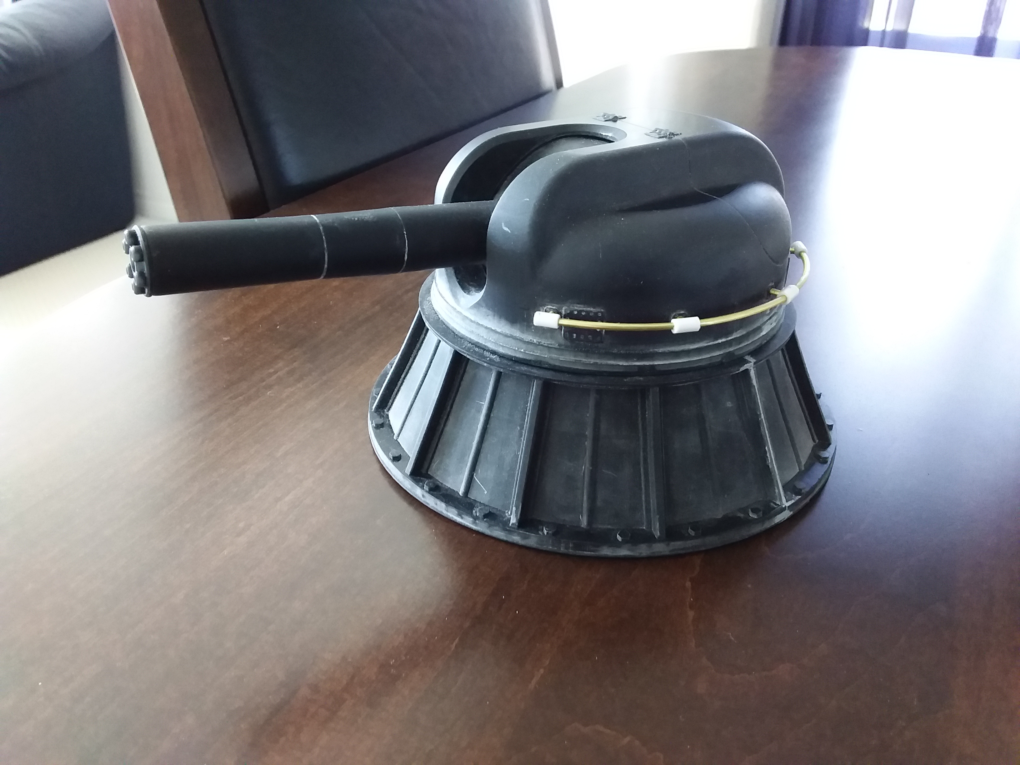

As some may have seen, I have made a SS Death Star Turbolaser, still working on a 1/9 scale Phalanx CIWS.
I bought the Takom AK-130 and the Kashtan.
I have a problem starting stuff and not finishing it. Probably ADHD.
So I have started designing a 3D printable DS turret base, so I can use some of the spare parts accumulated over the years. I will probably have to design some 3D parts that I have no kits for. Most of the greeblies are simple enough...but there are a lot. Some of the kits are still available at a fair price.

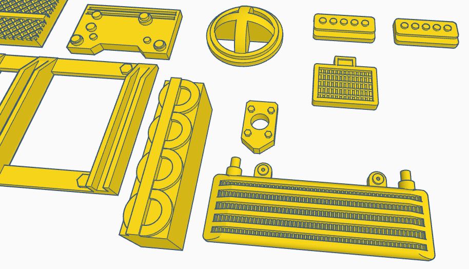

TazMan2000

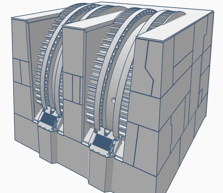

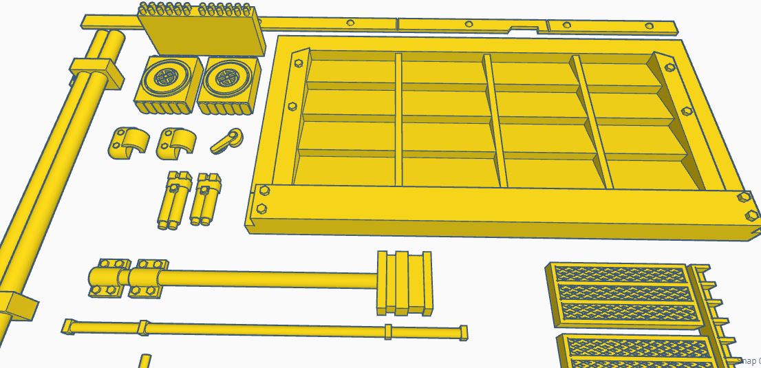

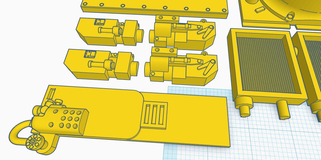

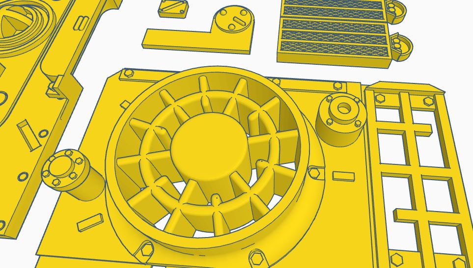

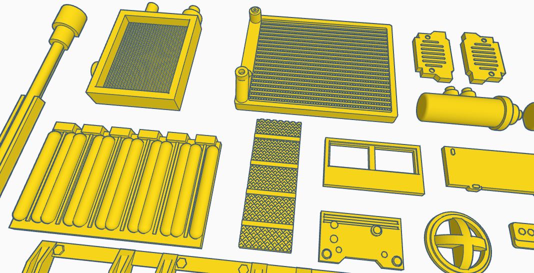

Working on the turret greeblies. I downloaded the nurnies from the Dave Goldberg TESTED model, but it didn't find them the correct size and either there were some import problems, or the parts did not covert correctly, but they just didn't work or weren't high definition. (Were they scanned?) So I just designed my own...but even these aren't perfect even though I worked from a micrometer.

This is one of the Goldberg greeblies imported into TinkerCad. Did this work for anybody else? Maybe just a TinkerCad import issue. Generally useless for me as my resin printer will recreate the bad artifacts.

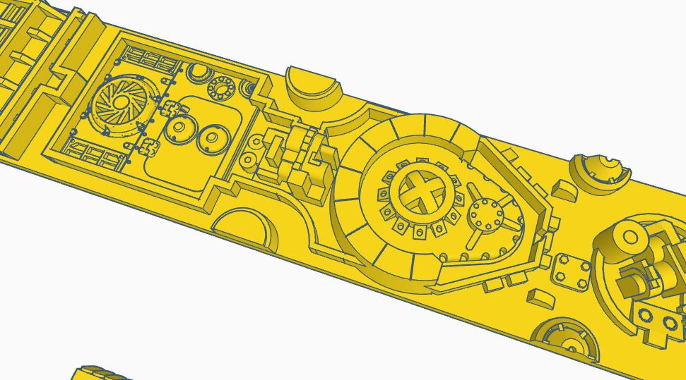

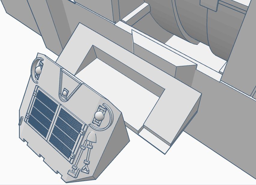

A little improvement on the printability of some of the pieces. Currently working on the top greeblies. The guns and their details are going to be a lot of work. I'll probably segment the guns, so that it could be printed easily on a resin printer without or minimal supports.
As you see, I'm making this 3D model with shields so you can't see anything inside, which I think would take away from the "displayability" of the model if you can see the insides.
I had to take a few liberties with the accuracy of the greeblies and their placement to aid in "buildability". I corrected the gun rotational axis based on the original. It is offset by about an inch or above the center axis. This should be a lot closer to the filming model.
When I originally build my kit from Wasilli, I didn't do my research and incorrectly mounted the guns.

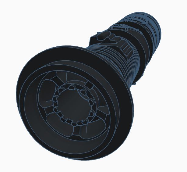

TazMan2000

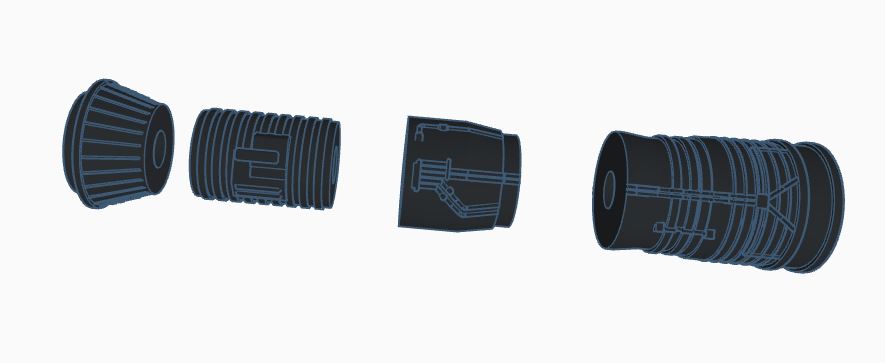

I'm working on the guns now. The piping details may look a bit dirty, but the tiny errors will not be visible after being printed on a resin printer. I'm thinking they may even look better than the original Mig-21 Engines since these ones will not have sinkholes.
The print sections are segmented for ease and quickness of print when printed vertically. They will slide over a 8mm brass rod. I still have about a 1/3 of the gun to go. I will elect not to model the details on the very lowest section of the gun, since it will never be visible anyway.

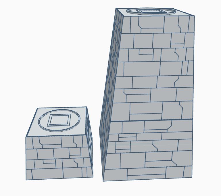

TazMan2000
I'm mostly done the towers both small and tall. I'm thinking of adding an extra piece to the bottom of the tall tower with about a 45 degree taper. As it is, the tower side is 657mm tall by 382mm wide, which means that this won't fit on any FDM printer I'm aware of. Even on mine, with a 12" bed, I'll have to break each side into 5 pieces. The top will accommodate a 3" swivel plate (lazy susan bearing).

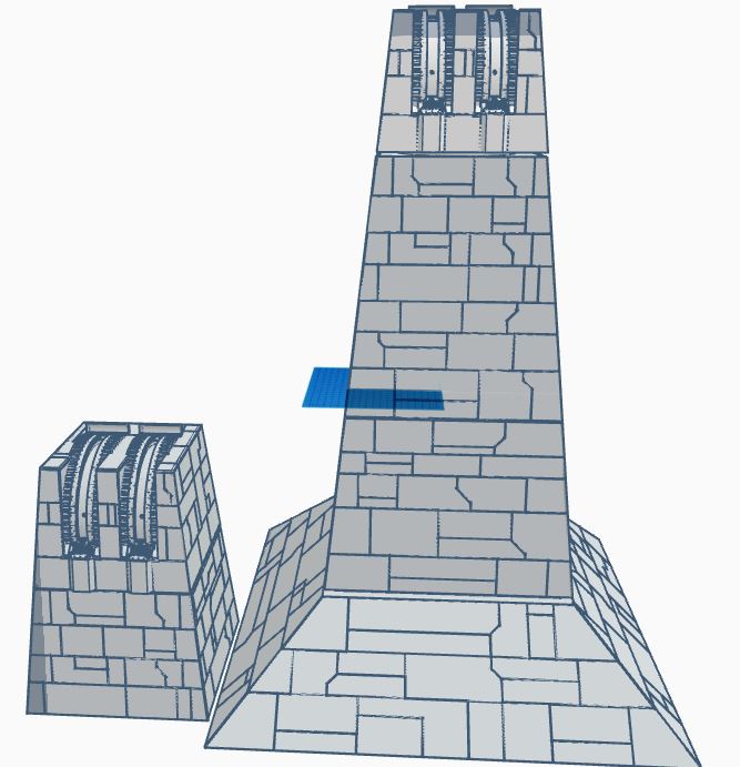

TazMan2000
Size comparison. :lol:
The large tower will be about 1.4 metres tall, if someone wants to tackle that.

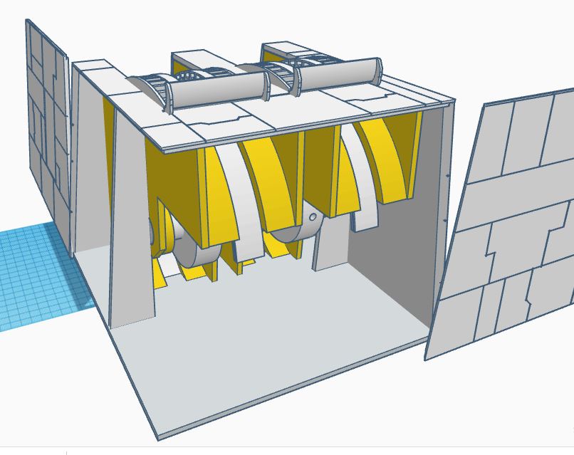

I reworked the turret and now there is room to have it motorized. It will also be a lot easier and faster to print.
View from the back.

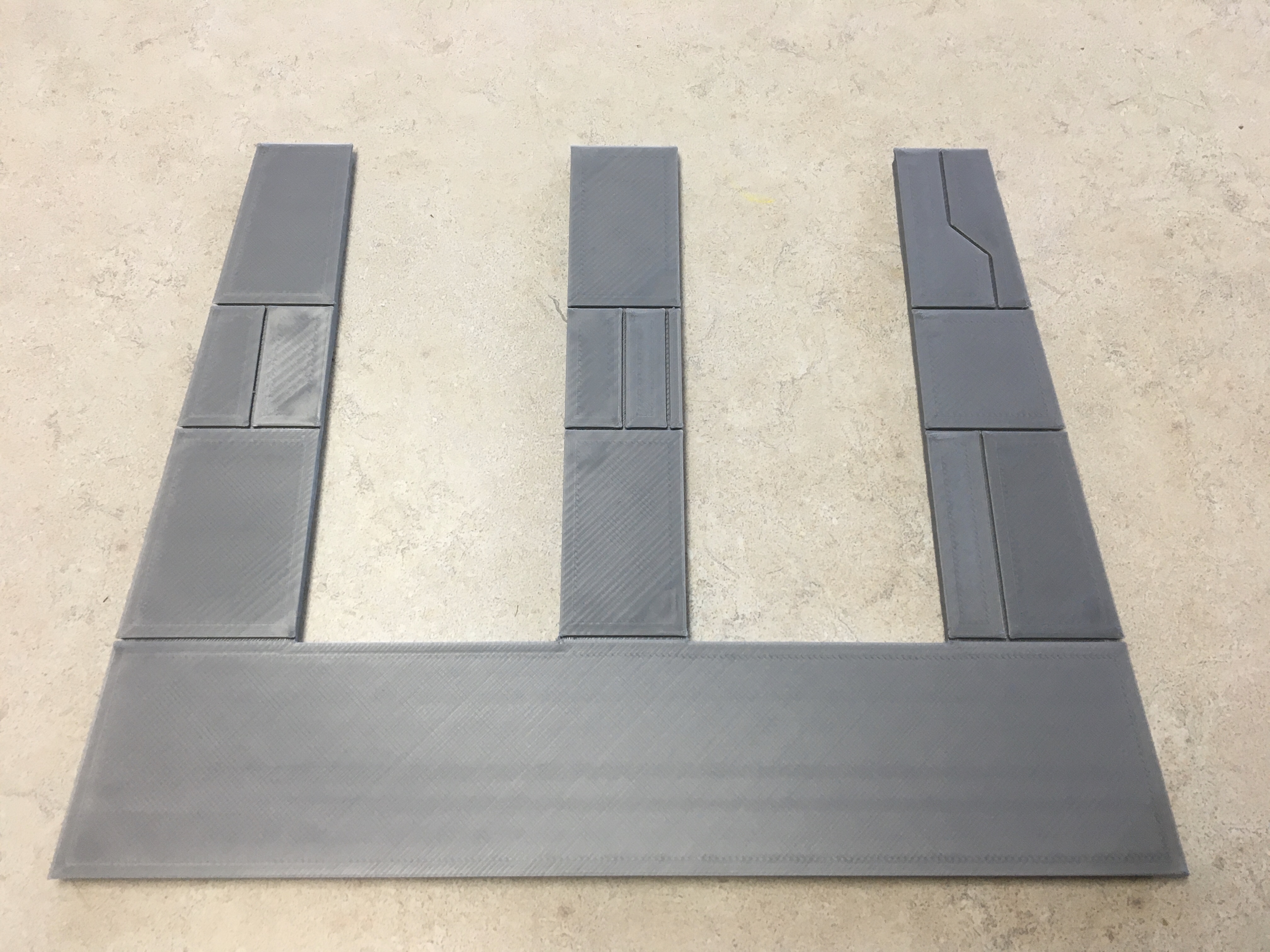

This took 10.5 hours to print with ironing enabled and with a 0.5mm nozzle, but it turned out pretty good. I was afraid that the ironing would obscure the panels.
TazMan2000
I do not have an FDM printer, but out of curiosity what is "ironing" supposed to do?
The printer goes back and forth over the top layer with the hot nozzle (without extruding any filament ***edit***a small amount) effectively ironing out the top layer of filament. It doesn't smooth it out completely, but it saves a lot of sanding work, since the top layer isn't as bumpy as it would be without ironing.
If there is fine detail or inset lettering on top, ironing could obscure it, so there is a danger there.
