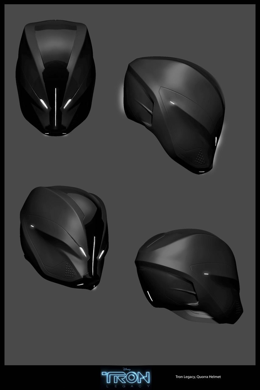

Anyone going to attempt to build a Quorra Helmet?
I was planning to, but not for the premier. I think the best way is to pepakura, but I am a noob in that area. I can can 3d model, but haven't done organic shapes. I think the best way is to slice it in layers in 2 dimensions and then surface it with triangles (via sandbox tool in sketchup). Export to google earth and import to pepakura. After tons of work, gut a digital camera for the heads-up display.
For the premier, I've got this going:
I'm still waiting for the El lighting, but I'm concerned that any applied lighting would look "surface applied"
I may have to cut the shell to recess the el wire.
