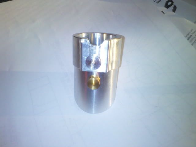

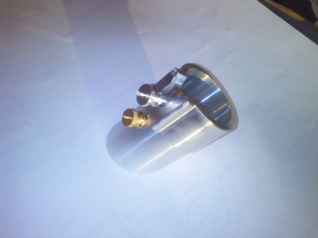

Also, the Delrin stock has finally all arrived. It was arriving in small doses over a period of time for some reason, but it's finally all here now. Here is the stock that will make up the "bulb release" and the grips:
These will make the clamp rings:
And these will be the covertec knobs:
By Wednesday, he'll be doing the final shaping and drilling on the shrouds, assuming his new computer is up and running, so I will try to drive back down then and get more shots of their progress.
