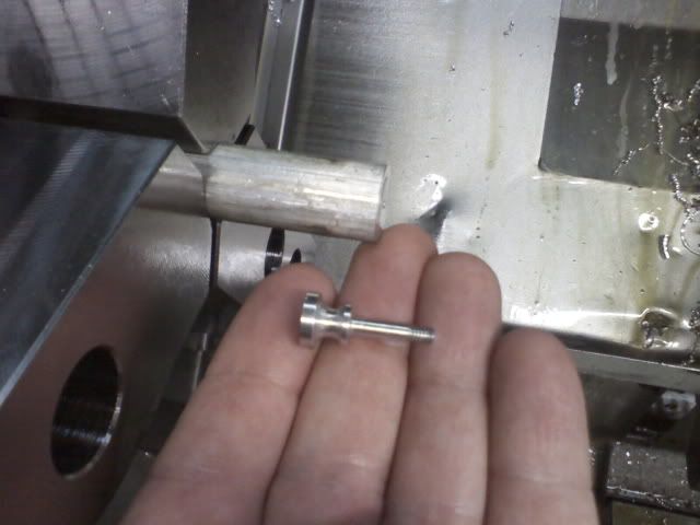

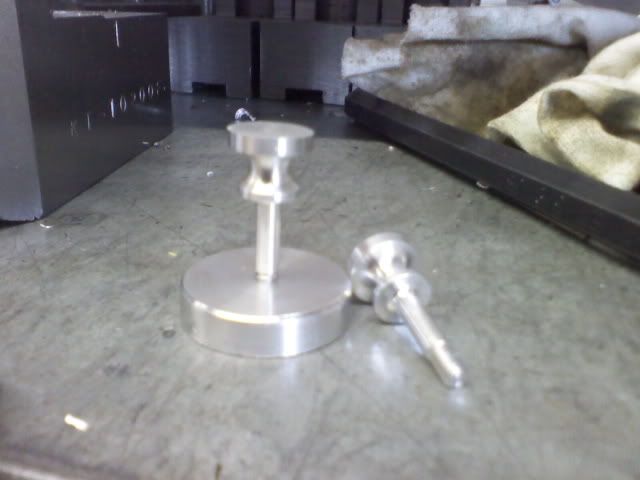

Holy crap, I have photos of something that's not a cylinder!
BEHOLD!
Well...it starts off as a cylinder:
But then ends up all knob like:
Those are test shots. The finished knob will have a slightly thicker threaded post, and the head will have a subtle radius along the currently sharp edges to match the screen used one.
And since they're so tiny, he was able to run one without the fluid so that I could take a neat video for you...well...neat if you like watching 4 1/2 mins of a dizzy piece of metal getting smaller:
CLICK THE VIDEO

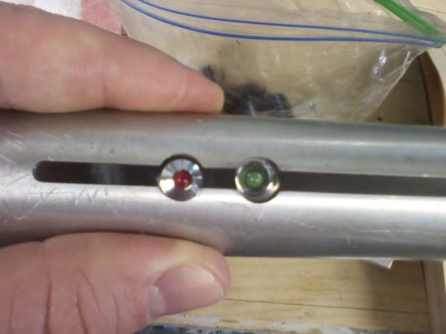

Also, I stuck the LEDs into the Chen body that I have just to see how they looked. The LEDs that came with the Chen saber, though very nice, are not quite shaped right, but I think mine match the hero saber:

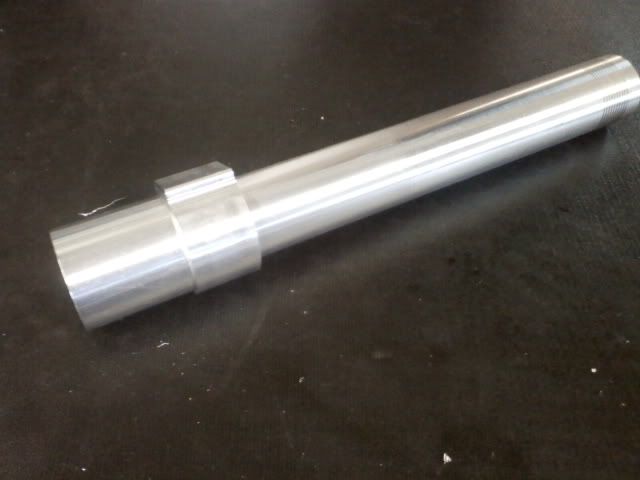

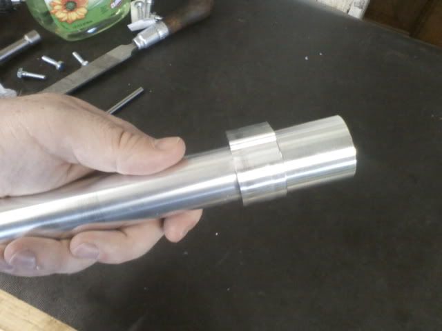

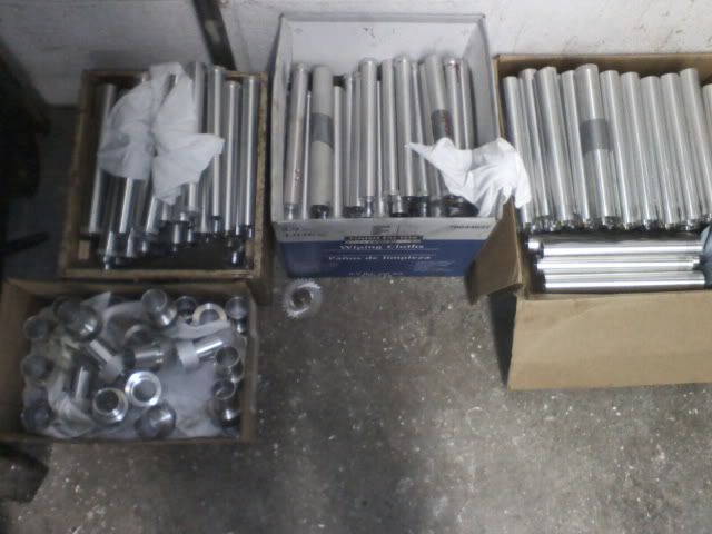

And here's the pile of nearly complete inner and outer bodies and shrouds. They're just awaiting repairs on his indexer before they can be finished:

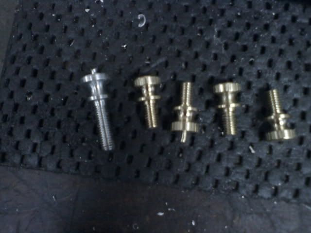

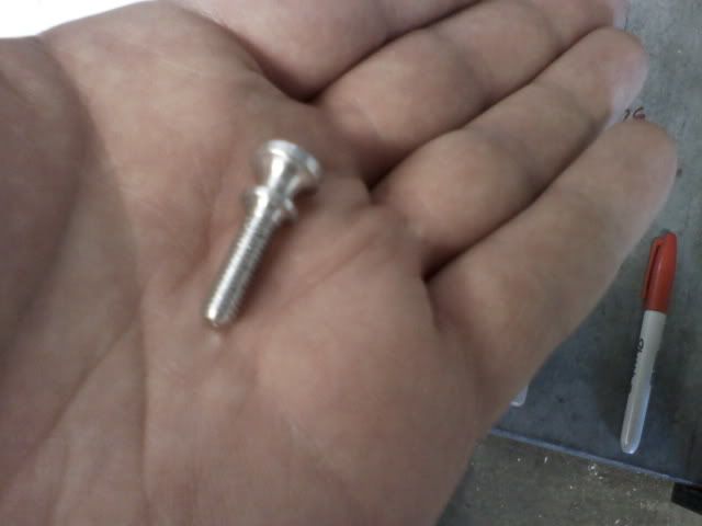

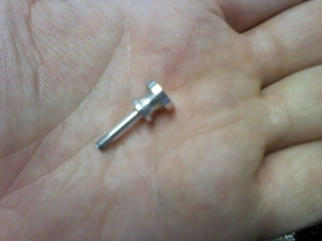

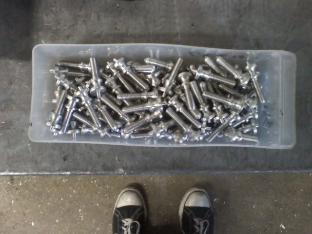

All the aluminum knobs are finished (minus some clean up), and it looks like he made a few extras, so if anyone needs a spare for a custom saber, let me know and I might be able to hook you up. These double as the blade retention screw, which is why they're so long. They'll go through the Delrin "bulb release," through the shroud, and through both outer and inner body tubes.
The brass knobs will be getting worked on soon, but he's waiting on a custom knurling tool to be be made for him, because apparently, nobody at the LFL prop department likes to use standard sized anything.

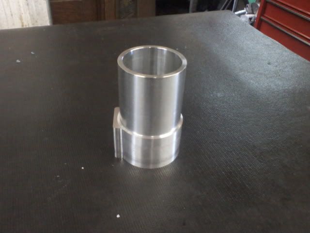

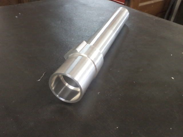

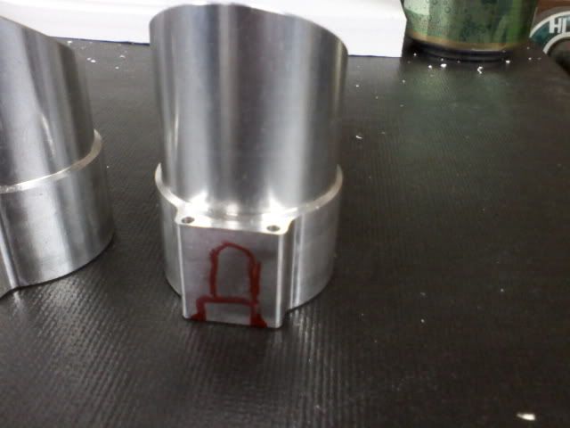

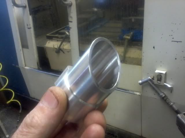

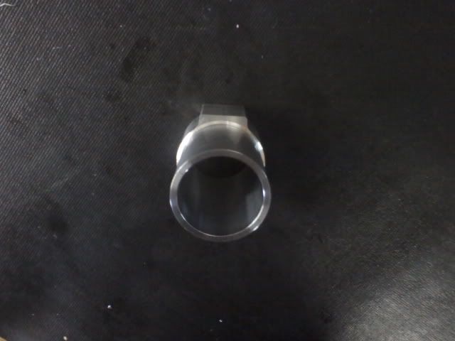

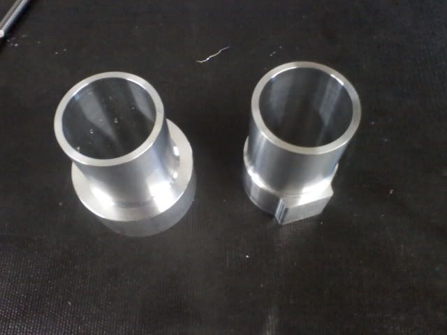

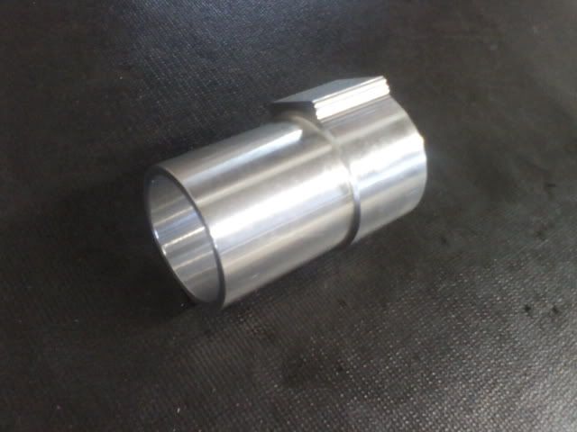

The shrouds are currently being worked on. I posted pics a while back of their roughed out shape that was done on the lathe. Now they're being refined in the milling machine. The box shape on top that the wire loop goes into has now been formed, and the diameter of the neck is at the correct scale.
The radius where box meets neck is too shallow in these two shots, but has since been corrected:
And here she is as she looks now, which is about half finished:
Before and After:
And attached to a body:
Next he'll be milling in the little horseshoe shaped channel that the bulb release fits into, drilling the holes for the wire loop and knobs, and then shaping the rear as well as adding the angled cut to the front. Stay tuned for more soon.

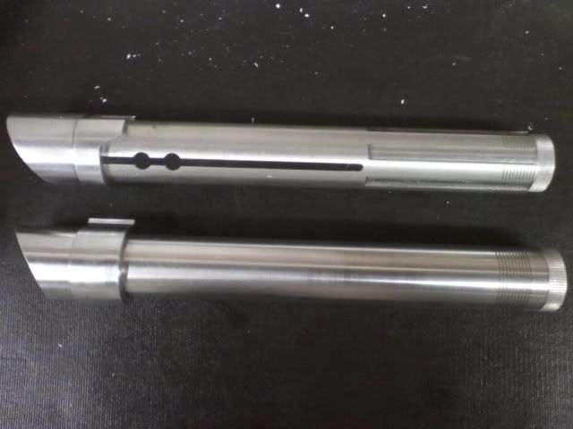

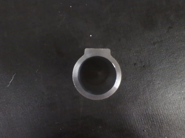

Angles cut into shrouds:
I'll get some better shots on Mon or Tues. These were just emailed to me from the machinists phone. The custom knurls should be in this week to start on the brass knobs.

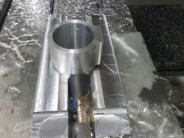

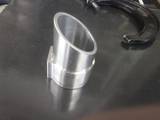

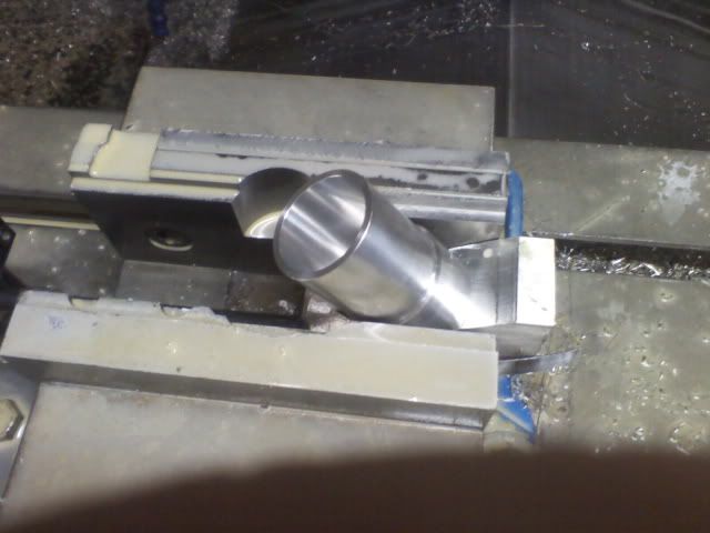

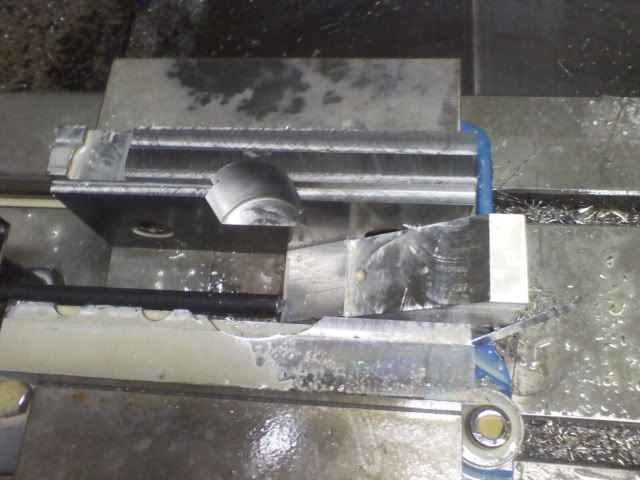

Here are some better shots of what's going on with the shrouds.
Here is the custom jig that was machined to sit the shrouds on so the correct angle is cut, while keeping it aligned with the box on top:
And an uncut shroud in place:

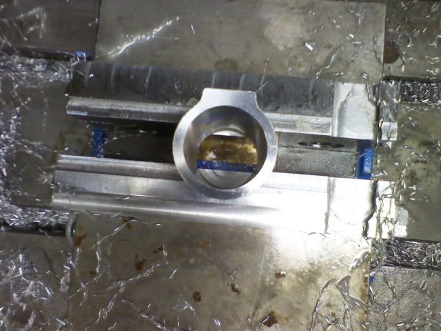

Unfortunately, locking it into the jig caused the shroud to get bent about 1000 - 2000ths of an inch, making it very very difficult to slip them over the main bodies. So he tossed some stock on his manual lathe and made a solid 1.25" plug to fit into the shrouds while they're in the jig:
The shroud, with plug, in the jig:

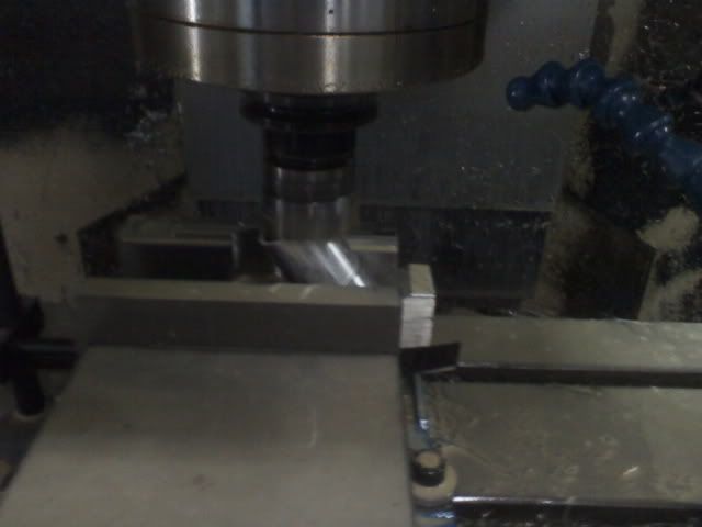

And milling:
And now the plug makes the bottom water tight :lol

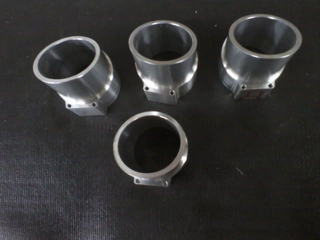

Front angling finished:
Before and after:
After After:
Starting to look like a saber!

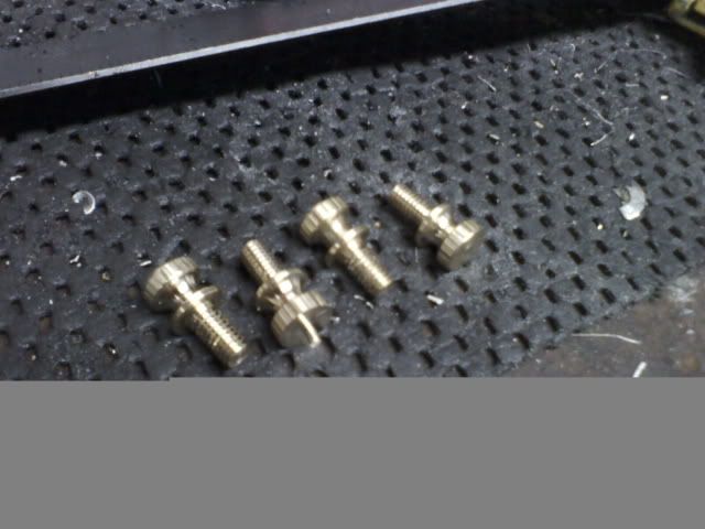

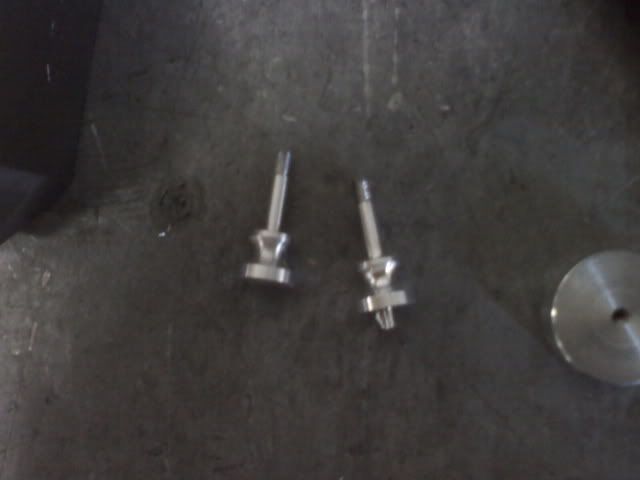

He also started work on the brass knobs. The shape is spot on, but the knurls aren't. He was using a set he borrowed from another machine shop on the off chance they worked. Unfortunately, they don't so he's still waiting for the ones he ordered to come in.
Next to one of the aluminum knobs:

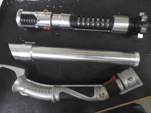

And Ki Adi Mundi from FX-Sabers requested I snap some shots of my saber next to some other sabers. I figured I'd share them with everyone just for fun.
My Ki Adi Mundi saber, and a screen accurate Qui Gon:
Ultimate Anakin Starkiller OWK TPM & a resin Dukoo taken from production molds:
The Chen Anakin (mine looks longer because there is still material that needs to be trimmed off the bottom by the rings):
