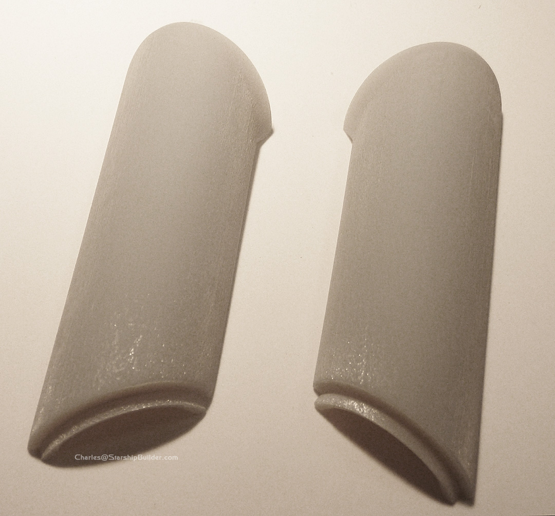

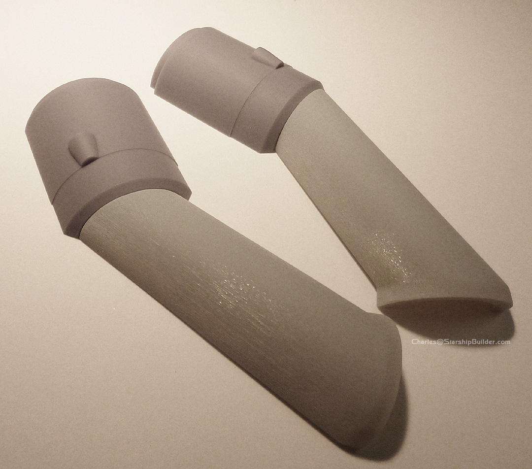

My client and good friend Phil ("Wombat" over at StudioScaleModelers.com) commissioned me to recreate the original parts as closely as possible.
Starting with my 3D recreation of the Galactica studio miniature's engine section, I positioned the outlines of the parts to match the photos. I then built them in 3D.
When finished, the parts were exported to STL format and printed. They are now being molded so that castings can be made available.

PS For those who are curious about the printing process, the four main parts came out so perfect they could have gone straight into rubber. (The photos show the "raw" parts as I received them.) I primed them with Tamiya fine white primer anyway just to be sure.
The tube parts were printed with a different process to save money (since they had no surface detail). Even though in the pics they appear to have a texture, they are actually very smooth. After priming, I noticed what appeared to be fine "cracks" near the edges (where the curvature is steepest). This is simply the result of the layering process. A little touch-up putty and another coat of primer and they will be ready for rubber.
