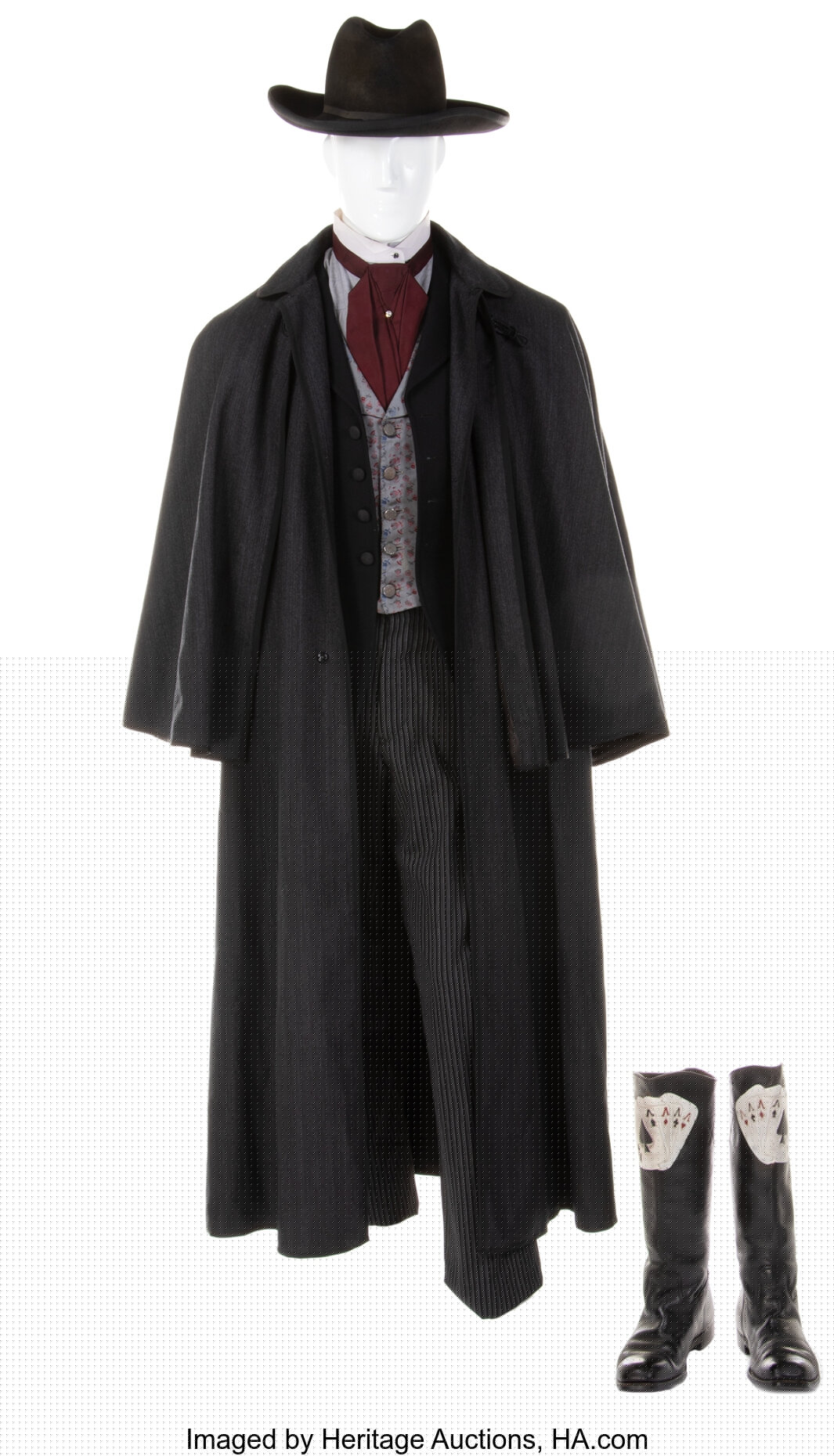

It's hard to tell for sure on the screen-used version but both the coats we've seen in auction photos do have buttons too. This one (definitely not screen-used as it only has one toggle on the cape, at the top) has a button near the bottom of the cape, and I can make out what appears to be another buttonhole on the opposite side near the middle:
And on this one, which might be the screen-used version, I can see a buttonhole at the top under the collar and what looks like another in between the top button on this coat and the bottom button we could see on the other:
So I think it's probably got three buttons, but they're very small for a coat like this and spaced pretty far apart. I'm still debating whether to use accurately sized and placed buttons on mine or to make them larger and use 5 or 6 like this sort of coat would normally have.

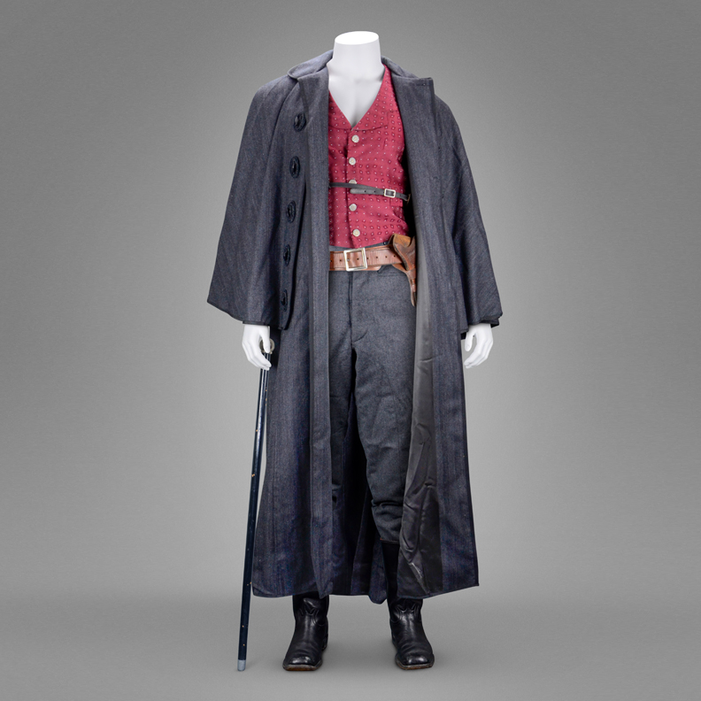

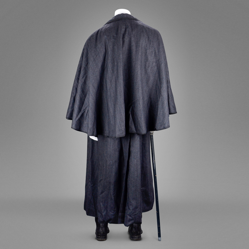

Okay, here is my observation on this. What you are referring to as the sleeve is actually the backside of the cape as it has a sheen to it matching the lining of the entire cloak. If it were a sleeve, one would assume it would be made of the same fabric as the cloak. To me this looks like the back of the cape has been brought up and got caught between the front of the coat and the opening of the cape.
As for the cloak that is in the photo with the vest we are trying to recreate, I am 99.9 % sure this was an alternate cloak. I know first-hand several things were made, and certain ones were chosen to be used in the movie. This cloak is not as elaborate as the one used in the movie. If you look real closely at cloak number two you will notice a few things. First off, Doc never had a collared shirt like that (all of Val's collars were wing tip collars). Second, Doc never wore those pants in the movie. Third, the hat is just one that they had picked out as a possibility for Val to wear but chose to go with a different one (thank God). Obviously, Val never wore those boots as they are very close to the Curly Bill boots. I truly think the ONLY things in this photo that were used in the movie are the vest and the cravat, everything else was just a possibility but just didn't make the cut.

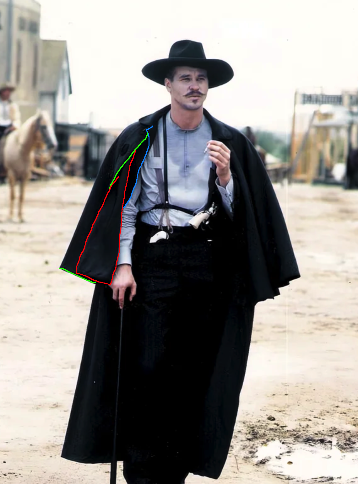

Hmm, you might be right about the 'sleeve', I initially thought it was the same material as the rest of the coat but looking again it does look slightly shinier and like the fabric is creasing differently at the bottom edge which makes me think it could be a lighter weight fabric.
The Val photo, definitely has an extra coat. Great demo with the lines JohnHolliday .
The part that made it difficult for me was the last manny photo was displayed in such a way as to make it look like the cape WAS sleeves because it has been tucked purposely to wrap around the wrists. But, no actual suit jacket is present in the manny photo:
But, it does make it clear to me (sorry for coming to this party so late) that the long overcoat has armholes. The manny arms are through the long coat but under the cape, yes?
If the outfit at the bottom has all the same pieces as Val's photo..... I am right back to no sleeves unless they are completey hidden in the manny photo.
Yeah, a coat without sleeves would still have an under-layer underneath the cape with armholes, like this:
I'm leaning towards no sleeves now too.

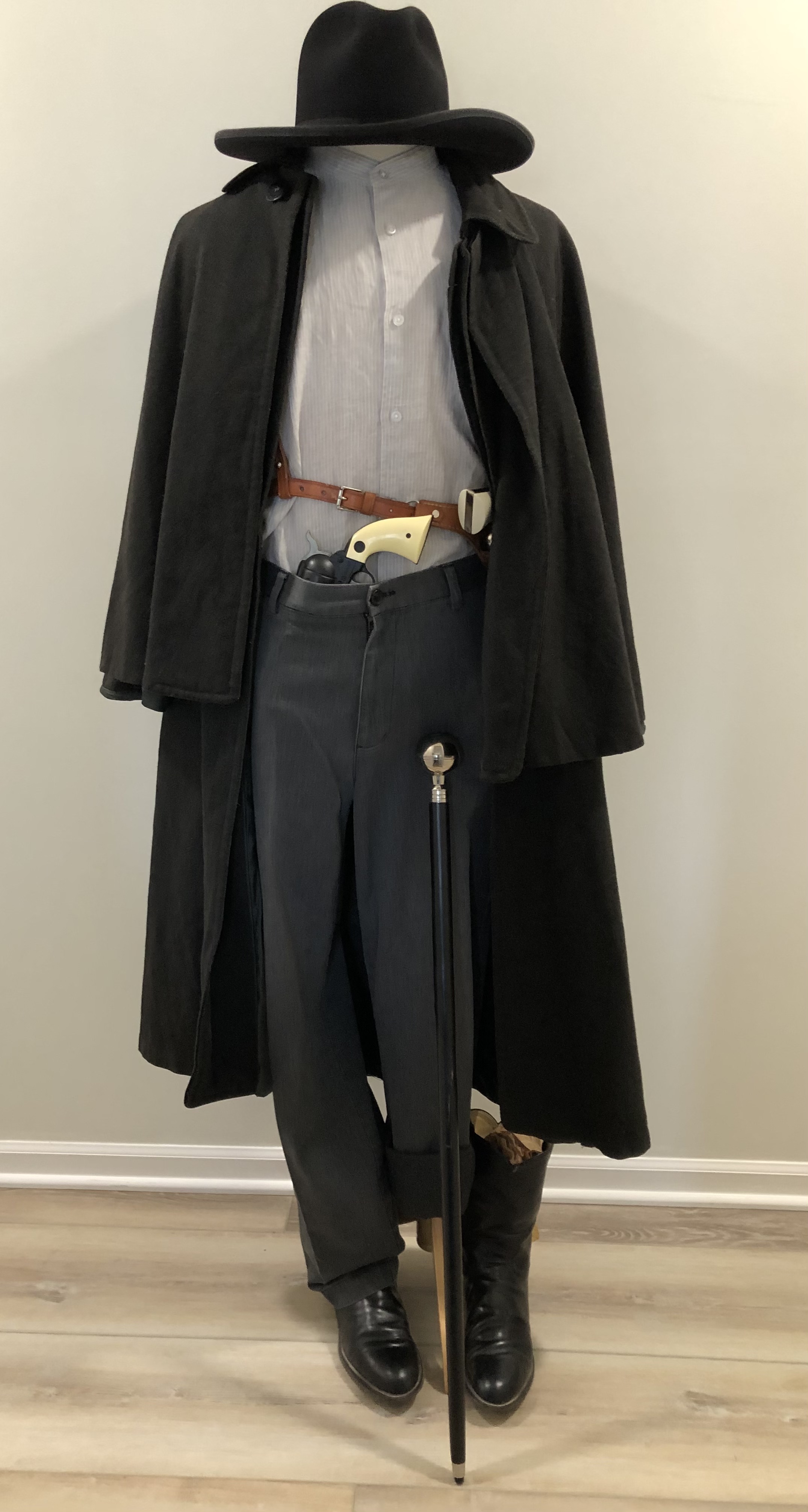

I will take some more in-depth photos of the cloak I have as it doesn't have sleeves. I just don't really see the point in having any sleeves on this cloak as I have mentioned before, I'm not even sure Val's cloak had them. I can also say with pretty good certainty that Doc's coat under the cape does not have any pockets. I say this because in the drawing of the cloak they show pockets as well as sleeves on the cloak.
If you look at the photo I just posted, look at the right side of the cloak (our left) and you will notice an optical illusion of the cloak having a sleeve as it looks like one is poking out at the bottom of the cape. I think this can be said the same for the photo of the Original Cloak Photo as well as it pretty much looks the same, or at least in my book it does............................ :unsure:
I agree. Looking at it again it looks like a fold of cape coming from side of shoulder and protruding from underneath. In this non voting scenario, I vote sleeveless.
