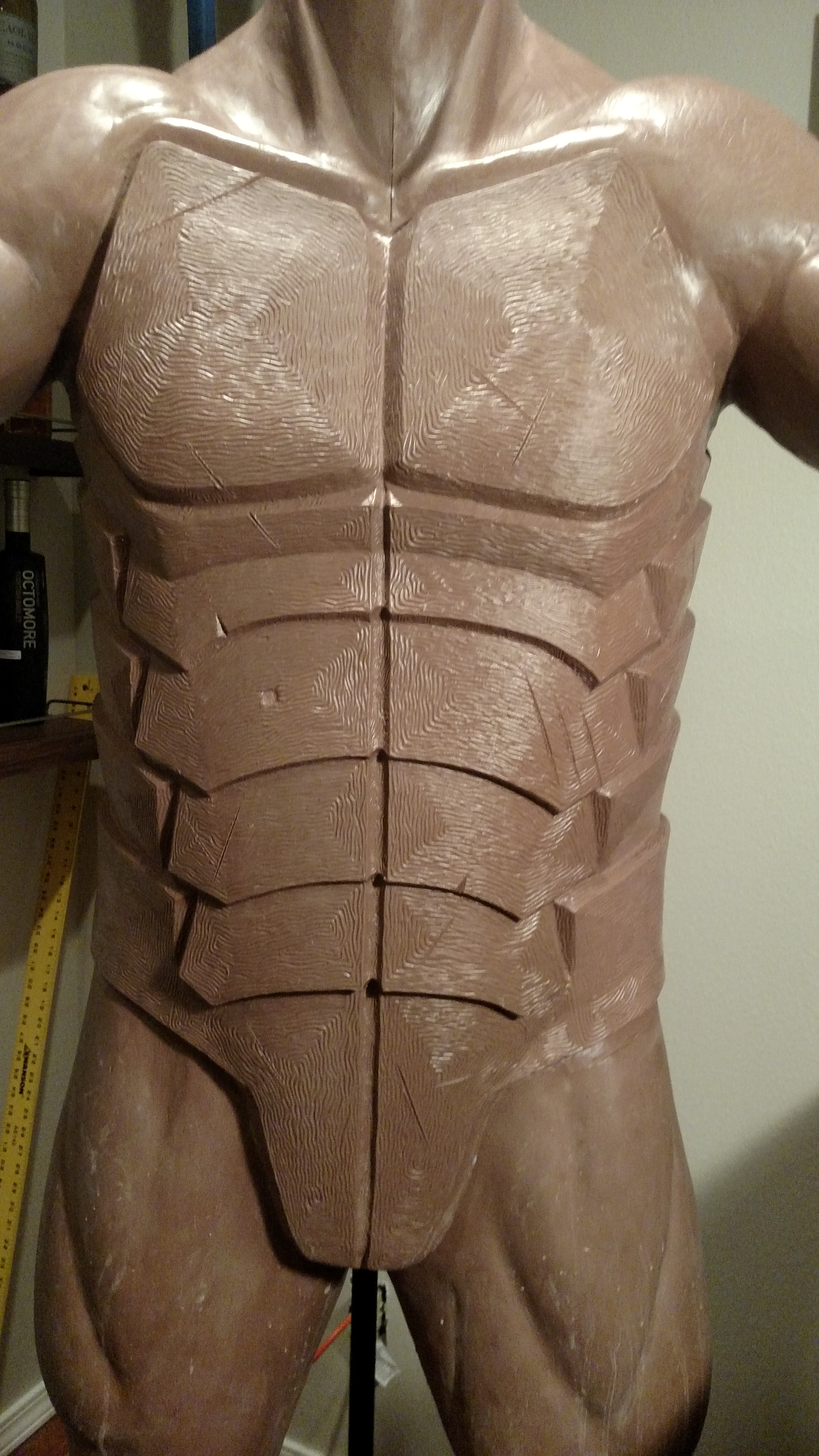

So, here's what I have so far. Making decent progress on the body. it's all roughed in but fine tuning, detailing, skin texture, etc hasn't been done yet. I roughly sculpted 2 different front shells (right and left). I'm not sure which one I am going to go with yet. I think I'll keep adding detail to both and make the decision when I get further along. I've also got Leo's swords about 80% done and his shell about 75% done. Still a LOT of work to be done but finally making progress after scoping the project and working on the mannequin for a long time. Life gets in the way sometimes.

Leo is coming along slowly but surely. Body sculpt is now more complete. Evened out both sides of the front shell after taking a long time to decide what side I liked more. Now starting to fine tune the sculpt and figure out what kind of texture the front shell is going to have. Started work on the head. It's a cross between heads that I've seen in the comics/TV/graphic novels. A lot of detail work left to do but I'm happy with the overall shape. Eyes are going to be solid white just like the comic.

Oooh this is looking so good! I love the little wigglies on the belly shell. The skin texture is also great. Nice and subtle. How did you go about making it look like that? Also something to consider, since it's so subtle, when the paint goes on are you going to do a dark wash to get the crevices of the texture to really pop? I hate how paint tends to ruin all the lovely detail you've put into something. :/
GodsAdvised
The texture on the belly shell is all done by hand. Just a lot of marking up the clay with a ball tool and then knocking it back with some alcohol and a heat gun. The texture on the skin is part done by hand and part done with some home made texture stamps. I went and got about 15 different scrap leather pieces of all different textures and then made urethane negatives. Trying out all the different stamps really helped me figure out how I wanted the skin to look.
