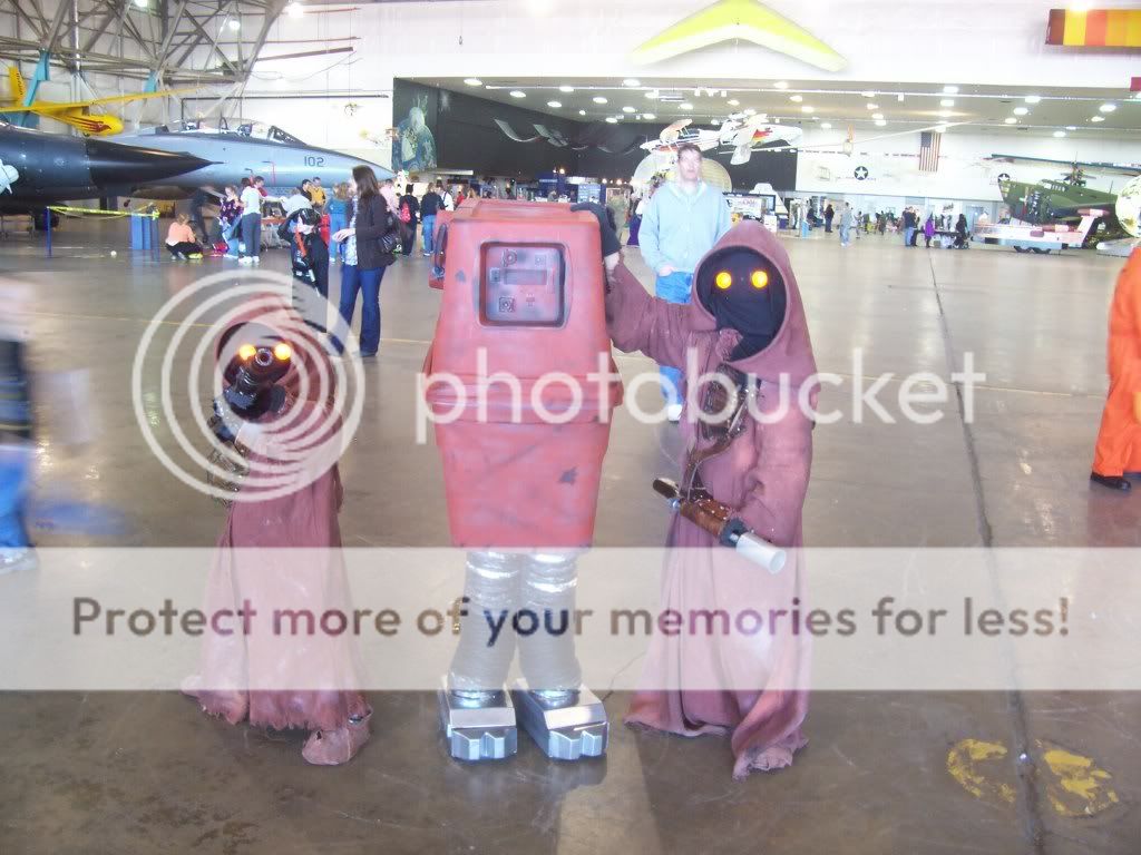

Found a pic of mine. Terrible paint job, but otherwise not too bad. You can see the vacuformed feet. I've lent out the buck, but it was easy enough to make out of stacked wood.
On the side you can see some outlet covers. Those are working! I wired him to be a "real" power droid. An extension cord connect underneath and then you can plug into his side. The world's largest power strip.

I helped a new friend and garrison member with his daughter's gonk here recently. He followed your advice Chris and we made "her" some feets ;) hehe:
Now I gotta get Jim to make a gonk voice changer for her :) hahaha...
