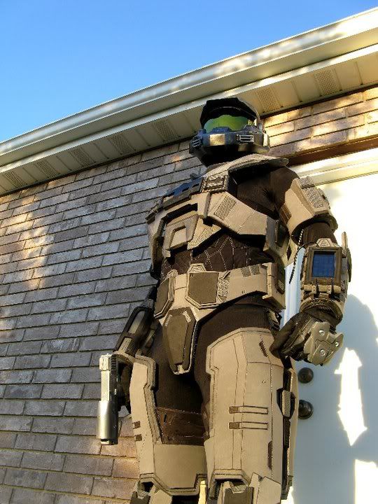

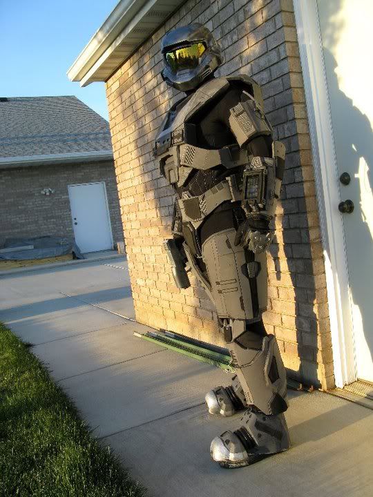

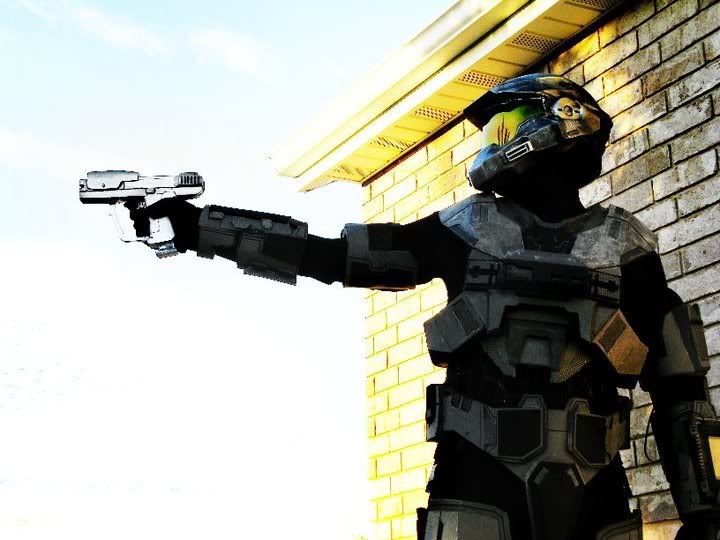

Im using parts of the pep to get the bigger pieces and figuring out the rest.

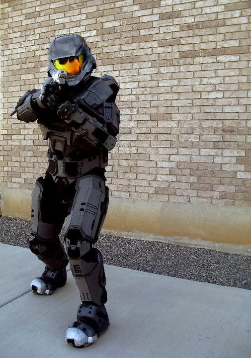

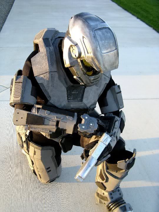

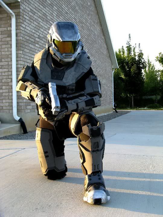

well I sorta finished my suit with the help of brandon mcclain on the helmet and me just using mark vi boots and hand plate I was able to make it to the release at 3 different locations last night one of which had over 500 people, I didn't have my camera on me but my sister managed to snap a few shots at home before I left hope you like,

I am curious about how you achieved some of that detail on the Halo Reach armor (I presume it's the stuff Noble 6 wears?). How DID you do that? Multiple layers? How do you connect them together? How do you thin out or modify different pieces? I'd appreciate any tips you could give me. : )
I'm also curious what stuff you used around your knees. The black stuff, not sure if it's more foam or a kind of padding, underneath the main layer, on top of the knee cap.
Once again, well done, sir!
would you be willing to share any patterns or reference you used to make this reach armor? it looks spectacular
(and link us to the 405th thread)
also, how did you get such angles on the armor, while keeping it smooth and for lack of a better word "hugging" to your body on the inside.
the chest and thighs particularly

heres the sticky to the pep files which yes I used part of but heavily modified as it doesn't work the same for foam.
*The Official* Halo Reach Pepakura Files Thread
heres my thread on the 405th but it pretty much the same as this thread
Reach and mass effects, its been awhile for me
I purchased my under suit from scuba123.com
to achieved angles use a dremel along the side of one piece and just using hot glue to put together.
I also used other foam stuff which I got at a hobby store the are just the normal foamies that you are used too that come in .25 think and smaller.
you can use Plasti Dip spray which you can get at home depot next to the same Rustolum spray paint that you can used on the Plasti Dip after it dried.

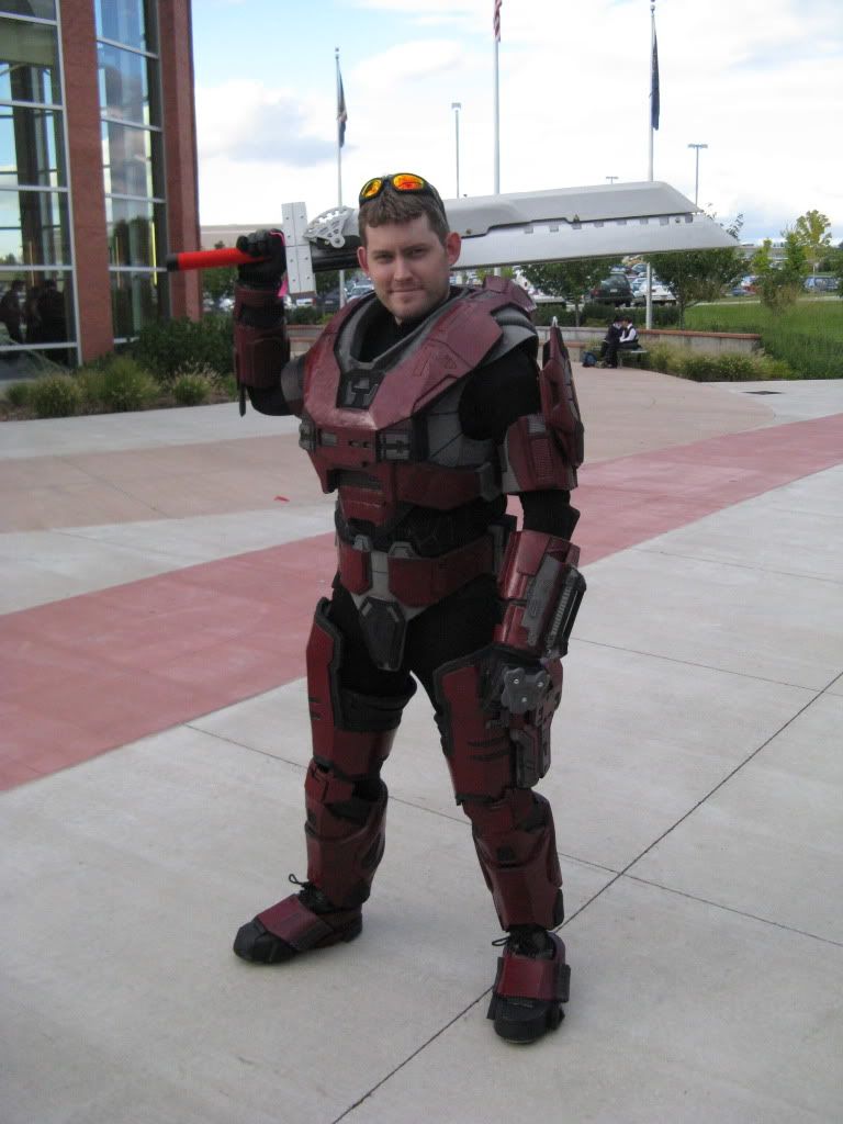

ok I've been gone for awhile trying to finish my sisters armor just barley made it in time minus the helmets for us which I hope to have done by halloween but wanted to give you guys some pics from our adventure at anime banzai here in utah.
