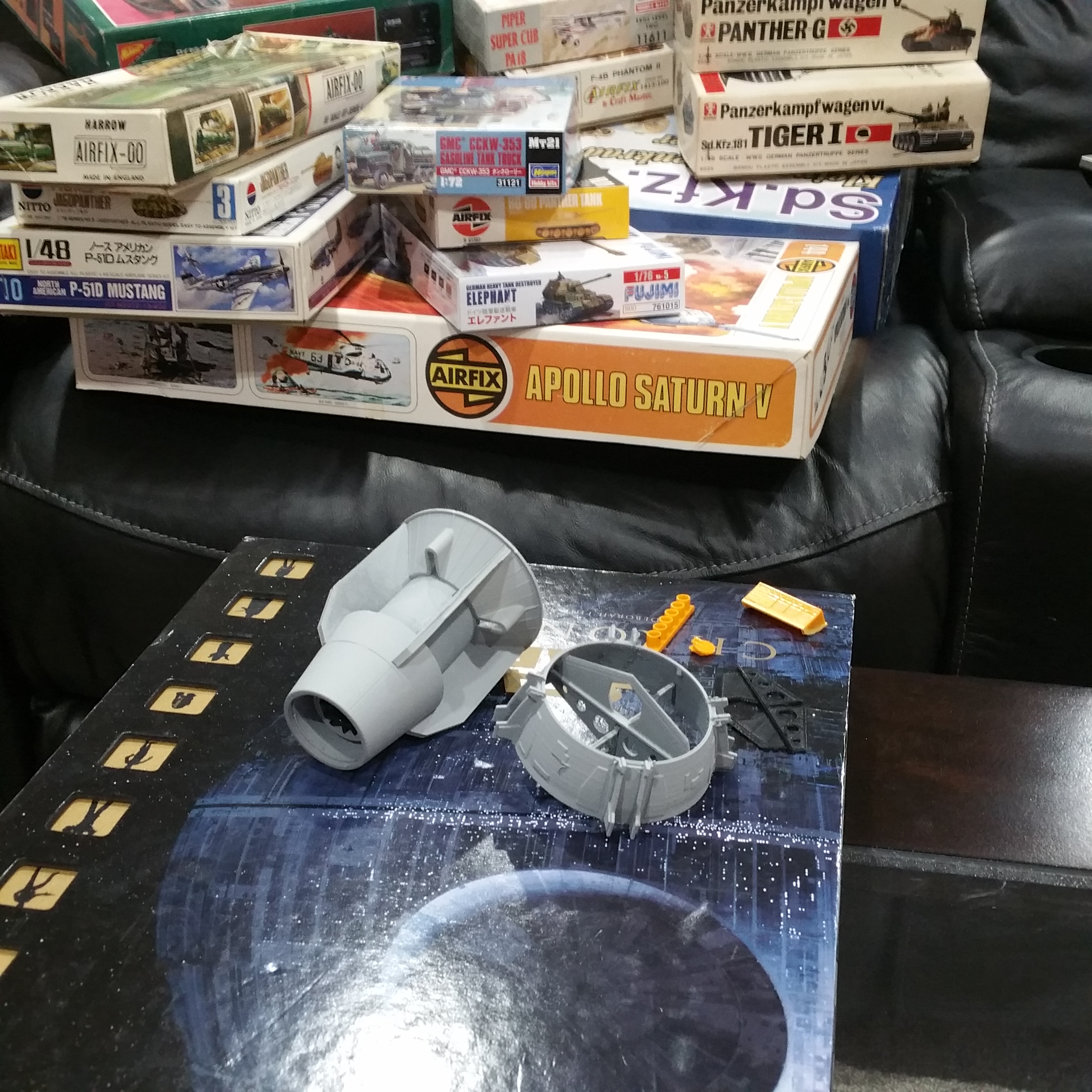

Thank you. No, I just did some modifying with styrene so I could see what can be done without a 3D printer, its not permanent, so far its not right but its coming. I'm hoping someone steps up an does the adjustments (cuz I can't), then I'll reprint.
Re: Open source Y-Wing (DaveG)
I managed to get some free time this past weekend. Started on the engine inserts (big thanks to maxhebus, they turned out great) and did a test print of Dave's rear Leggs and control vanes, which also look great.

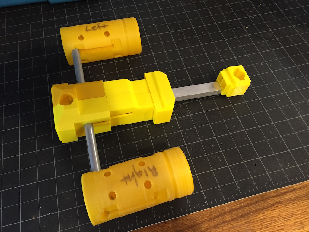

So what are you going to do about the length Ron? There really doesn't seem like there is a lot you can do without changing the length of the armature.
There are a couple of solutions to extending the length of the armature using the components I supplied. It looks like the amount of extension required shouldn't be more than 1/4", if that. This adjustment should be possible by either drilling a new set of holes in the aluminum C channel or filing the existing holes into elongated slots with a round file which would allow the forward fuselage shell to be slide forward slightly creating more room for a longer neck section. As has been discussed, the 3D printed neck parts need to be modified (I'm working on that now based on the great information Scott provided).
Alternatively you could change the three holes on the rear of the C channel to slide it forward but the armature will be most rigid if the aluminum channel butts tightly into the 3D printed mounting block as design. Of course, a C shaped spacer could take up the gap and help prevent any flexing.
