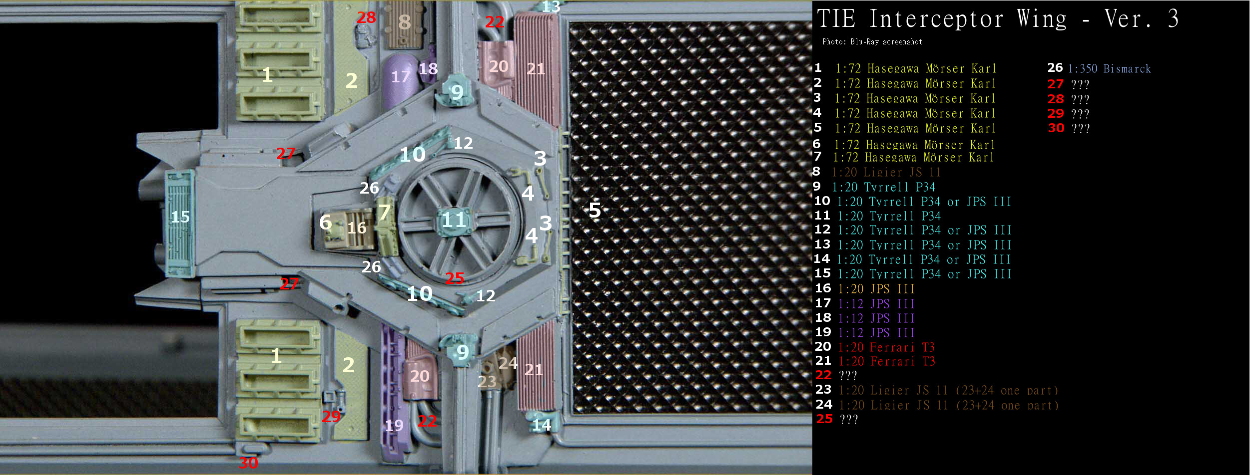

I’ve been looking into studio scale models and want to make an Interceptor; however, I can’t find any good parts lists, or places to start on the model. I’m also waiting to see if I can get into the studio scale modeler forum, but I’m unsure if people are still being let in. So if it ends up that the forums aren’t an option, are there any other good places to look for resources?
Here's what's on Ssm. Credit to Elfonso in 2013. If your here and object , Elfonzo I'll take them down.
I can't vouch for accuracy, not my maps, I'm sure the eagle eyes on here will sort out any errors, ; )
Kit list for wings.
Tam. 1/12 Tyrell 6 Wheeler
Tam. 1/12 JPS Mk III
Tam. 1/12 Yardley M23 (damalo)
Tam. 1/20 Ferrari 312T3
Tam. 1/20 Tyrell 6 Wheeler
Tam. 1/20 Ligier JS11
Haseg. 1/72 Mörser Karl
Tam. 1/35 Flakvierling
Tam. 1/20 JPS MK III
Tam. 1/350 Bismarck

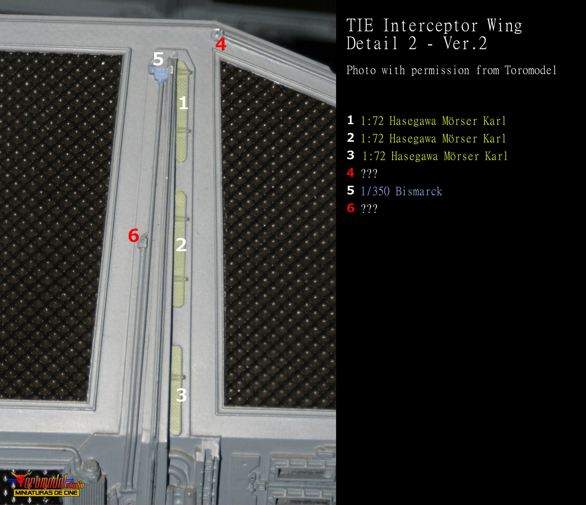

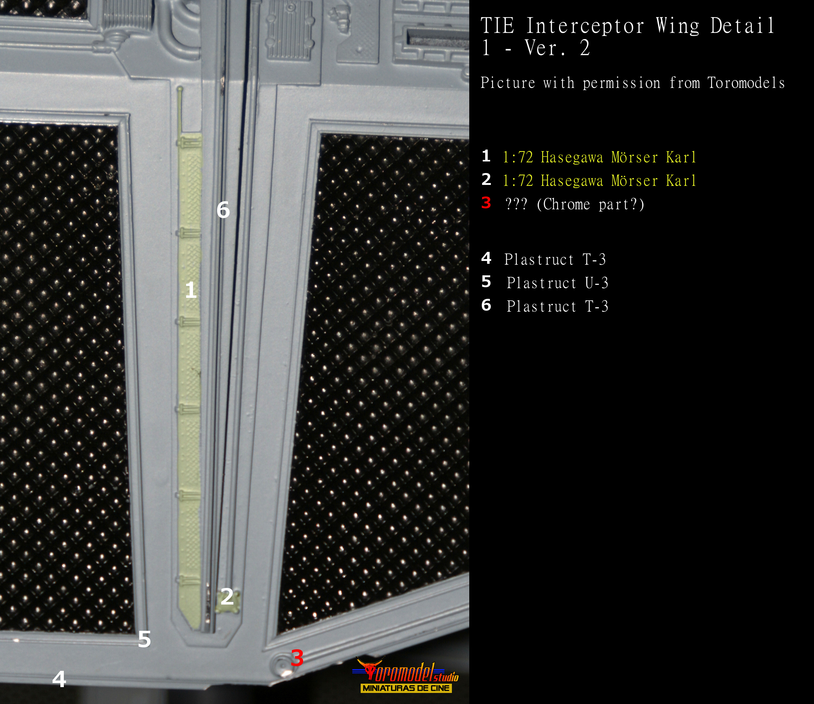

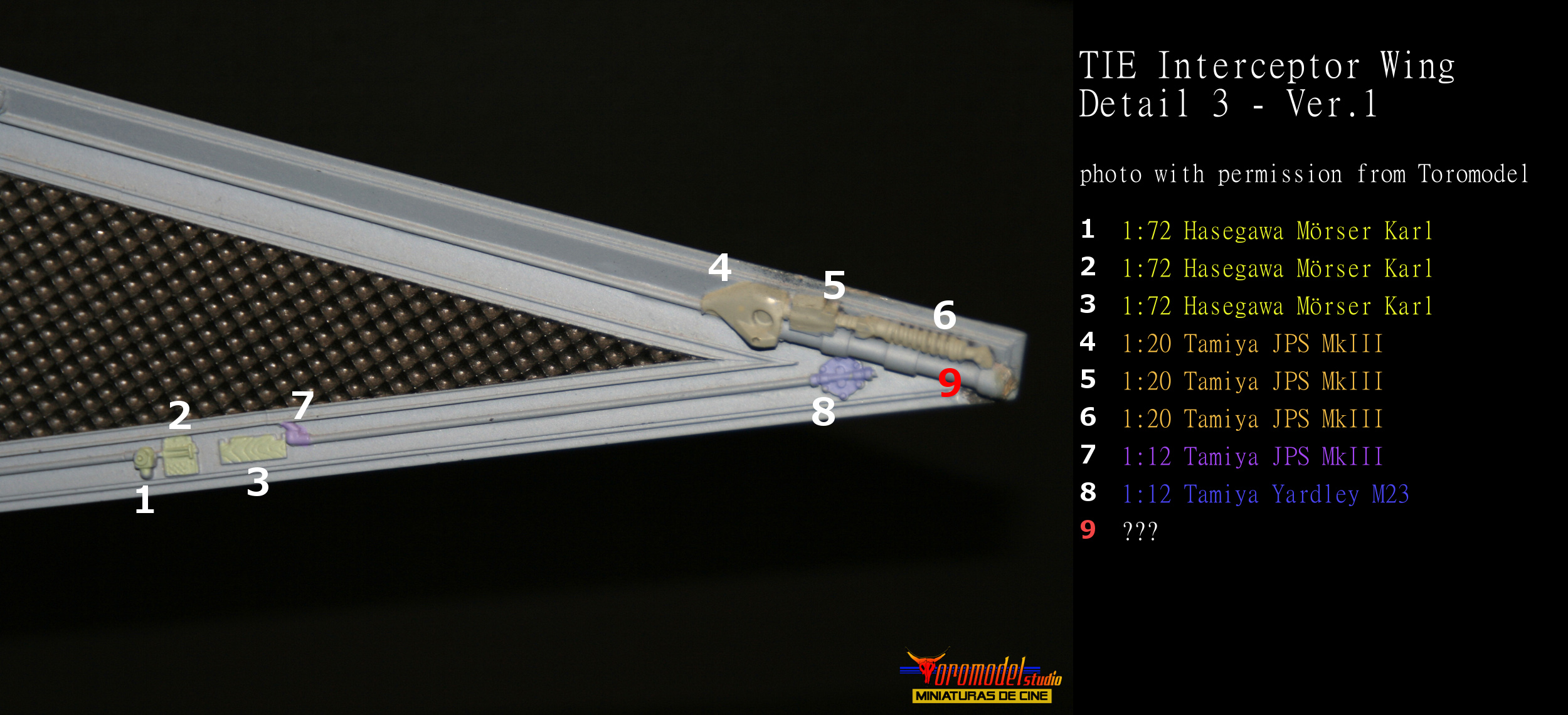

Did find this link over there, courtesy Toromodels,

If you manage to figure out the age old debate on the wing panels, that will be a real treat. Some say they were a fluorescent light diffuser, some say a Plastruct pattern sheet. I found a diffuser panel many moons ago that looks close, but where that thing is , is anyone's guess, lol. I think the panel I found had diamonds that were too large. At least that's what someone told me. If I ever built one, I would just print the inserts, and call it close enough, ; )
