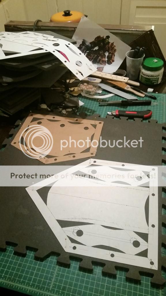

The idea is to create a silicone skin for the exposed flesh areas. Lastly I managed to start patterning the armor.
