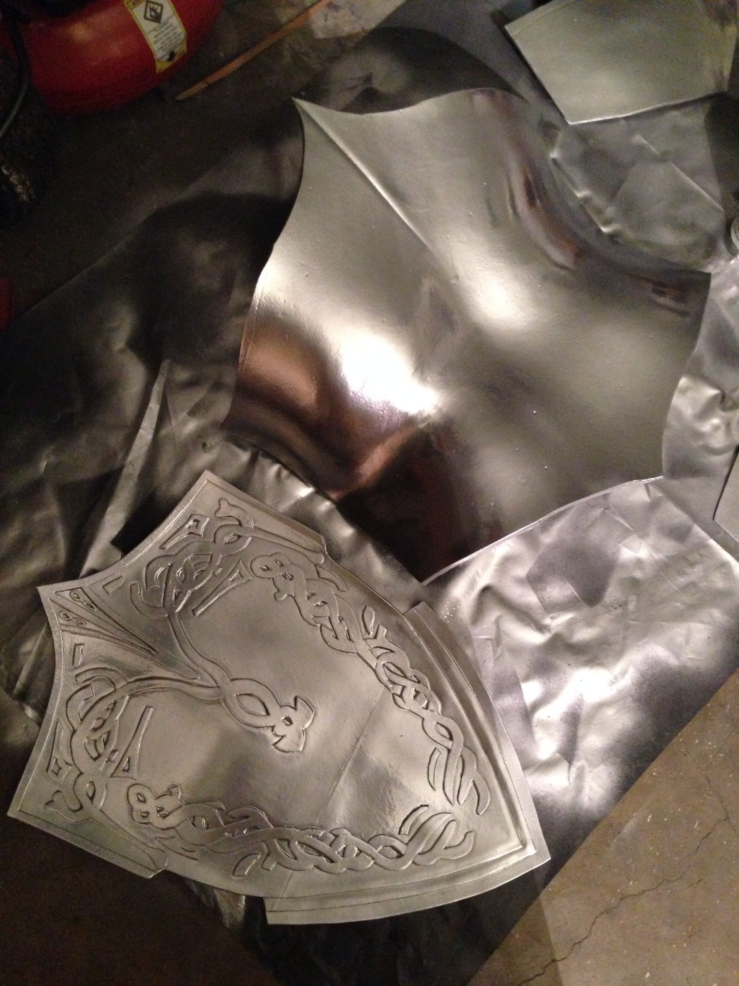

Korigirl - Oh WOW! That looks amazing so far! I'm super impressed with the shield, especially the detailing. What material did you use? Feel free to post any of your progress on here (unless you already have your own build thread). The more the merrier! :)
Thanks! I'm excited about it (it's my first armor build). I have a thread I'll be posting some pics in in a couple of days. We have a Comic Con on Saturday, so everything needs to be finished by then! (My boyfriend is going as Thor)
I used EVA for the armor, thin craft foam for the shield.
