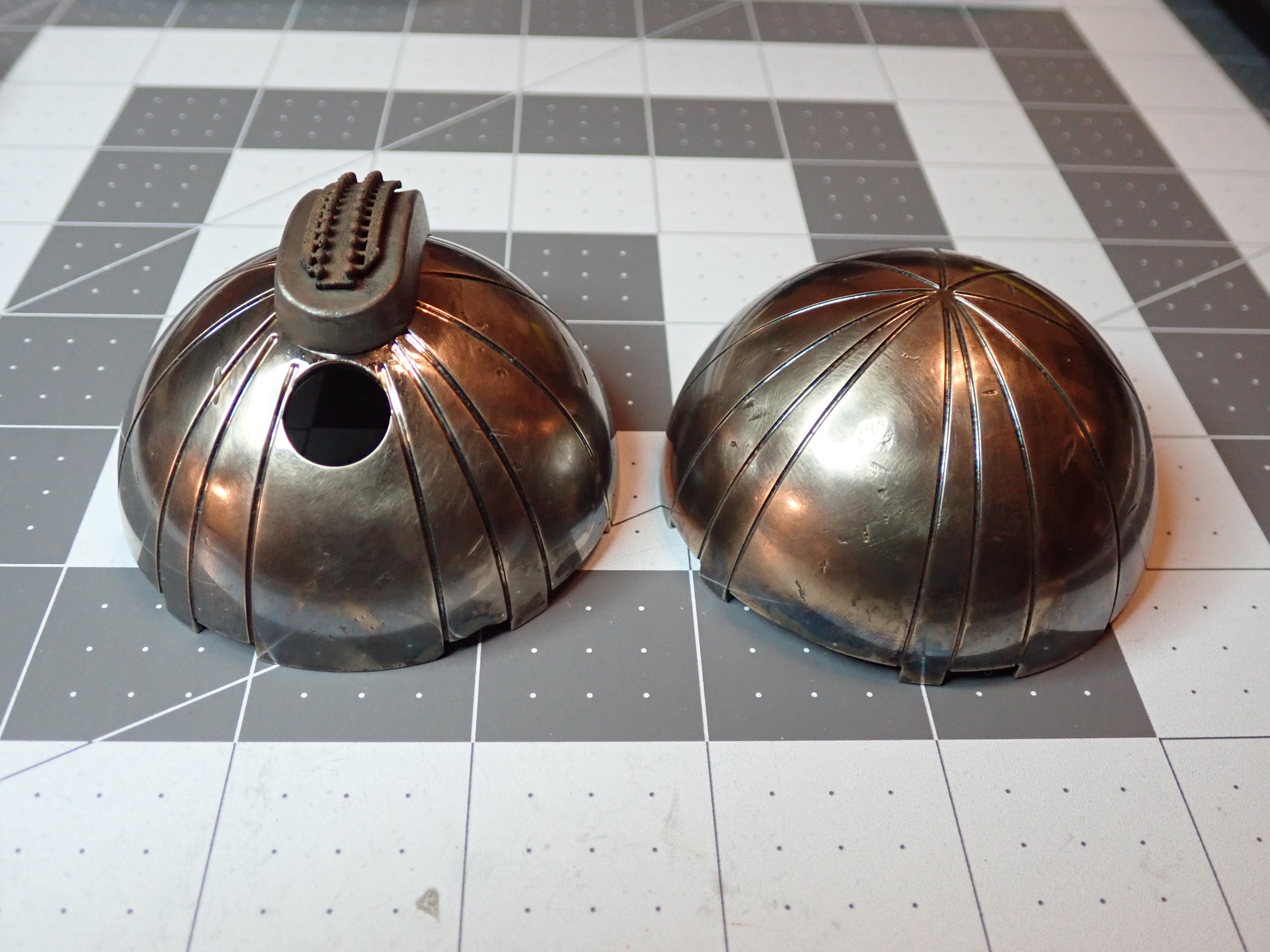

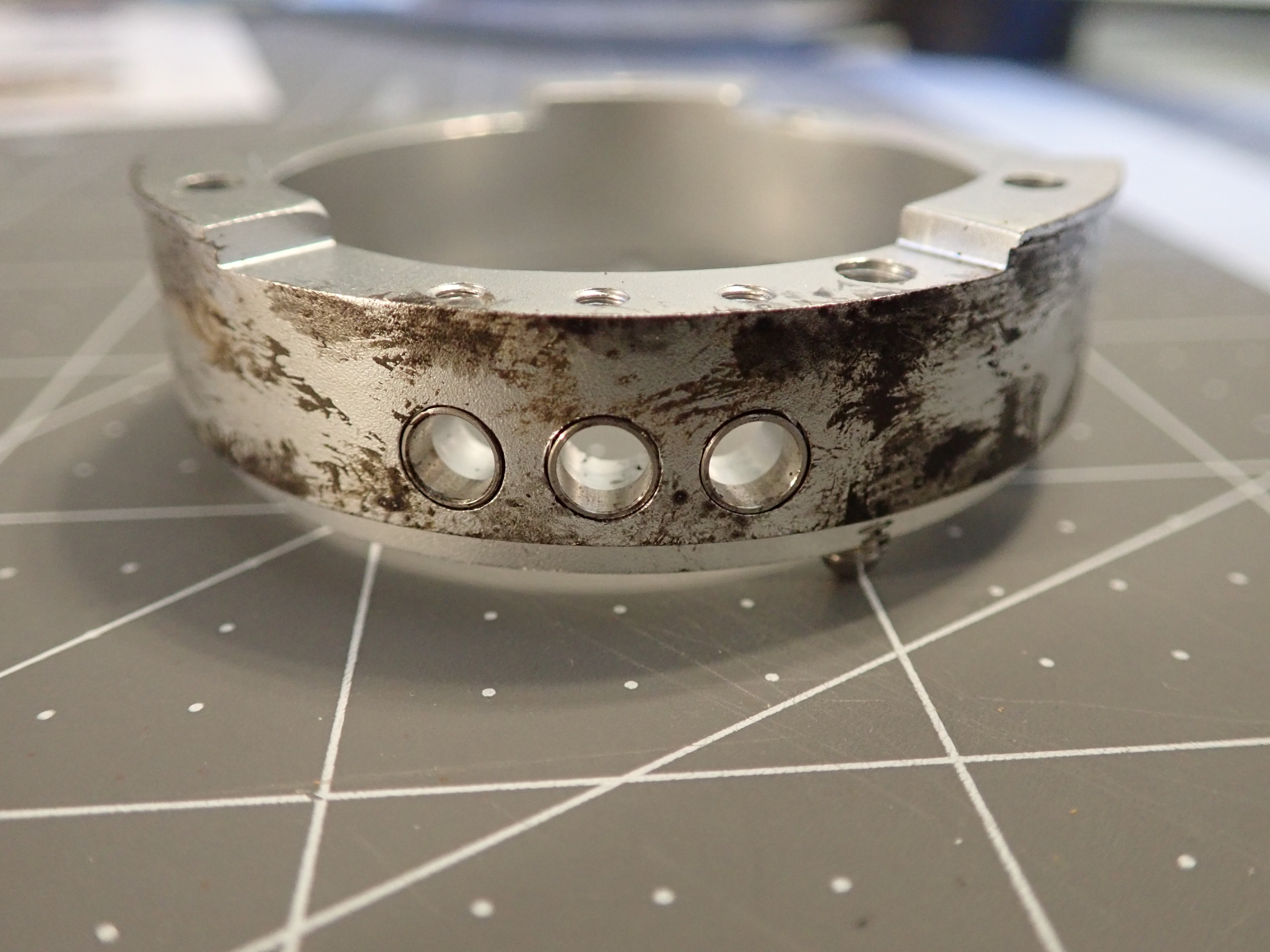

I do have to say that I was quite hesitant at first to ding up the TD. But once I got started it was actually quite fun. So my approach to the weathering is to get rid of the reflective shine and to darken it while while giving it some real world damage, dings, etc... a light to medium weathered look.
I’m actually quite happy how this turned out. So basically what I did was I used a dremel black sanding pad (400grit equivalent I think) and that took the shine away. I used a random pattern leaving some really dull areas and some with a bit more reflection. I think you can see it in the photo above. The pad I used is below.
For the physical damage, I used a screwdriver, hammer, dremel cutoff wheel and went to town here and there.
To darken it, I went with the tried and true aluminum black in a 3:1 water to AB ratio for the bulk of the TD and full concentration for some of the damaged areas. And then the usual rinse with water, dry, repeat as needed, etc... Applied using a scrap foam piece and q-tips.

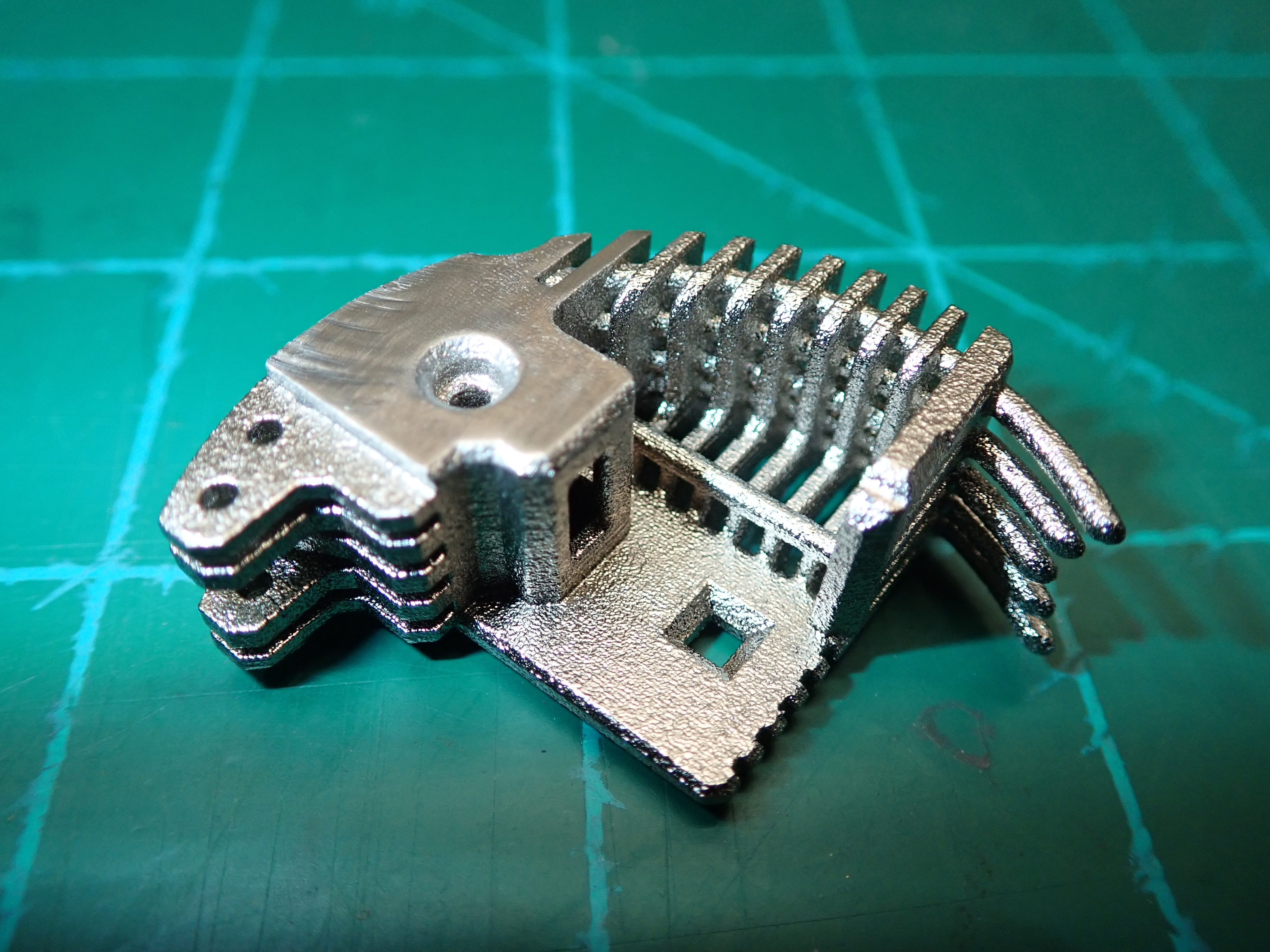

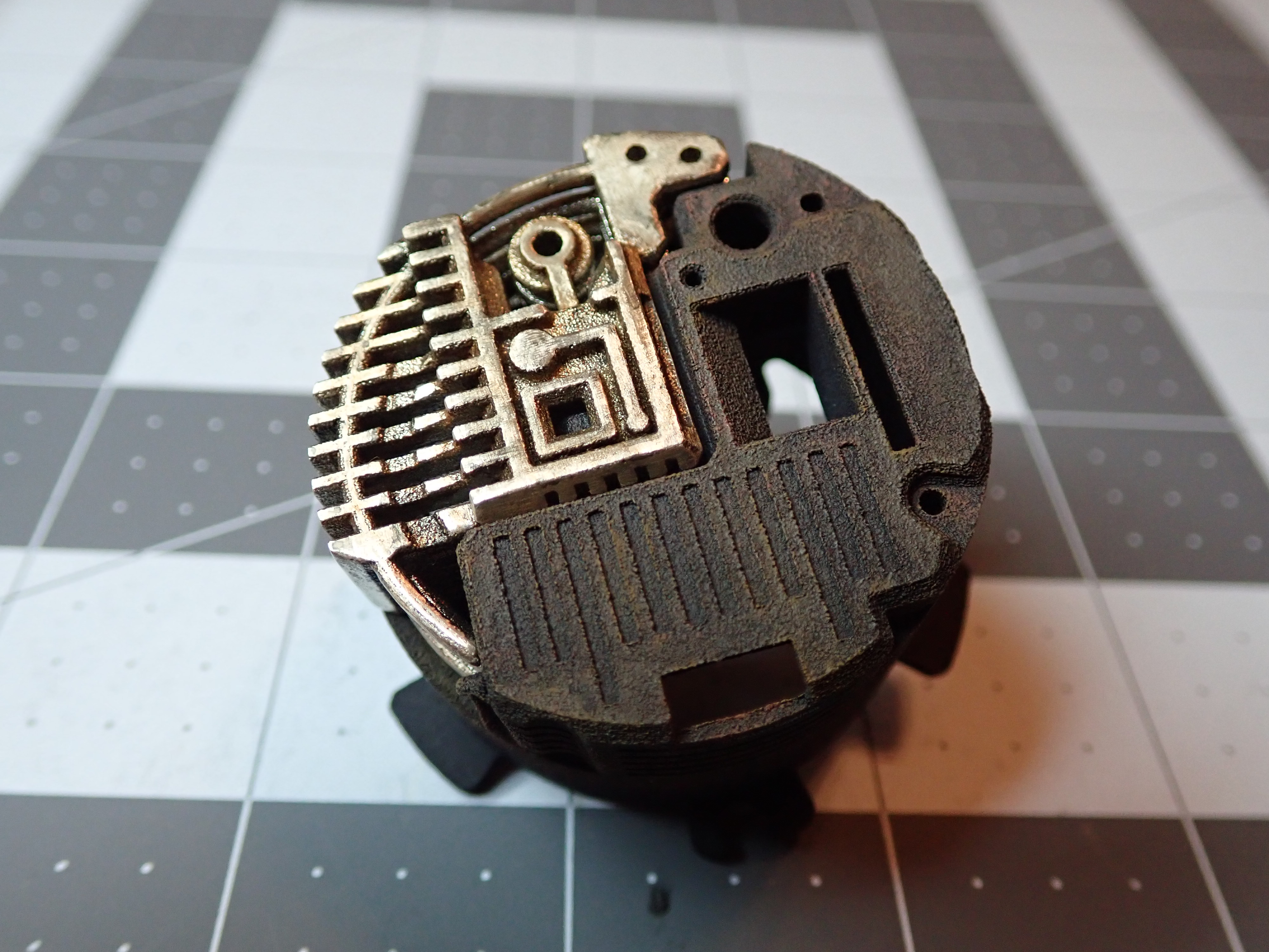

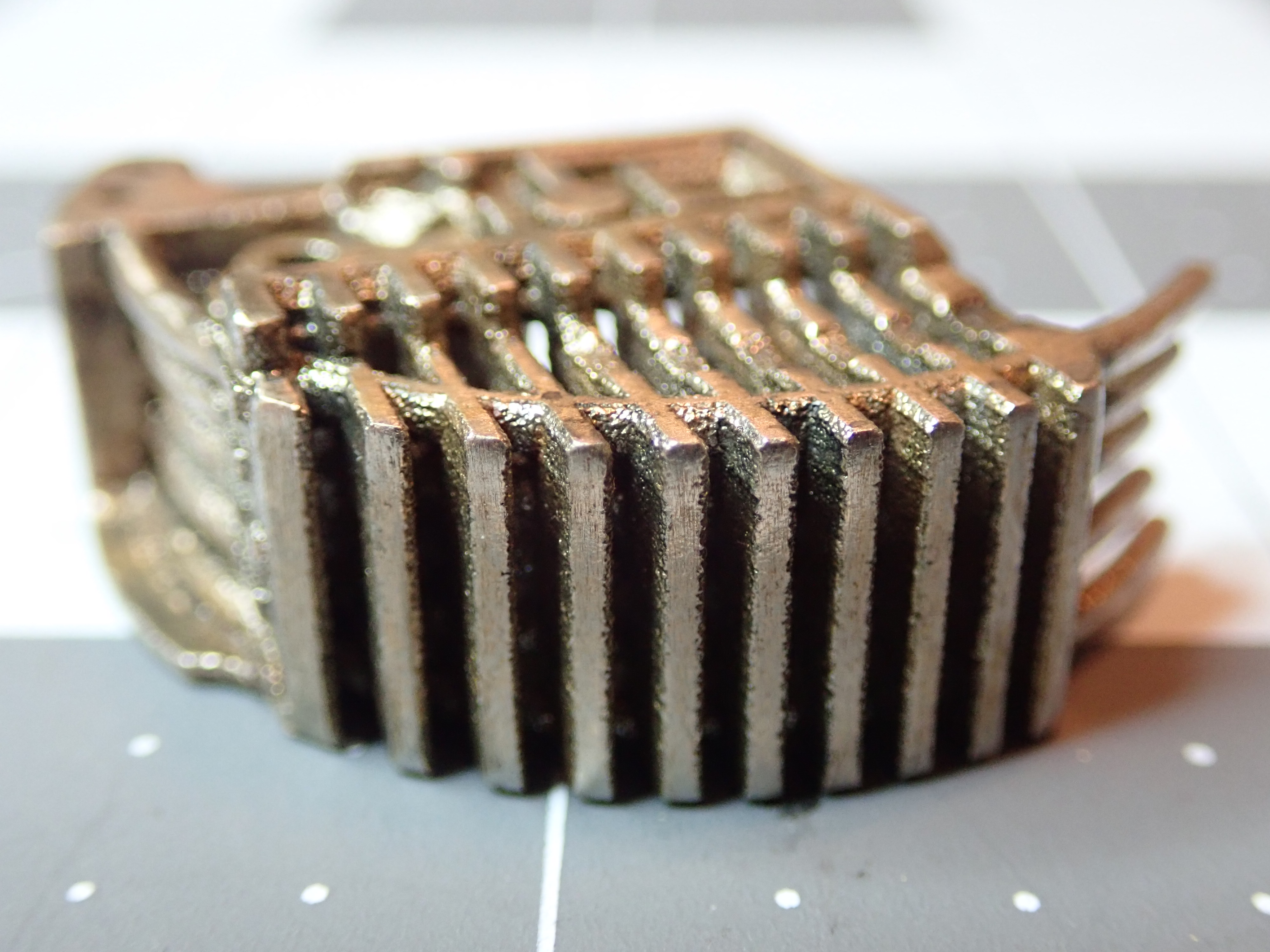

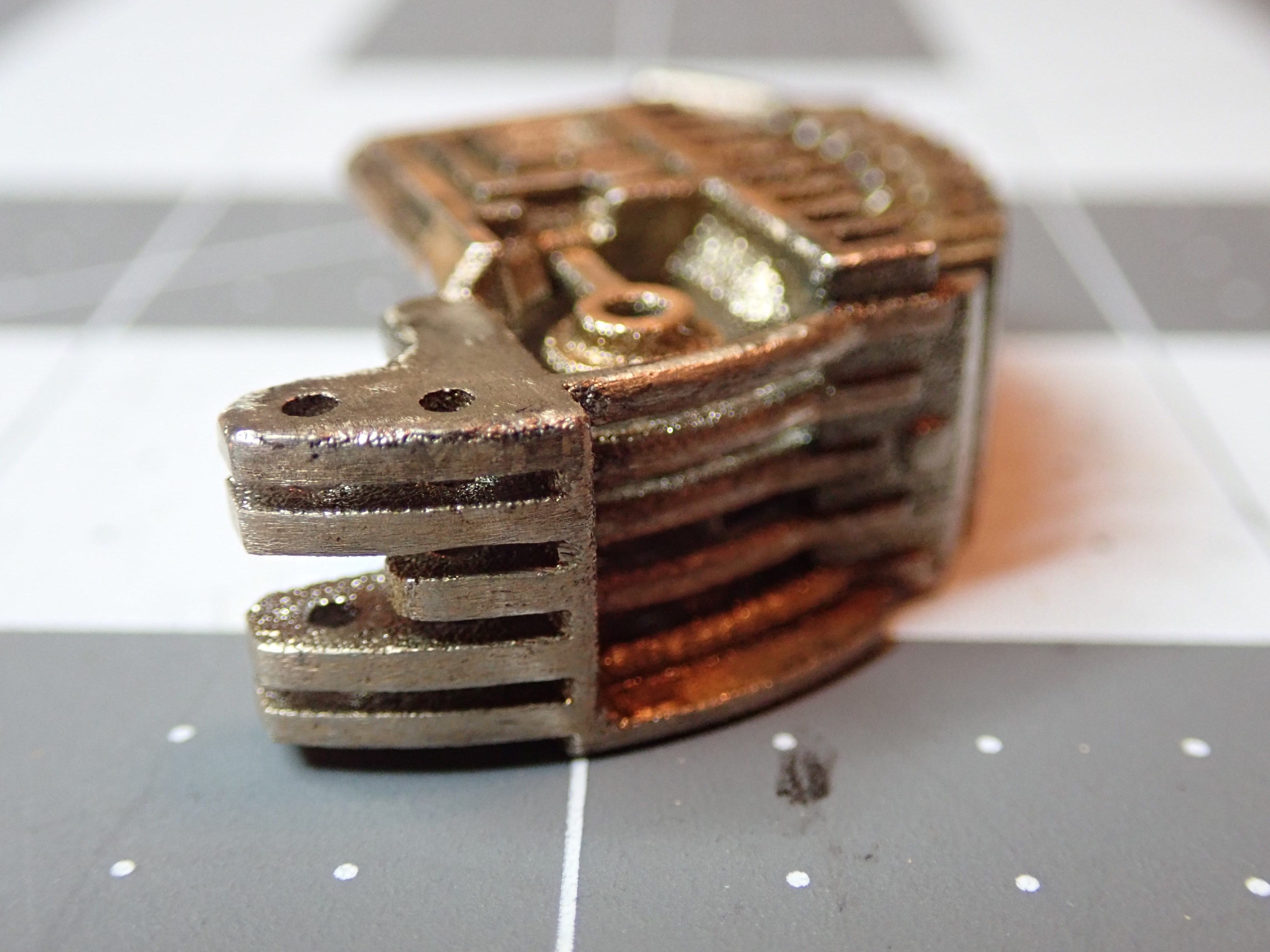

So today I decided to tackle the metal chassis. I ordered the part in bronze steel knowing that the finished will be grainy. The bronze and brass metals sure look nice but I didn't want to spend that much on this piece.
As you can see in the photos below, the finish is quite rough but I've seen so many people smooth out the finish that I had to try it myself. I had already started with the sanding on the big flat part in the photo before I realized I hadn't taken a photo yet. Since this portion of the chassis wouldn't be seen I felt it was a good place to start in case I messed up.

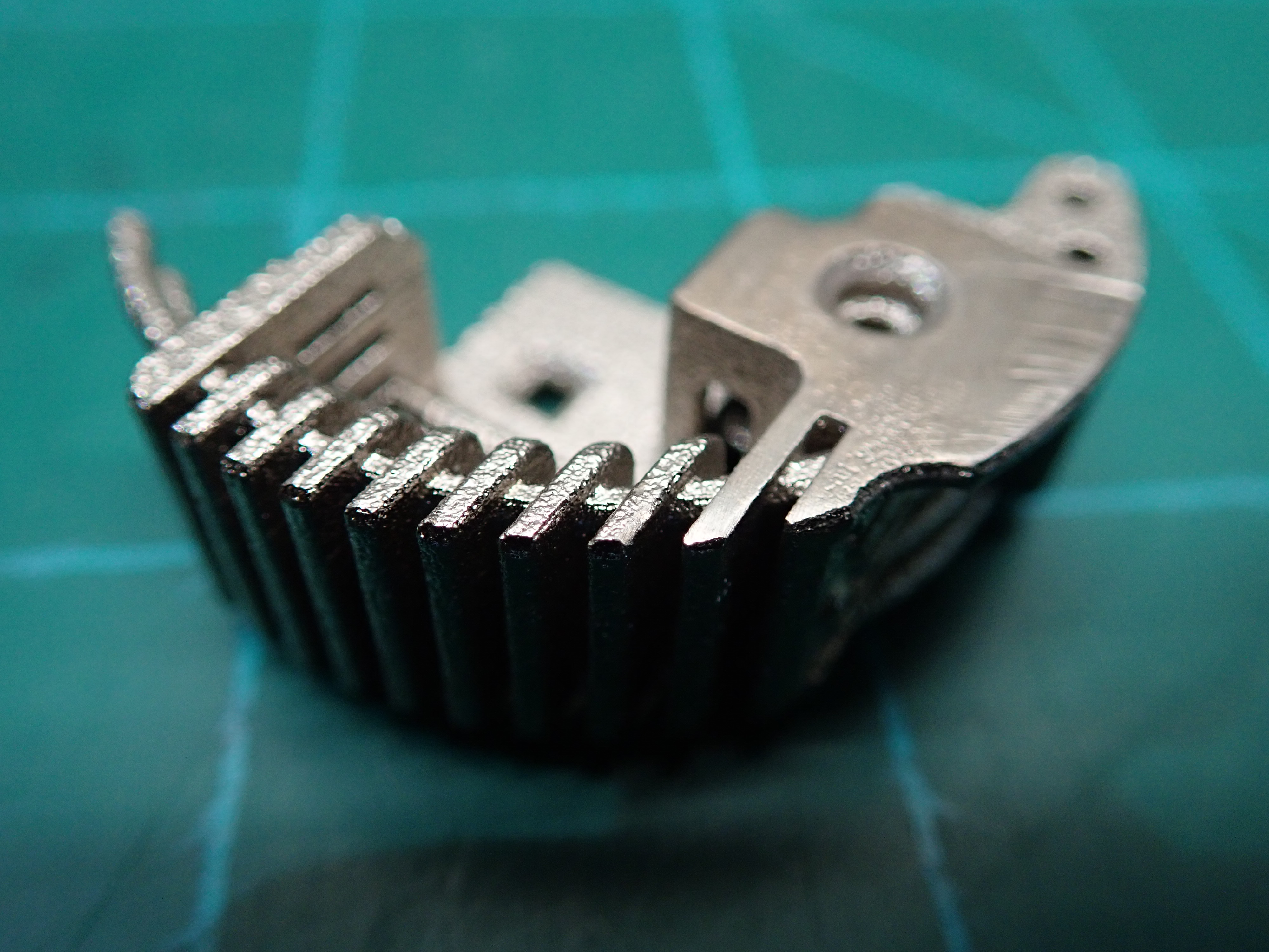

Here's a better comparison photo on the fins to see the difference.
I focused the sanding on the "high" spots and left the recesses untouched. One because I can not sand those spots adequately and two, I think it gives a nice contrast in the overall look.
So far so good....next will be the hemisphere and plastic chassis parts since those will be weathered using paint. I can put the power tools away...for now.

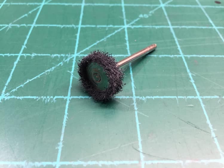

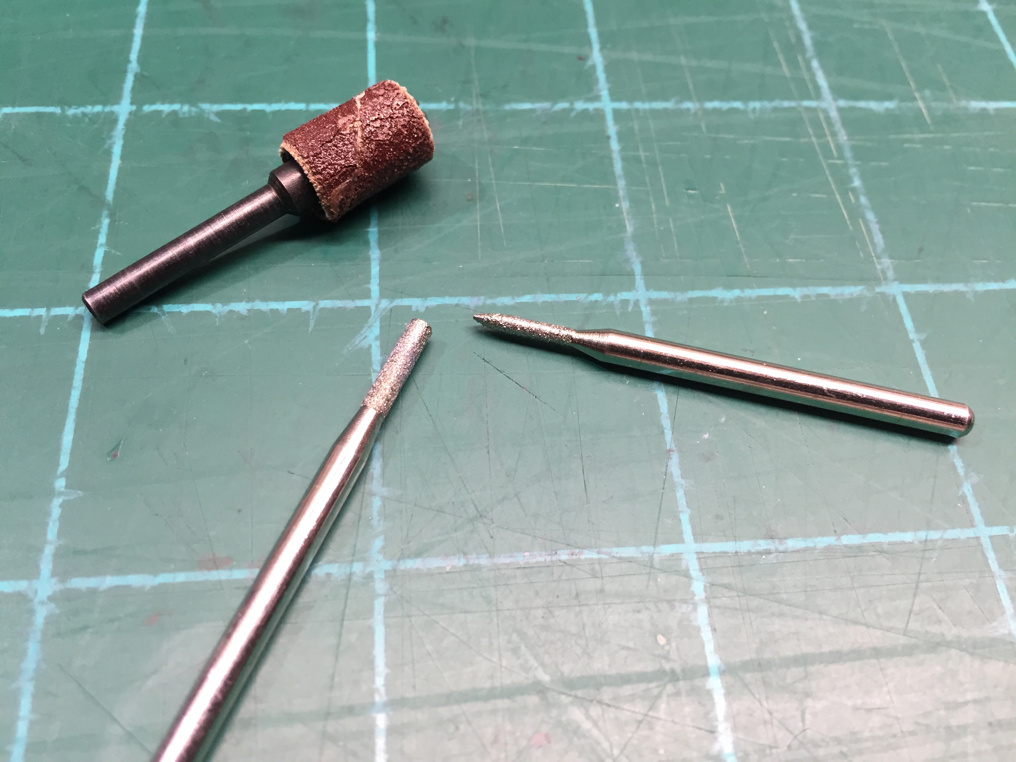

What did you use to sand it? I just recently got some metal parts from shape ways, I didn’t need to sand them they cane pretty smooth.
But curious to what grit paper is used on these metal parts
Did it take you a long time to get it to fit into the chassis?
zjunlimited
Seems like while the steel parts are the more affordable metals, they do require a bit of work to make them look better.
I used a combo of various dremel bits...the sanding drum is the 120 grit version and was my primary go to for most of the sanding. I used the other bit for areas a bit tougher to get to.
The parts actually fit direct from Shapeways. All of the sanding were on the external sides so no issues with fitment. And while GOTH did mention a bit of sanding may be needed for the main chassis to fit the hemisphere piece, mine did. It require any.

Got some work done over the weekend so all of the main weathering activities are now done.
Here's the finished hemisphere weathered using Vallejo acrylics. I'll probably do some touch up after the TD is fully assembled.

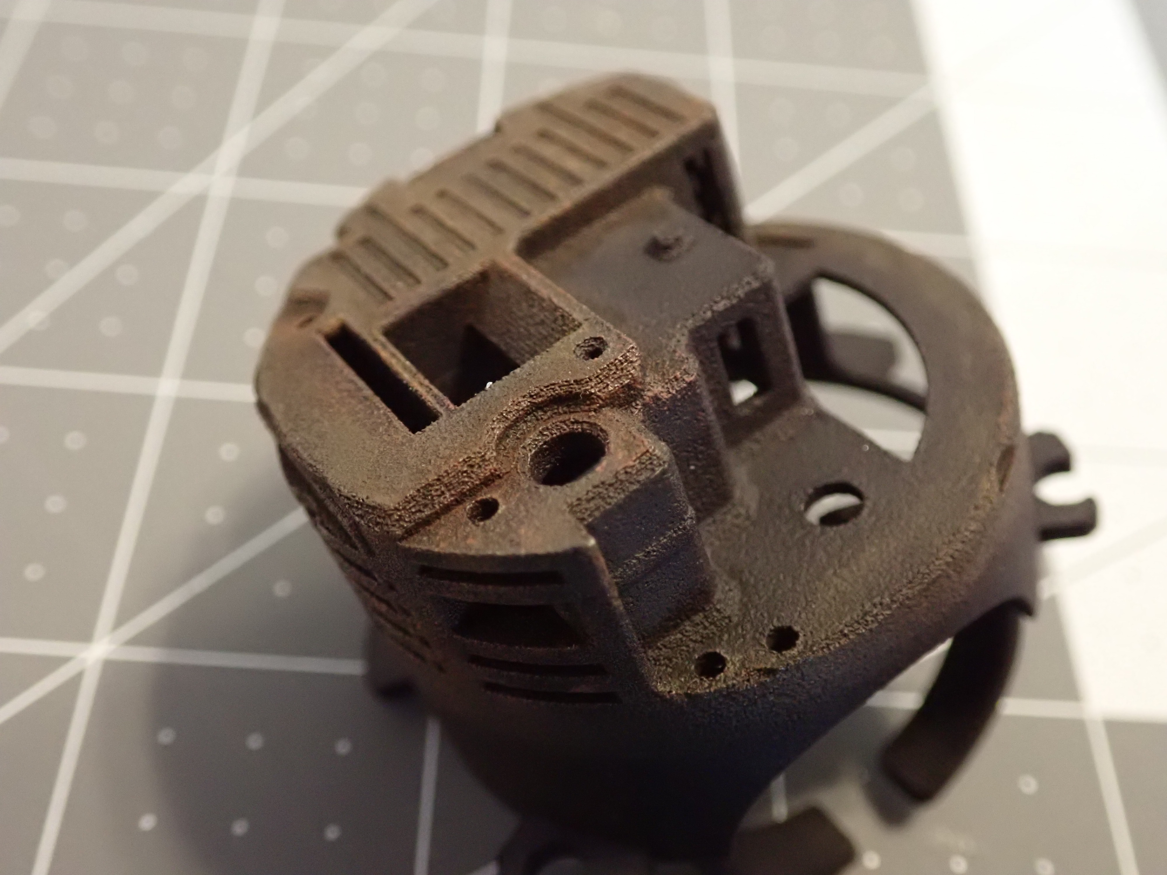

Next is the plastic chassis, again Vallejo acrylics....dry brush and washes...olive drab, browns, marron, rust.
And all together....same acrylics used on the metal chassis.
And one final photo of the TD but with the tracks and switch lever weathered.

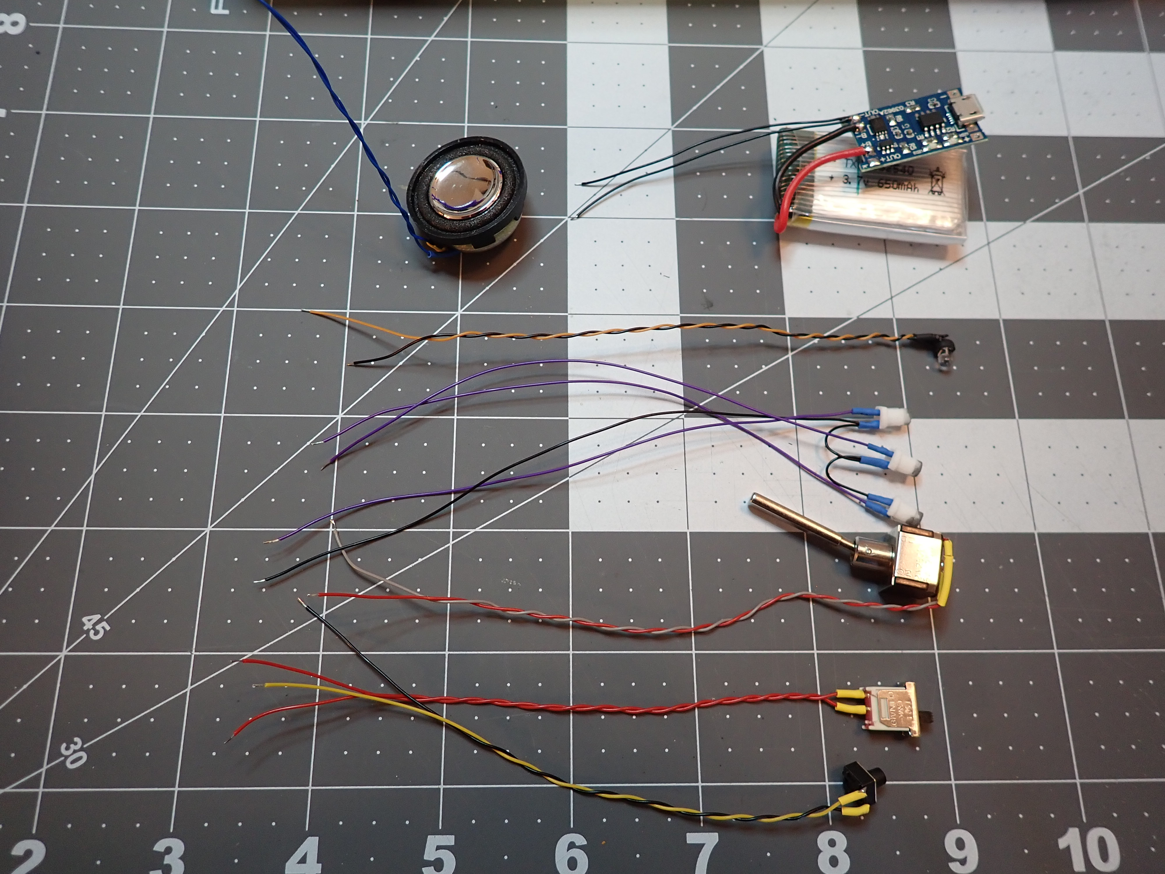

Not much excitement with this post but progress nonetheless.
Prepped the wiring for all the major bits and pieces
Most of the wiring was pretty standard using 30 AWG wires.

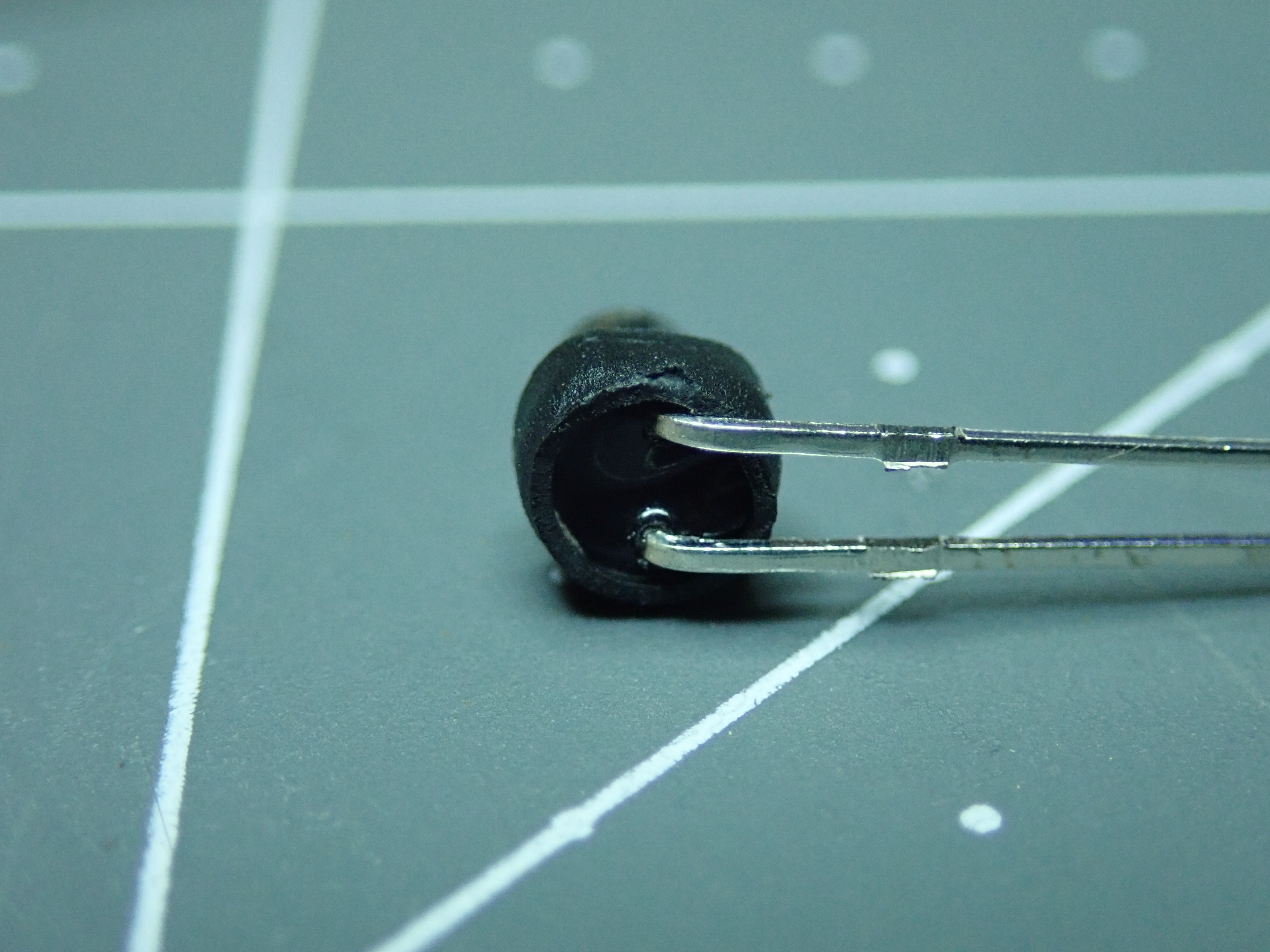

One item to note is related to the power-on LED...there were reports of light bleeding through and being seen from the front 3 leds. To avoid / minimize this, I covered the bottom of the led with electrical tape and wrapped some heatshrink around the base of the LED (tip from Scarecrow).

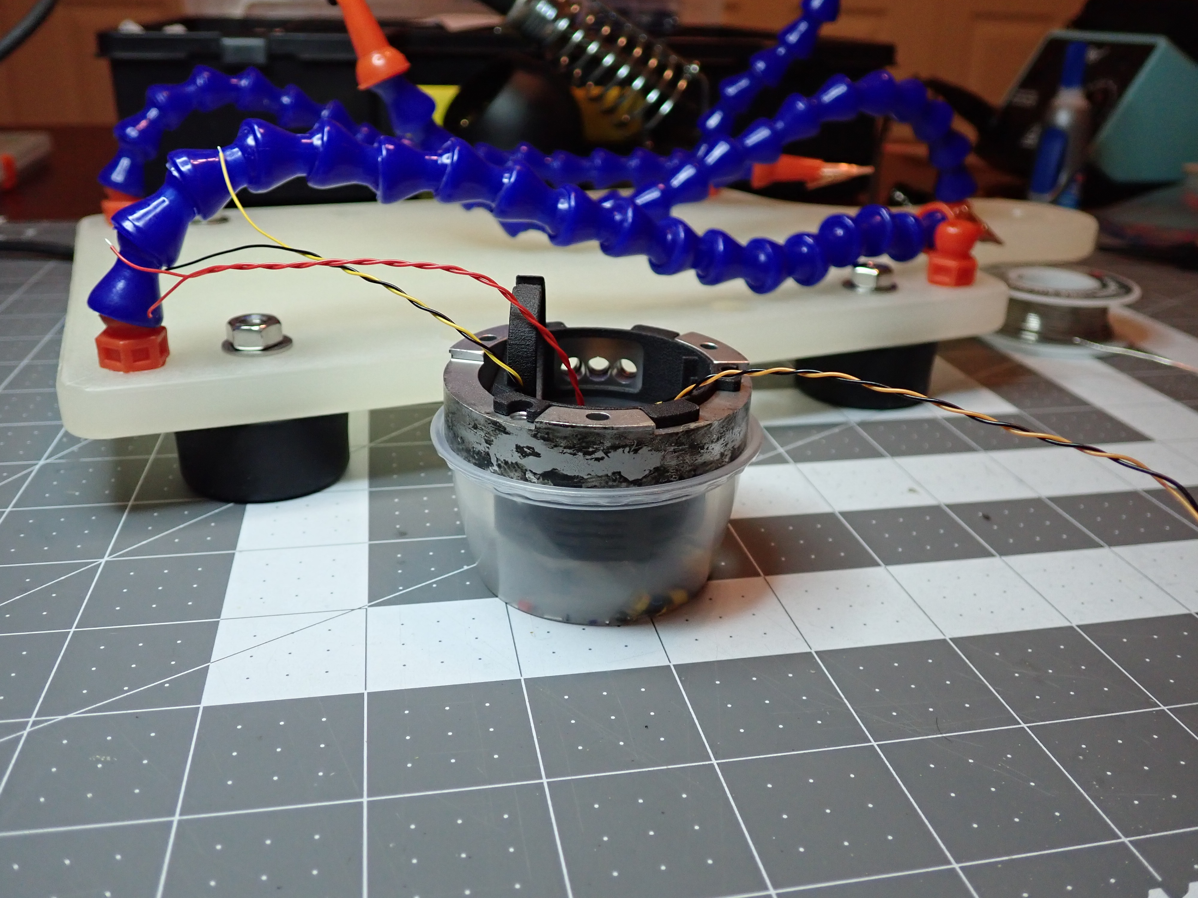

Question for those who have built one of these out. The usb plug can be quite difficult to insert and remove and I’m afraid the board would move around quite a bit. How are you securing the usb board to the chassis?
The problem with using any type of glue is if I ever need to service the battery or board, it may be a bitch to try and remove? But I can’t think of any other means to secure the board? Thoughts?
Duncanator
Your welcome. It’s been fun so far but now I’m heading into some more challenging territory.
You could glue it in place with a couple blobs of silicone caulk. It can provide a little shock isolation, and to remove it you just cut it with a knife.
Not as handy as a set screw, but I'm not sure where you'd hide one of those.

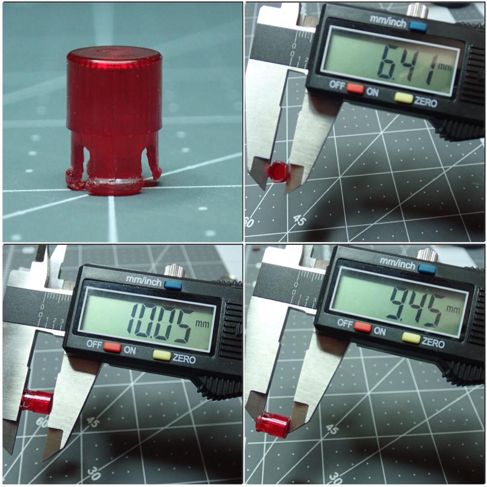

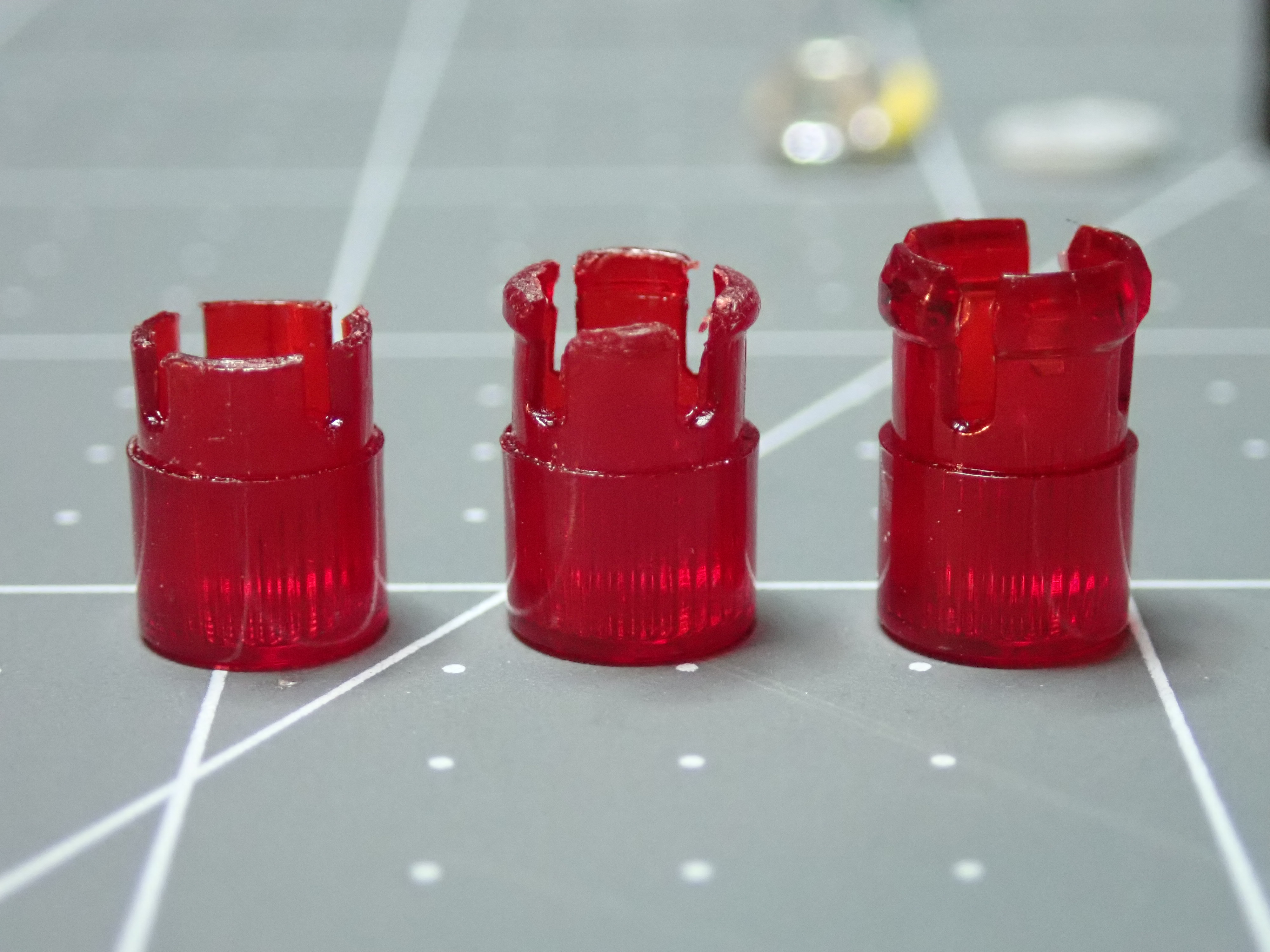

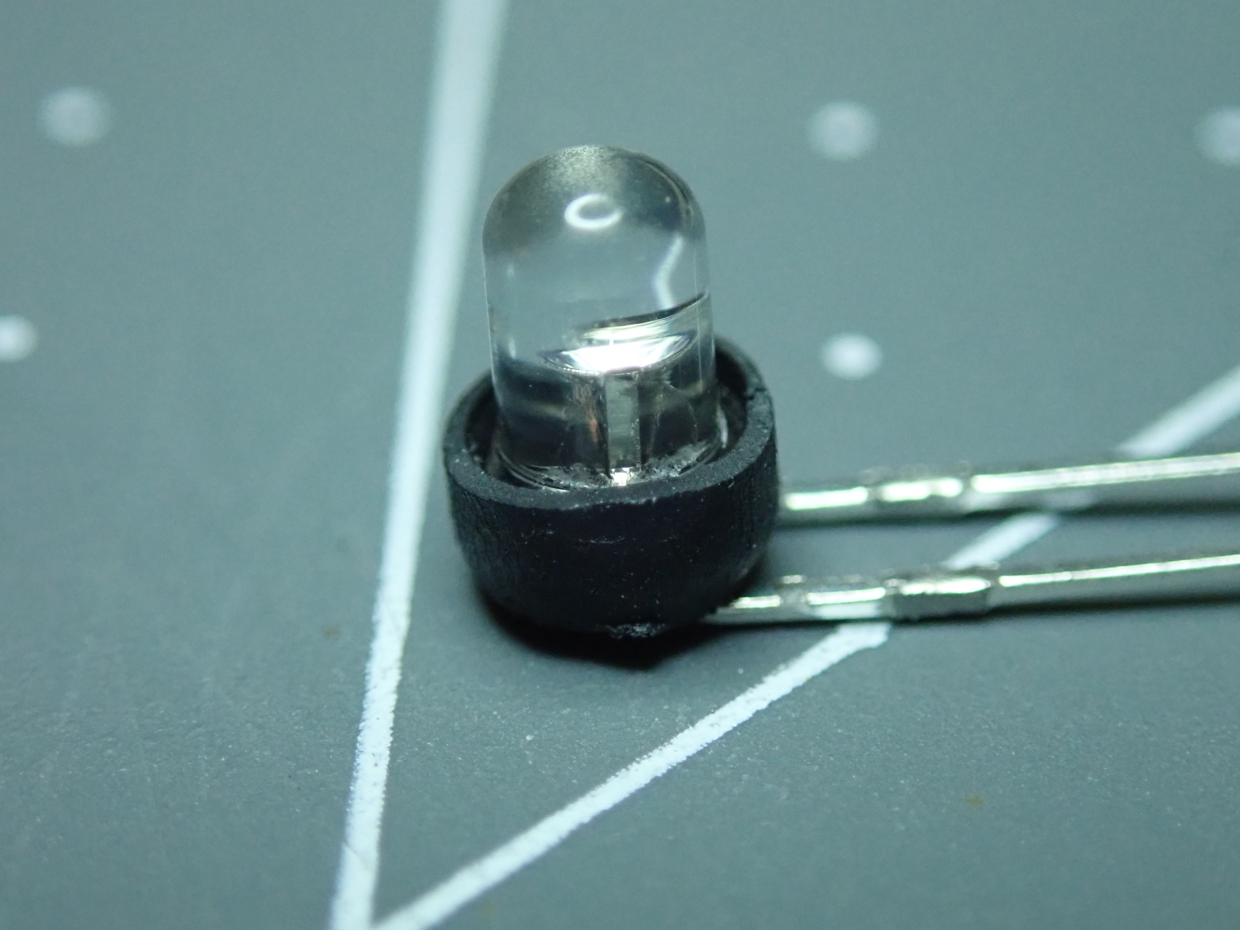

So the red aux mod put me through a bit of a ringer... In essence, since there isn't a spring I needed to mod the red lens, aluminum holders, 3d printed piece, so that there is some play to allow the red lens and led to act as a "plunger" to activate the aux button... So here goes....
First off, since I had this as a static prop and followed KRSabers youtube instructions on assembly, I cut the bottom portion off the red lens (left in picture below). Well, I need the button to be more or less intact so I had to order new buttons (right). Luckily these were cheap (3 for $1.05) and relatively local to me so shipping was 1 day. My roughed modded lens is in the middle.
Here are some reference measurements.

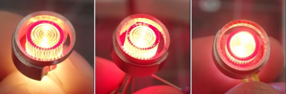

And while I was at it I experimented with the led color.
(L) Warm White included in the kit, (M) Red, (R) Cool White.
In person the color is much more noticeable. I decided to go with a red led.
