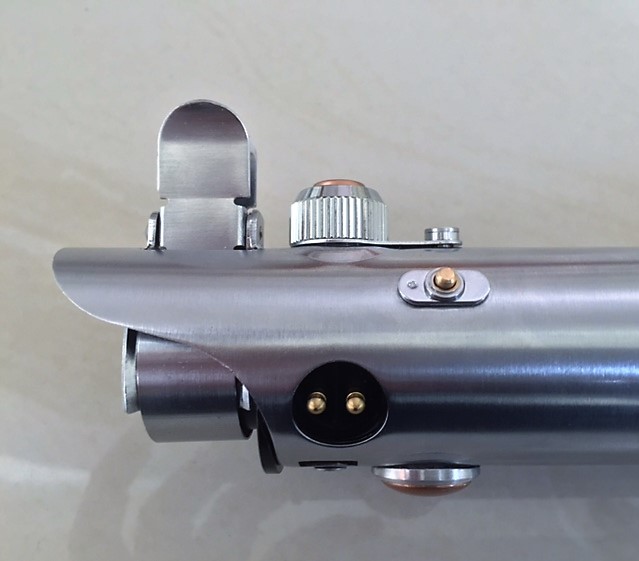

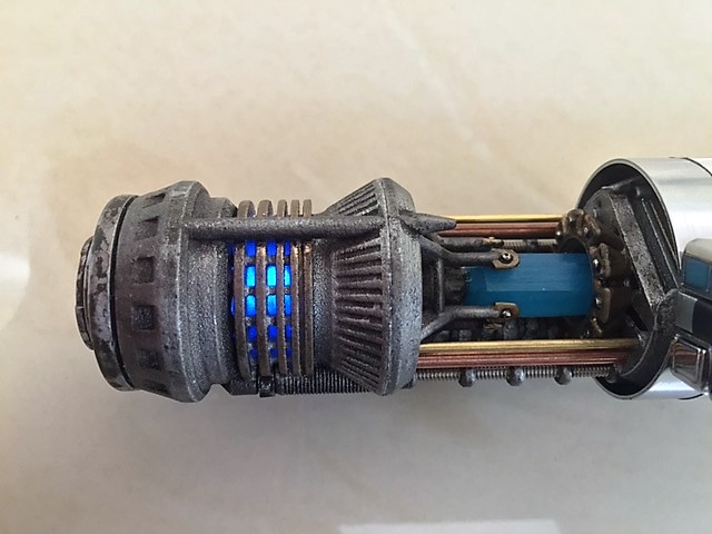

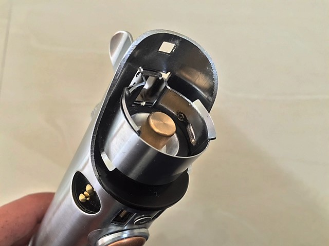

Decided to convert my Parks V1 Replica to a ROTS version, or what I think it should have looked like, keeping all the elements of the ROTS screen saber. Used/did the following to complete it, but am still waiting on the stamped Mylar Tape and a new clamp leaver which I am having brass/gold plated.
1. Parks V1 Graflex Replica
2. KR Sabers Blade Adaptor & Blade Plug
3. Tri-Cree ( BBW )
4. TCSS ROTS Pins
5. Graflex Shop Heat Sink
6. Goth Knight Chassis ( Replica Version ) & Crystal ( Painted Tamiya Clear Blue )
7. TCSS Covertec Clip
8. Slothfurnace Clamp card
9. NB3 Sound Card
10. Wannawanga grips
Custom Made the bottom Button and pommel end cap and tweeked side switch to make it the activation switch. BUTTON.jpgFULL VIEW OPEN 1.jpgFULL VIEW CLOSED 2.JPGENDCAP.JPGEMITTER 1.JPGCRYSTAL CHAMBER 3.JPGCRYSTAL CHAMBER 2.JPGCRYSTAL CHAMBER 1.JPGCLAMP.jpgLOWER BUTTON.JPG
I did one of these myself. Let me know how those TCSS ROTS Pins look, because I debated swapping mine out with those. That end cap looks great.
Mate, I can't recommend the ROTS pins highly enough. Well worth the purchase!
This saber wasn't actually a graflex, nor replica graflex based was it? It was fully machined at a 1.25" OD vs the standard graflexes 1.5" OD. At the time of RoTS people were saying it was because hayden had tiny hands :)
Not to say you didn't do a great job with it :)
