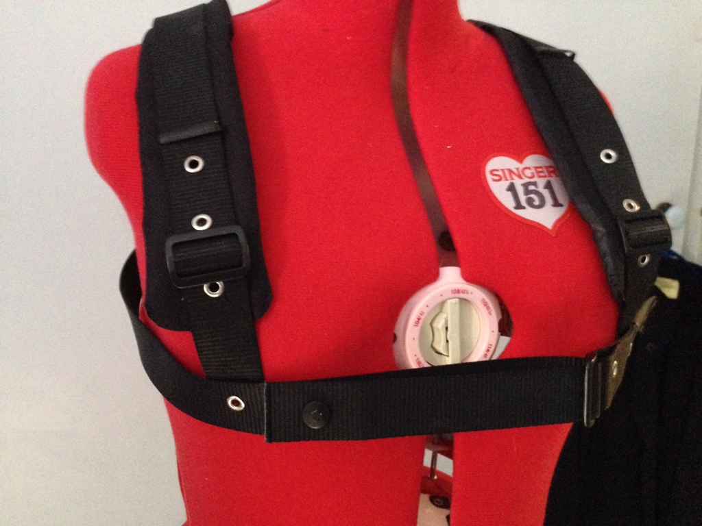

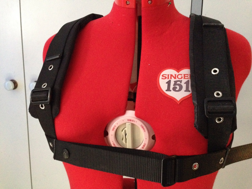

Here is my harness build. Hopefully the images work cause I'm using my phone...
So, after studying all forms of references I worked out that he has the two shoulder straps which attach to a horizontal strap, which in turn goes under the arms and attaches to the back holster thingy (and obviously the shoulder straps also insert into this holster thingy). It's pretty much a custom build because I could not find anything commercial that matched and I wasn't happy with how the weight-bearing harnesses sat/looked. The horizontal strap is actually two pieces of webbing that thread into a step lock; one side is fixed with an eyelet and the other attaches with a press stud, so it's easier to get on and off.
I bought some 32mm webbing, eyelets, nylon sliders, a press stud, and a couple of strap keepers (I actually couldn't get them in the right size in nylon so had to spray paint metal ones). Technically the front horizontal strap has a step lock but they didn't have any in the right size so I just used one of the sliders. It still works but the webbing doesn't sit as flush as it would with the step lock but oh well.
I bought a cheap backpack from the Reject Shop and unpicked the straps. I made a pattern for the back harness holster thingy (where he holsters the Skorpion) and cut out the back of the backpack (the part that would rest against your back. Including the foam padding and lining). Pinned the shoulder straps and webbing to the top corners, pinned the horizontal strap webbing to the bottom corners and stitched around the edge of the entire thing. I was on my own trying to measure it all out and check fit so I'd recommend getting someone to help to make the job easier/faster -_- Anyway, once you've worked out the correct length you need for everything it's a matter of adding the sliders, strap keepers, eyelets and press stud where they're meant to go. The eyelets attach the shoulder webbing to the horizontal strap. And I ended up applying a dab of contact adhesive to keep the webbing on the backpack straps. Now, I haven't added the weird bit in the centre of the back holster thingy where his Skorpion attaches to but overall it looks accurate and if you wanted you could probably figure out how to do that.
Sorry for the long post but hopefully it makes sense. Lemme know if the images don't work.
View attachment 315079View attachment 315080View attachment 315081
How did you get the eyelets so well onto the webbing. i've used eyelets before on vinyl but on my webbing they keep moving off centre or warping the actual webbing itself...

How do you keep the harness from riding up in the front with the weapon attached to the back?
It might be the length of the stem on the eyelet? I'm using eyelets for leather which may be longer than those for material. As for keeping them straight, uh I tried to make sure I kept the eyelet setter vertical and hammer straight down. I have had off centered eyelets before - often because I've struck it on an angle - so I took my time and got lucky! But it may just be the length of eyelets you're using if it's warping the webbing.
Depending on how heavy the plate/weapon at the back is, safety pins or fashion tape could work. Or just making the harnest tight enough
I haven't been able to get a Skorpion yet (my state laws are crazy strict and my usual toy gun seller doesn't sell them DX ) so I haven't carried a weapon on my harness. But, the front horizontal strap does keep it in place pretty well so it shouldn't ride up much. You may need to tighten the front strap. Alternatively you can probably use velcro on the underside of the harness that keeps it to your back if it is slipping.

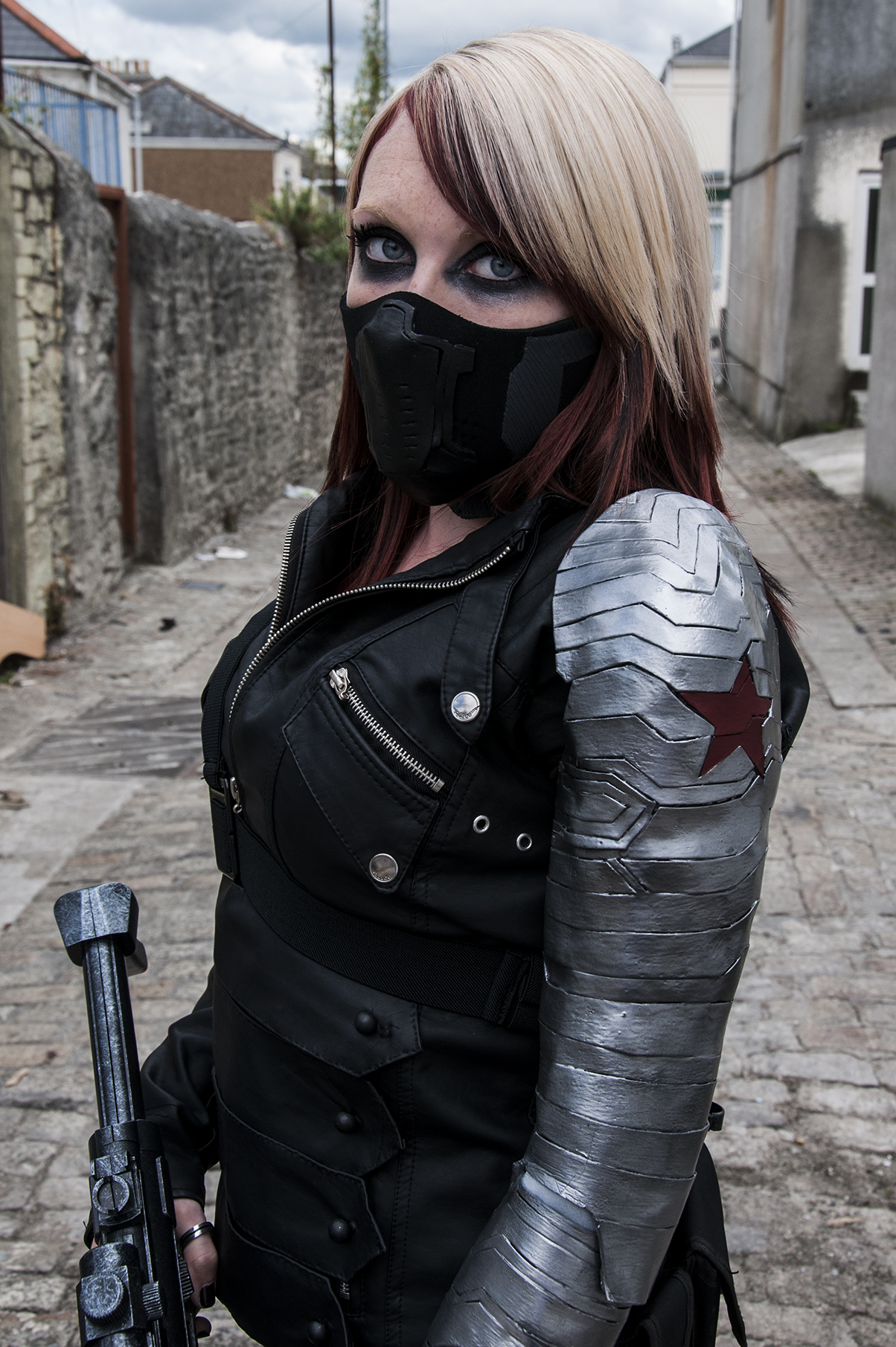

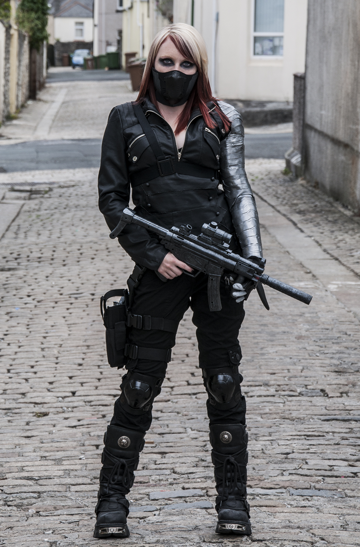

Havent posted in a while...but have finished my costume :D Yes it's not a direct replica, but costing, time and body shape (being very short!) means this is the best I could do, wanted it to have a more feminine edge so kept my hair and only panelled the front of the jacket up to the chest. Hope you like it! :)
View attachment 364335View attachment 364336View attachment 364337View attachment 364338View attachment 364339View attachment 364340
That's awesome! How did you go about making your arm?
