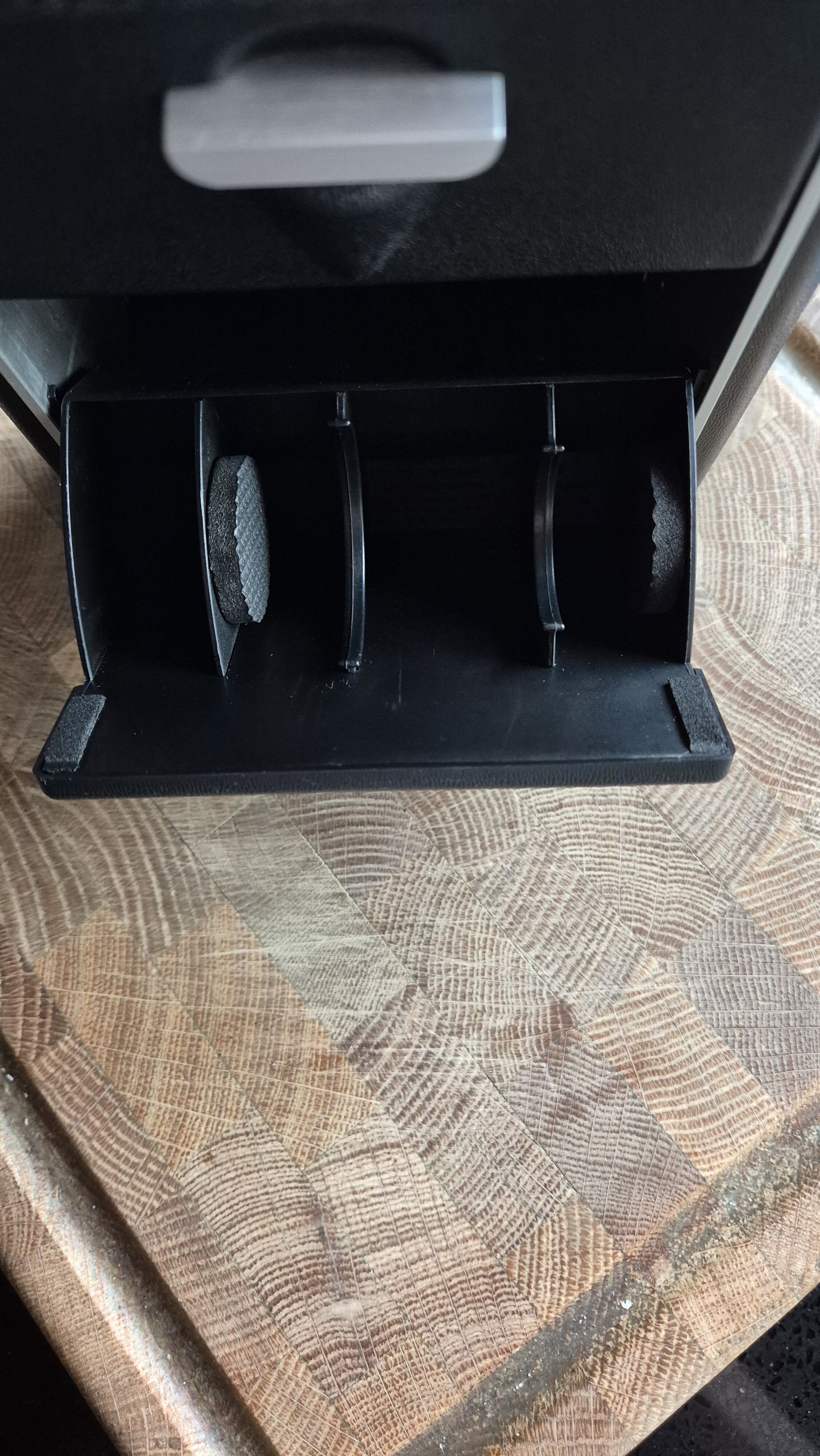

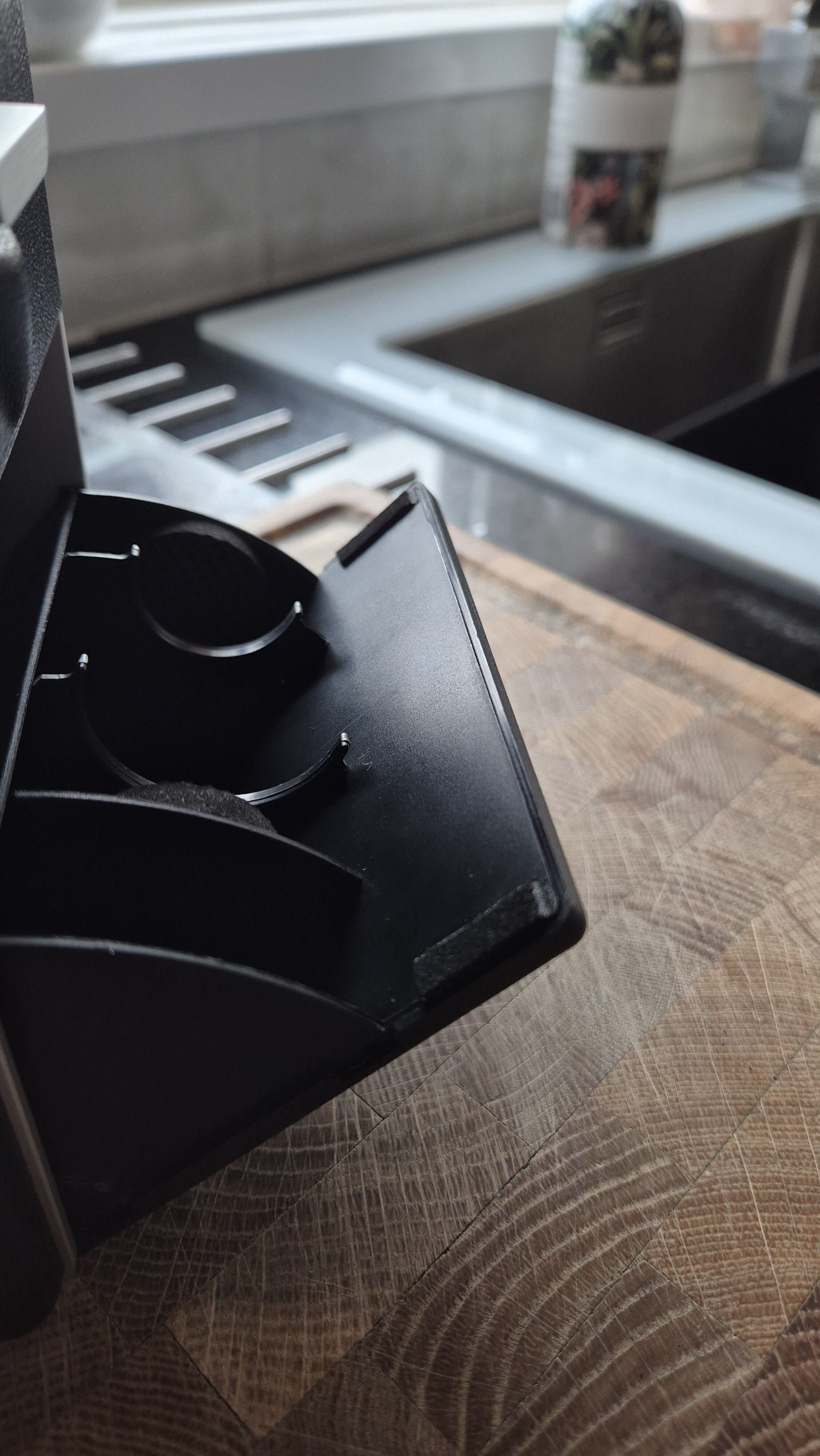

On the subject of felt, I have put two pieces of foam on the inside of the lower compartment edges. I found that after a while of opening and closing the compartment door it doesn’t stay completely flush when it's closed and taps against the ABS. I've positioned them so they look like they're meant to be there.
Also the round foam pads I mentioned before to stop the scanner falling out of the dividers when the trike is angled.

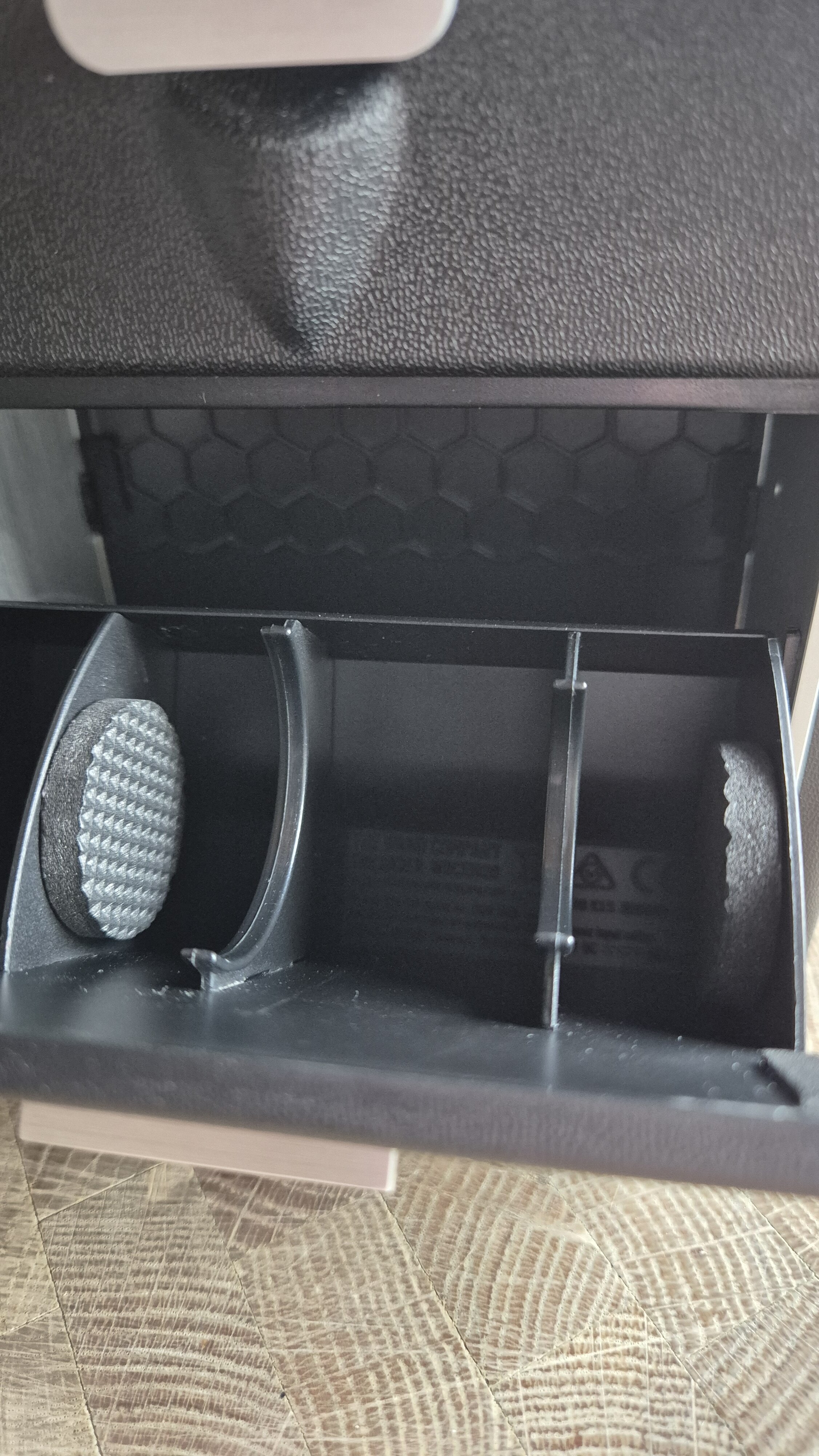

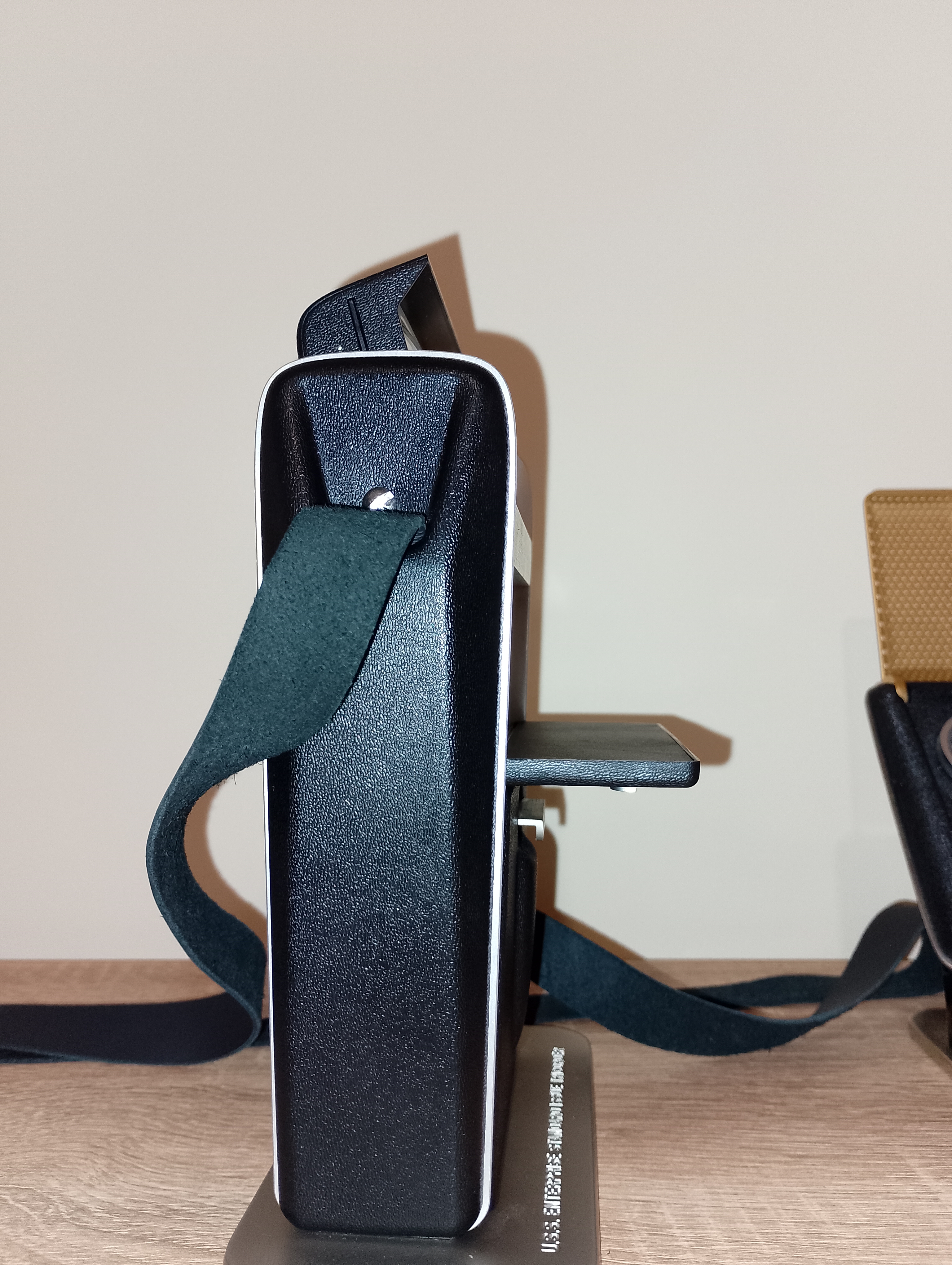

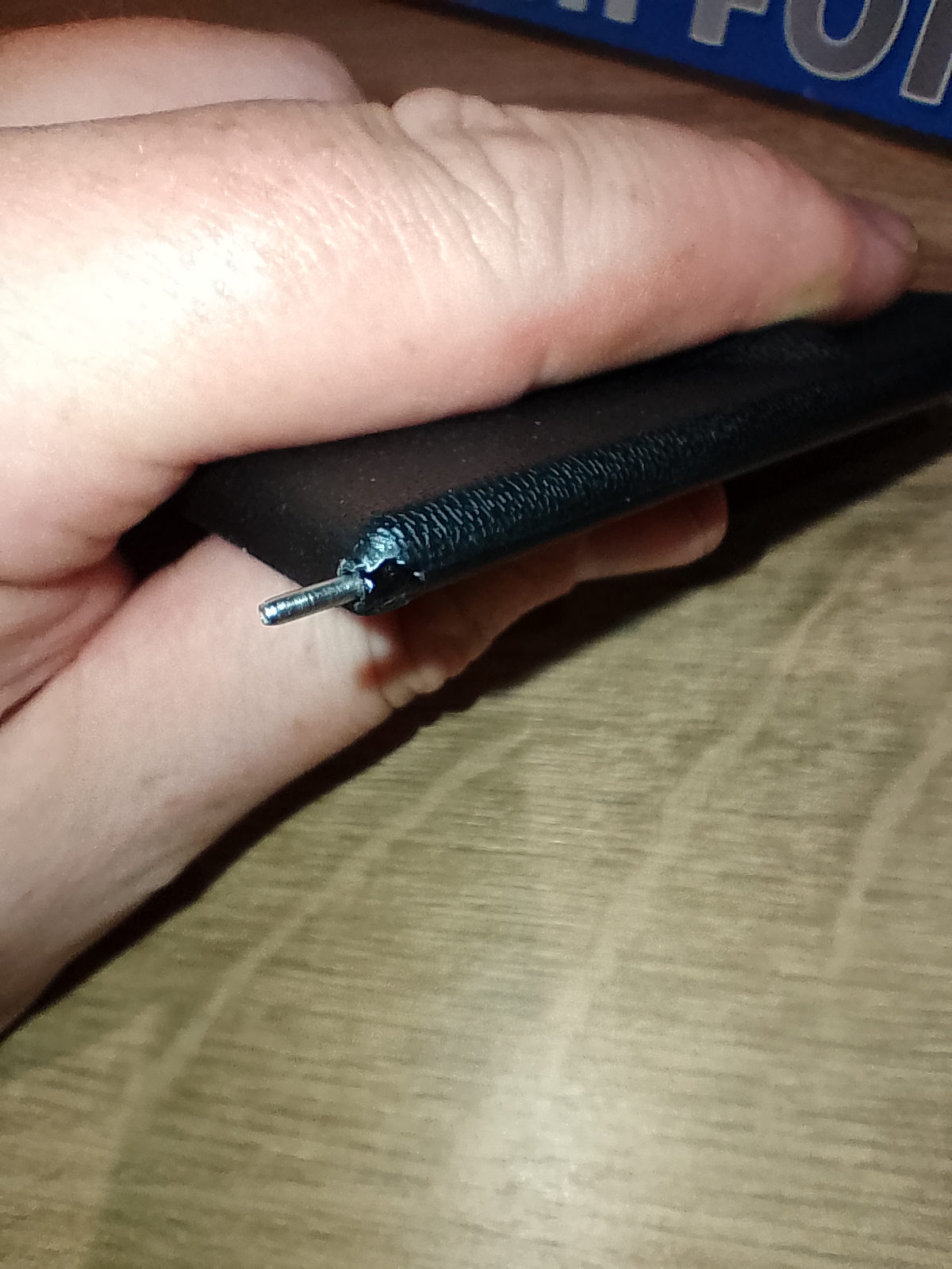

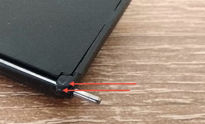

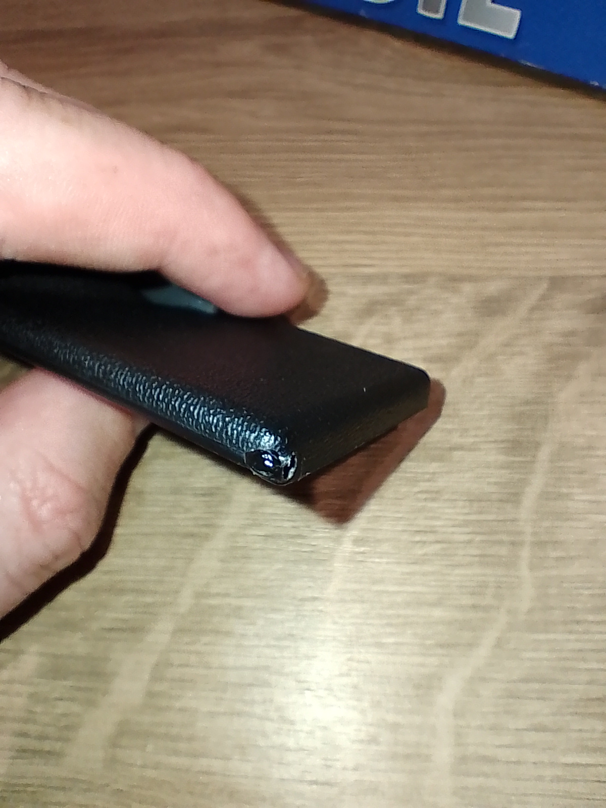

I've managed to get my door holding securely at 90 degrees. I remembered it held better before I sanded the plastic lightly near the pivot to remove some flash. The flash seemed to act as a bit of friction which held it in place.
I decided to try and use a bit of black super glue to build it up slightly so as to act as a grip. It worked and now the door hold in place when open.
