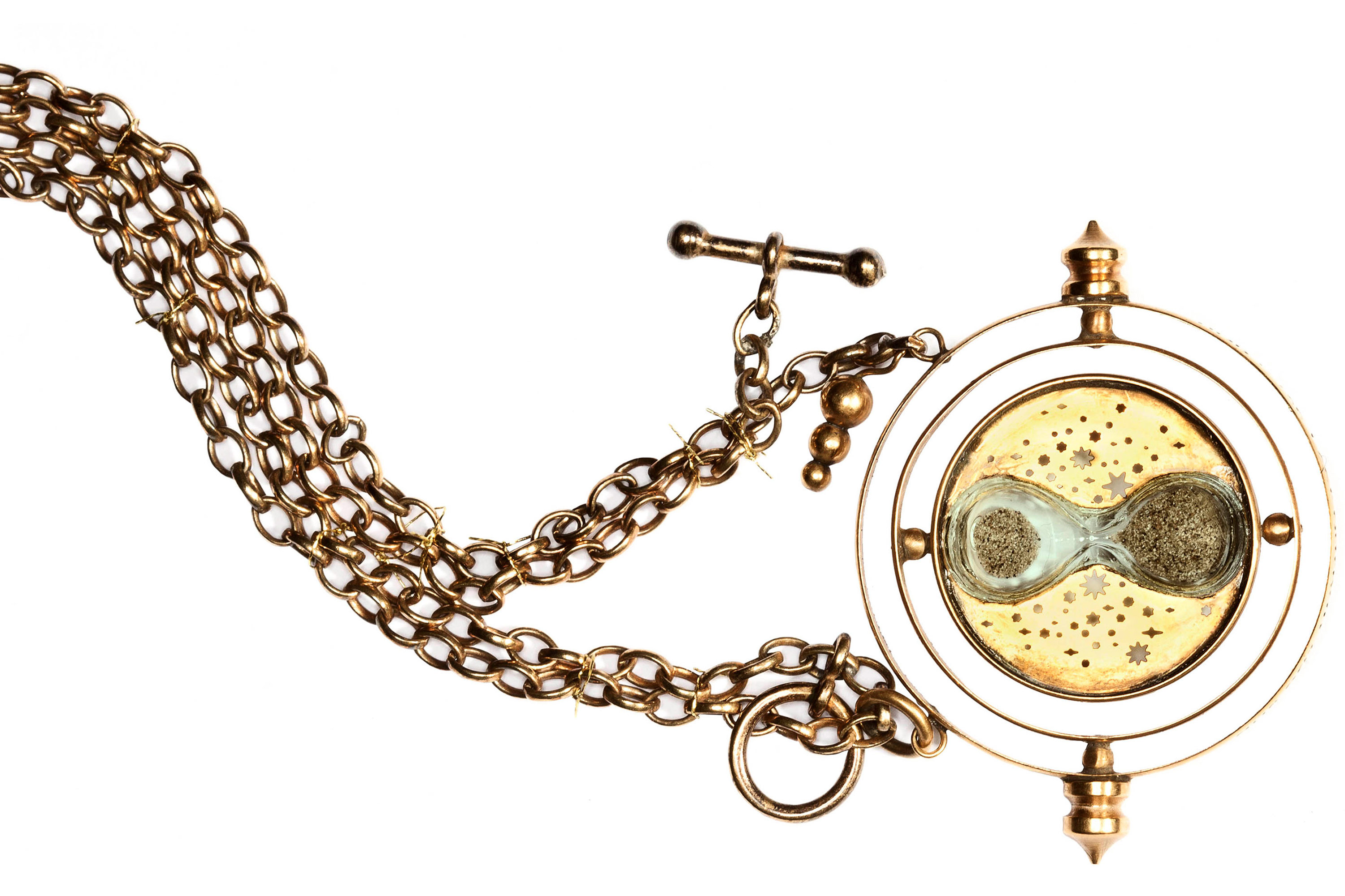

I did props for movies and TV shows for a couple of decades - and whenever we made anything that had engraved text, we'd usually have to darken it up for camera. With regular engraving you lose detail if it's being hit with a lot of straight-on light, so the standard solution was to paint it with some black or dark brown acrylic paint and then wipe it off so it only stays down in the engravings. Much better than printing on metal - since printing can scratch off or look slightly raised (and look like cheesy printing) if seen in extreme close-ups. Getting metal items engraved is actually not all that expensive or difficult for a good engraver these days - there's a lot of really accurate, high-tech ways of doing it. Advice: get/make multiples of all the parts that need engraving, and have the engraving done on the rings before you assemble anything - just in case they mess it up. And see if you can find a jewelry shop with someone who likes Harry Potter and you'll have a better chance of getting it done right. :)
Thats a really good idea about the paint for the engraving, but because we have pictures of the "real" prop both with and without the paint I think I will let whoever buys decide for themselves. I know engraving isn't that difficult anymore, so I'm not worried about that. I've just begun preliminary talks with a Jeweler today, PROGRESS!

Well we've got no reason to believe that Noble's is the wrong size except for the fact that noble often goes out of thier way to make things wrong. As we've got no reference as to the size right now, an because of the "switch the star plate" thing, I have a feeling we will use Noble's size. If, however we do get a size reference I may decide to go with that.
Is the hourglass piece in the middle a "found" item? Also the chain and the details (finials) might be jewelry pieces that are available - not custom made. I don't know a whole lot about this piece, so forgive me if I'm speculating about something that's been solved long ago.

If buy "found" you mean I know where to buy one, than no, but I have a feeling this may have to be made for the time turner. The chain should be relatively easy to match.

No by "found" they mean something that was not custom made. Something they found somewhere else and used to make this with. I would actually want to switch plates on the japanese one since the chain connection is on the wrong side on the noble, plus it was my idea :)
I agree with Phelx, I build props for a living and I darkened the engraving on my Japanese one using an antiquing solution. It makes a major difference.

I can definitely send measurements, until then...
I just compared the design you laid out to the japanese version and there are some differences. Was that based of the noble version?
Differences:
1 The Jversion uses the symbol for "and" instead of the actual word
2 The chain is connected between the words mark/the and every/one, not in the middle of a word.
3 Each side of the ring is printed upside down compared to the opposite side, not sure the noble one does this.
The chain is so people know from what angle we are looking at the time turner, not to represent where the word breaks are, sorry if that was confusing.
Response to differences:
1. Noble's does in fact use the and symbol, I just did a bit of a sloppy job
2. That's what I was thinking, but as Noble's has a different line of the poem there I wasn't sure if it would fit
3. I didn't even think about upside-downness, again sloppy job, I will need to think of a way to represent in a picture all the info, which is so hard to gather as the rings spin and change order...
Can everyone do me a favor? Be on the lookout for the knobs on the sides, they may be expensive to have custom made.
