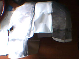

I'm trying to scale an Ironman pepakura armor to fit my 3 1/2 years old boy. I'm having a hell of a time doing it because his proportions are not those of an adult which are the ones used for the original files. Any help changing the pepakura files to fit his body? I know he's going to outgrow it very fast but I still want to do it with him. For reference, here's a picture of a paper Iron Man Mark 1 helmet scaled to 75% of its original size and grotesquely modified to fit his very round head:
Thank you very much in advance!
