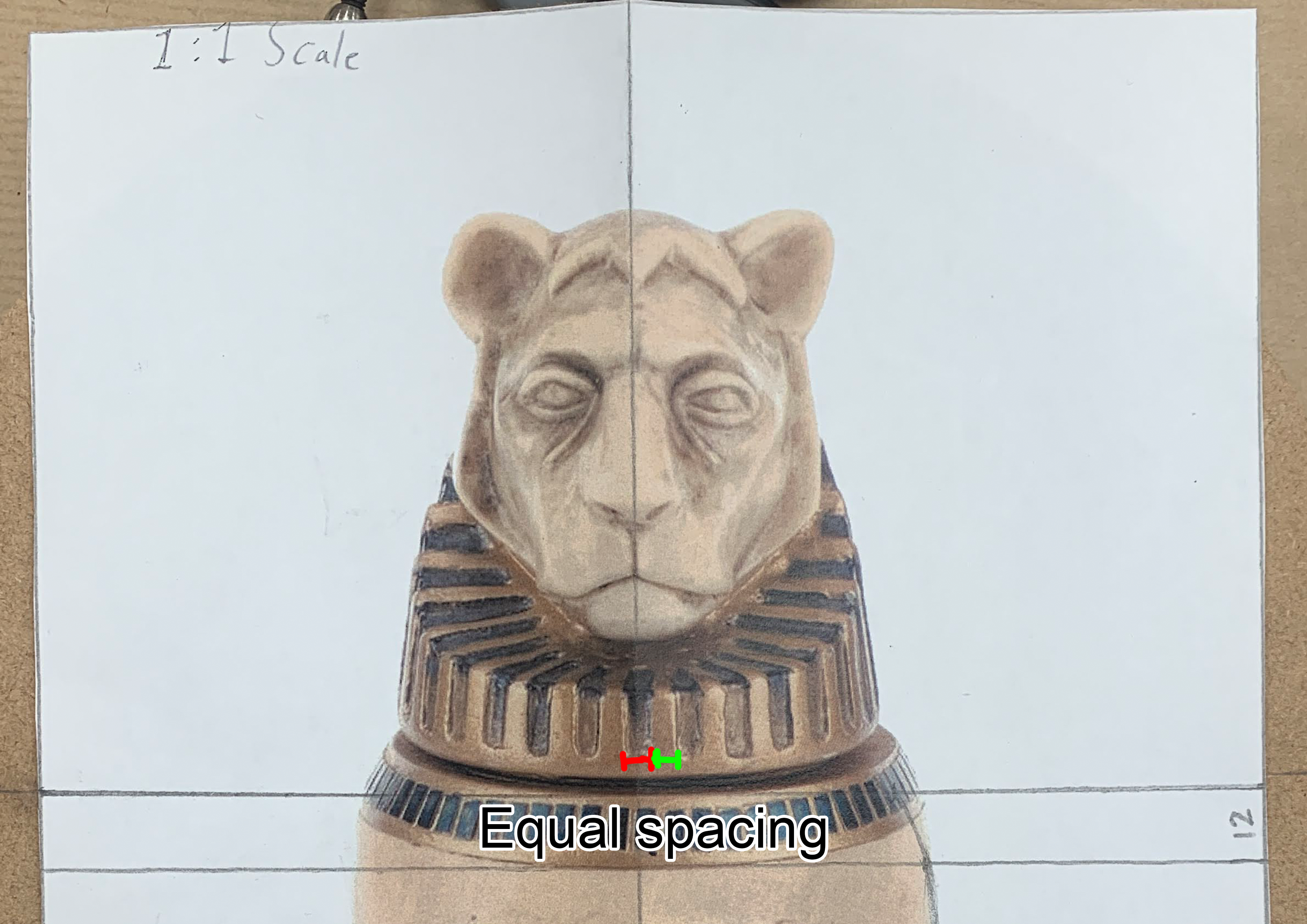

I discovered that the falcon head had a slightly different base from the others. It has a pointier back, which made me realise that they all look somewhat different.
By counting the lines and measuring the height difference on the back I could also identify the level of curvature.
Unfortunately, there aren't many references for the Jackal, Human and Baboon head. The ones I could find were either screen grabs from the films or the jars at a The Universal Studios display (Canopic Jar and chest props from The Mummy movies...)
By looking at these images I could safely assume that the jackal and baboon bases were close to identical to the Lion's head. This meant that I could use the Lion heads base as a reference for the other 2. This also meant that the falcon and human head had to be sculpted separately.

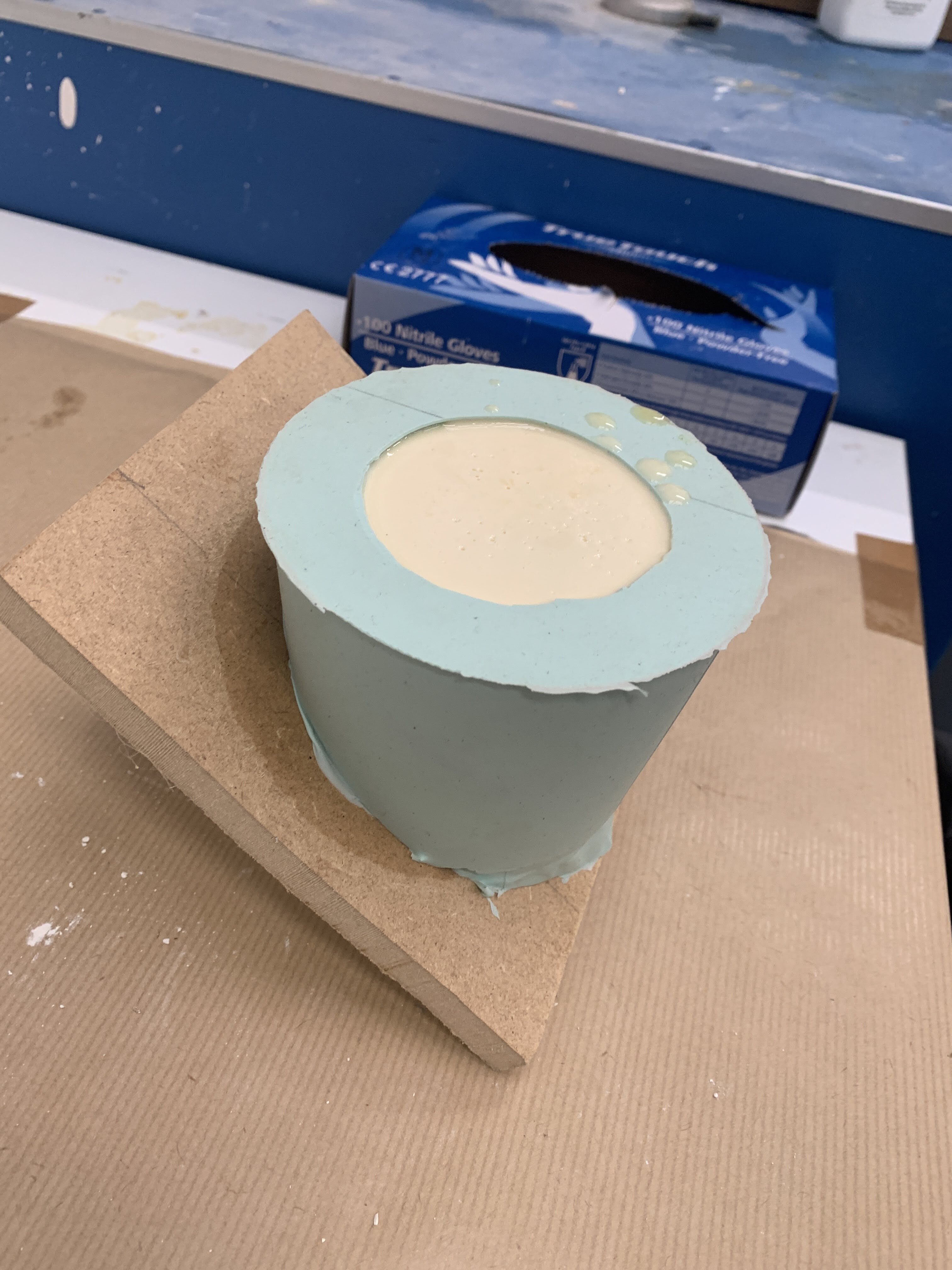

Introductory jokes aside, I began by creating the base with some blue foam and covering it with some oil-based clay.

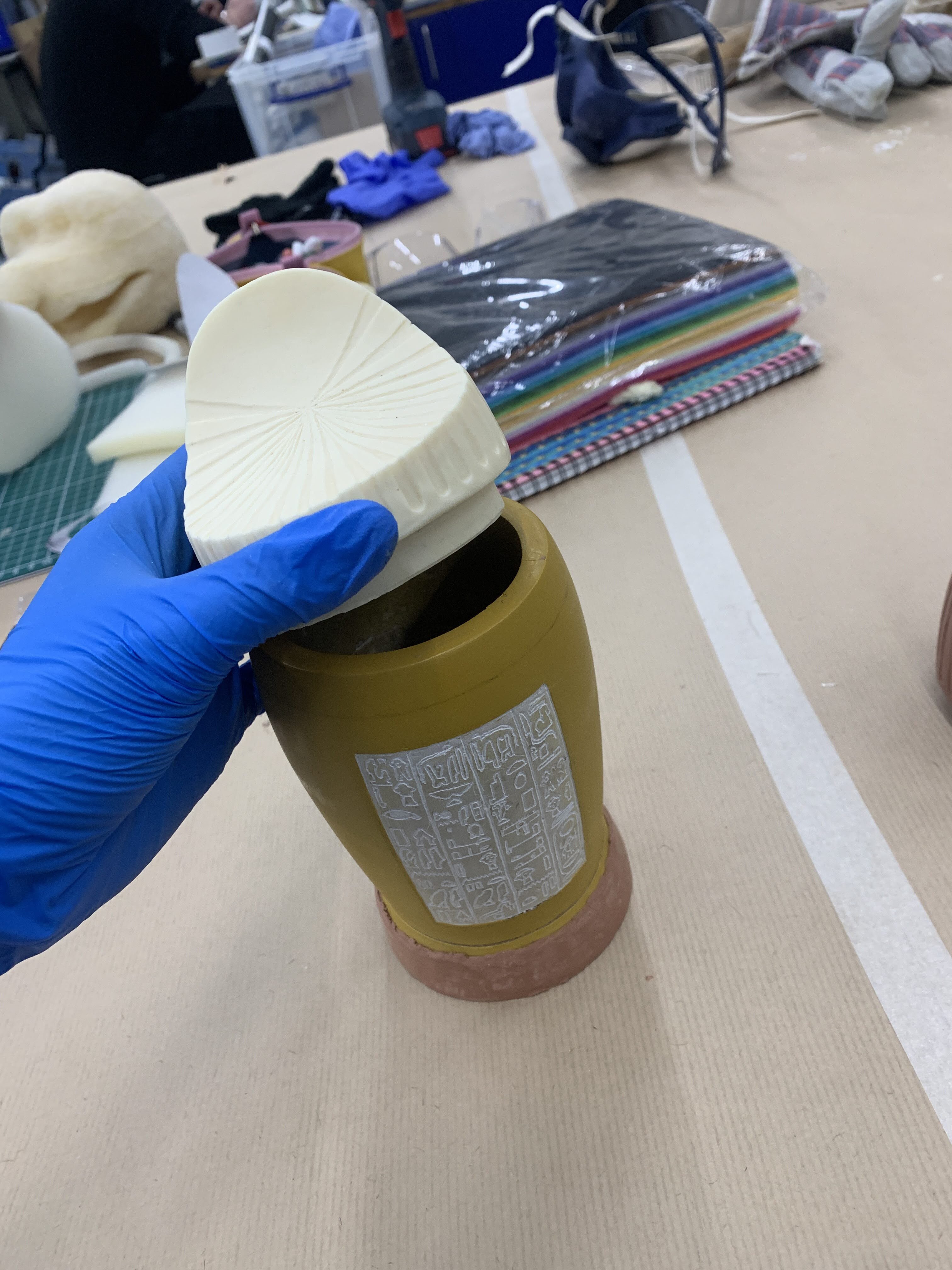

The same techniques were used for both bases. Two different bases were sculpted, they were both moulded but the lion base was copied 4 times. I chose to make resin copies of the bases so as to not ruin the geometric details whilst sculpting the heads.

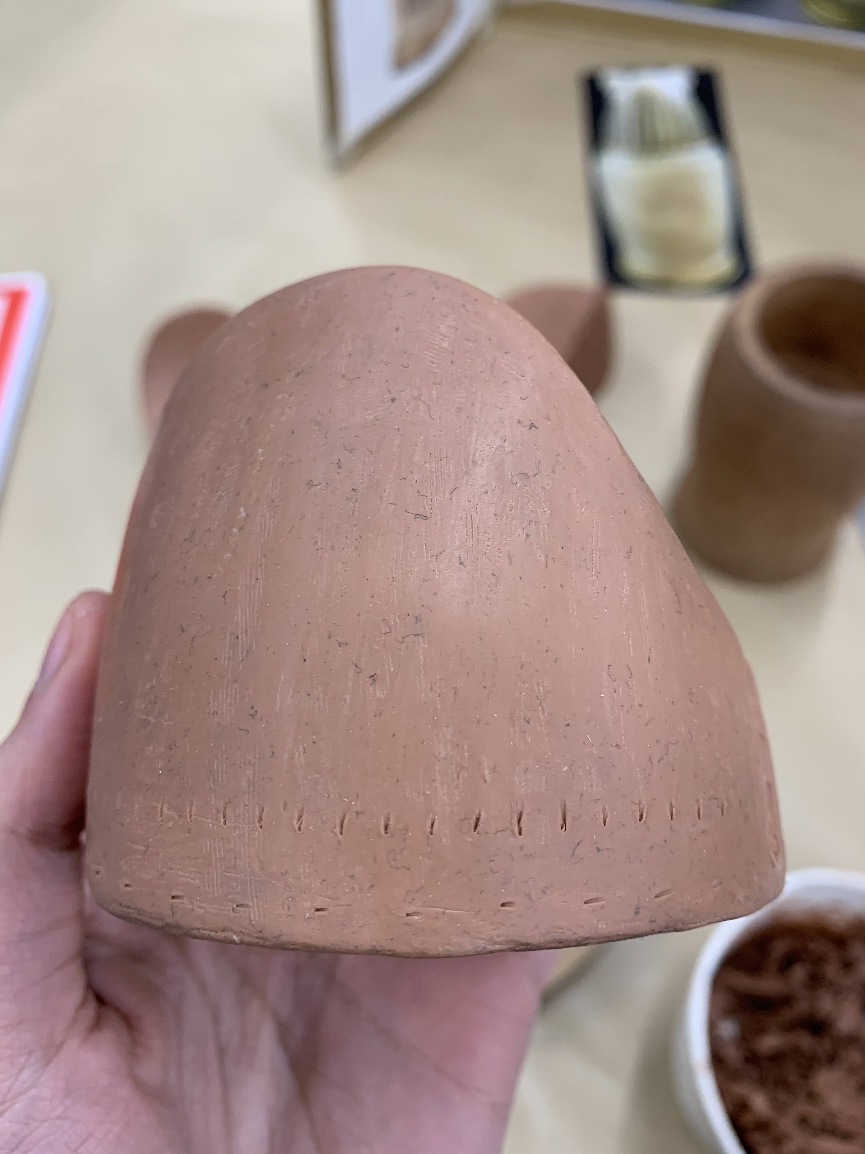

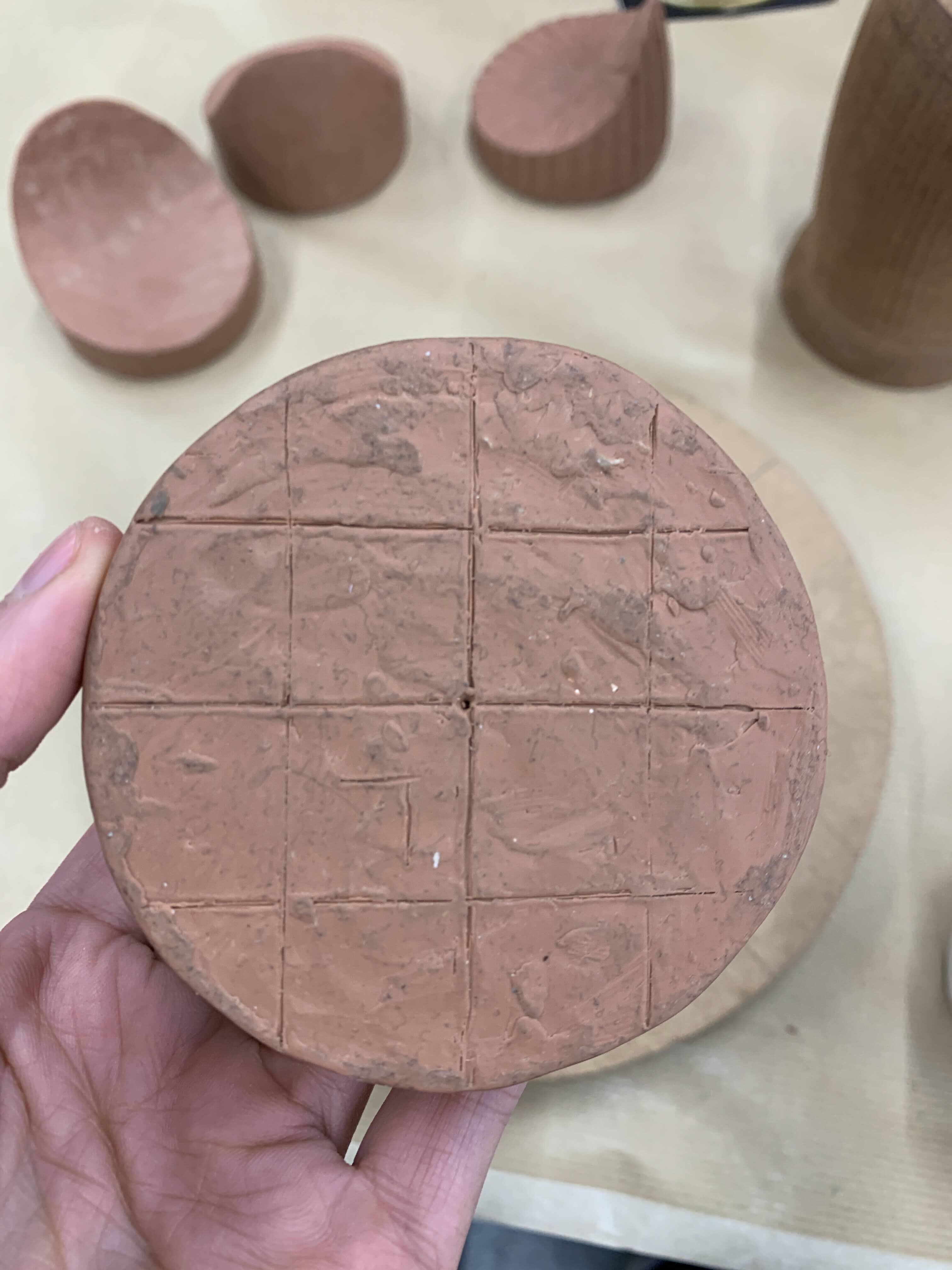

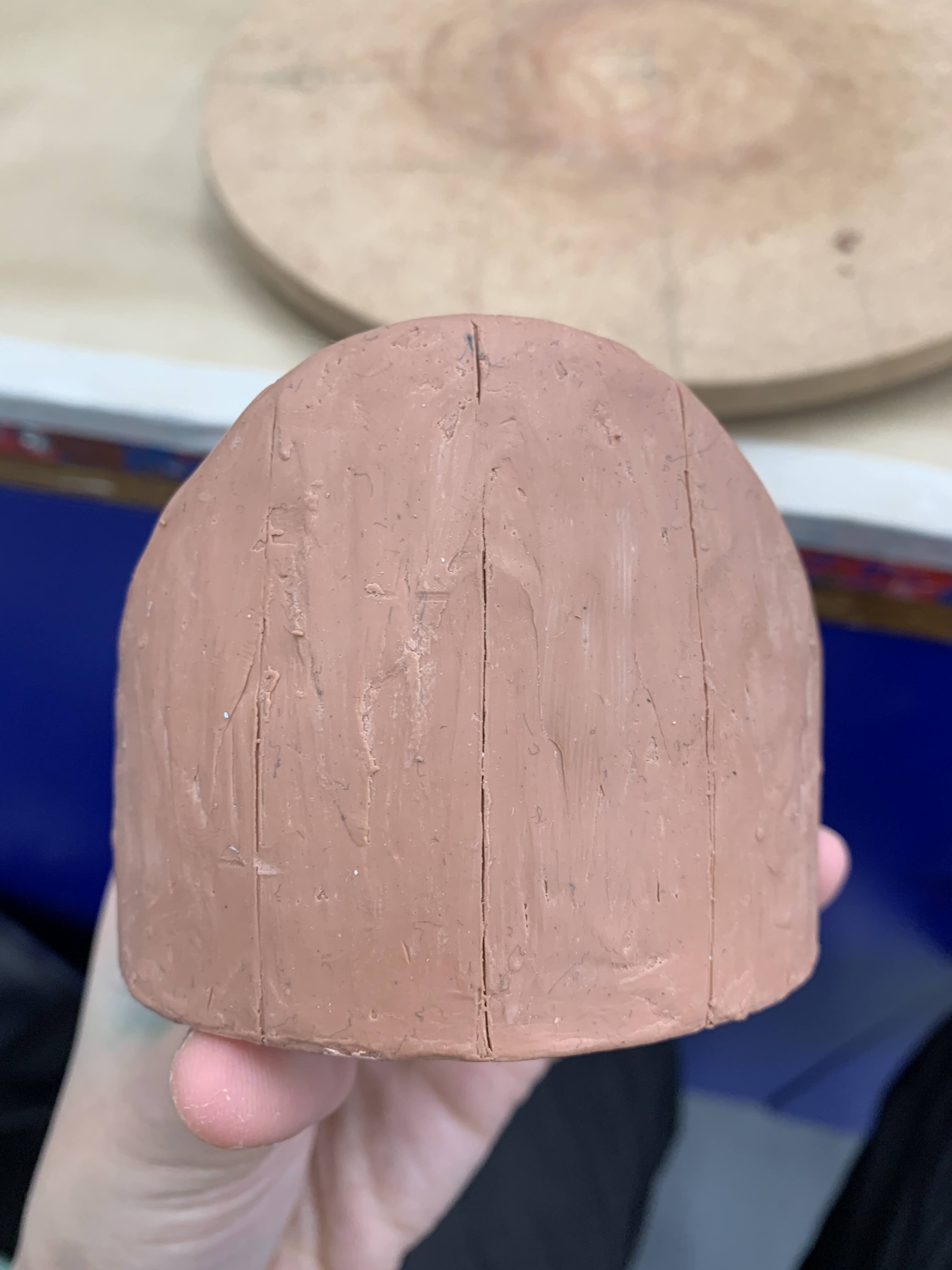

To uphold symmetry, grid lines were drawn onto the bottom of the base. Wherever the grid touched the edge, the lines were brought upwards. This gave me equally spaced sections around the whole perimeter. These lines were used to measure both sides and to refine the curvature.

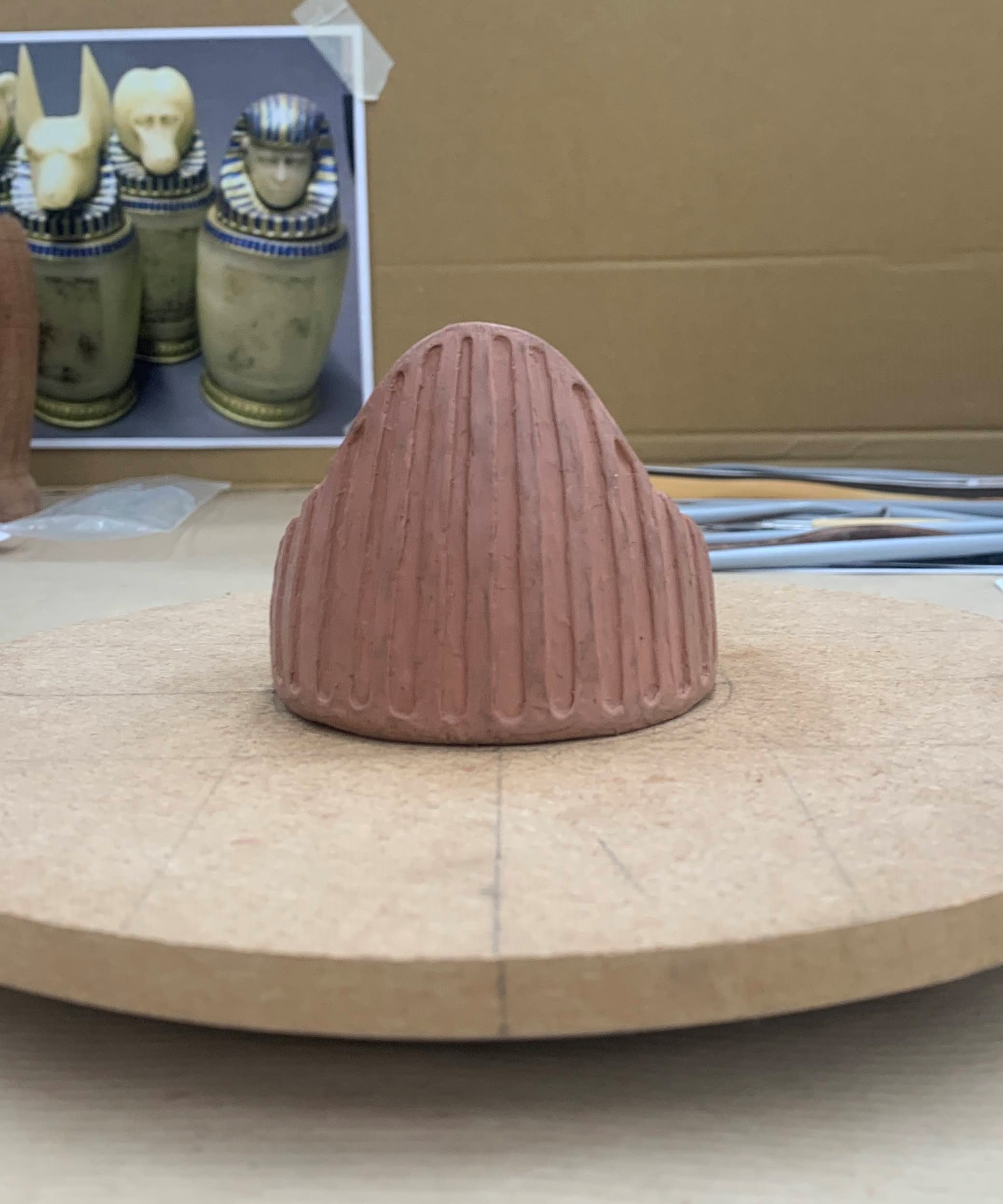

Once the final shape was sculpted, I proceeded to work on the recessed details. I determined from my scaled print of the jars the thickness of the recesses and the spacing between them. I marked this distance on the sculpt and was happy to find out that it matched the circumference perfectly. From there, I drew out the lines and cracked onto more...sculpting...

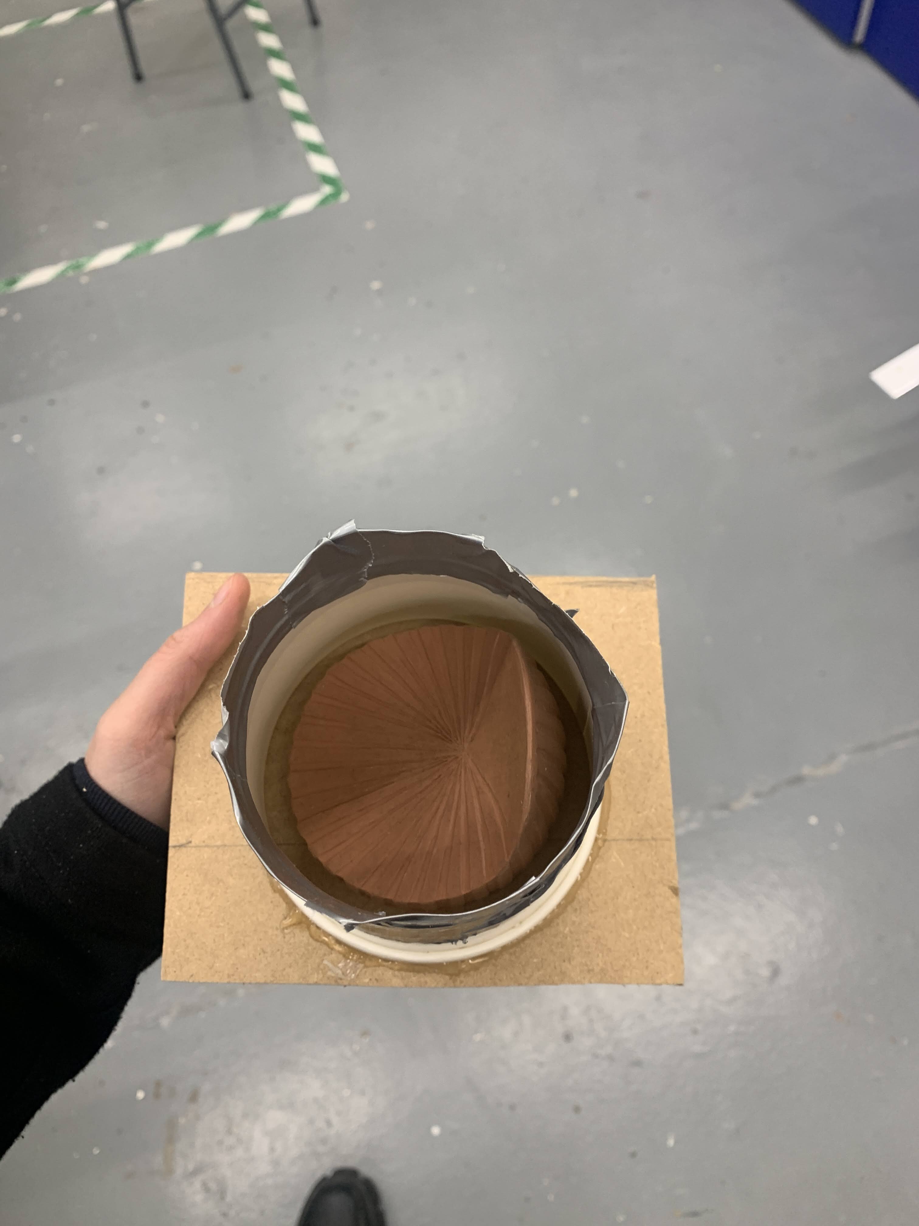

The next part was pretty simple. Dump Moulding the sculpts and casting copies.
