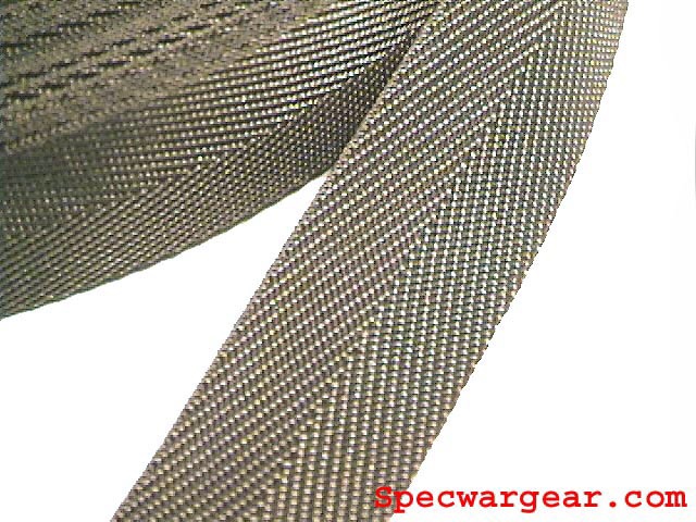

I managed to figure out how the webbing is made and I have to say it's clever and stupidly obvious. They went for herringbone webbing which also goes under the name "soft herringbone tape" and "Horse Blanket Binding". It's interesting because it can me either cotton or acrylic that is supposed to "feel like cotton" as advertised. What they got was two sizes, one 45mm herringbone (the V-shape) for the Nautic buckles + Cobra Compact at the belt, and another (guessing 25mm) without the herringbone weave as the Molle.
I can't upload pictures now, but at the front where the webbing goes from 45mm to 25mm they just folded it and sewn it double thick where it is 25mm. It's not obvious at first glance which is brilliant!

Good research. This is a military herringbone tape:
It still doesn't look perfect though but very close

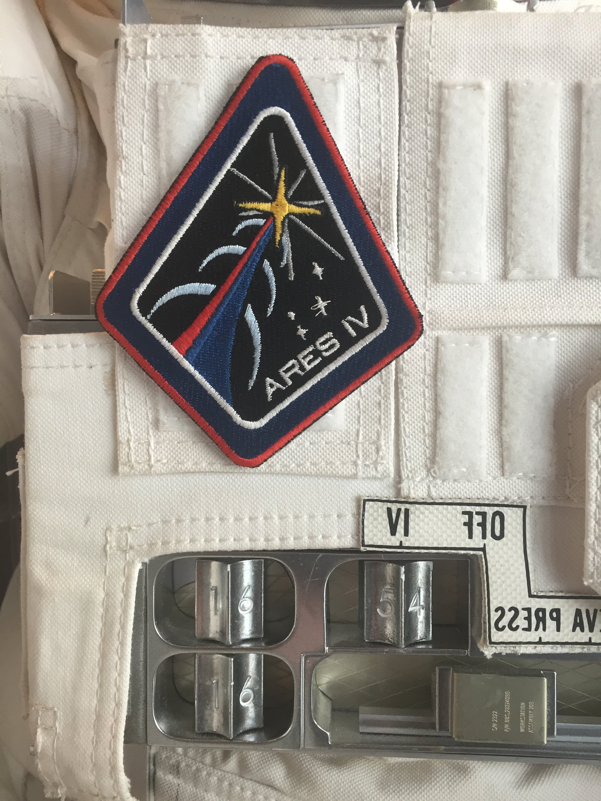

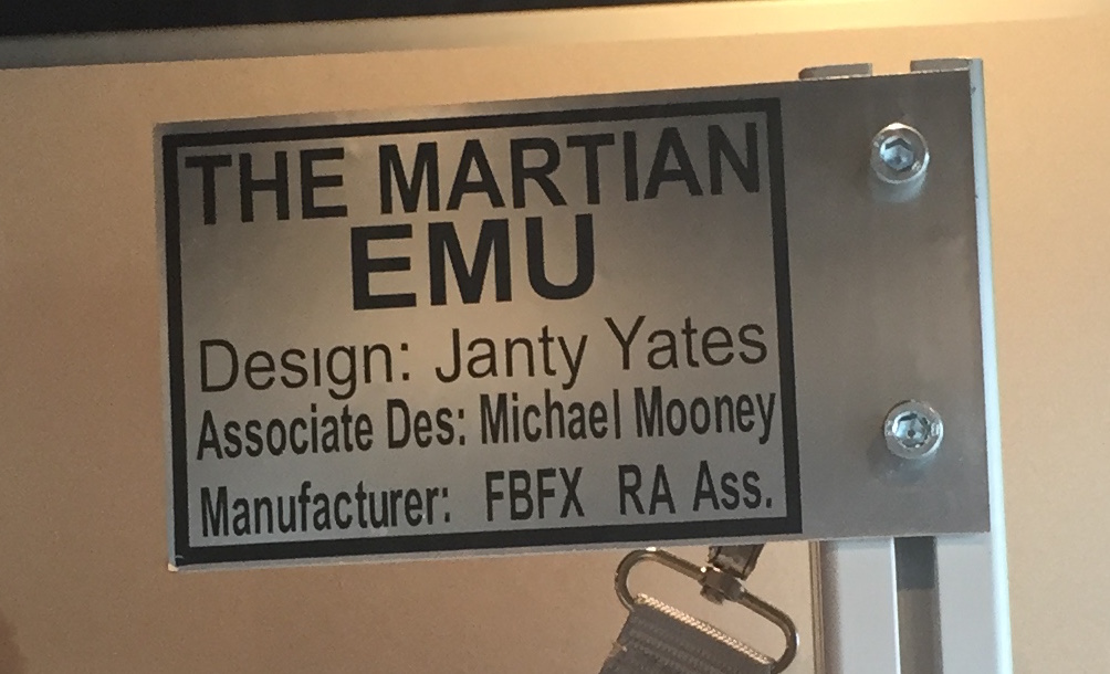

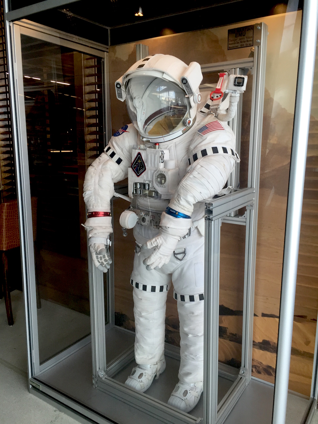

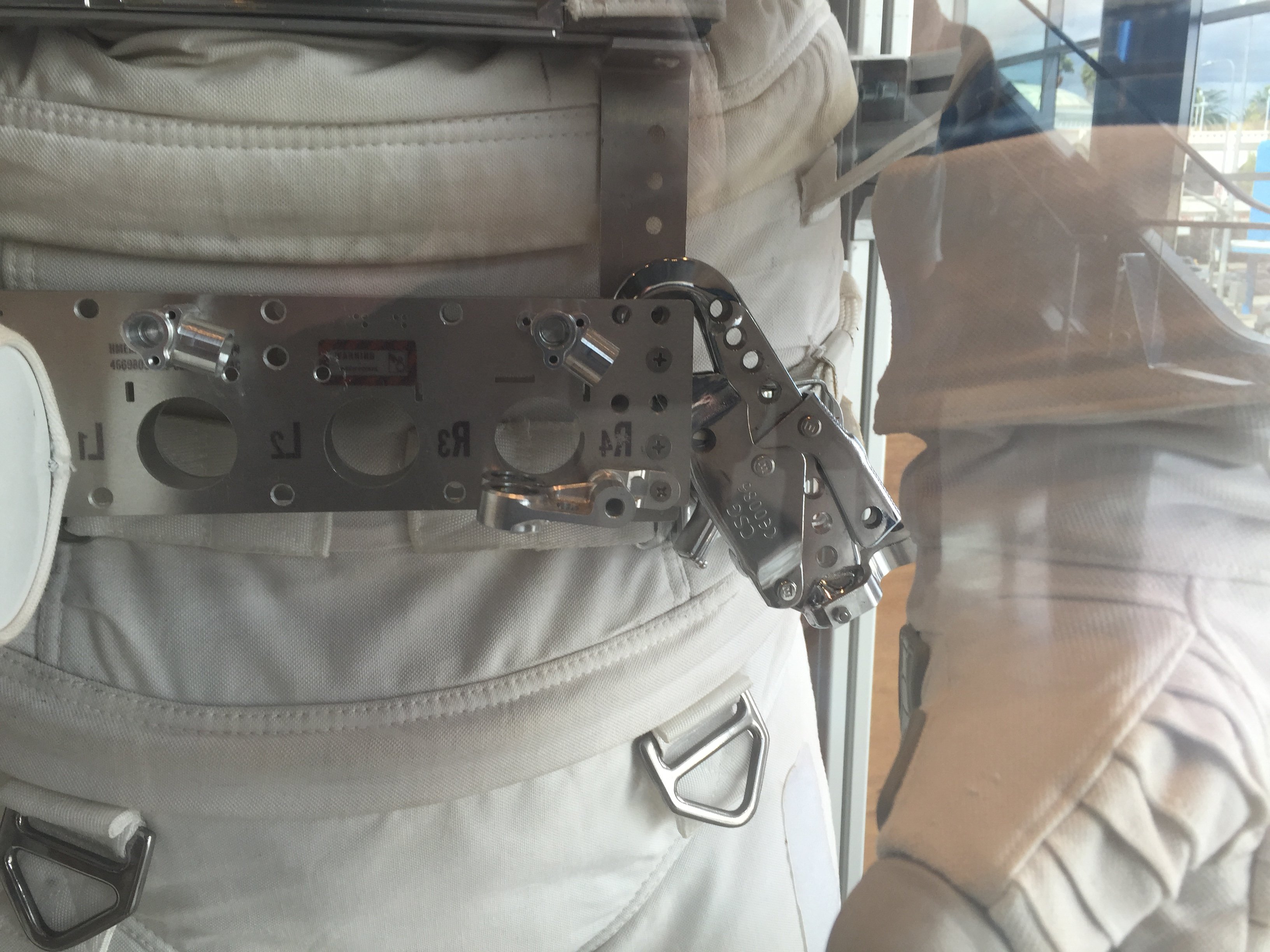

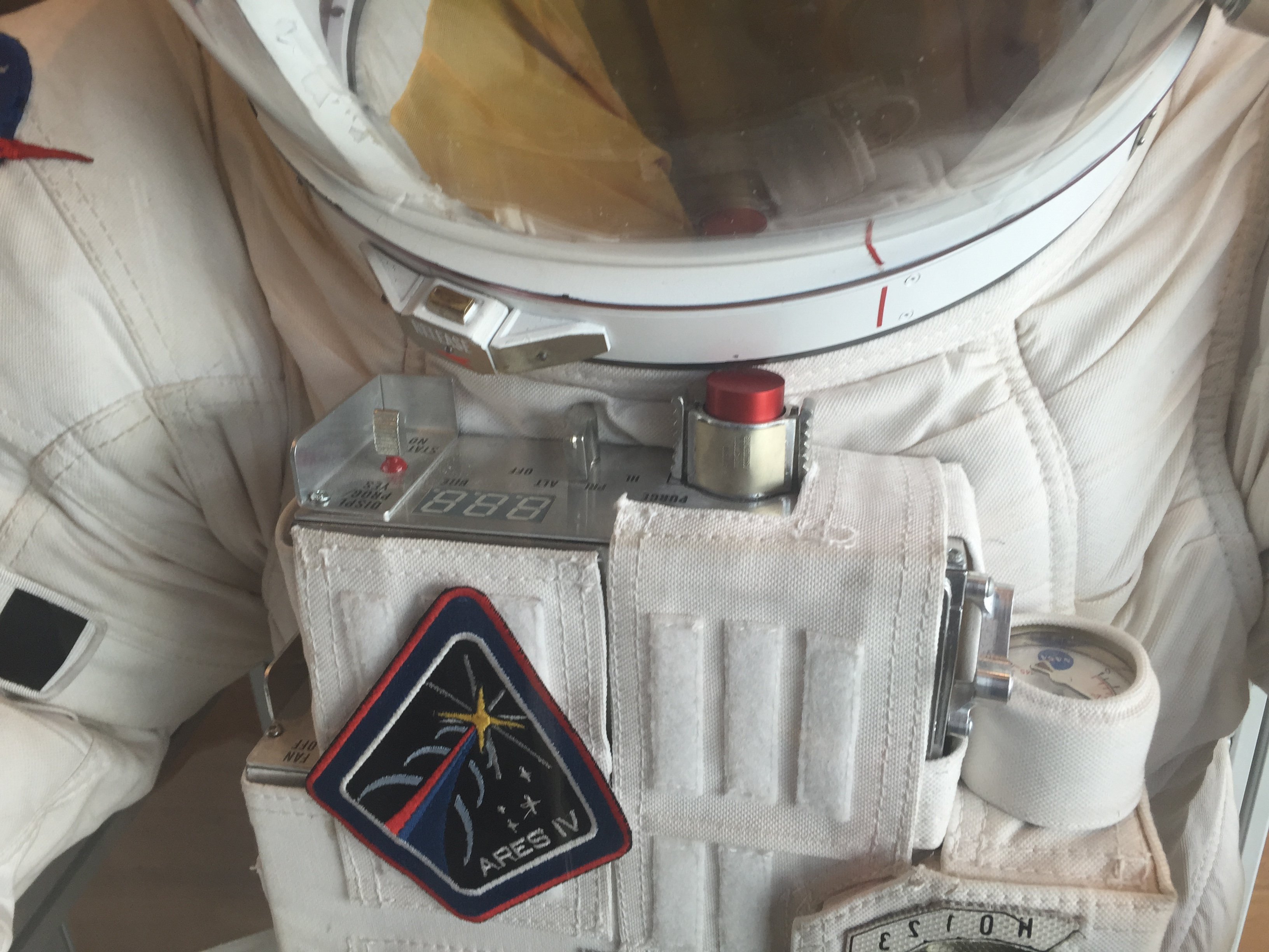

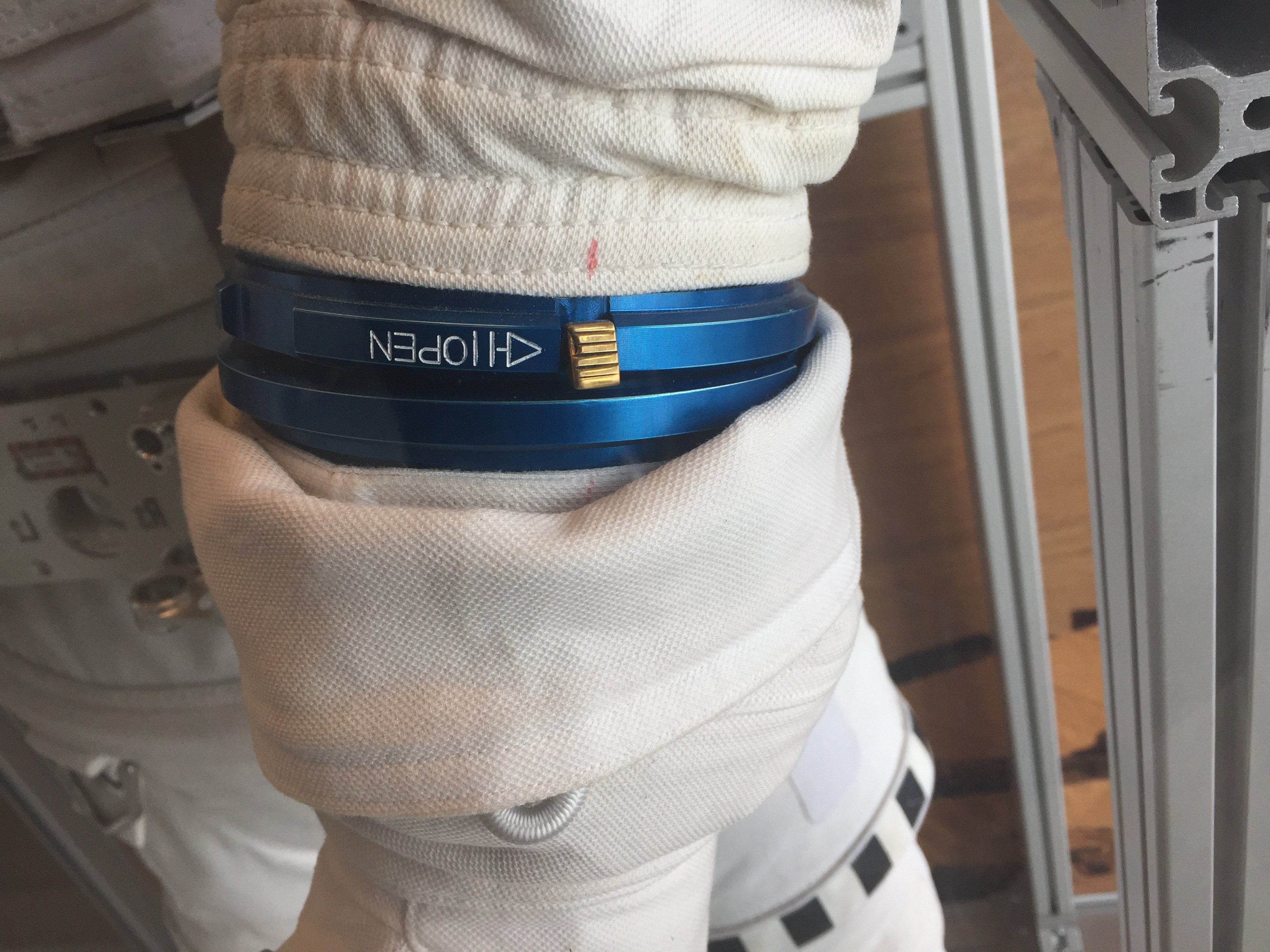

They have this on display at the Landmark in West Los Angeles! (yeah, we get all the cool stuff)
Just had my phone, I'll head back with a nicer camera soon!
Very cool! What does that plaque say beneath Janty Yates? I really want to contact everyone who touched these suits to find out what they were made of.
The EVA suit looked like it may be real Beta cloth. The texture on the folds around the gopro look like the real deal.

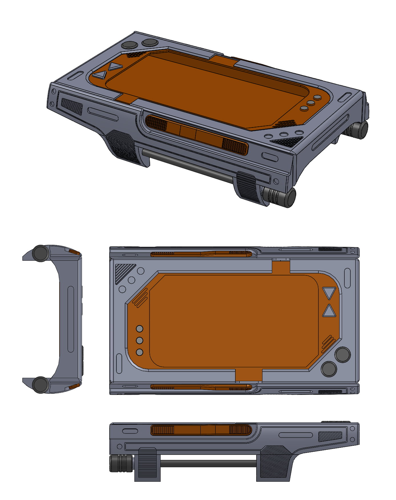

Got a bit more progress on the arm comp today. I tried to detail out the fillets as closely as I could following the reference photos. Some of them are a bit weird, probably hand done so the model isn't as clean as Id normally like. But as accurtae as can make out from the photos I have.
The internal screen pocket is sized for an iPhone 5 right now. So that should be able to slide in perfectly.
Still not sure if anything is on the thin side. In terms of a little detail. My guess is there is a pill slot on it, but for now its blank.
I just have to optimize if for 3D printing and round 1 should be good to go.
