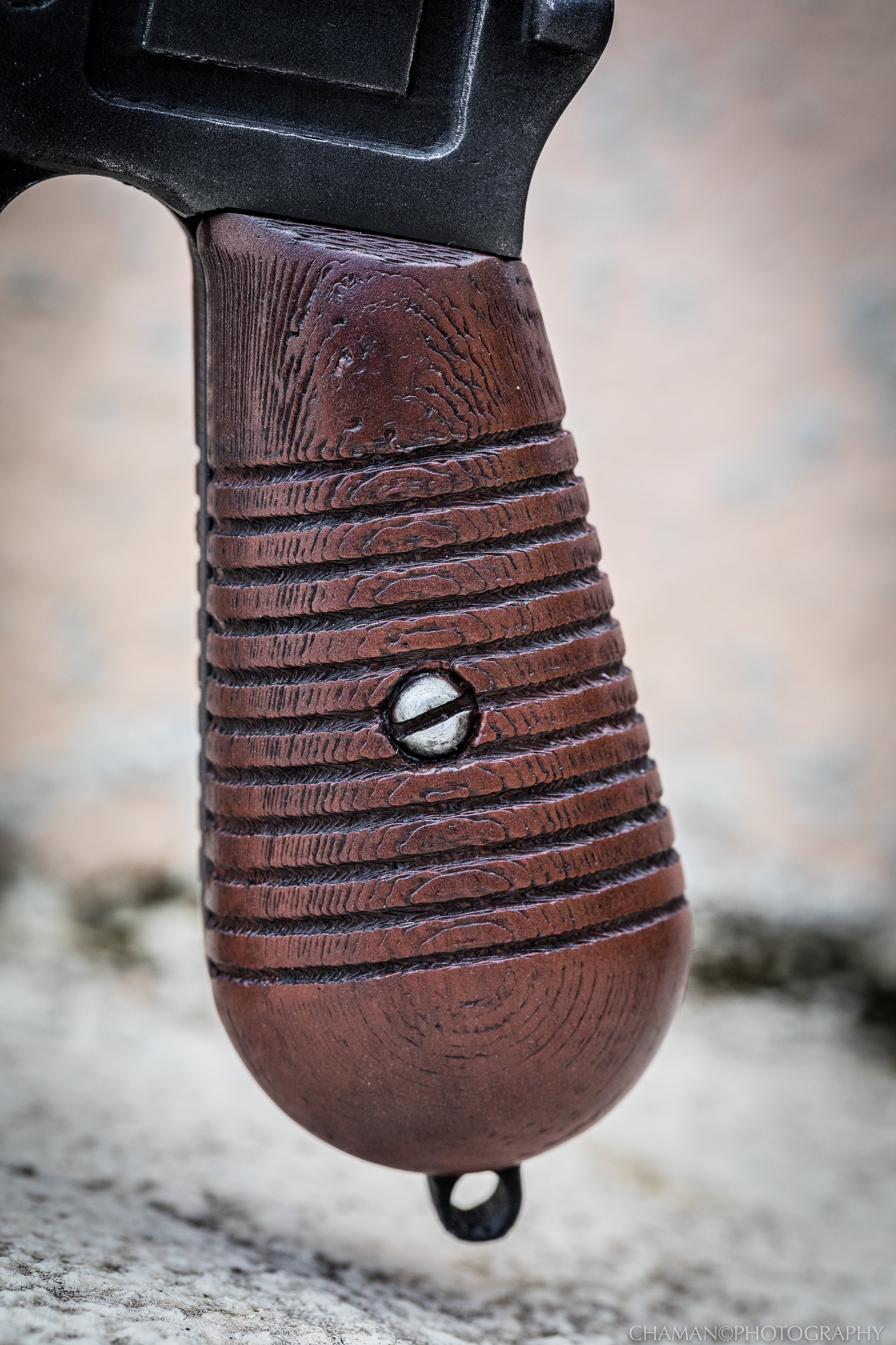

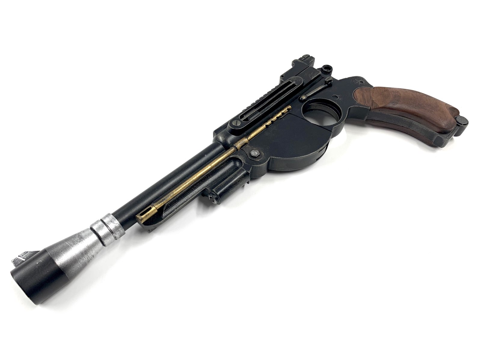

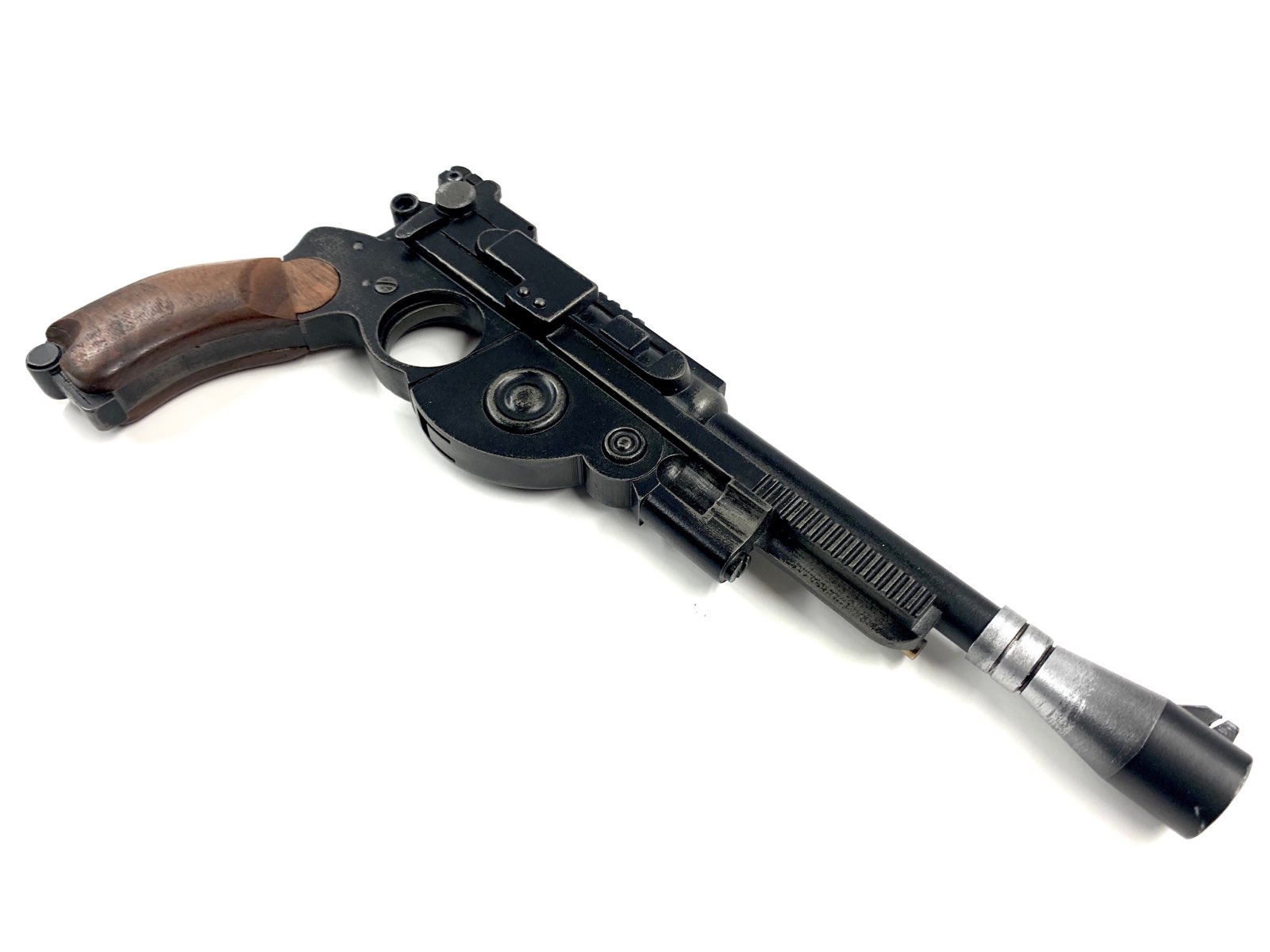

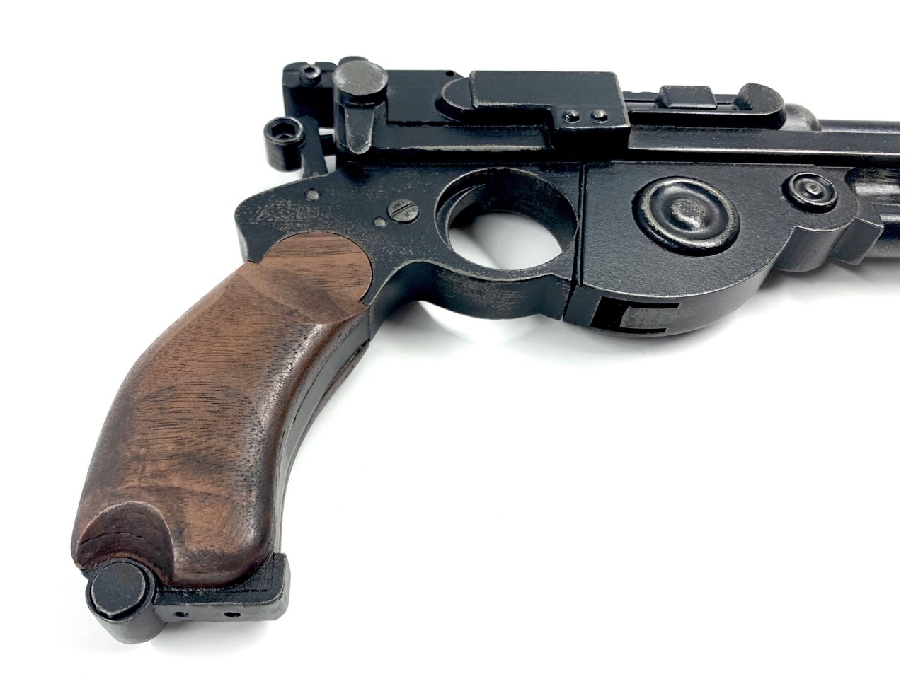

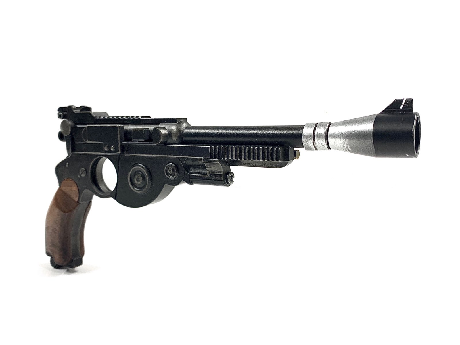

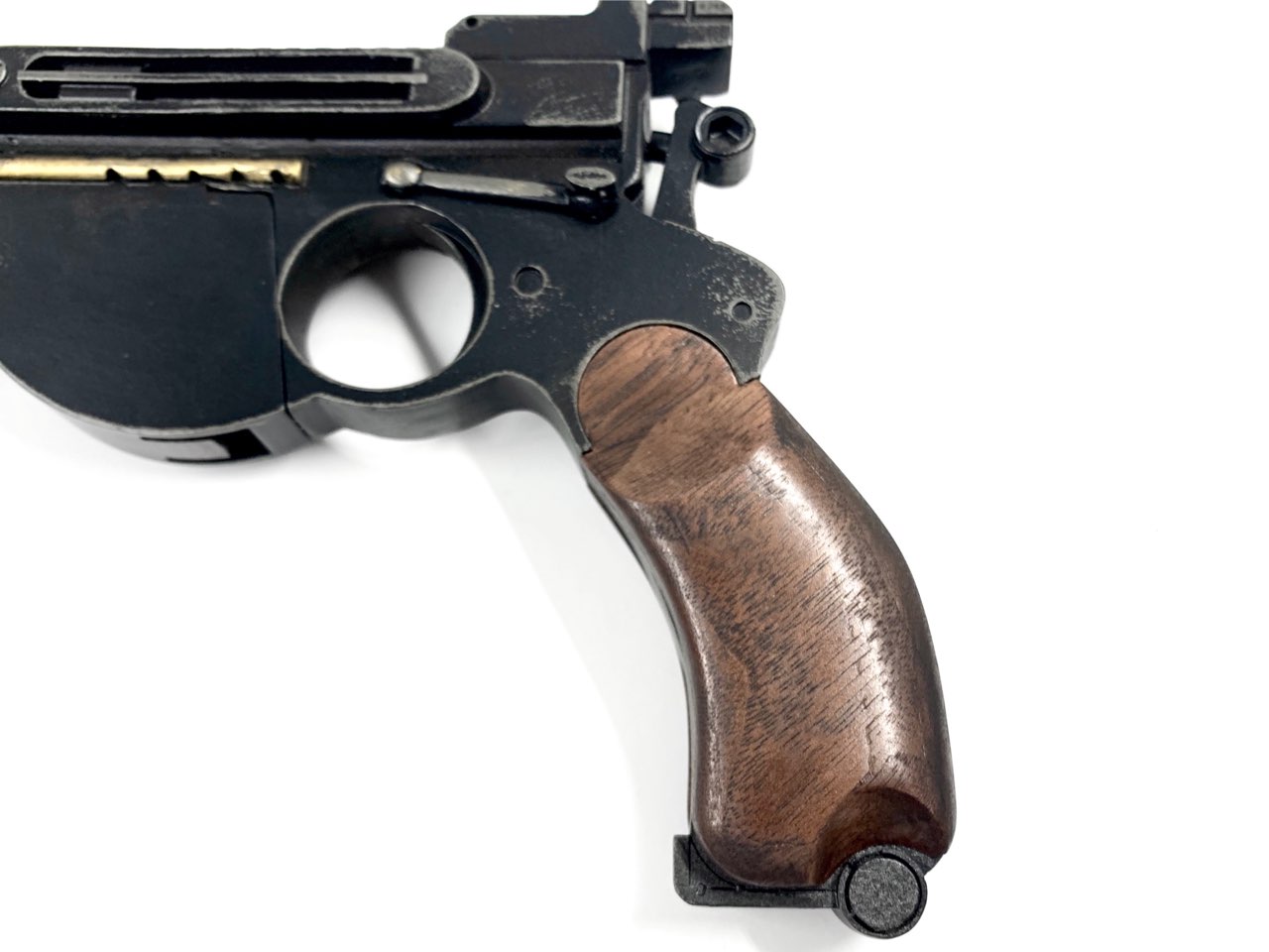

I'll be working with Joe and offering CNC'd solid walnut grips for his kit! Here's one I did for a fellow RPF'er's (jhusel) blaster based on an older design before we had better references.

These walnut gips on mine look so nice! Much nicer than the painted resin ones I had on there! Perfect fit too

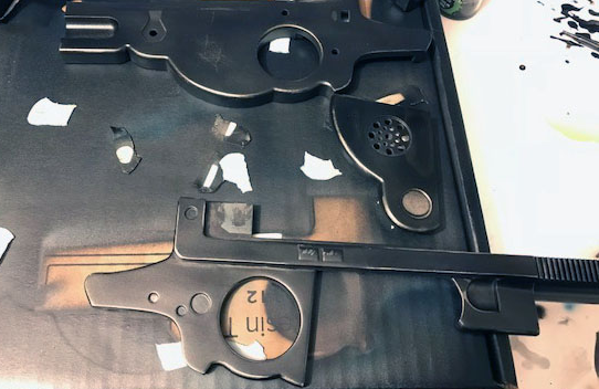

OK, so... the next step in painting the body of the Mando was spraying it with metallic lacquer to use as a "cast steel base" when weathering. I used my airbrush and Alclad, because I had extra paint loaded into my airbrush at the time and then coated it with gloss (IMPORTANT!) clear. In this case, it doesn't matter that I used a regular rattle-can clear that messes with the metallic sheen a bit as we don't need chrome reflectivity. What we do need on the other hand, is resistance to isopropyl alcohol, which will become clear soon. You can really use any old silver paint for this (Games Workshop's "Lead Belcher" is a great light gunmetal) as long as it doesn't rub off with alcohol and gloss paints are more resistant than mattes. Most normal rattle-can paints are good for this. Apologies, but I forgot to take a photo of the parts at this stage.
Once the silver is dry it's time to hit the parts with one coat of black ACRYLIC paint, gloss or matte. I use Tamiya's glass jars usually. The trick here is that you want this paint to be vulnerable to the alcohol. (You see where I'm going with this.)
After the black has dried, it's time to start with the stuff that will give you a nice chemical blued effect. I thin some Tamiya clear blue acrylic, then add just a drop (!) of a metallic gunmetal shade. Seriously... just a drop, because too much can ruin the effect. If you don't have an airbrush, you can probably use any clear blue rattle-can paint, as long as it's acrylic and not a lacquer or enamel. Again, we want it to be vulnerable to alcohol. If you can't get any clear blue that has all these properties, you might have to do weathering in a different way, by adding silver "on top" of the final coat later. In that case, you can skip the silver-spray mentioned earlier and just do the clear blue right after the black base coat.

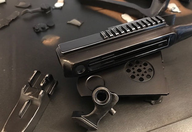

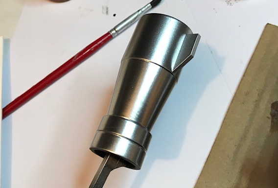

I hit all the brass parts and muzzle with Molotow chrome using my airbrush. Molotow is great for "bright" chrome (Alclad is generally darker) but very tricky to apply until you get the hang of it. Basically, you use VERY low air pressure and apply one medium-thick coat. You have ONE shot at it basically and if you mess up, it's time to strip and redo. Put it on too thin and it'll "frost" over and not give you the mirror finish. Put it on too thick and it'll take weeks to dry. (Either way you need to give it at least a day to dry. I always spray a scrap piece that I can press with my finger to test- if your fingerprint leave a mark, it's not cured yet.) Molotow is also fantastic for applying "candy" color to.
Here's the muzzle:
And the brass parts, covered with Alclad "candy gold" paint.

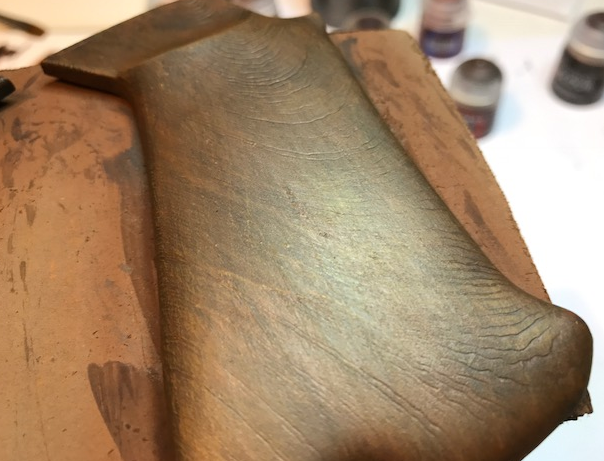

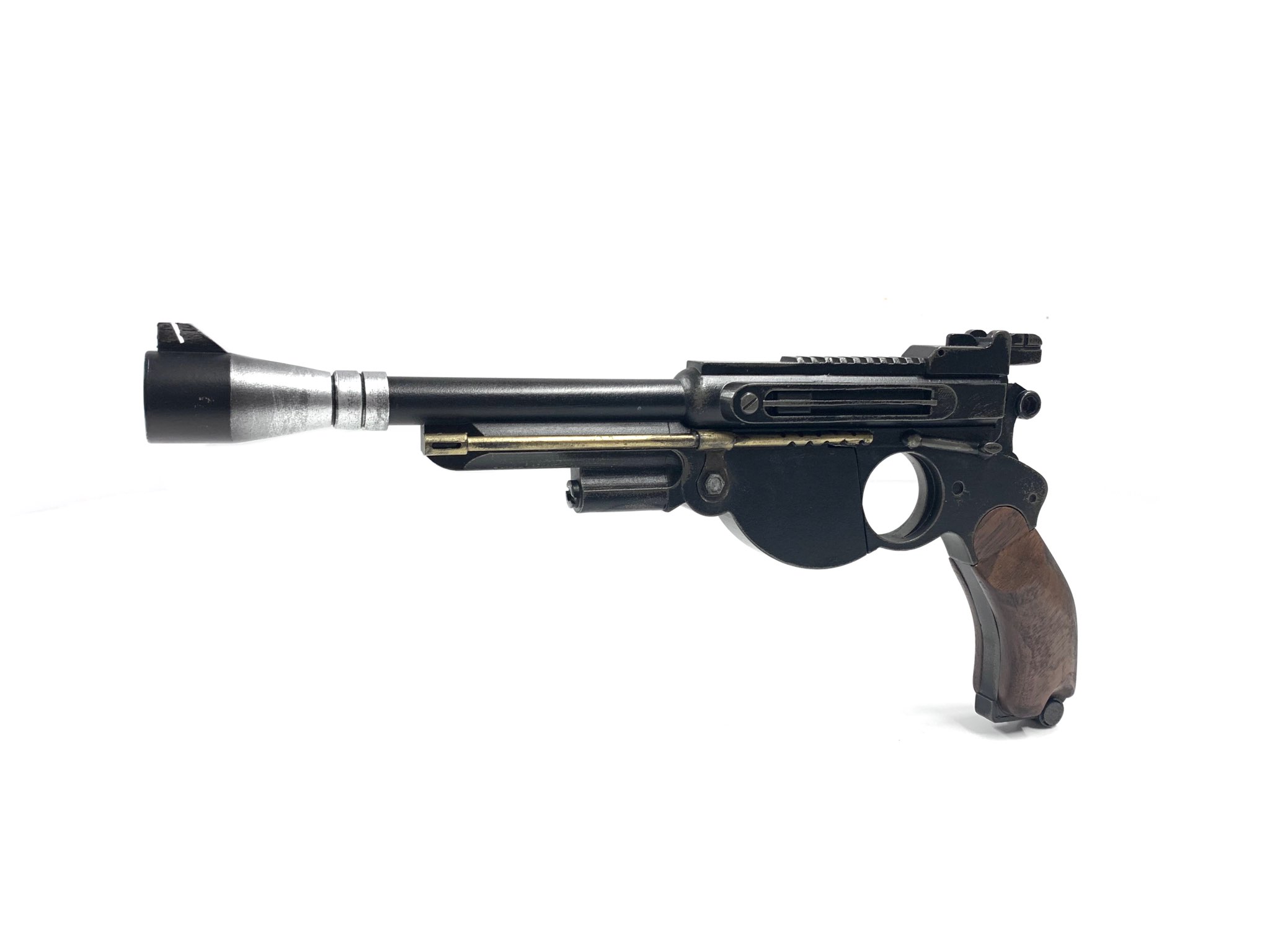

Some progress on the grips. These (still w-i-p) were done with (more or less) the method Tennantlim described above. I moved the brush in more of a wavy pattern to kinda follow the grain and added a wash of GW "Agrax Earthshade" ink and also their "Wyldwood contrast". (Yes, I do love Warhammer and their paints!) At this stage they look a bit like grips that are in the final stage of sanding, before oil staining.

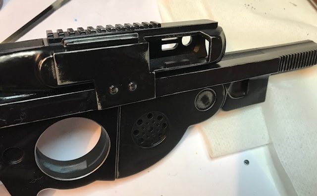

Now for some weathering. I dip a Q-tip in diluted alcohol (isopropyl) and rub it along edges of the body panels. This takes off the blue and black coats, exposing the silver underneath. You can experiment in different ways of scuffing the surface using pieces of plastic, guitar picks, carefully scratching with a scalpel and so on to beat up the surface. You can take it as far as you want, to get light or heavy weathering.
This is all pretty basic stuff. Once the body panels are all weathered it's time to add some graphite powder, where the addition of the clear blue over black starts to pay off...

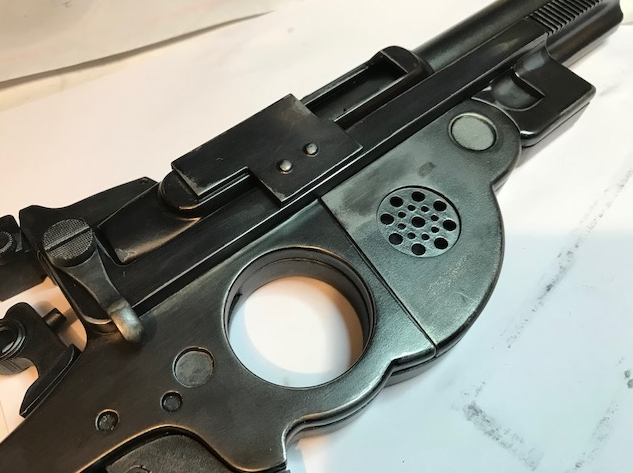

Here' s most of the main body after weathering all the edges. Honestly, we could leave it at this level and it would look pretty OK. It's not far off from how the blaster looks a lot of the time (though it's even more scuffed in some episodes).
But let's take it up a notch or two.

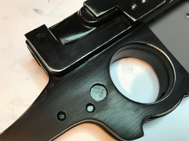

After this stage, I scuffed up the surface with some fine steel wool, using straight movements with a very light touch. I also made sure that the scuffing was not uniform, leaving some patches more shiny and others taking off the blue topcoat, going down to the black underneath. Like so:
Next, the parts were covered in a rubbing of graphite powder, using a cotton swab, then the parts were washed in water and diluted (hand) dishwashing liquid. The graphite particles embed themselves into the paint, so they don't all wash off easily. (Sorry, no photo of this stage.) Inpsecting the blaster, I wasn't happy with the overall look- it was too "gunmetal" and uniform, so I decided to add more blue, and also some brown.
Going over all the parts carefully, I sprayed clear blue and clear orange over them, typing to keep a consistent method. This will help represent, in very subtle tones, the "oil slick" shifting you see in old blued weapons.
This is what that stage looks like:
Time for some more scuffing with steel wool and a little 1000 grit wetsanding paper, again with a very light hand! This builds up a feeling of "wear over time" instead of it just looking like you took a scrubbing to it. And after that, another rub-down with graphite, followed by a thorough washing wish dish soap again. (This time I used kitchen towel paper, the non-lint kind like they use at gas stations or workshops, because it's ever-so-slightly abrasive.)
That leaves us here. Not too far from what I was aiming for, but still a little too much "gunmetal".
Here's a real vintage blued S&W revolver piece to compare:
At the time of writing, I'm not 100% decided yet on what I'll do next. One option is to do a weathering rub using black oil paint, which will tone down the shine and darken it a little, but most likely I'll do another spray coating, with Tamiya clear "smoke" with a drop or two of black added, to darken the overall look.

Gave the muzzle some paint and weathering. First I stuck it on the end of a drill at very low speed, then very, very very, lightly touched it will a soft sanding pad to make it look "machined". Coated the front with a 50-50 mix of black and Tamiya smoke- the idea here was to make it slightly translucent. It's not done yet... still need more weathering and will probably hit it with some Alclad sepia to add some heat discoloration.

Onto the blaster. Sprayed all the parts, including the muzzle, with Alclad Aqua Gloss clear as a final protective coating. It's very thin, so you need to be careful, but it dries fast too and preserves the metallic look. I'm happy with this finish. The gloss coat brought back some of the subtle blue-brown tonal variation. A light scuffing and maybe an oil-wash and the main parts will be done.
Added a metal-burn sepia tone to the muzzle (before the Aqua Gloss).
Checking fit and look of the brass parts. They need just a tad more weathering (to match the hook above). Note that in the lower part of the image are a couple antique (over 100 years old) blued steel pieces. It's not too far off, and the Mando is supposed to be darker and look like it has been kept better anyway.
