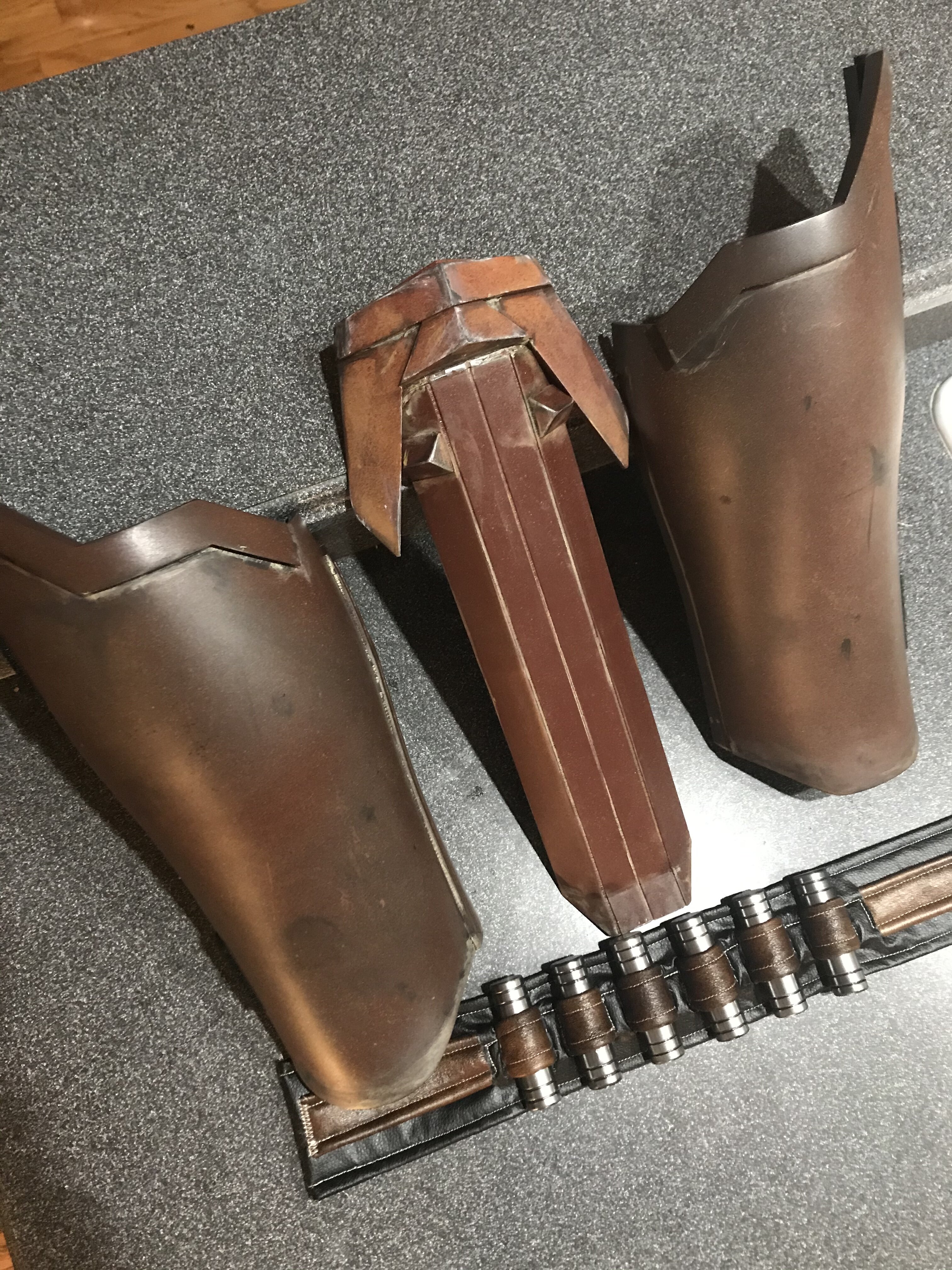

are you free handing all the armor shapes or working from templates?
Free hand.
I made the flack vest and adjusted it to the size I thought it should be then made the armor to fit that.
Went through a couple size iterations before I landed on this one.
first couple chestplates are in this picture.
Really nice work. I am really interested in seeing the right shin armor. That will be a fun make.

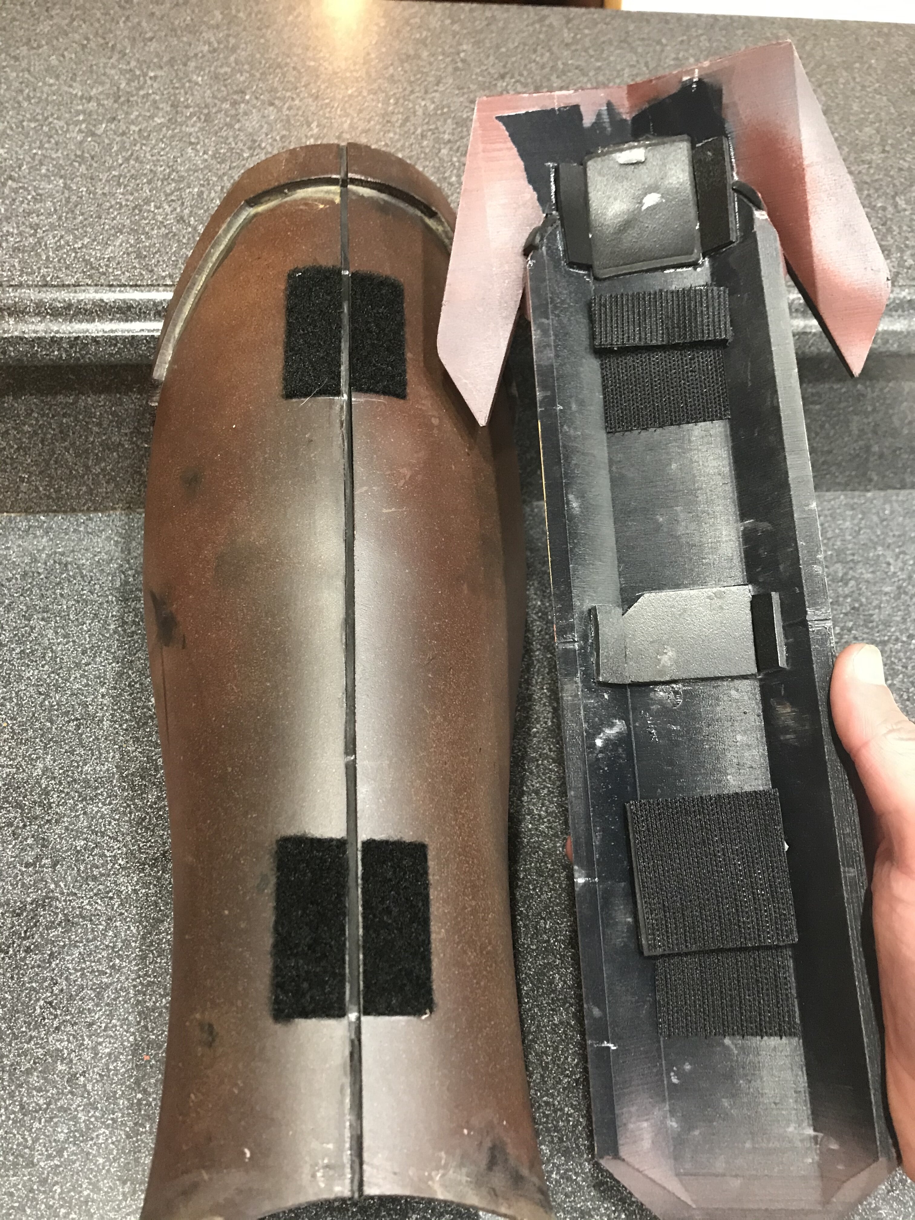

Thanks , the one in the picture above is 10mm floormat foam. the right shin was definitely hardest to free hand and at the time there were no templates available. I cant for the life of me figure out a way to recreate that shape with sintra.
I have a template now and might make a foam version 2 and coat it with xtc 3d or epsilon. then I might try to mold and cast in 65d or something. really trying to avoid 3d print but it may come to that o nthat piece like the gauntlets.
I will post some progress when I get to that soon.

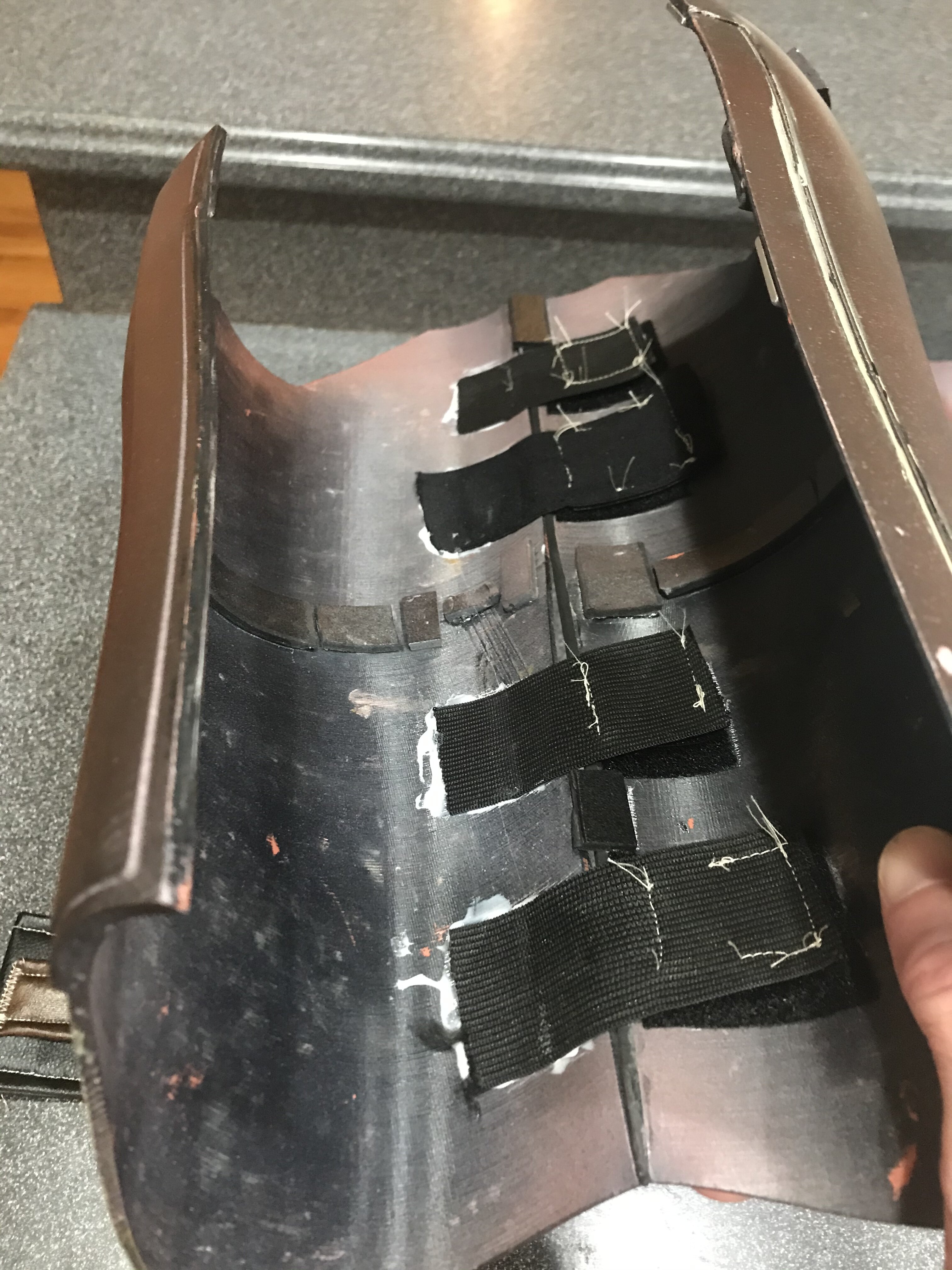

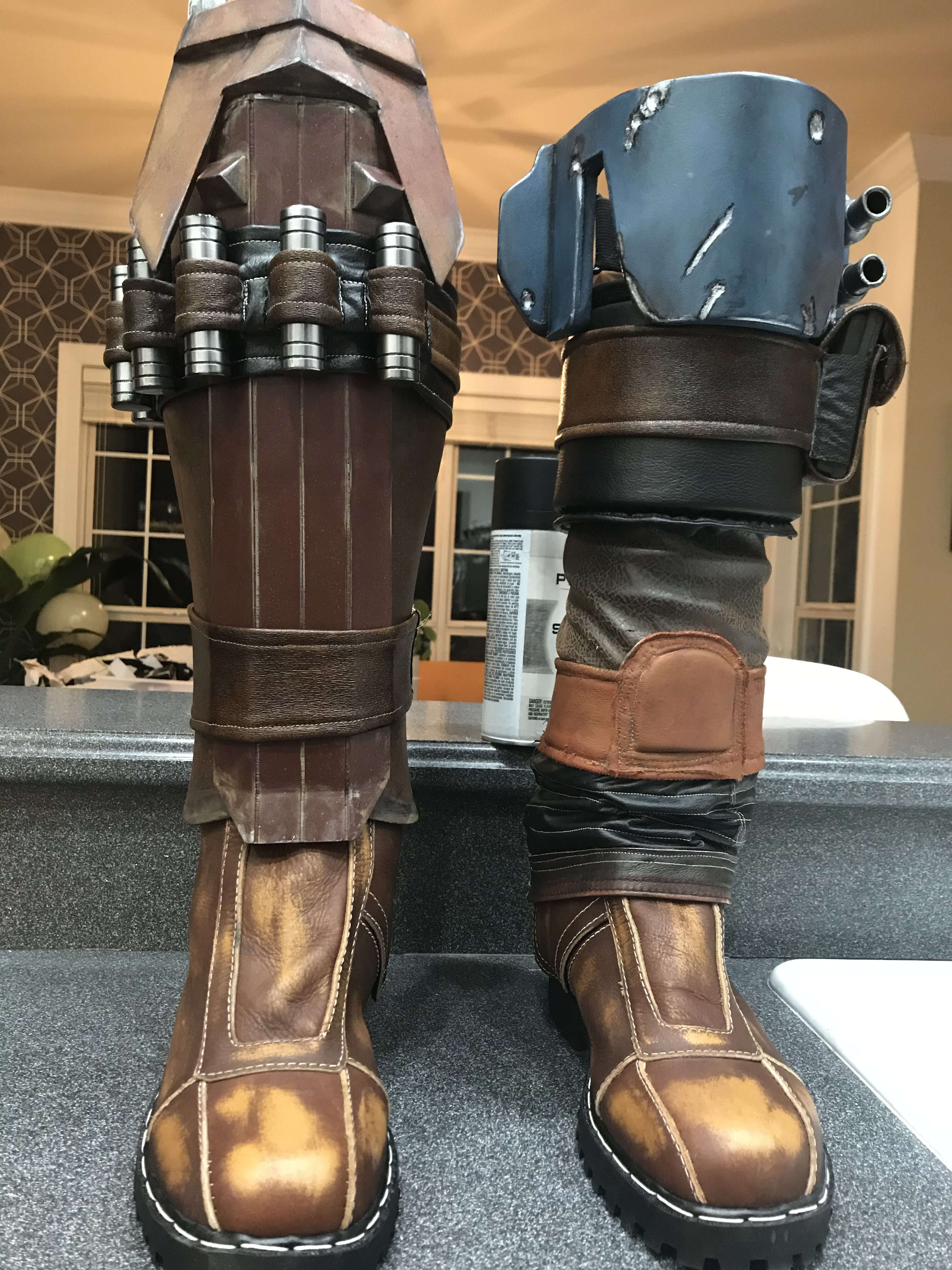

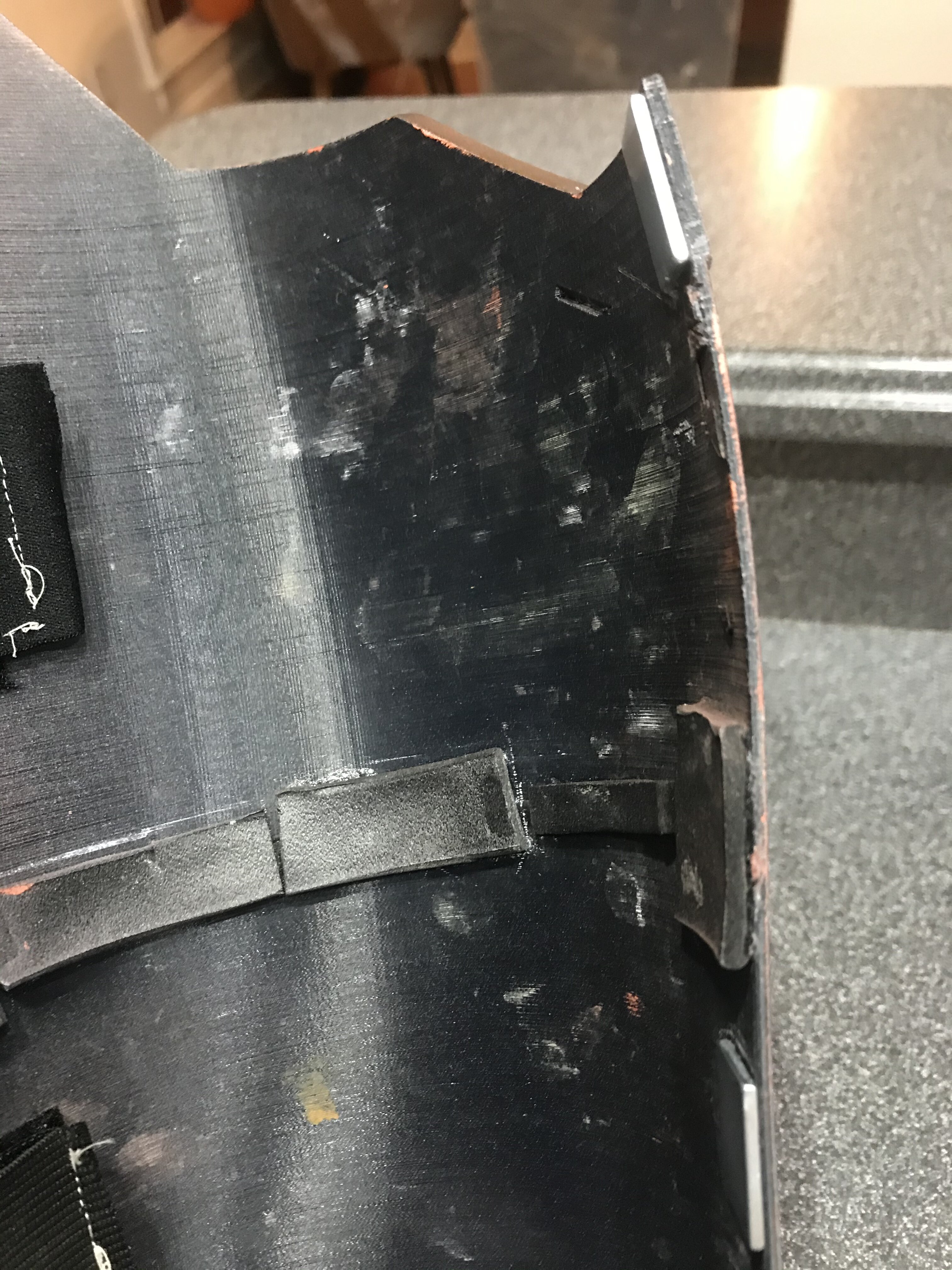

I could not find a good way to scratch build the right shin. My brother in law printed Nigel Chua’s file for me. Sanded through the grits 80/100/150 a couple times then filler primer coats with wet sand f at 400. Painted Montana gold shock brown dark and the boomerang was chestnut.
attached the center with elastic in the front and magnets in back.
Sewed the pleather strap and painted the ammo cylinders with Duralumen.

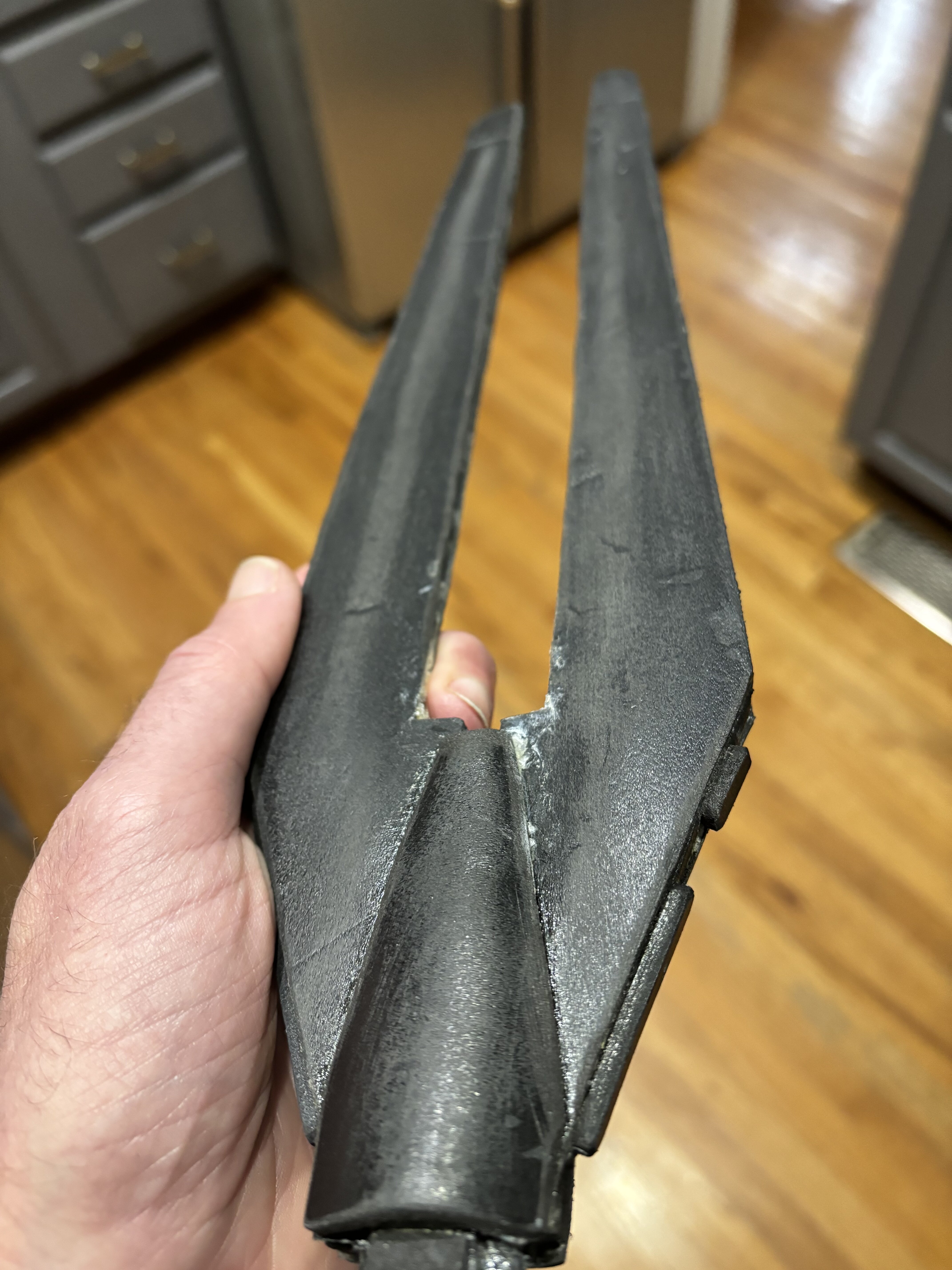

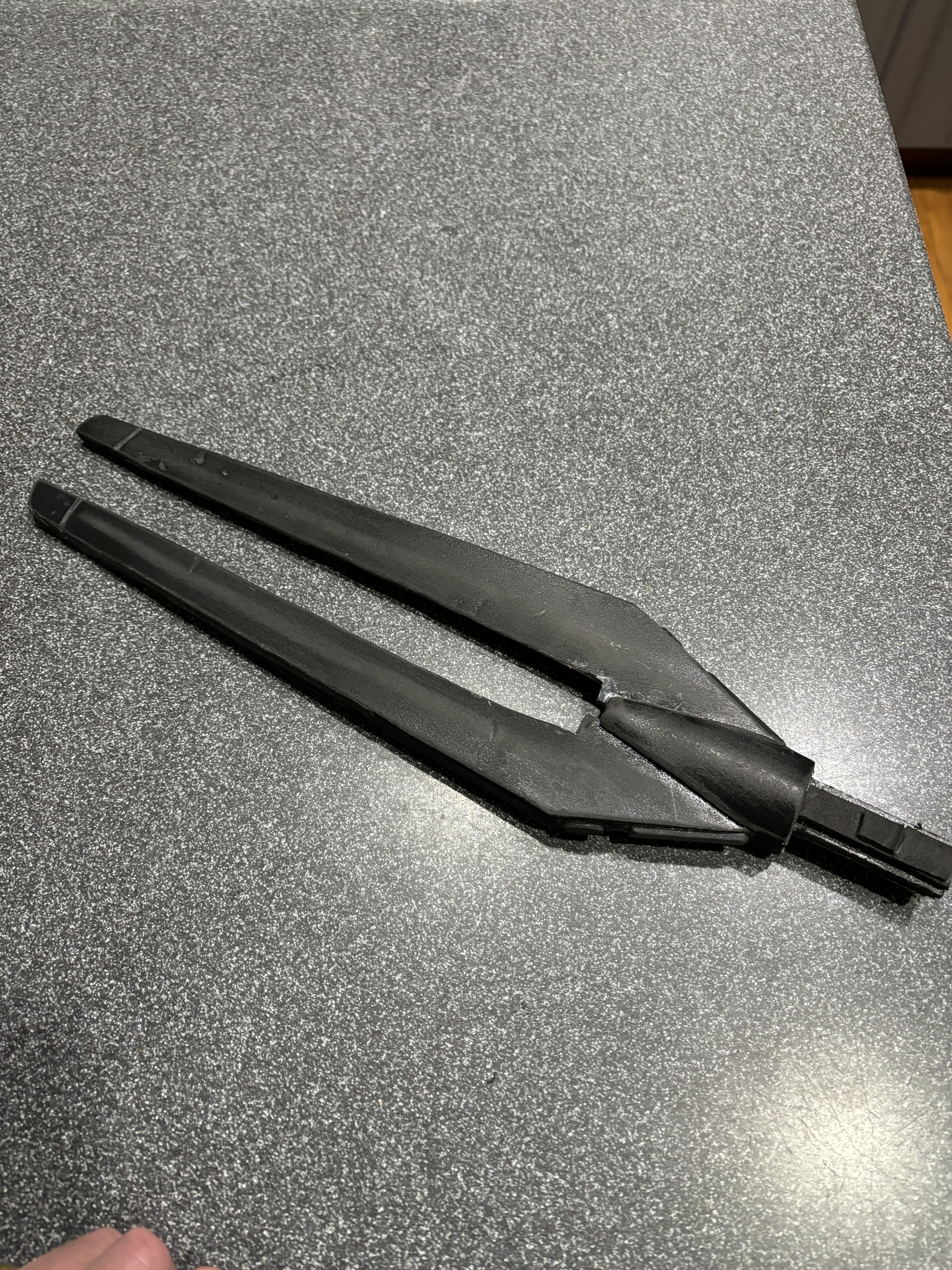

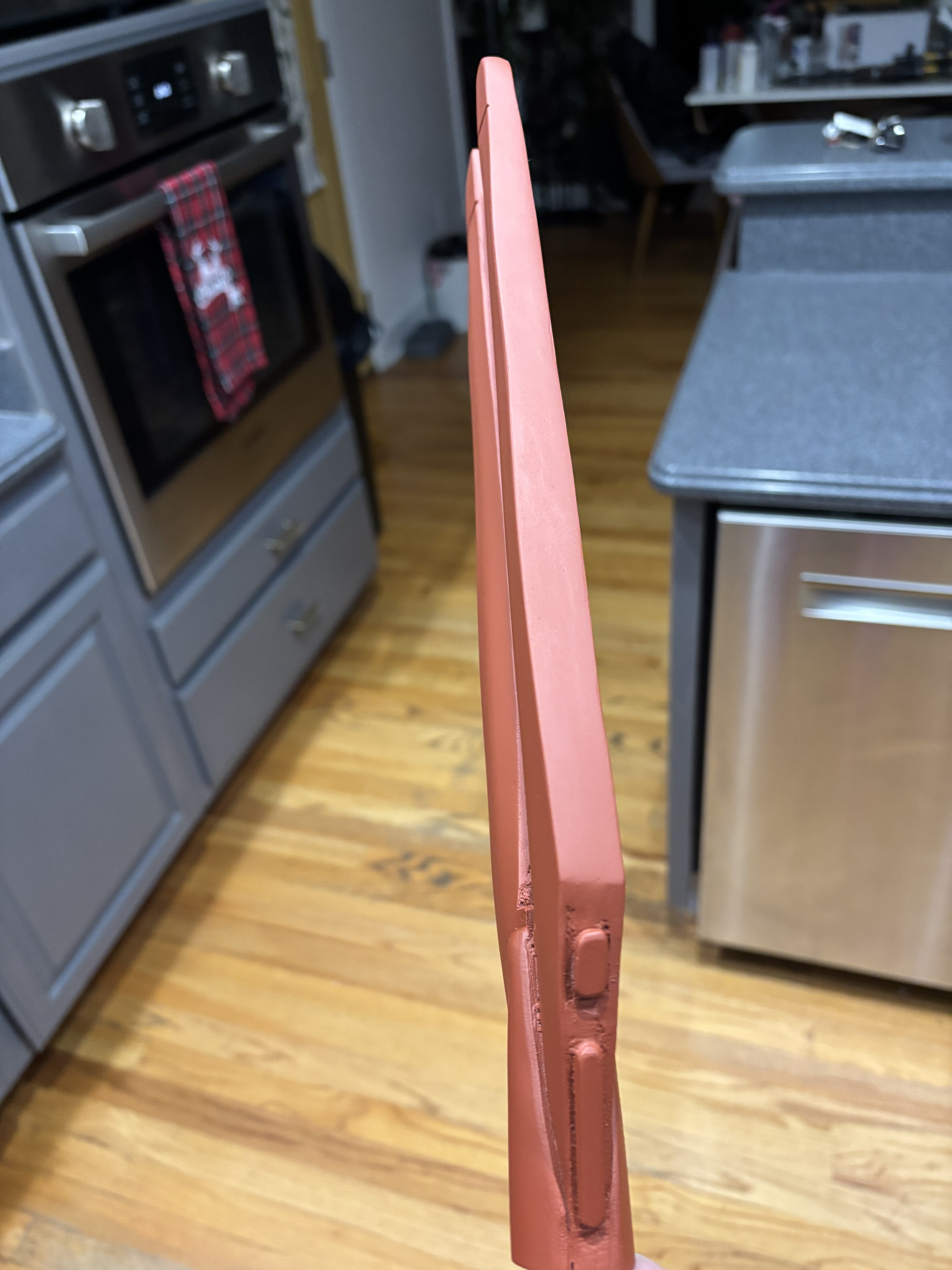

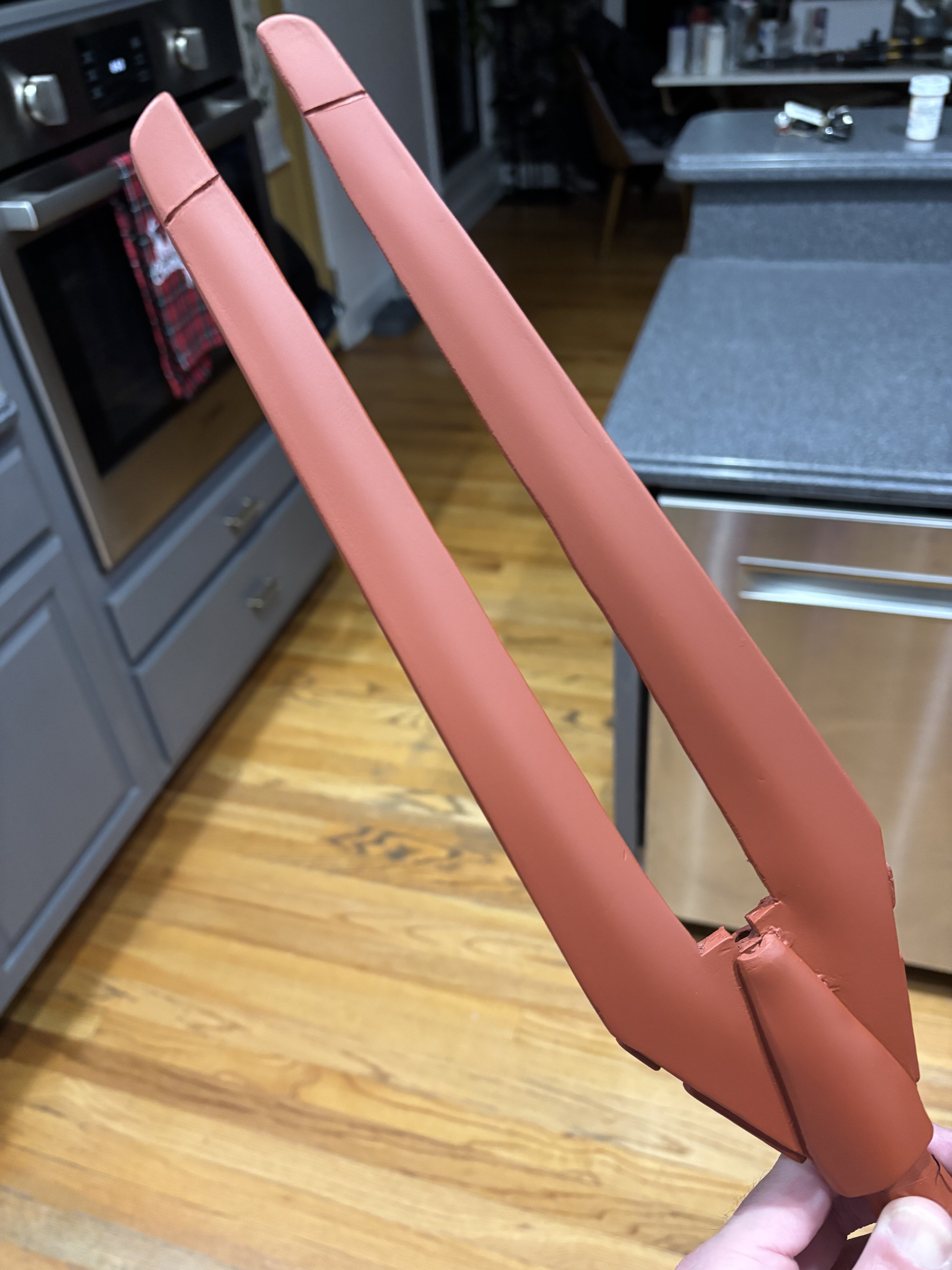

Still tinkering with this build . I scratch built the amban rifle in 2019 with foam , sintra, and pvc. There was not enough reference and have been slowly upgrading it over time. The fork really needed an upgrade.
I purchased a template and scaled it to what I neeed. I made it from sintra and foam. Currently have it painted black with clear on it, ready for the chrome paint , then a clear and weathering.
